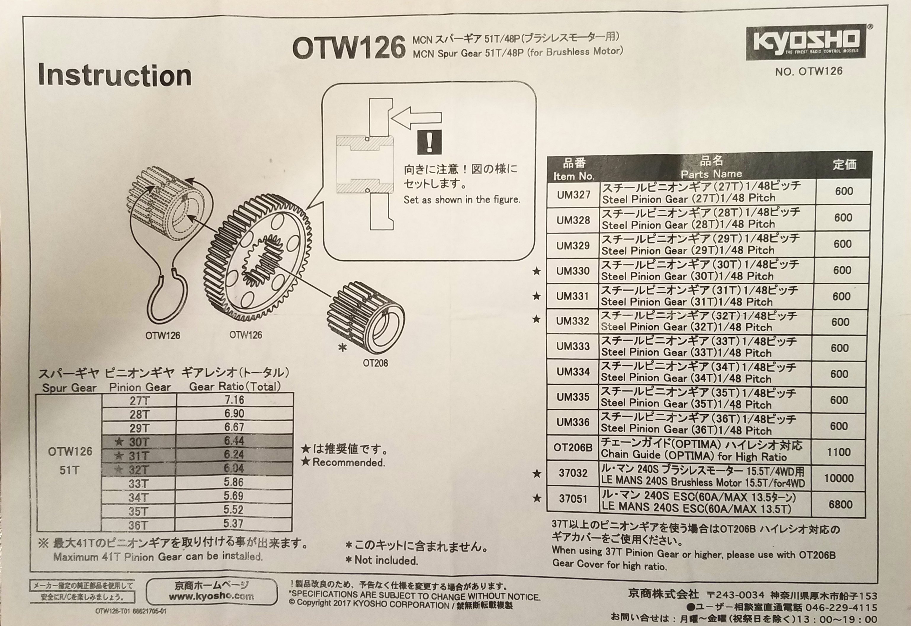

I agree that the good folks at Kyosho know what they are doing. In fact they recommend 30, 31 or 32 tooth pinion gears along with the 51 tooth spur gear when going brushless:
In fact, based on their recommendations...if all 540 motors use the same gearing then I am waaayyy under-geared.

I looked at the Javelin instructions as well as the brushless spur gear recommended pinion instructions and did a little math.
Both give final drive ratio with various spur & pinion gears and the internal gear reduction of the transmission is determined to be 3.79:1.
So, for an Optima / Javelin... Final Drive Ratio = (Spur Gear divided by Pinion Gear) x 3.79
This puts the final drive ratio of the 30 to 32 tooth pinion gears recommended by Kyosho between 6.04 & 6.44.

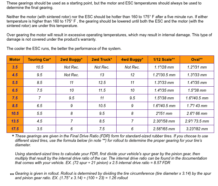

The following chart was provided by Novak and recommends final drive ratios for various turn brushless motors on various platforms. Even though it skips 15.5 turn motors, it looks like Kyosho is right in the sweet spot of what Novak would recommend for a 15.5 turn motor in a 1/10 4wd buggy.

So, it looks like Kyosho is spot-on if one is using a 15.5 turn motor, but I'm running a 8.5 turn motor.
If Coelacanth is right that all 540 motors can use the exact same gearing, then I'm actually fine. However, most motor manufacturers have final drive recommendations for their motors and they recommend lower gearing (higher final drive ratio) the lower the turn count (or the higher the kv rating).
Based on the Novak chart, I should be shooting for a 9:1 final drive ratio. The adjustment on the motor plate will not allow me to go any smaller than a 24 tooth pinion with the 51 tooth spur and that gets me to 8.054. Currently, I have a 25 tooth pinion installed & it gives a final drive ratio of 7.732.
I could put the kit supplied 61 tooth spur gear back in & use a 25 tooth pinion and take the final drive to 9.24 which is almost optimal...just slightly under-geared. A 26 / 61 set-up would be 8.892 which is pretty close, too.

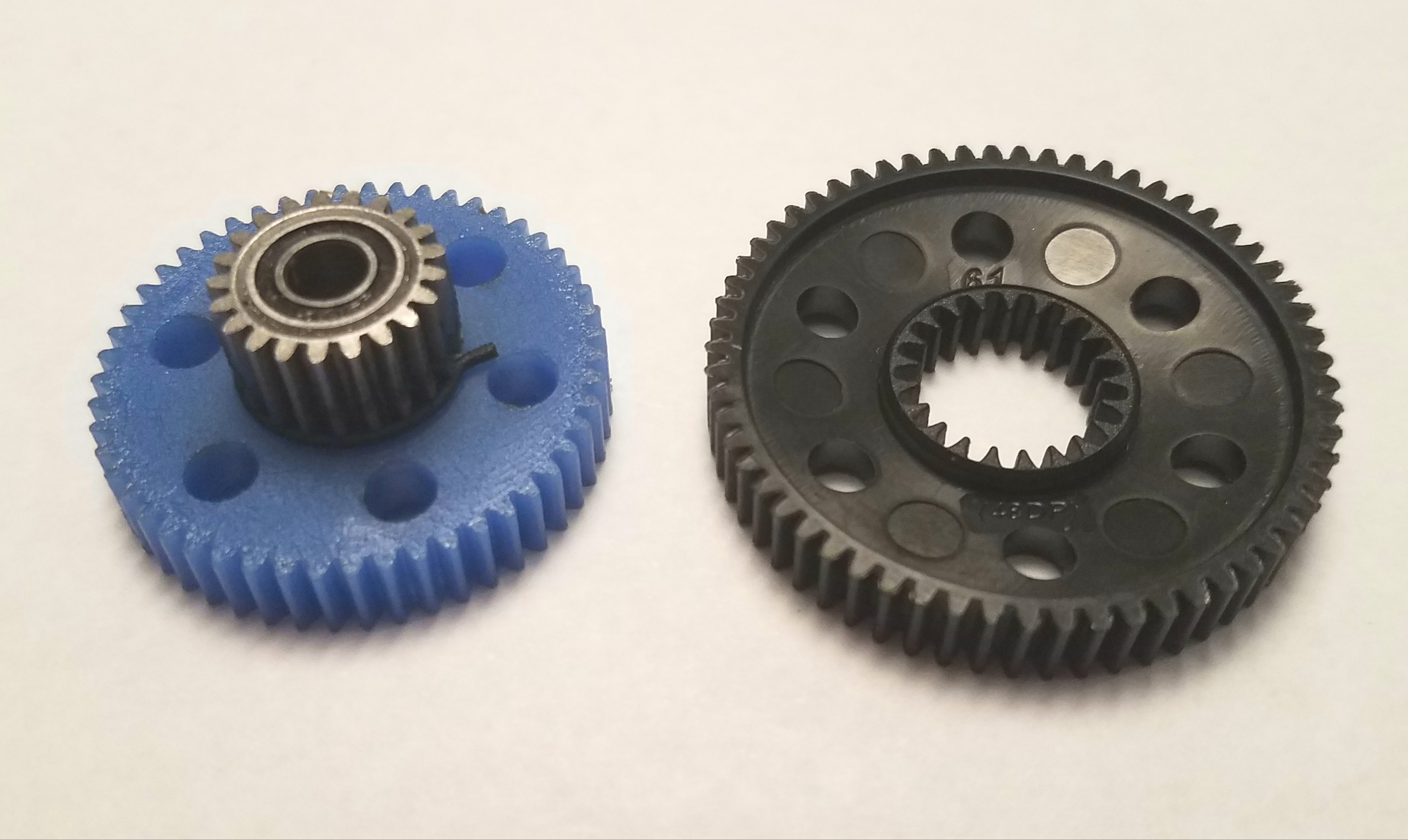

However, take a look at the picture below. The 51 tooth OTW126 is on the left and the 61 tooth kit gear is on the right. There is an obvious difference in the composition. I am wondering if the 61 tooth gear is weaker than OTW126.

It seems to me that the ideal gear ratio depends upon your goal. For instance, is the goal to attain the best possible performance (acceleration and top speed) or is the goal to achieve a reasonable balance between performance and heat/run-time. If you were to run an extremely high FDR, current draw would be relatively low so motor and ESC would remain cool and run times would be very long but the car would perform like a crawler and how fun would that be. Conversely, with an extremely low FDR, the car might perform like a rocket for a short time until it disappears behind a thick cloud of smoke.
I guess I'm just stating the obvious.
Looking at Novak's chart, my cars are under-geared (i.e. high FDR) so I'm probably missing out on some of the performance potential from my equipment.
Regarding the material difference with the spurs, that's a very good question that Kyosho should be able to answer.

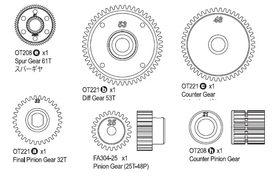

ahenderl, I'm trying to update my gear ratio calculator to include re-re Optima gear info. I see that the re-re spur gear is 61T and has a 21T inner cluster gear inserted into it. What I don't have is the counter gear specs; the one with the slipper. How many teeth is that gear? The original stock Optima counter gear is 28T but that slipper gear looks like it has a lot more, finer pitch teeth than that. That would completely change my calculator's output.
I assume the internal gears are the same as the original Optima; i.e. internal diff gear = 37T and internal final pinion gear = 19T. Thanks!

here are gear teeth counts for rere javelin. assume optima is the same. hope this is helpful.

XLR8 wrote: Mon Sep 10, 2018 5:23 pm here are gear teeth counts for rere javelin. assume optima is the same. hope this is helpful.
That's excellent, XLR8...just what I needed. The re-re Optima gearing is completely different, outside AND inside, so my gear calculator's results will be way off for a re-re Optima. I'll update my calculator with the new gearing. Should be interesting to see how the new rollout compares with the old.

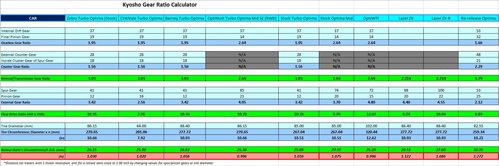

Coelacanth
Posts: 7421
Location: Alberta, Canada
Re: A tale of two Javelins...
Post by Coelacanth »
Okay, here's what I got, plugging in the new stock re-re gear numbers, and comparing to the original Optima, Turbo Optima, Optima Mid and Lazer cars, and some observations:
You'll notice with the stock original Optima and Turbo Optima and even Optima Mid, Kyosho was aiming for a rollout ratio "sweet spot" of 1.00 inches, give or take 10%. All of these cars, with the originally-included gears, had a rollout between 0.90" and 1.10". I don't think that was a coincidence. In all my modded cars, I selected spur & pinion gear ratios to match that "sweet spot" rollout ratio to get as close to 1.00" as possible, factoring in the very different tire diameters I used with some of those cars; the Barney Optima using larger 2.2" wheels & Proline Caliber tires and the CYANide Optima on-road project car, that has smaller-diameter HPI Vintage VTA wheels & tires installed.
EDIT: I assume the re-re Optima tire diameter is 82.55 mm, is this correct?
Even the later Lazer models, with different gearbox gearing and finer-pitch spur/pinion gearing, ended up with rollouts very close to that 0.90" - 1.10" optimal range.
The re-re Optima, with stock gearing, has a final drive ratio of 8.03 vs. 10.35/9.78/9.74/10.06 (orig. Optima/Optima Mid/Lazer ZX/Lazer ZX-R), which is a significant departure. When you rotate the motor one revolution, the car's tires will roll forward 1.272", about a quarter-of-an-inch more than most of the vintage cars. My guess would be that the taller gearing is acceptable since all of the gearing is stronger than original, the car has a functional slipper gear, and you can easily adjust "punch" acceleration settings in modern ESC's these days.
What I'd be interested to know however, is if motor and ESC temperatures would decrease a tad if someone were to change the spur & pinion gear ratio to something like 61T/23T, which puts the rollout to 1.017". I don't have a re-re Optima or Javelin but would anybody be willing to try out that ratio and let me know how the car runs?
