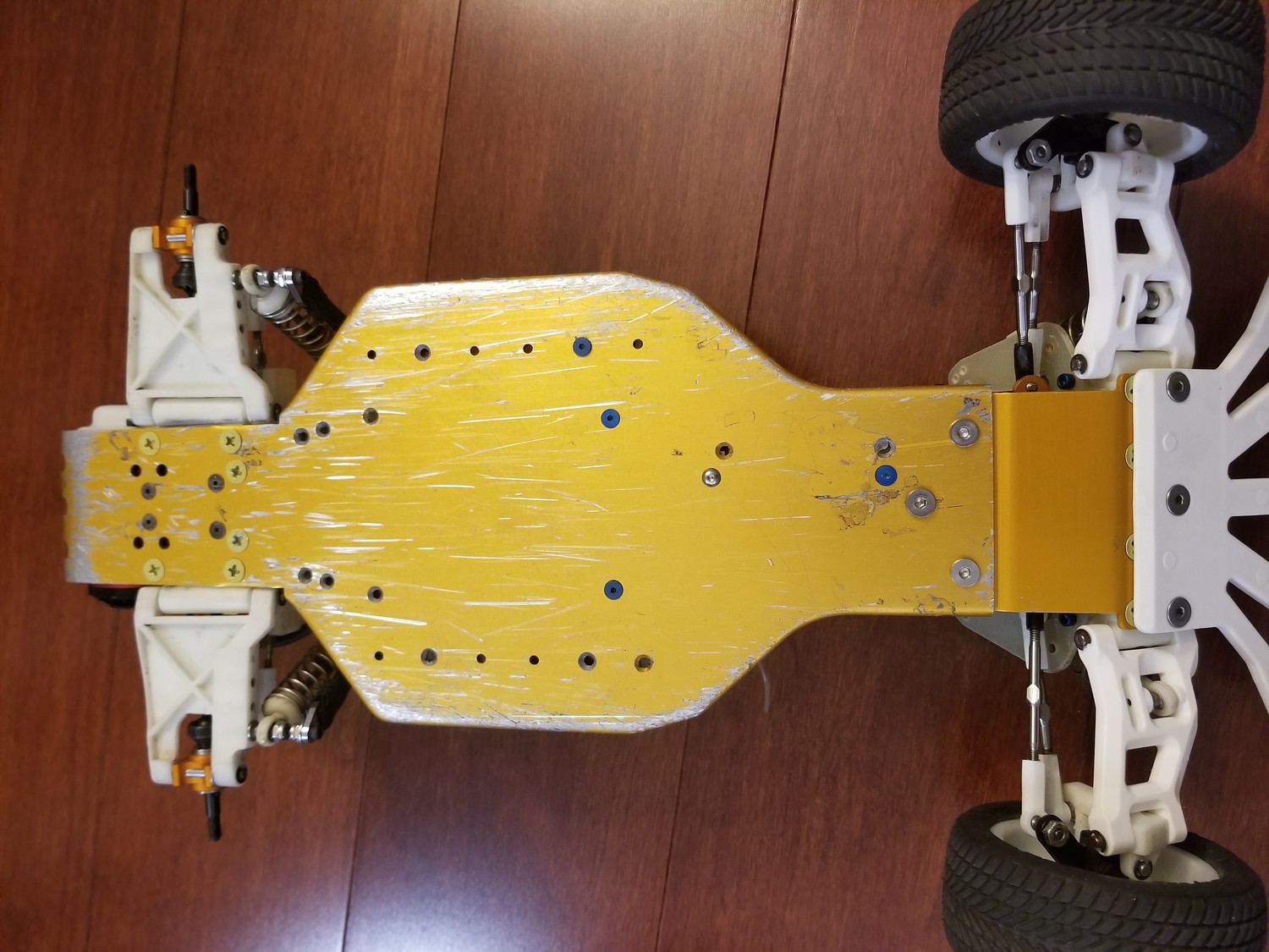

Right now I'm working on finishing up the steering, as I have the z-wires and collars that are needed for that. I picked up a black 81T black spur gear to install, so I won't ruin the white original. I have some RPM white heavy duty rod ends that will be going on some nice ti turnbuckles. I also have a few other parts on the way like Avid bearings, a Trinity Speed Spec 6-cell nicd, and Team Associated Factory Team curved body scissors to trim the Andy's Renegade body. I will be making my own chassis protector to protect the value of the car.

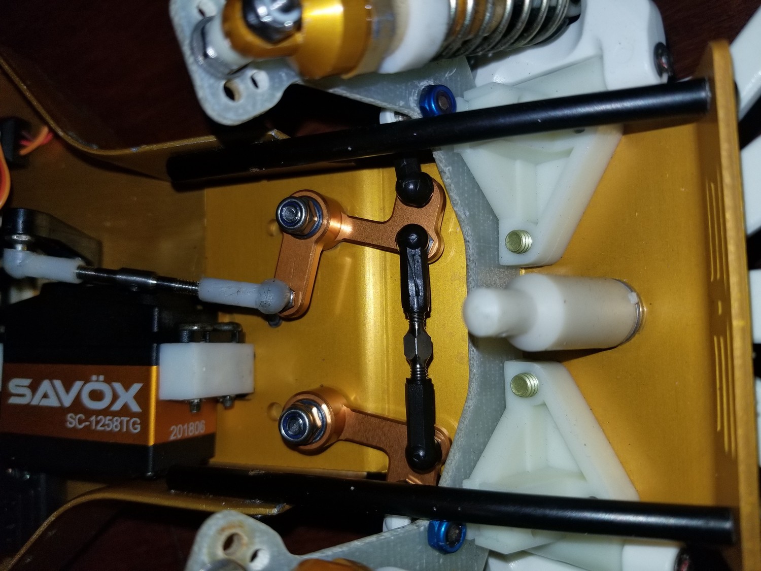

I started out with 21/81 gearing. I know the Force II motor has 34 or 36 degrees of advanced timing, so I hope that 21t pinion isn't to tall. We'll see. I have a question on the steering rack...is it supposed to be tight? I mean it's movable, but nothing like a nice bb setup. I even backed off on the nylon nuts to give it some slack..and it didn't help. Should I upgrade it to ball bearing steering? Or is there a trick to it? This car has only been ran one time according to the last owner I bought it from, so I'm thinking it might free up some as I use it. Hrmm. :?

The stock bellcranks should move freely. I think most guys upgrade to BB cranks to gain precision (the stock setup can be sloppy). I've had stock cranks bind before and discovered that the screw was bent slightly (it doesn't take much).
Thank you for the help XLR8. I will take the bellcranks off this weekend to see if the screws are bent. I have also heard of people sanding the bottoms of them to make them perfectly smooth.

x2 on the chassis protector. A scratch free one adds at least $50 to its value. My CE ended up being my main 1/10 scale car and its not quite scratch free...
For the cranks, I like the Dhawk aluminum ones on ebay. Just gotta locktite the threads for the ball ends.

You can't beat a good RC10 runner BooGTS. Thanks for sharing. I still need to make or buy a chassis protector. I definitely won't be driving it without one. Klavy69, I whip my cars up and down my street all the time, but you have me wanting to try out the tennis courts at the end of the block. :lol:
So I got the steering working smoothly. It was a slightly bent kingpin. Not sure how that happened, but that was the problem. Here's a few pics of the car so far:
