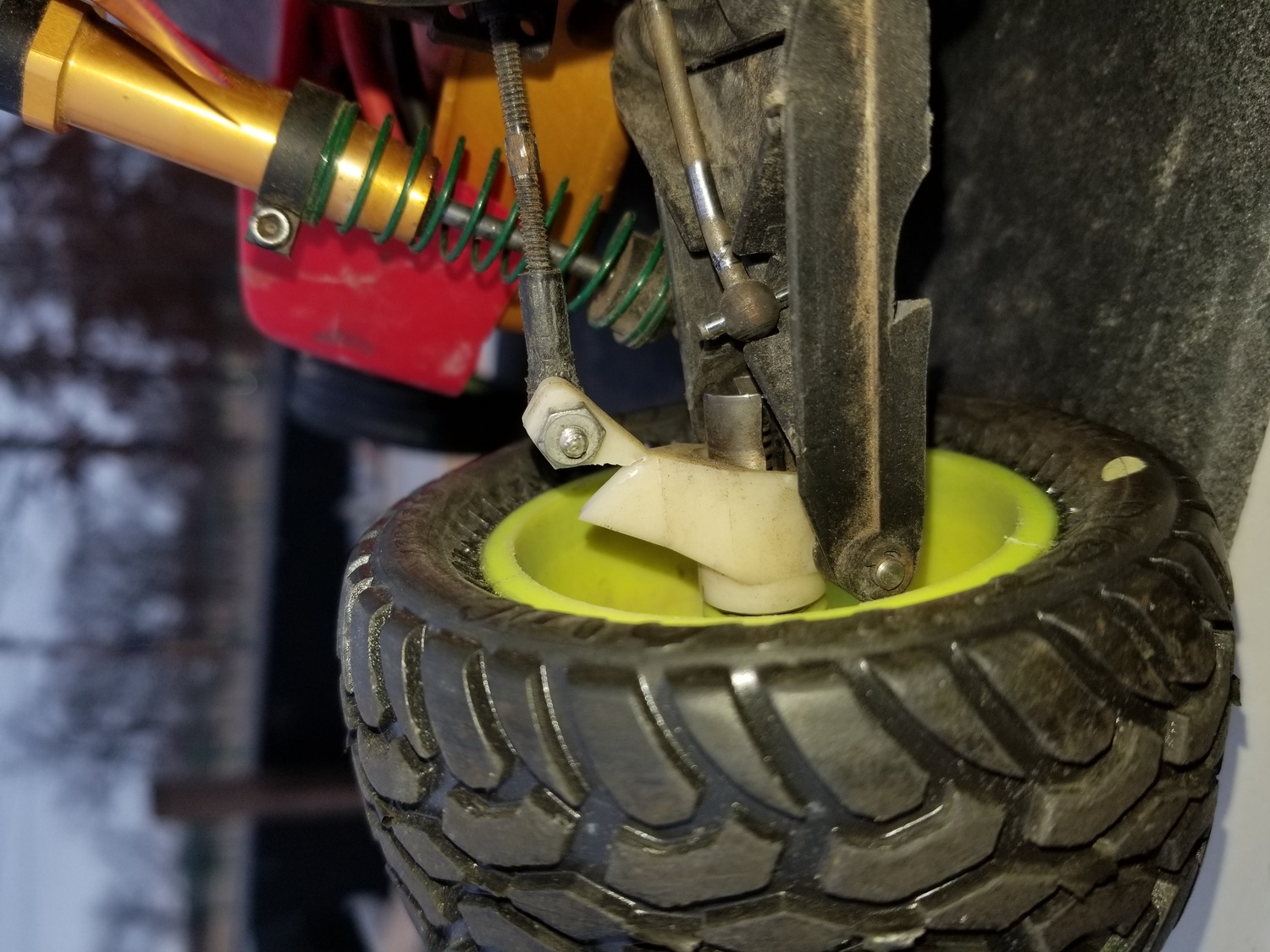

Well finally got somewhere I could run my rc10 that wasn't wet or ice, doing great in a parking lot, went in the grass then wouldn't move....? Picked it up I broke the rear axle holder and bent the shaft... any ideas who carries parts?

Is this the part number? Part#: ASC6365

Yes those are the direct replacement number.

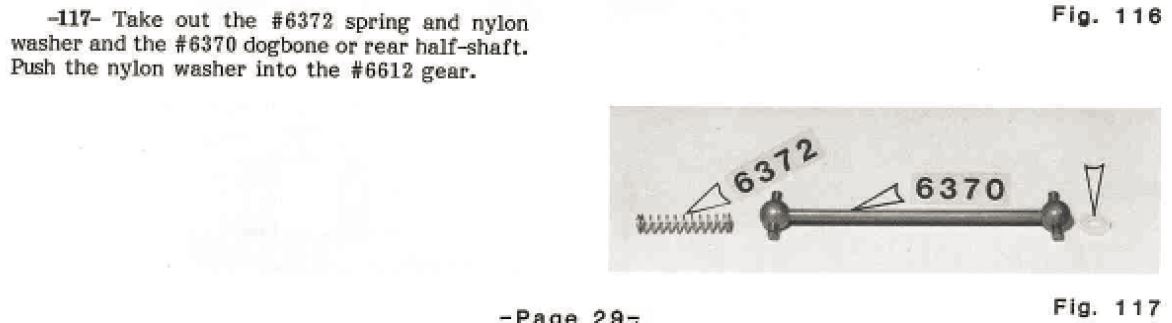

#6325 hub #6355 rear arm #6370 dog bone in stock at Team Associated
Also be careful you don't lose the spring and spacer out of the axle shaft and outdrive before you repair it .

rctenracer wrote: Sat Jan 26, 2019 5:27 am https://www.teamassociated.com/cart/
Ahhh.... I've got the spring, and dogbone.... what spacer??
I think I need to get a part schematic!!

thanks, cool!!! i still have the spacer
