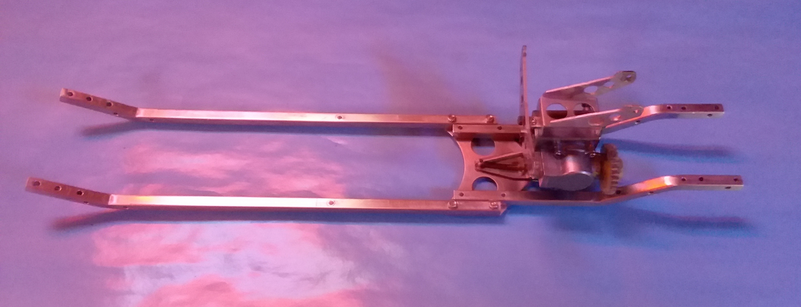

Post by coxbros1 »
Bent frame rails
Straightened and restored

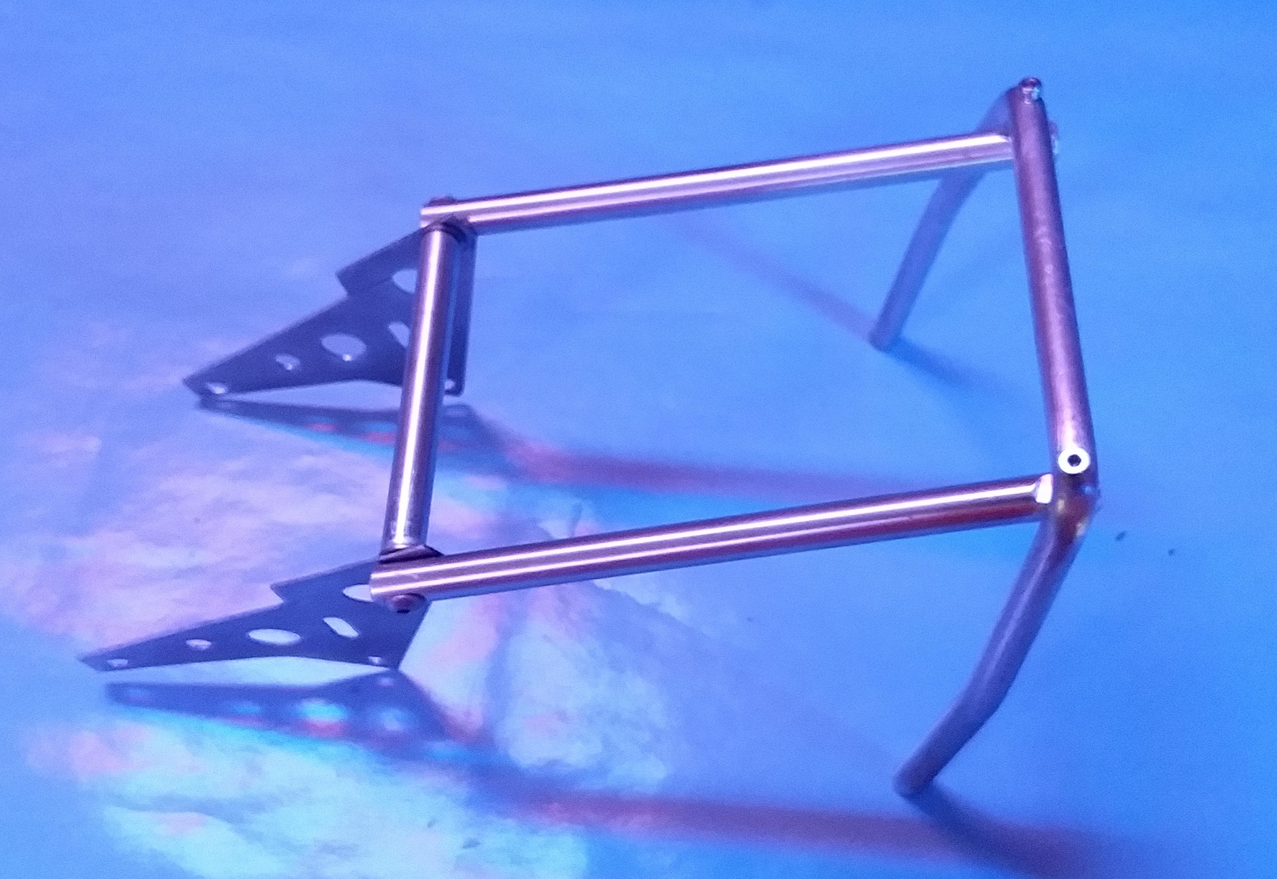

Post by coxbros1 »
all had to made except the bent roll bar

Rear frame rails
Startn to like the basket case better than the new never ran piece

I agree, nice work! So how'd you get those bent frame rails to look that good??

I heated them up with a heat gun, then hammered the bents out gently with a mechanics hammer on a the flat area on a shop vice. Then i put them on a straight edge and just hand bent the remaining curve out until they were both identical. Then i took a rolock wheel to smooth any gouges out. Wet sanded with 400 grit, then rubbed them with #0000 steel wool. No compound or aluminum polish was used
