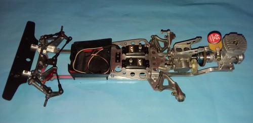

Handmade parts mounted up, just to test fit.
Still have to dismantle this pile completely

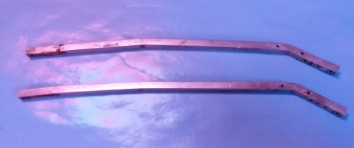

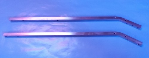

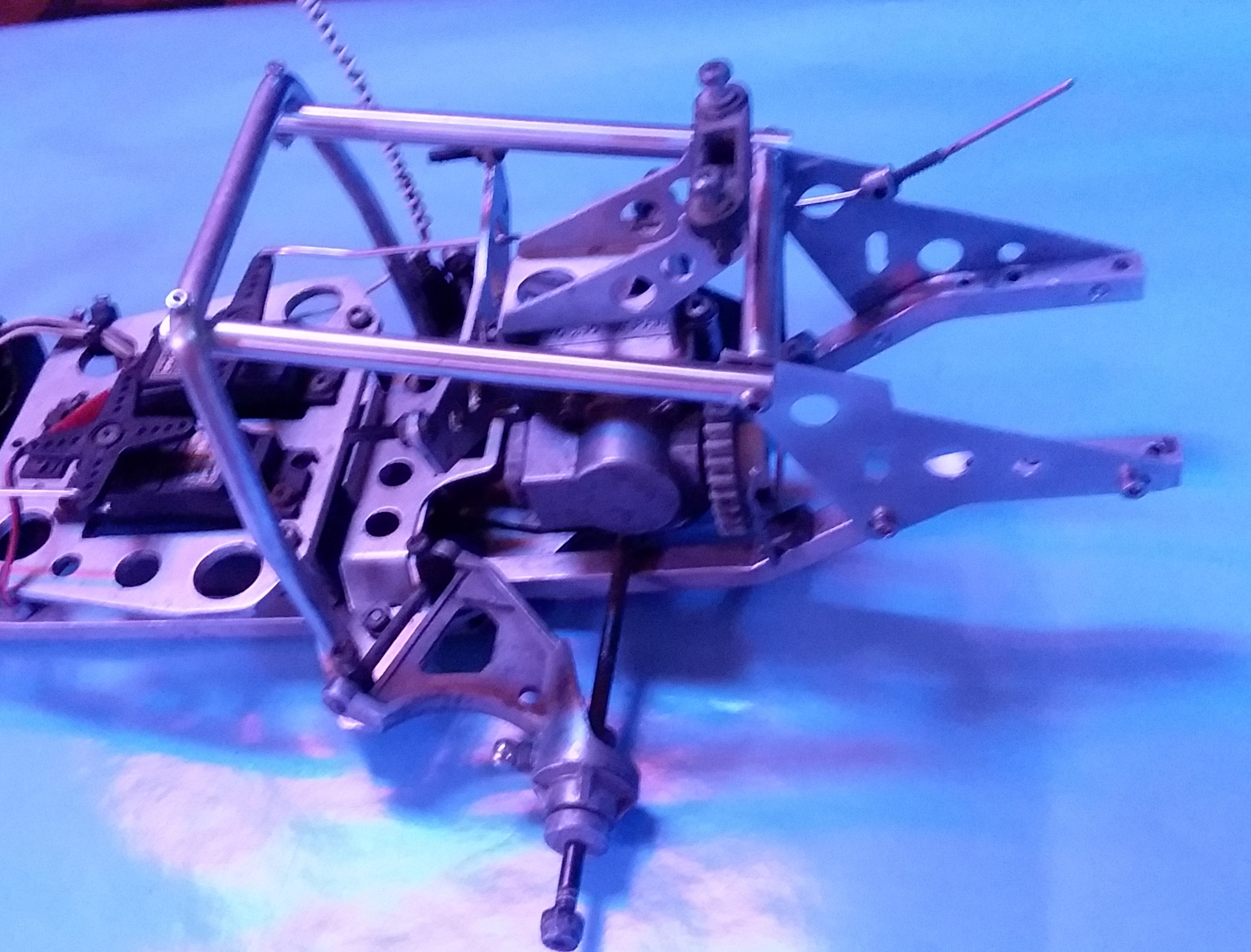

Bent frame rails
Straightened and restored

all had to made except the bent roll bar

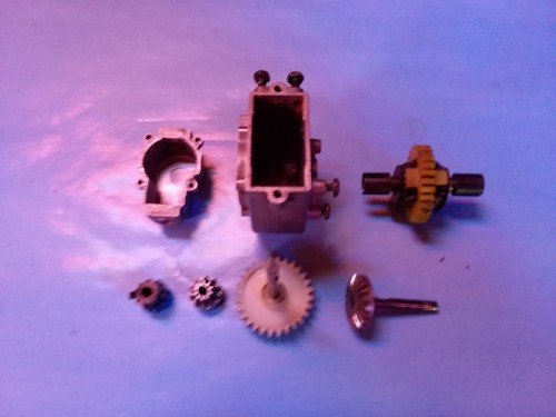

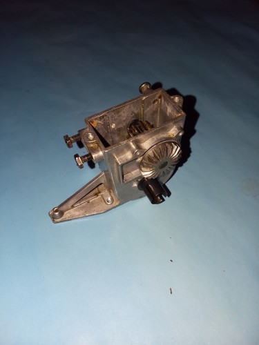

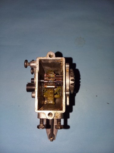

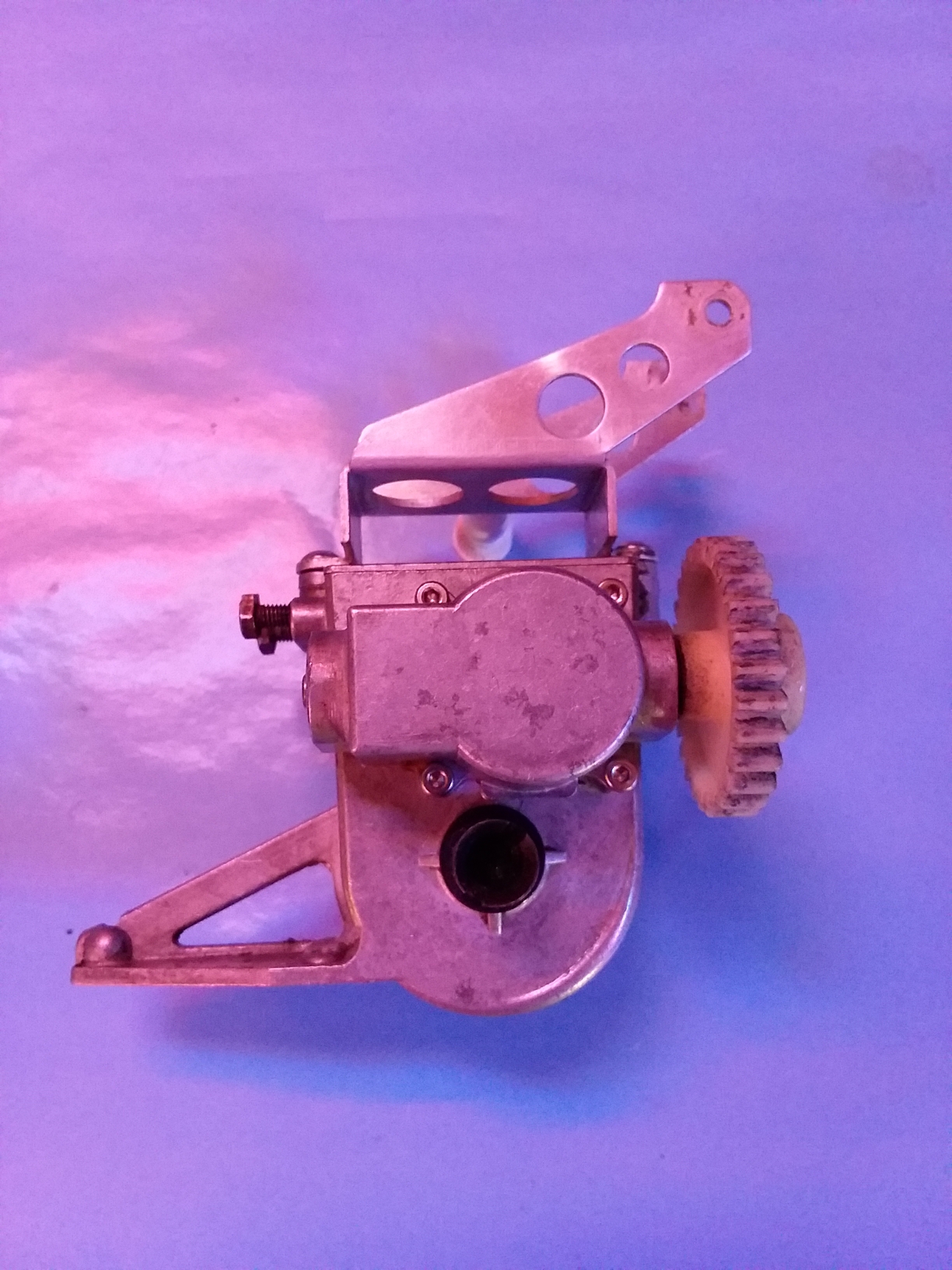

Pretty impressed with gearbox, unlike any i have worked with, the differential gears are exposed, one plastic gear inside, perfect shape, rest are metal, except the outside counter gear.
It feels like brand new now, no slop at all, turns very free

Rear frame rails
Startn to like the basket case better than the new never ran piece

I agree, nice work! So how'd you get those bent frame rails to look that good??
Matt
coxbros1
Posts: 2495
Location: Energy, Illinois
Has thanked: 2758 times
Been thanked: 2407 times
Re: Kyosho Assault Box Art Restoration
Post by coxbros1 »
I heated them up with a heat gun, then hammered the bents out gently with a mechanics hammer on a the flat area on a shop vice. Then i put them on a straight edge and just hand bent the remaining curve out until they were both identical. Then i took a rolock wheel to smooth any gouges out. Wet sanded with 400 grit, then rubbed them with #0000 steel wool. No compound or aluminum polish was used

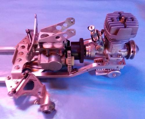

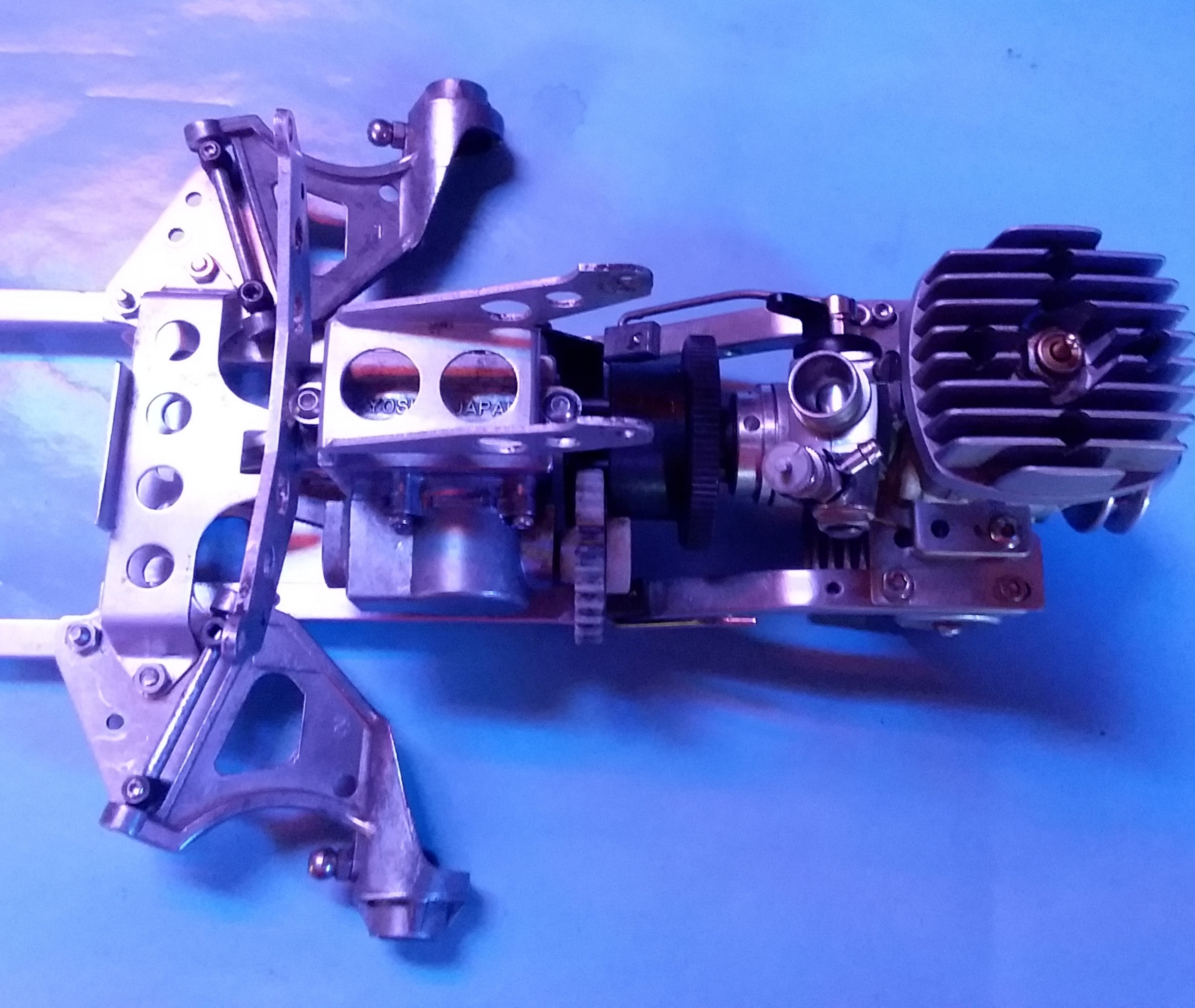

Test fitting the engine. This is actually the engine from the other car, waitn on a clutchbell for the engine for this

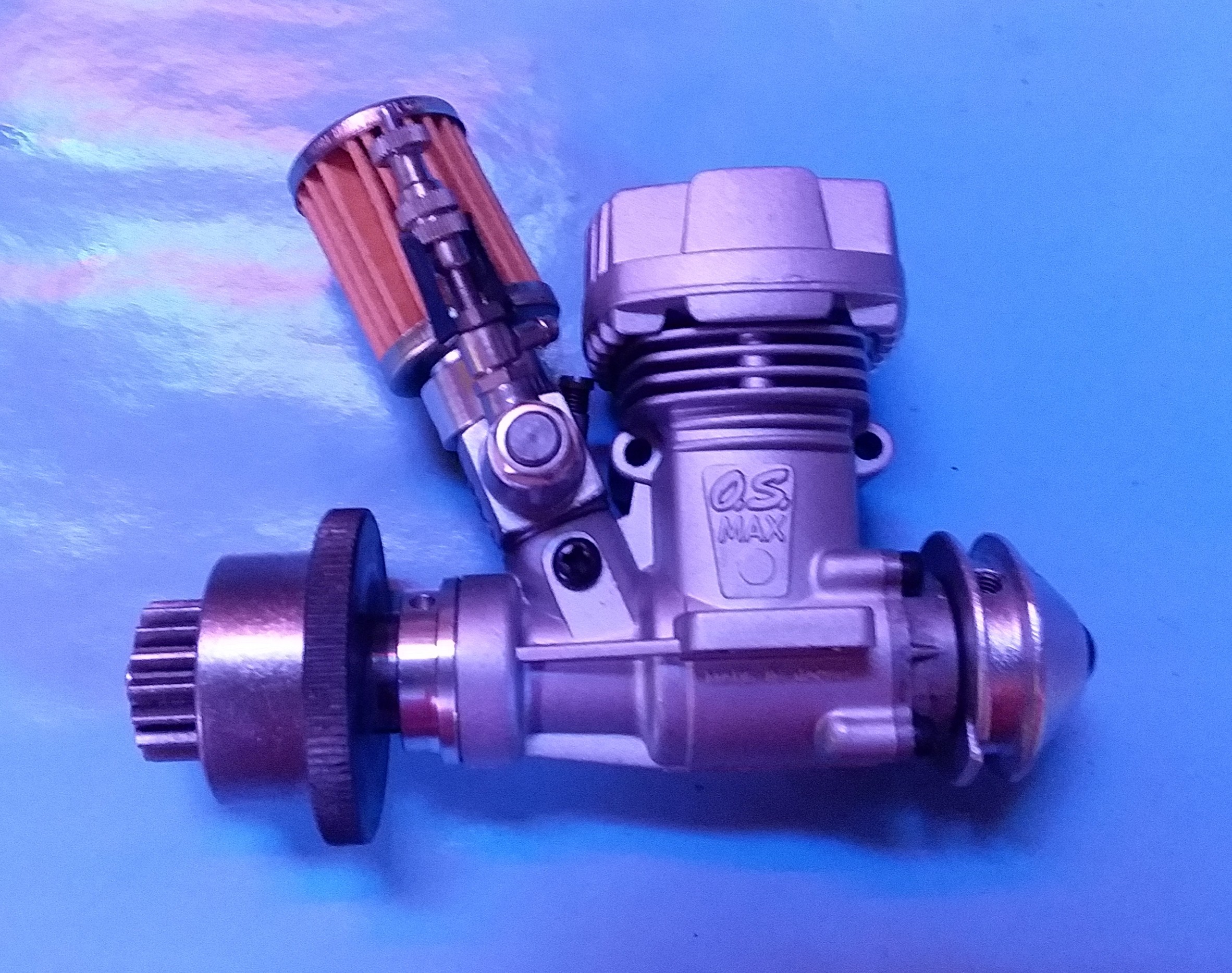

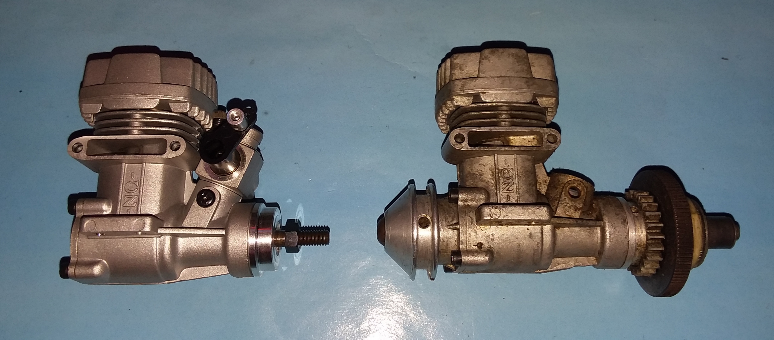

New engine i will use on left, after i put the crankshaft and cone starter from original engine on right

Post by coxbros1 »

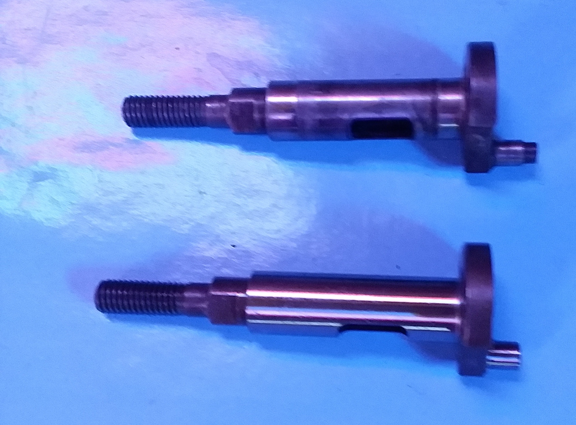

Top used crank has tit for starter i need
There it is all done with cars original crank
