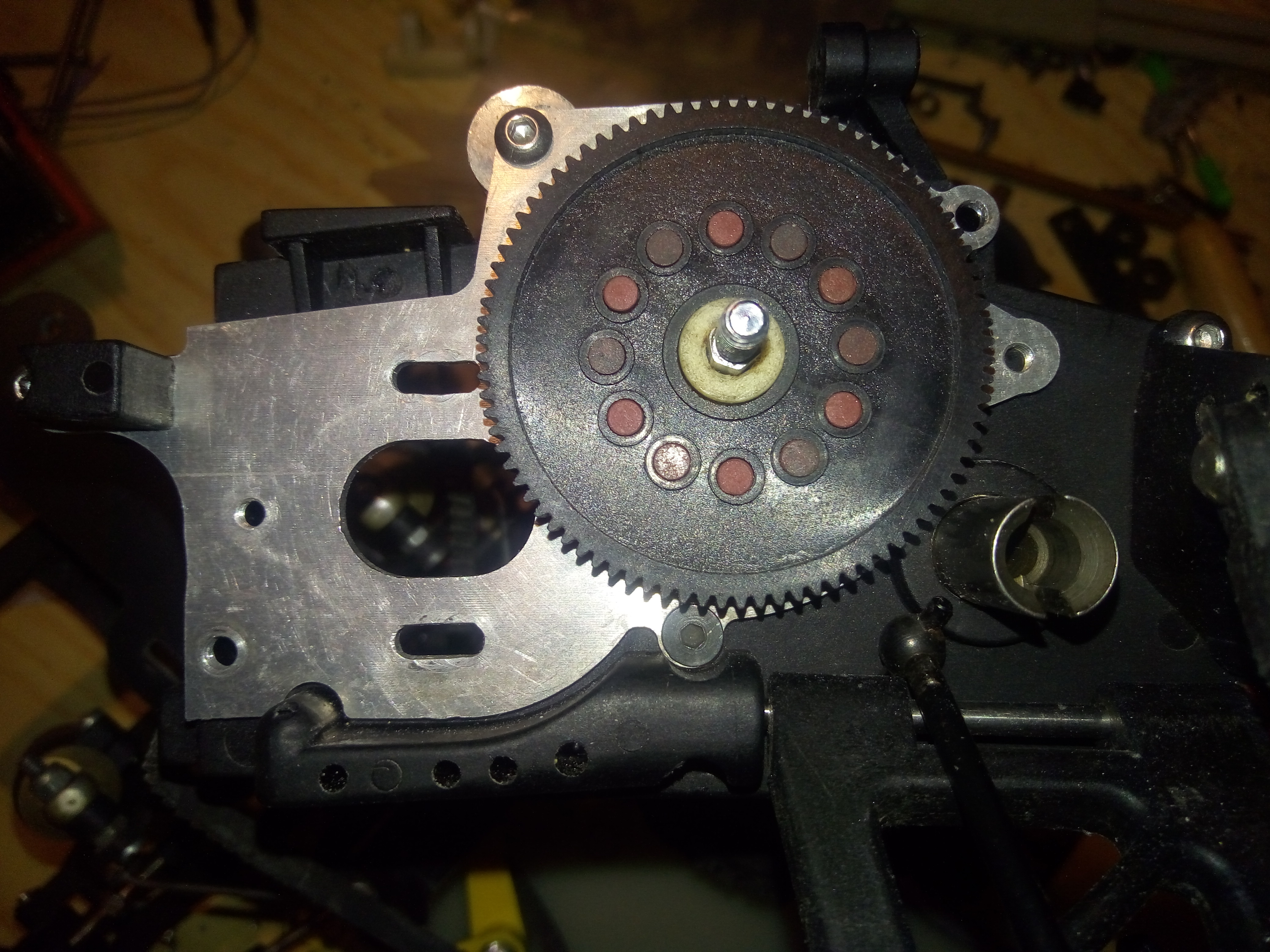

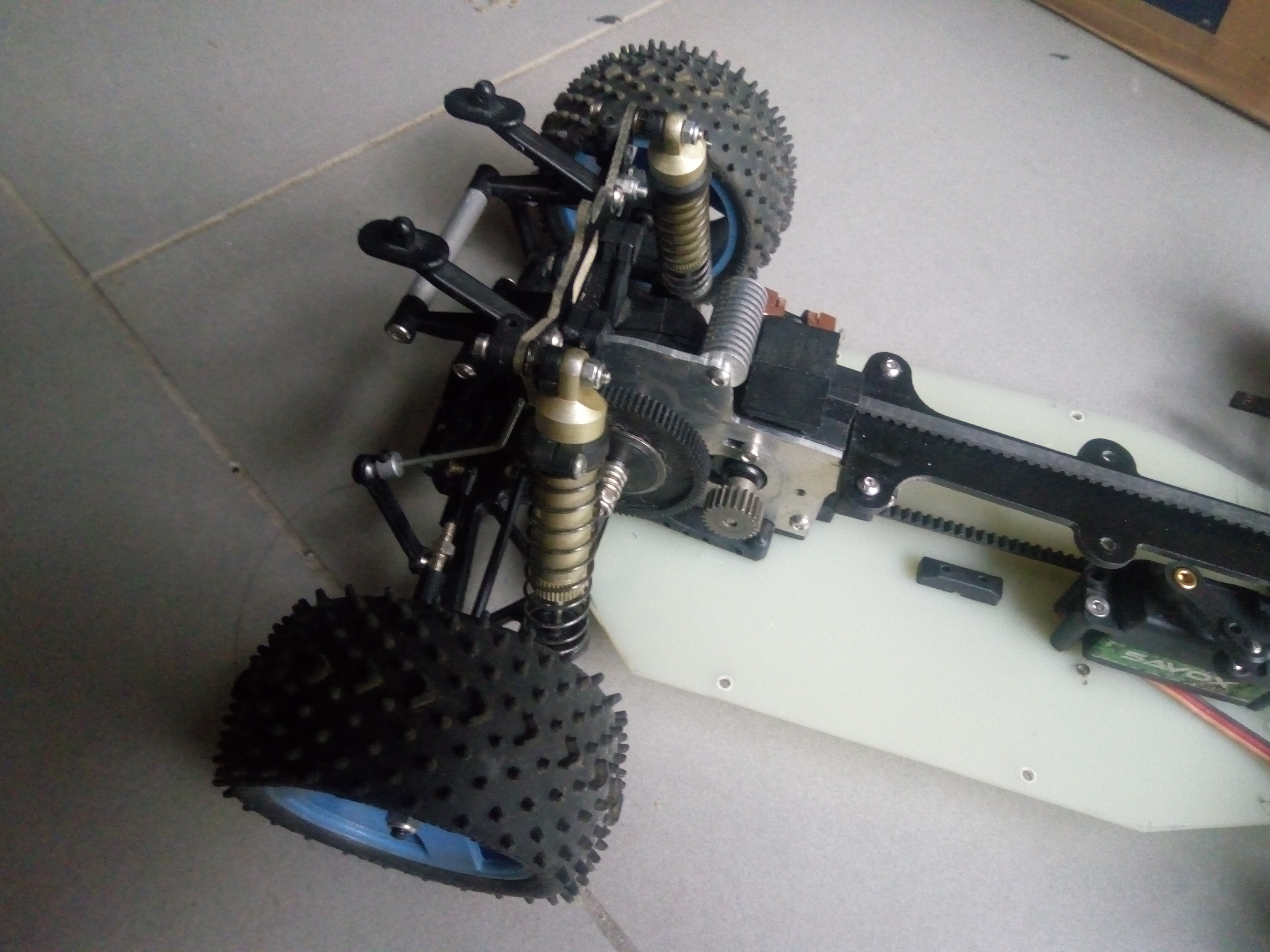

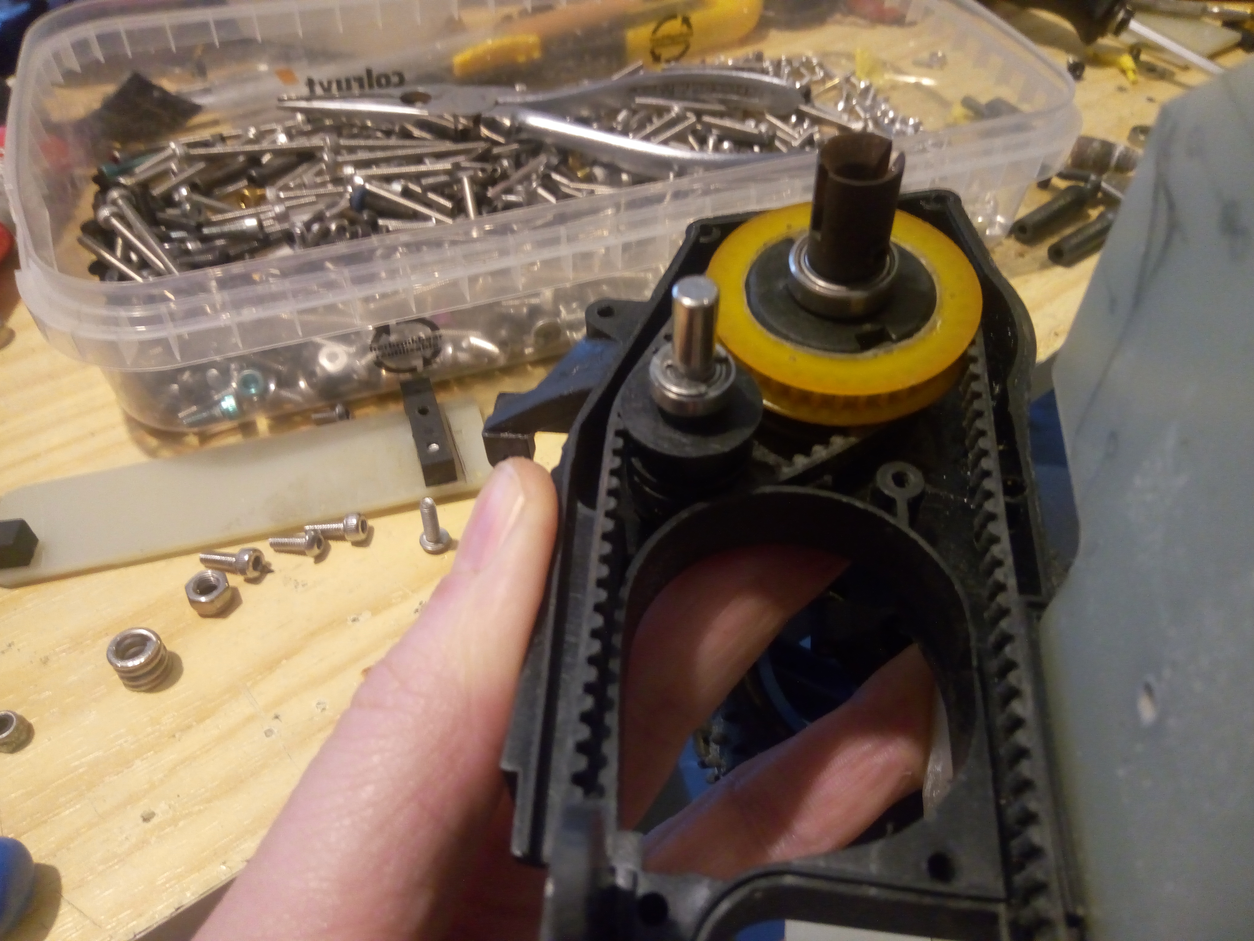

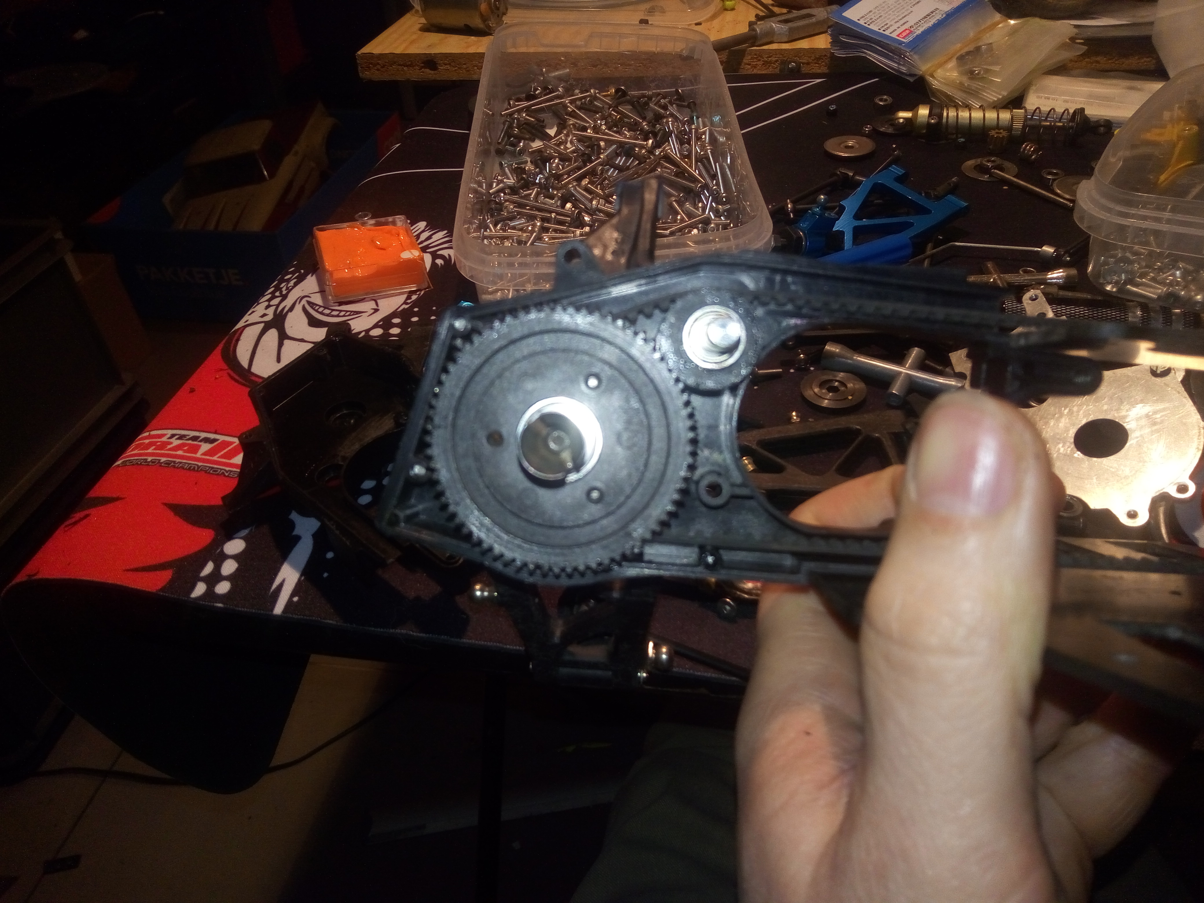

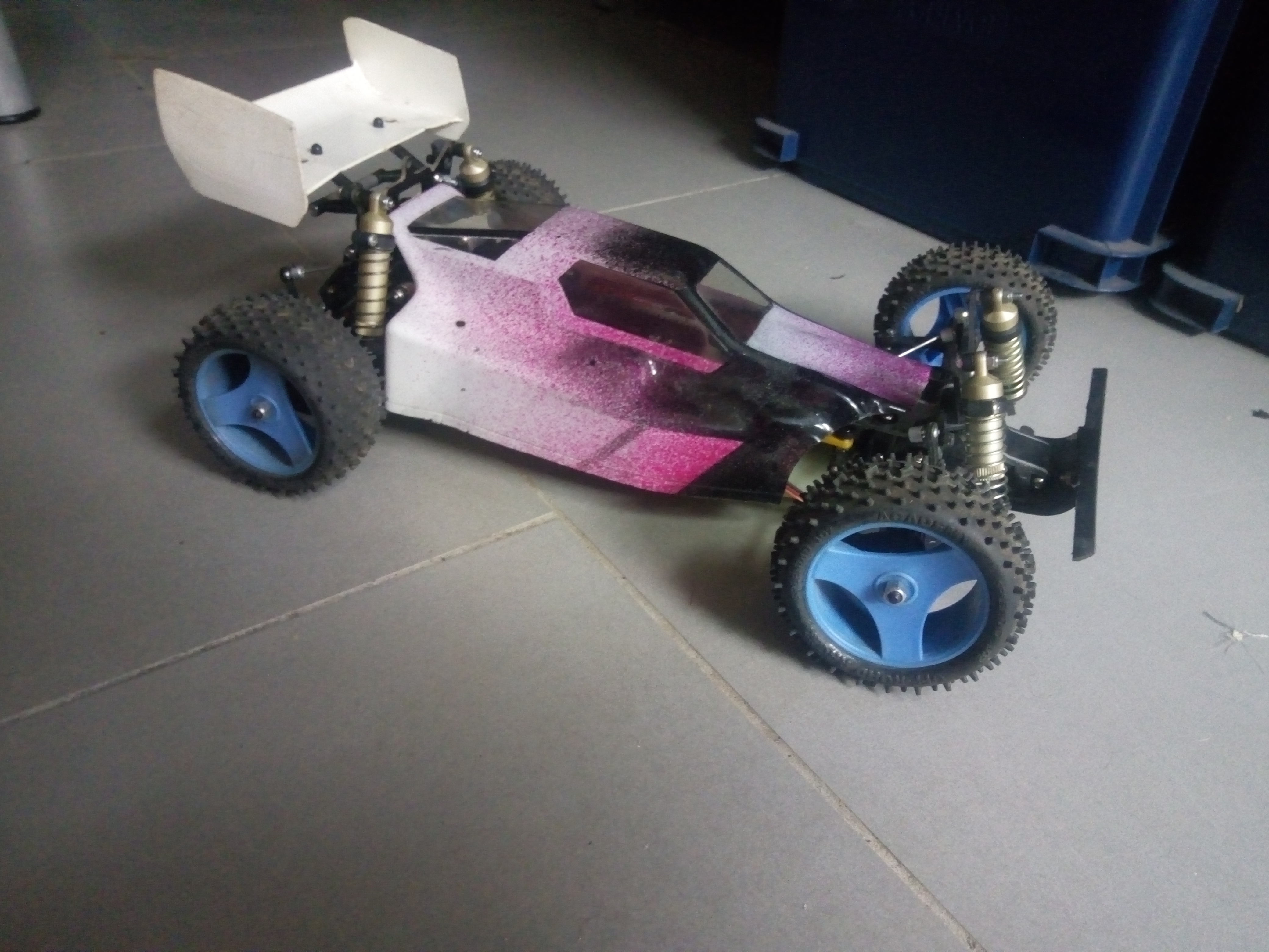

I bought this buggy from fellow member cyberfox some time ago and now plan to run it in a vintage race closeby.

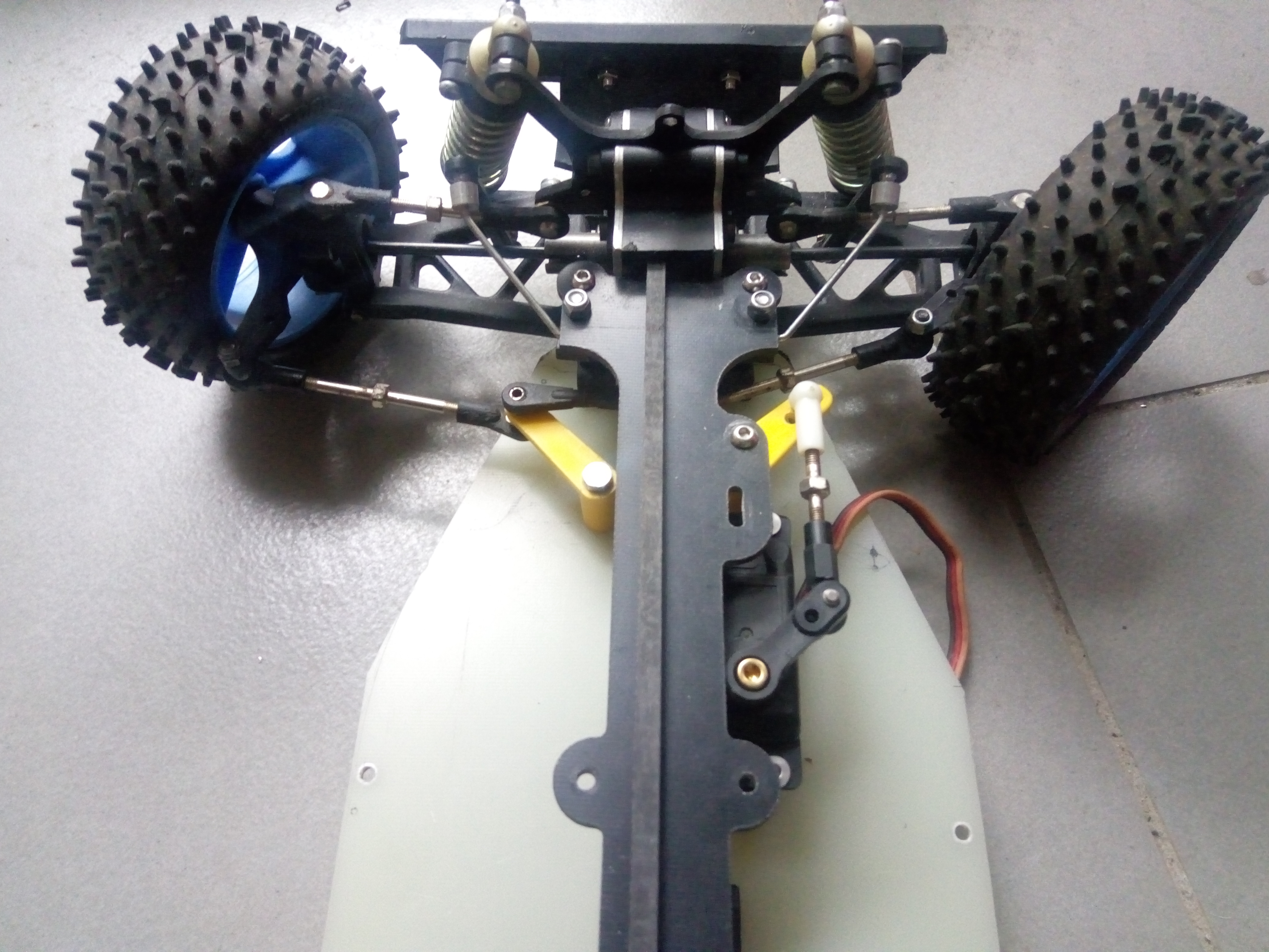

My initial plan when I bought this was to put Lazer arms on it. I tried, and Tamiya df-03, and Academy wyvern. None worked out.
I did find the conic hexes to squeeze the bearings, so I replced them with academy u-j's which use crosspins.

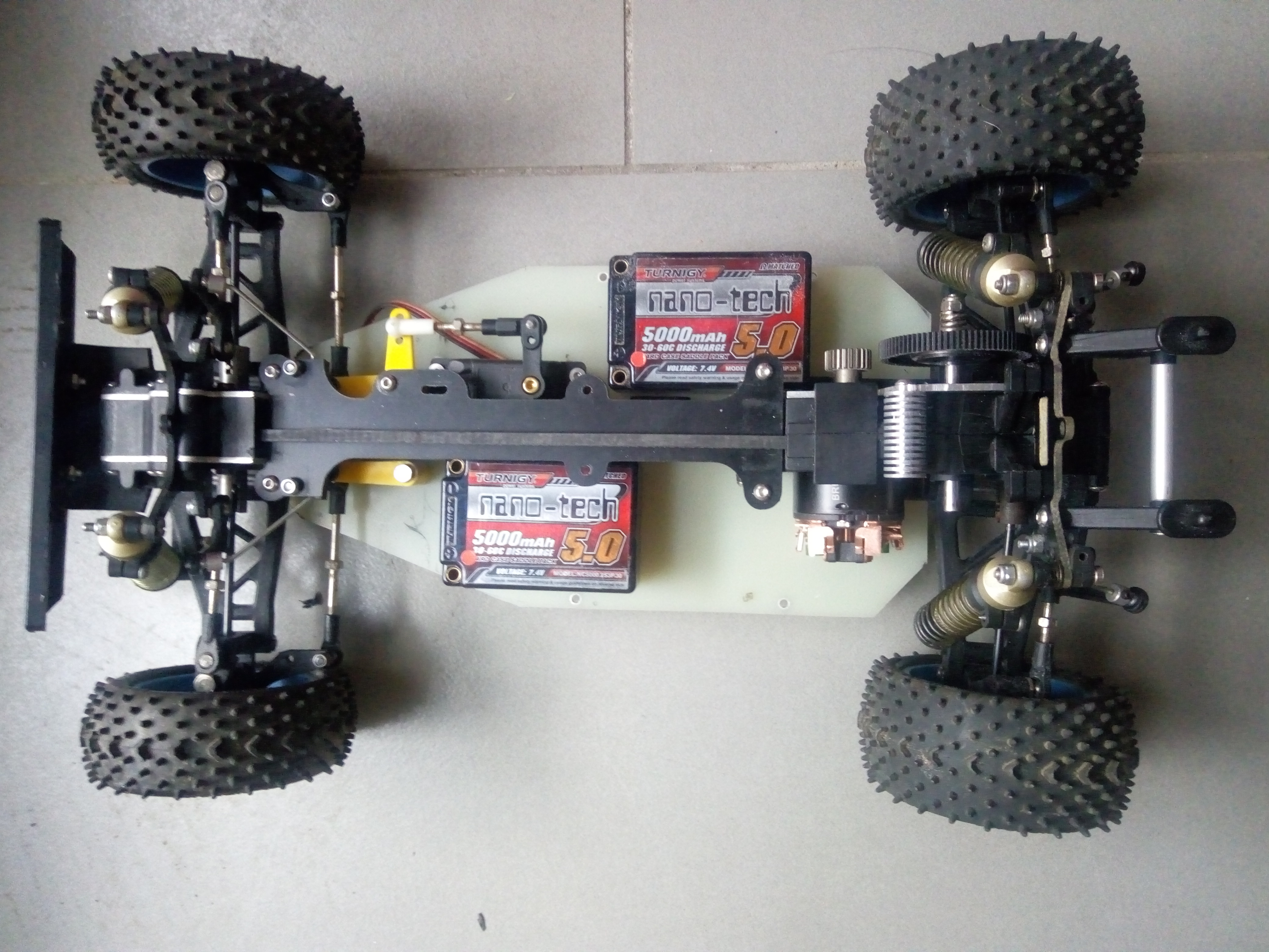

I also made a new lower chassis, with more space for the lipo saddle packs and electroniscs, and a new outline to match the new body shape. The original body and underpan came with the car but were painted very poorly and no one makes repro's.

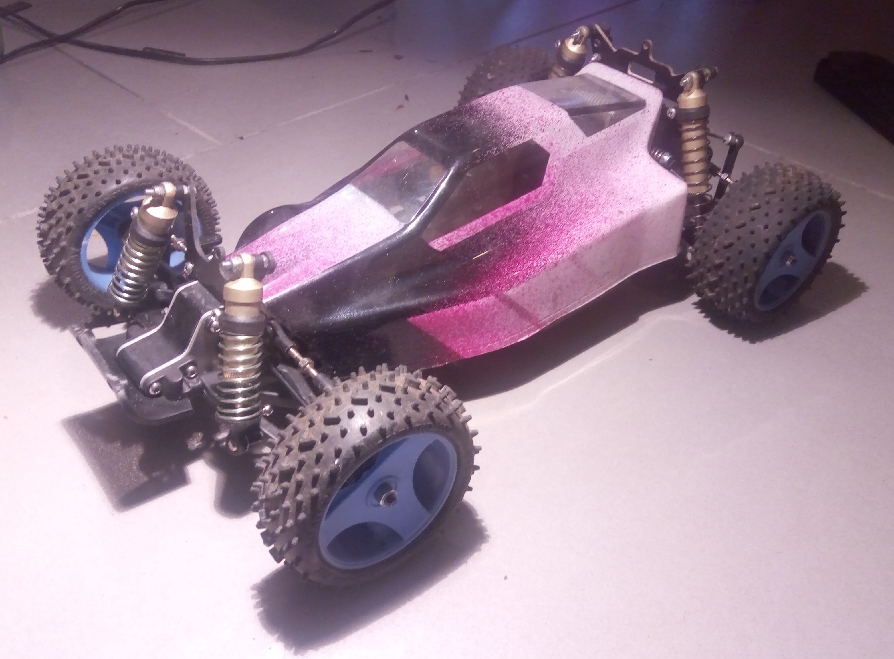

So I testfitted some of the bodies I have and decided for the xx4.
Another thing I managed: slipper!

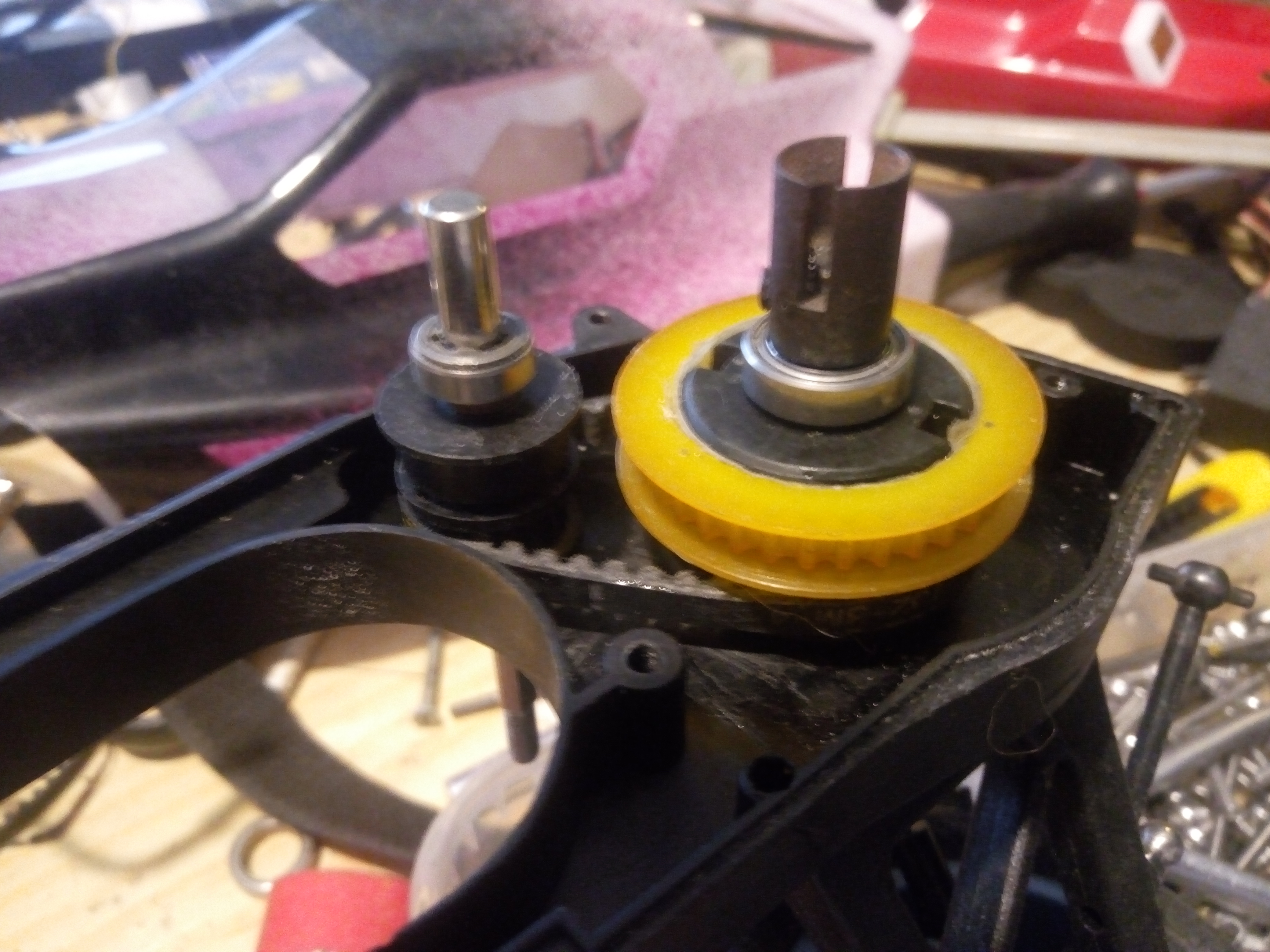

And last but not least: I replaced the stock diff. Nothing wrong with the stock one, but I put a lazer one in. Added a pulley from the yz10 and abelt and replaced topgear by a pinion pulley. So now the motor has to spin in reverse but since it's mounted opposit, well it spins the correct way compared to winning cars like the 870 now.

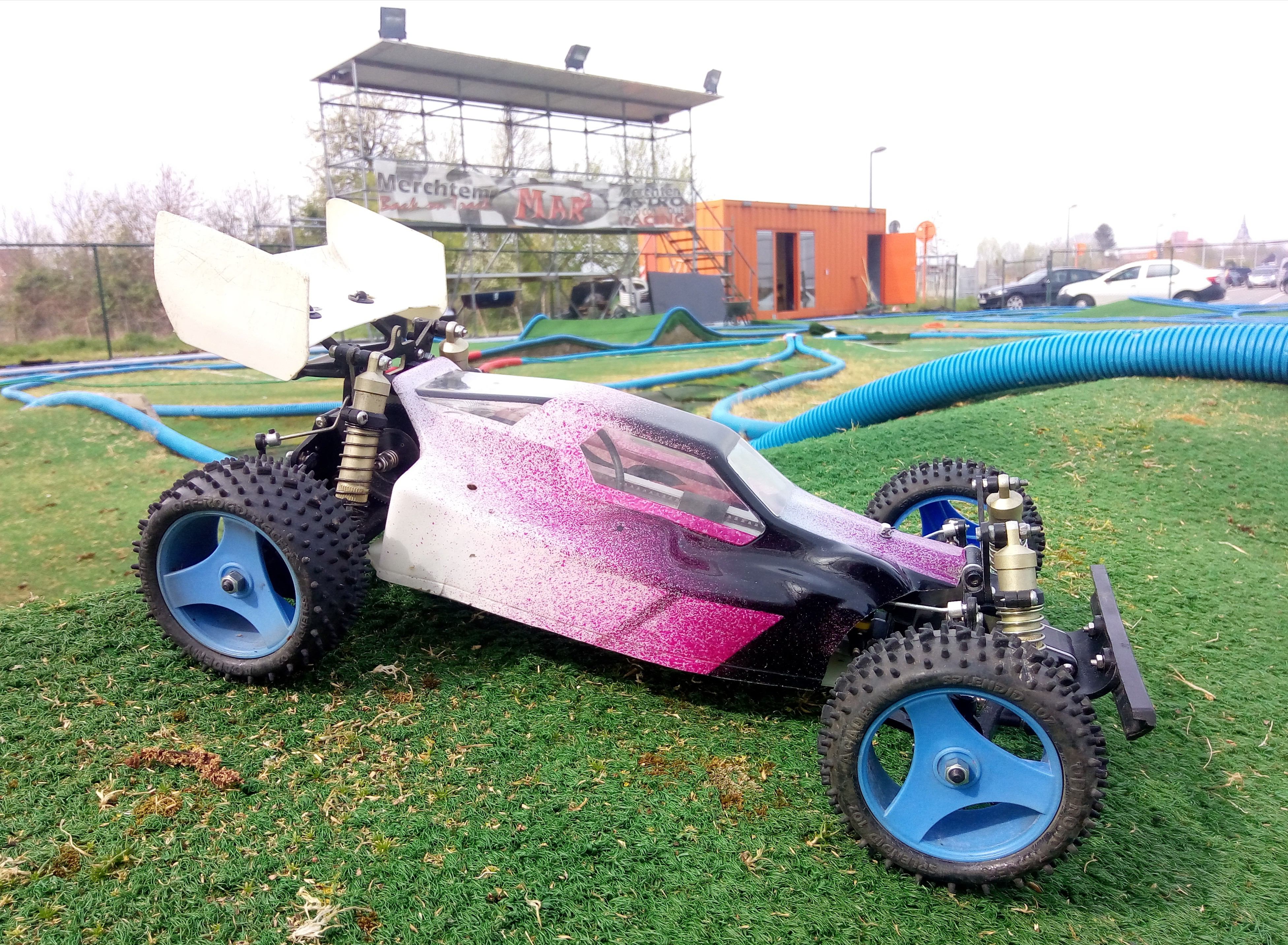

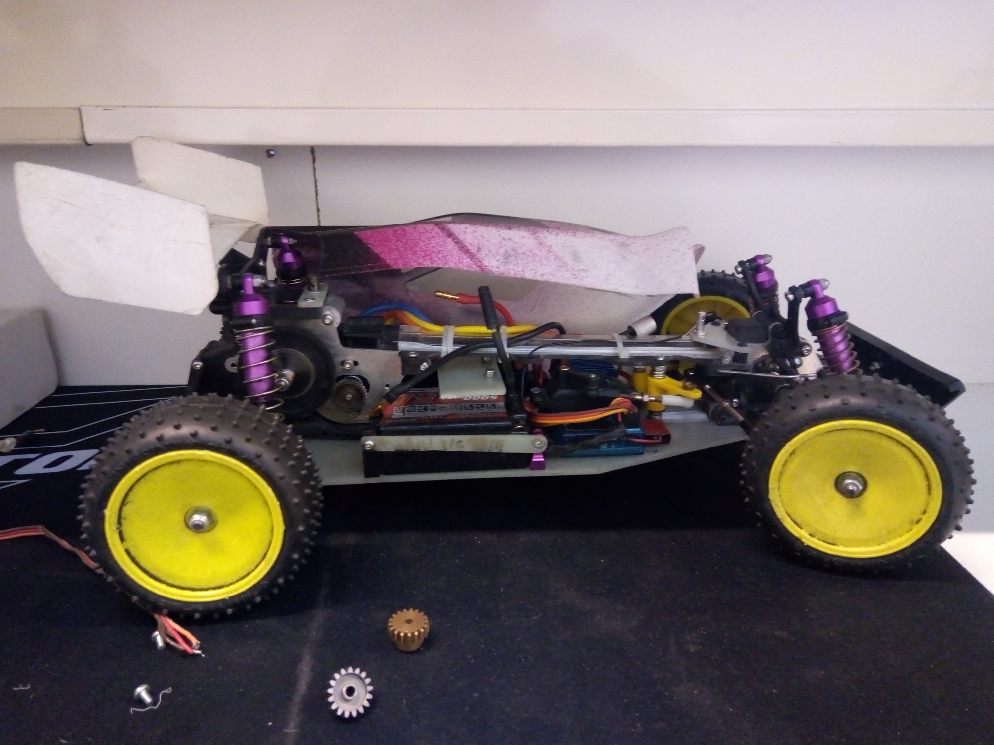

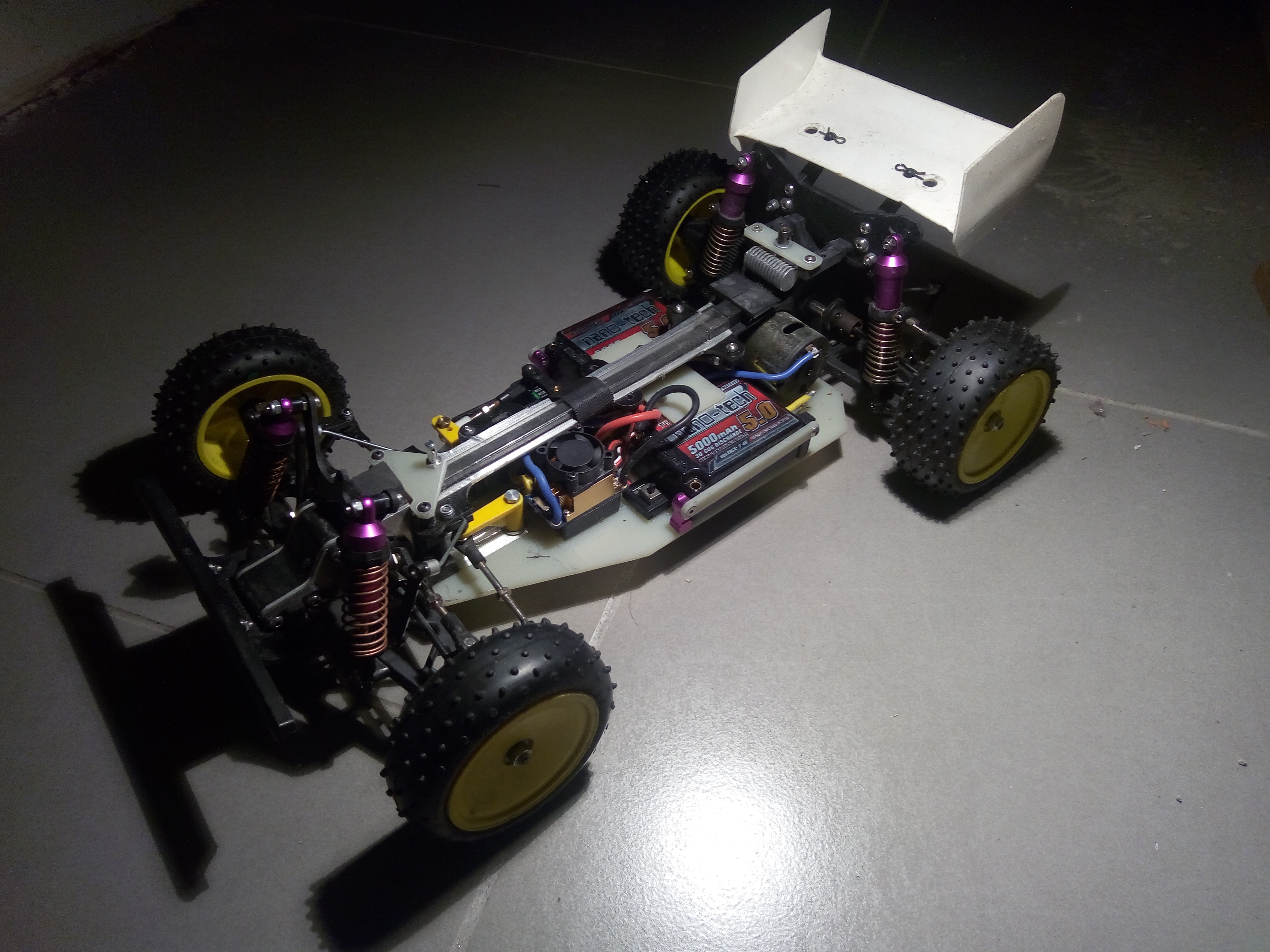

A bit more work done today: better wing mount, new rear shock tower and purple shocks from Academy.
I also replaced the inner bearings of the steering knuckles. It now has 4mm thick ones instead of 5mm. This way I hope the academy uj's won't bend again.
Oh, almost forgot: an extra bodymount was added to keep the rear end of the body well centered and away from the spur teeth.

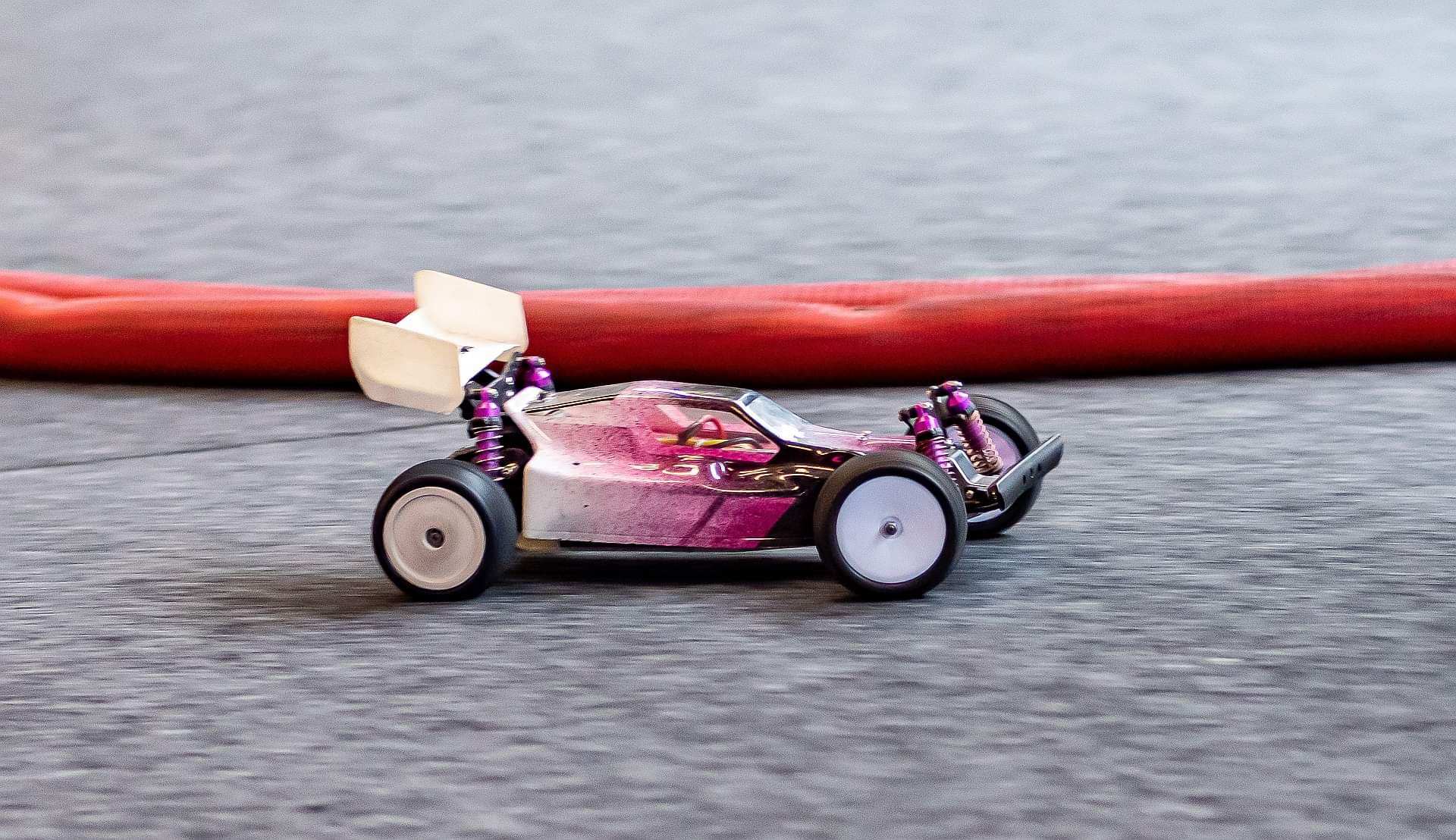

Small update: I ran the car last weekend at the 2020 vintage euro masters in Sittard (NL)
Paired it up with a 21.5t brushless motor and 35t motorpinion.
Unfortunately I broke the front shocktower: crashing into an oncoming optima mid as I landed on the wrong lane from a missed jump.
Thanks to Ralph Loch for the lovely action picture.
