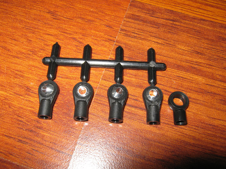

Today I found another source for the body mounts. The proper shock ends are Kyosho part # W-5015, came across them at the same shop.Mr. ED wrote:After seeing the pics, I don't think it should be too hard working around those rare body mounts.
Same for the long shock ends. You could just chop them to the right length.

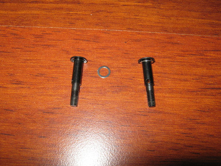

Miniature update:
Originally I had planned to use some PureTen Alpha wheel axes for the rear wheels, but I decided to use the proper Mantis wheel axles:
Parts: And assembled: I might replace the stock plastic hexes by aluminium ones, still have to think a bit about that.

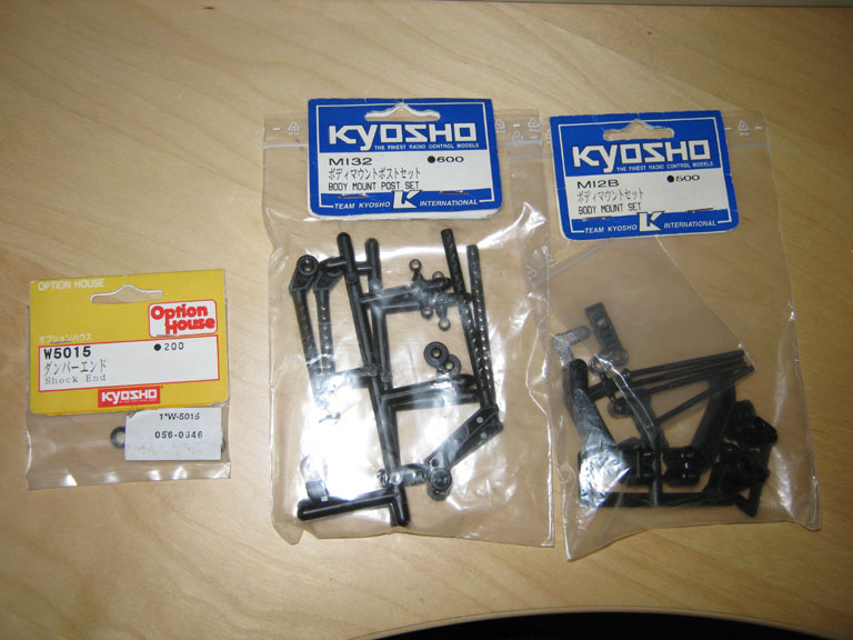

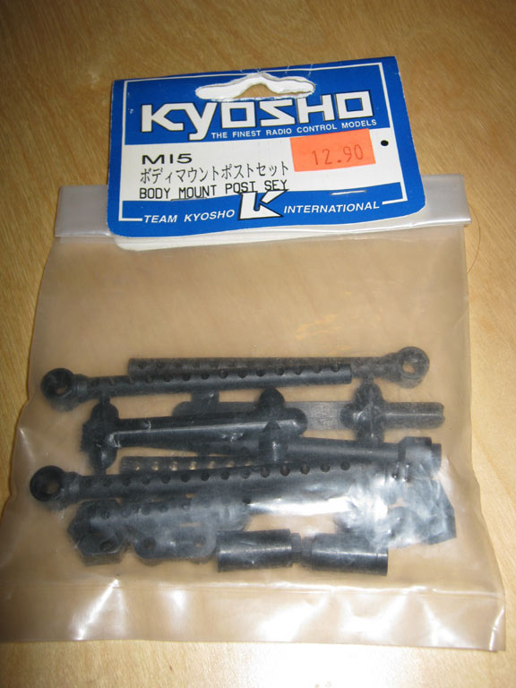

My alternate source for the body mounts worked out fine, after a small scare because Ebay.com seemed to behave a bit strangely with items only available on Ebay.de. The body mounts in the picture below are actually for the Mantis Mini, and move the correct position of the mount holes in the body by 0.5 cm:
Also shown in the picture are the correct eyelets for the shocks, and the Mantis body mount mounts, which I ordered just in case I needed the alternate parts I didn't have yet. Turns out that isn't the case: I can use the front Mantis Mini mounts at the back in combination with the body I want to use, and will attach other front body mounts to the bumper, so they can also keep the foam bumper that I want to add in place.
As for the MI-5 body mounts I had ordered at a Canadian hobby shop, nothing yet (and also a worrying lack of communication) - scrap that, the parts just turned up expertly packed and in good condition in my mailbox today (August 19th). Still, it took them two weeks to ship (ordered July 31st, sent August 14th) and a shipping confirmation or reply to my email would have been nice...bit confused here on whether to recommend them or not
So now I have a choice of body mounts. Mi-5 includes body posts for use on the bumper, too.

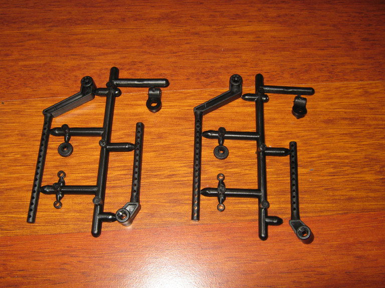

Re: Kyosho Mantis EP FWD build

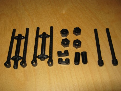

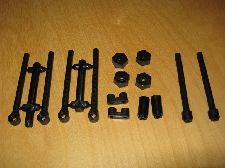

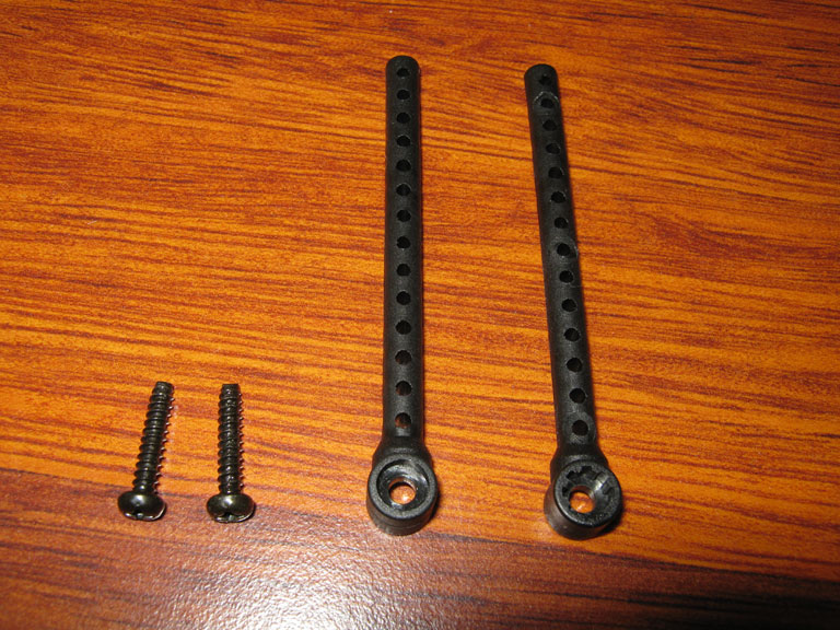

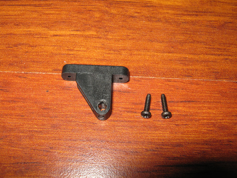

So, the Mi-5 body mounts look like this:
They also include the servo mounts and the wheel hexes, which are quite wide (6 mm!).
These are the MI-2B body mount mounts:
And these are the MI-32 body mounts:
Comparing the MI-5 mounts to the MI-32 body mounts shows there are some other differences besides the location of the holes in the body.
MI-32 also places the body posts further apart.

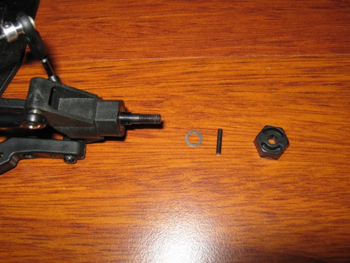

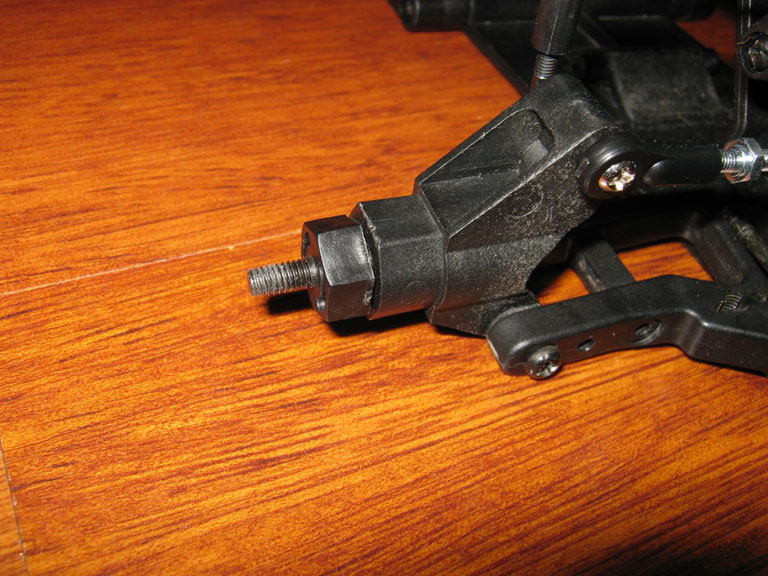

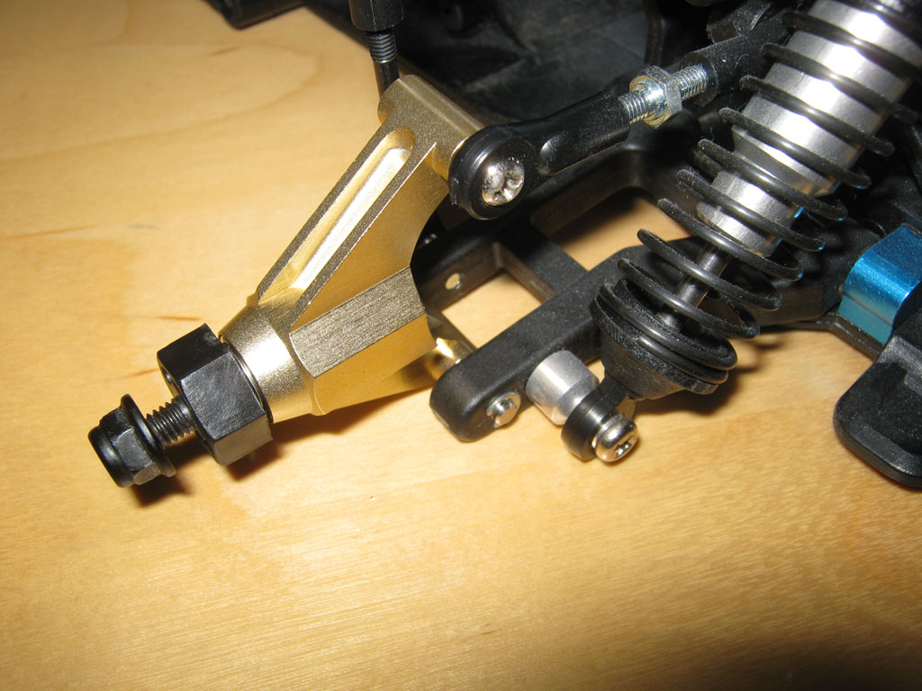

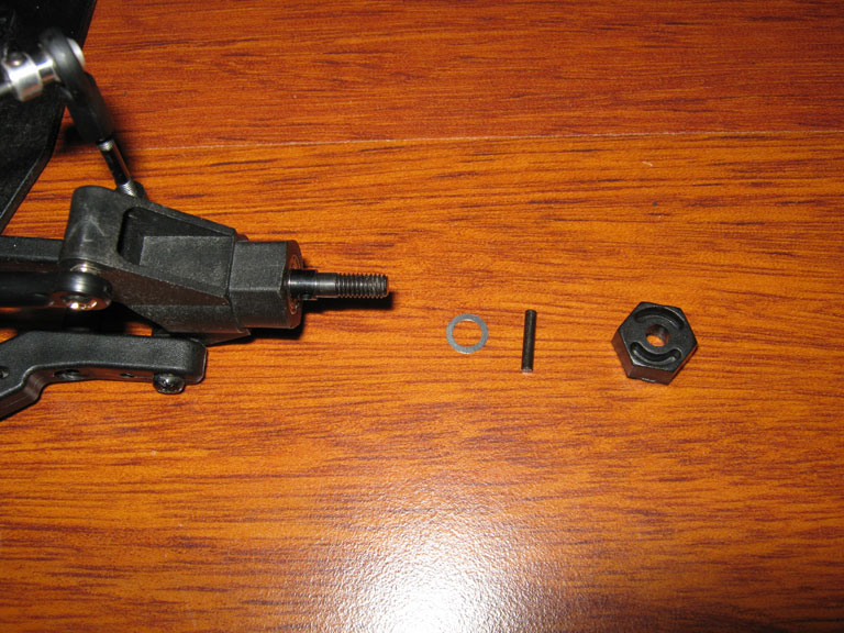

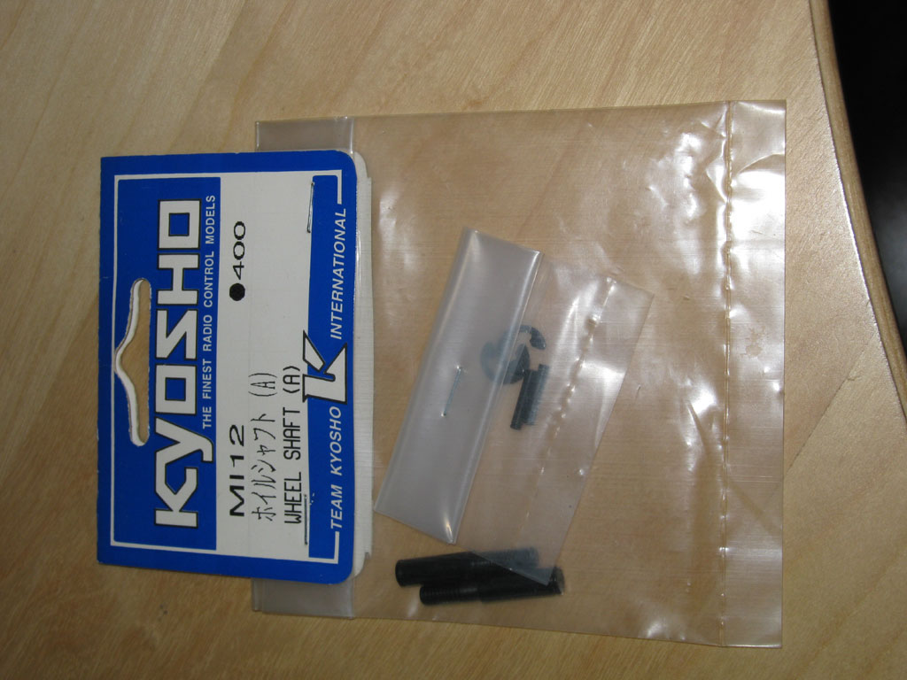

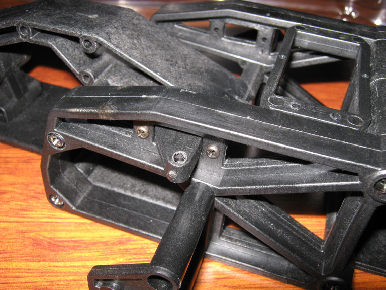

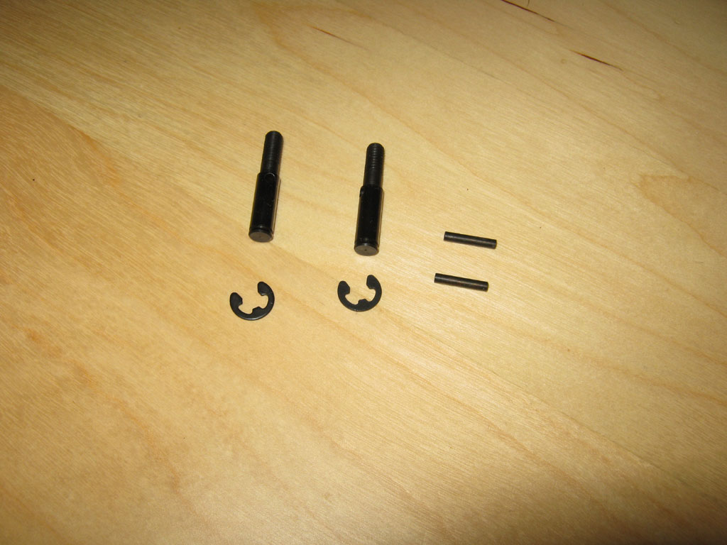

I decided to first install the rear axles. With the hex installed, these had quite a bit of side-to-side play, so I added a 0.3 mm thick shim on the inside:
The outside takes a 0.2 mm shim:
Assembled:
The hex fits quite snugly and doesn't fall off easily.

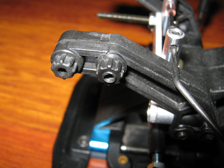

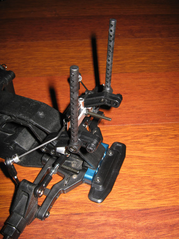

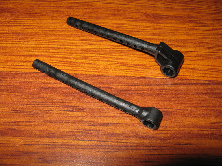

Then it's time to install the rear body posts (MI-5):
You need to use a screw with a small head, unlike Kyosho's usual wide-head screws.

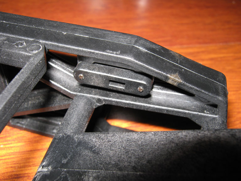

Close-up of the attachment point on the rear body mount mounts:
I had to replace the rear body mount mounts as one was mismolded and it turned out to be impossible to install the body post.
Assembled:

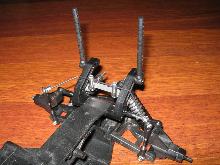

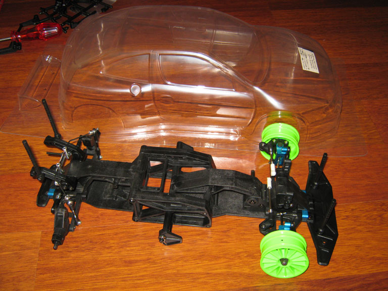

Rear body mounts installed:
And this is a mock-up of what I have in mind:
Body = Kyosho's rendition of the Renault Maxi Megane, a rally game car that was popular back then.
However, I'm not sure I will be able to use the bumper-mounted front mounts without using the extension parts - they might just be too low. The problem is that using the extension parts makes it impossible to use the body mounts to hold down the foam bumper, unless I modify the parts. On the other hand, I'd like to avoid using the regular front body mounts, as I would have to cut those off just above the servo (seems a waste...).

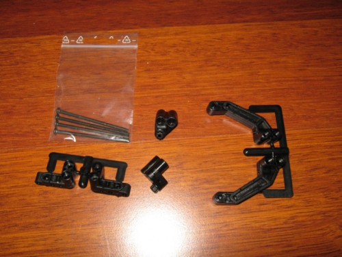

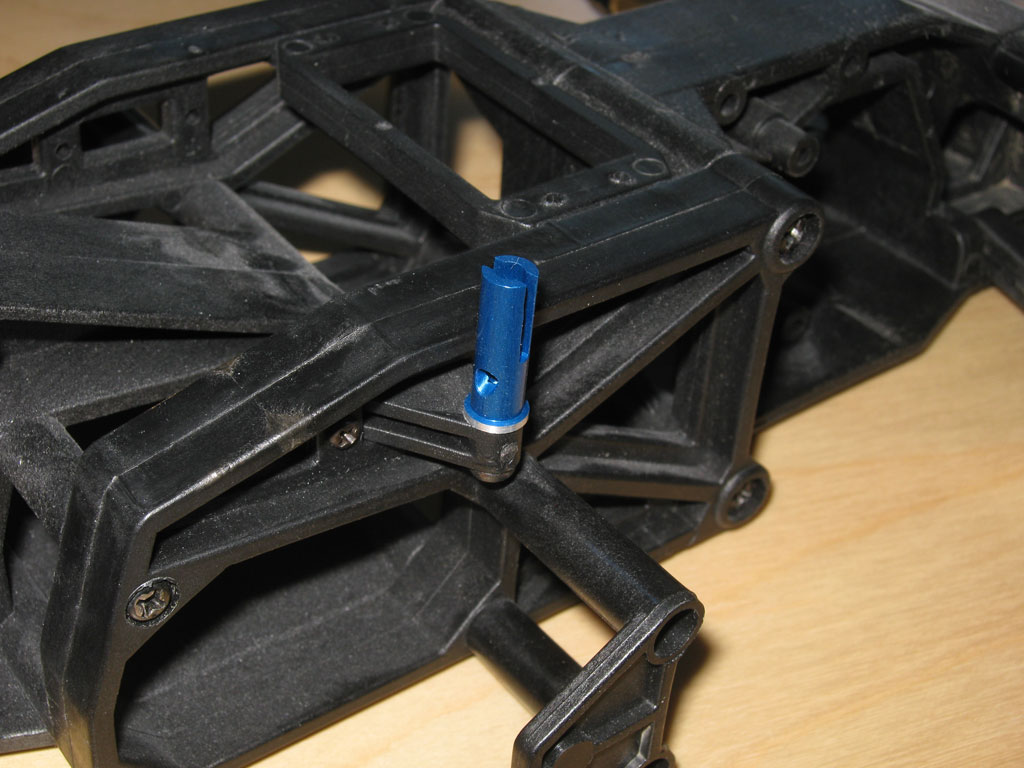

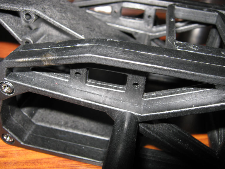

I then installed the mount for the antenna tube. Parts:
It slots into one of the slots available for the ESC/receiver switch:

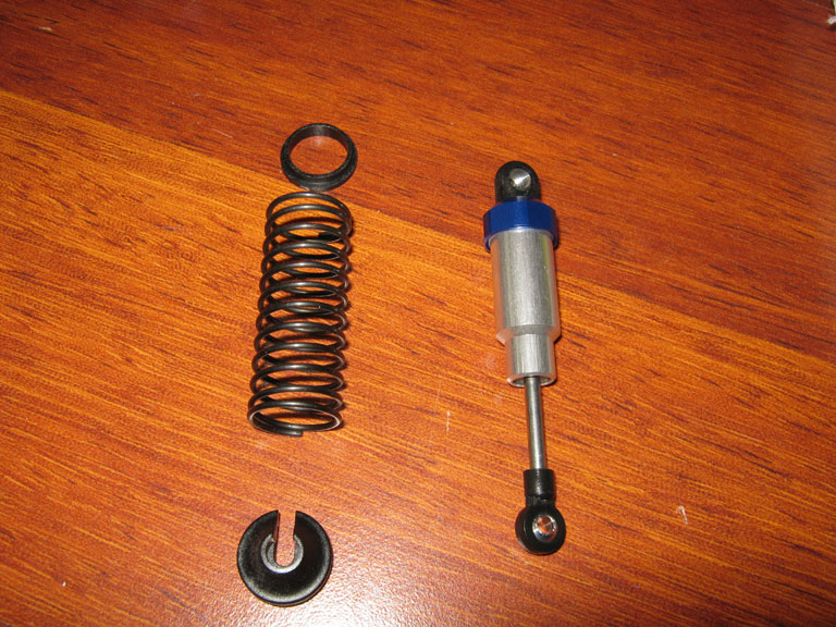

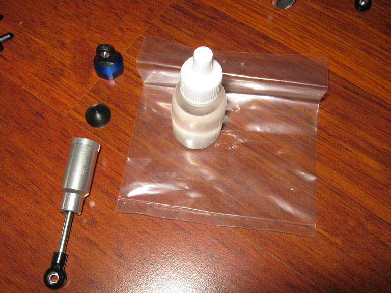

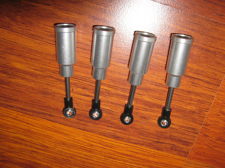

Then I decided to finish the rear end by adding the shocks. W-5015 ball end next to the shorter-but-still-too-long ball ends I wanted to use:
Added to shocks, together with aluminium balls:
Shock parts needed for filling shocks, together with 300WT oil included with shocks:
One perfectly bouncy shock + spring and plastic spring perches:
I was a bit worried because it's been a while since I (re)build a shock, but they turned out fine and I didn't make a mess.

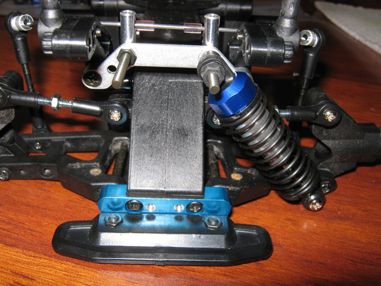

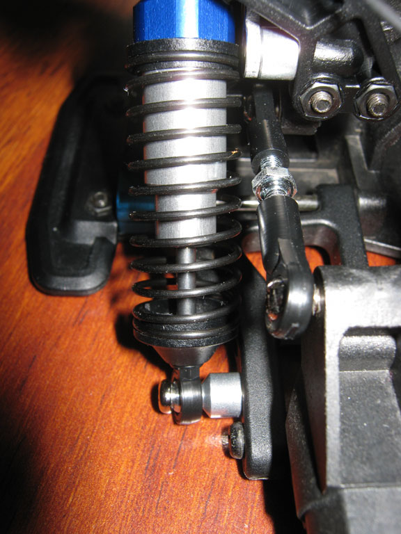

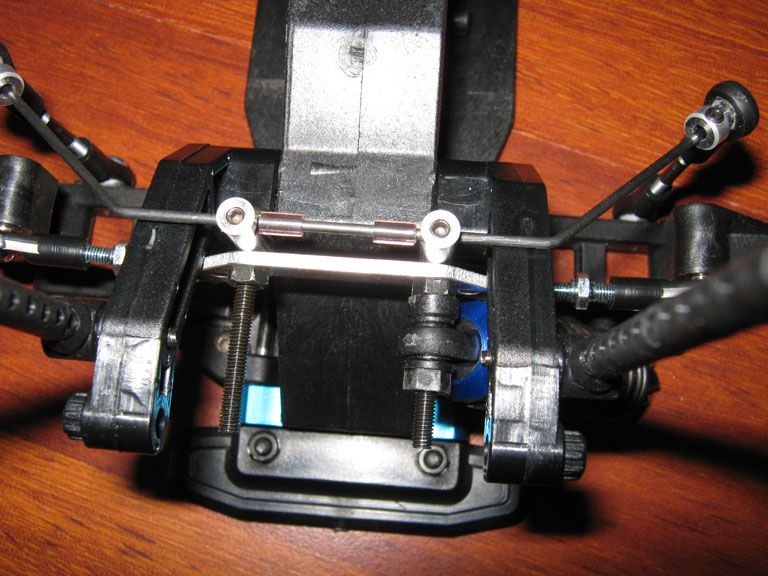

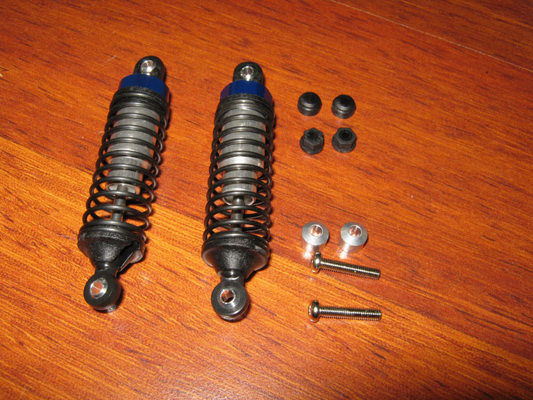

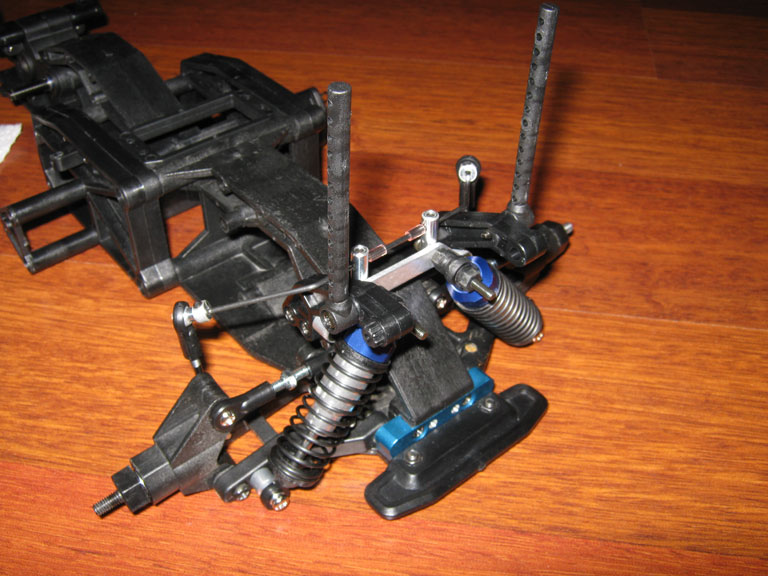

Both rear shocks and the hardware required to install them:
One rear shock installed:
The setscrew for adjusting ride height is located right below the shock and is very difficult to access once the shock is installed.
Here's how it attaches at the top (of course the screw holding both the shock and the swing bar got loose when I tried to tighten down the nylon nut for the shock...):
And here's how it attaches at the bottom:
The shock just clears the shock tower and the suspension arm.
Anyway, rear end complete
It's weird how just attaching the shocks makes the car look much less like a beginner's car...

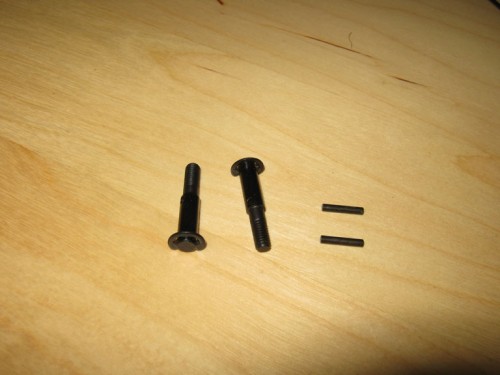

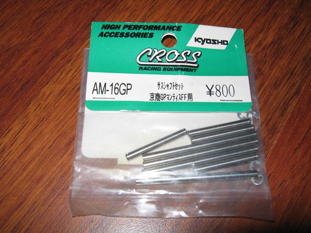

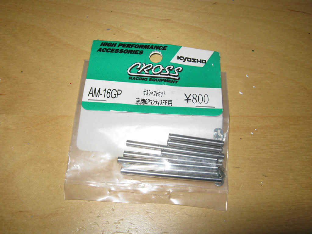

Picked up this Cross hinge pin set to replace the screw pins and inner hinge pins by proper steel hinge pins:

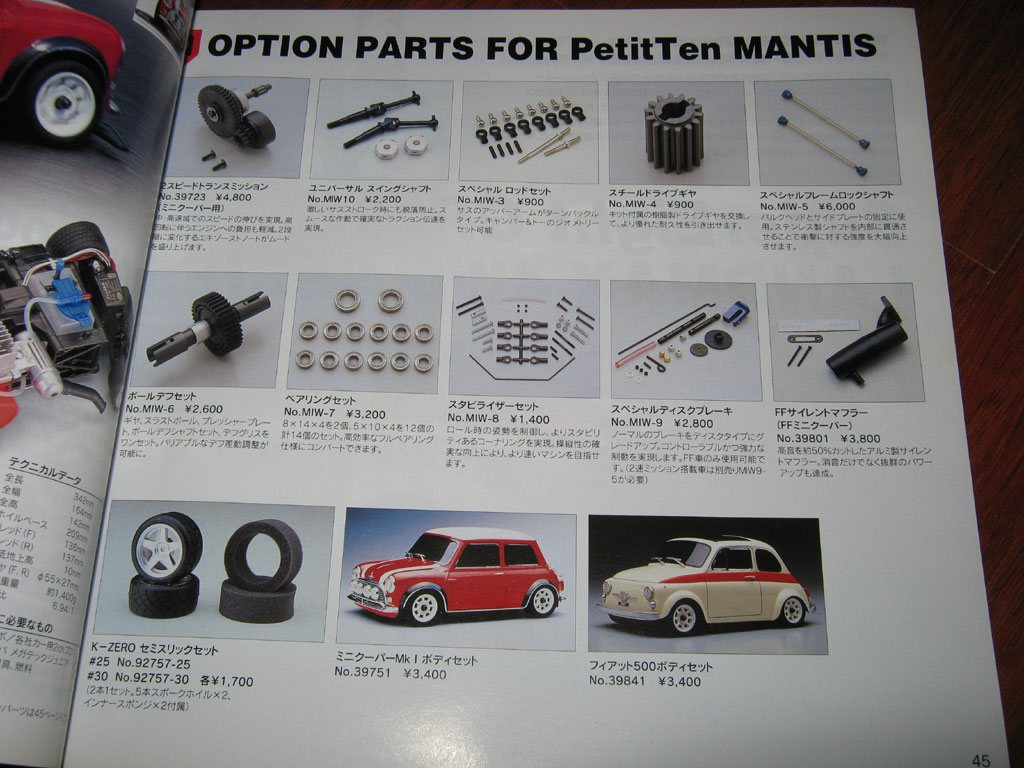

Also picked up a Japanese Kyosho catalogue that showcases the Mantis Mini (Mini and Fiat 600):
...and many of the hop-ups:
MIW-5 Special rod set is, as I suspected, a stiffener rod set for holding the chassis halves together, but the price (6,000 yen - about 60 bucks) is absolutely outrageous. Seems overly expensive, even if the rods were made out of titanium (which I don't know). No wonder that option can't be found...

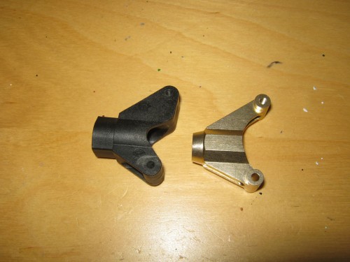

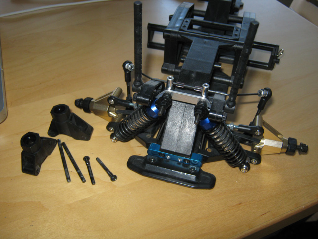

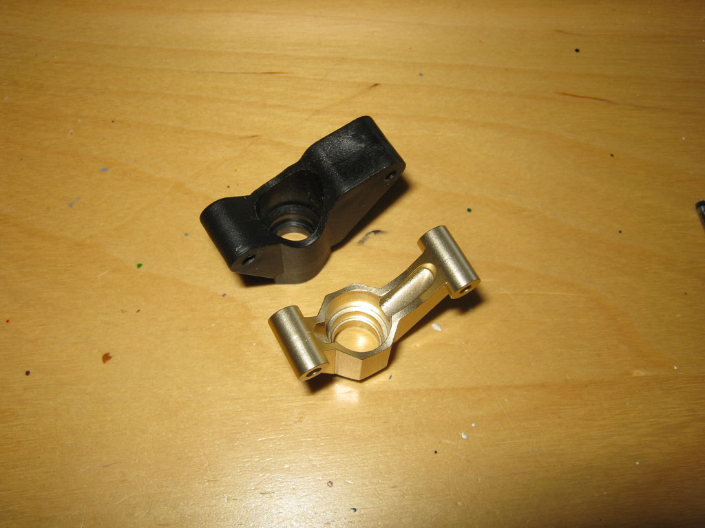

Somewhere last year I bought these rear uprights:
Now that I finally have some time to do something hobby-related about a year of crazy upstairs neighbour antics, packing, moving, and unpacking, I figured I'd do something to my Mantis and make some use of these too:

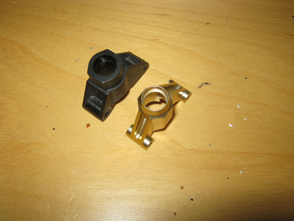

So comparison with the original uprights:
They are a lot less bulky and also reduce the track width by about 1.5 mm per side.

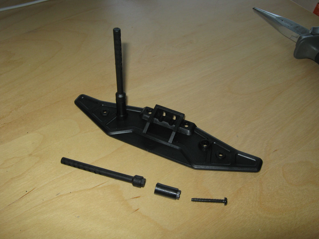

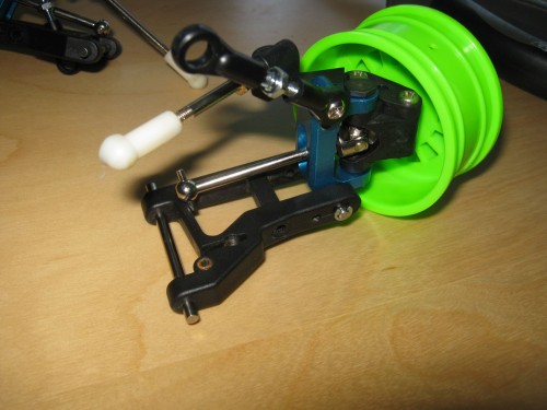

Mounting them together with the hinge pins:
And that's the rear end really done:
Also installed the hinge pins on the front:
And a better antenna mount:
And put the front body mounts on the bumper, including extension pieces.
Let's see when I'll be able to post the next update...2025?
