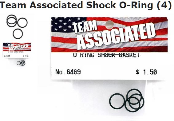

o-rings
https://rover.ebay.com/rover/0/0/0?mpre=https%3A%2F%2Fwww.ebay.com%2Fulk%2Fitm%2F152941488048
the plastic parts just try to save them and take care during disassembly they dont exist only on Ebay.........................

Re: Rebuilding Gold Shocks....in 2019?

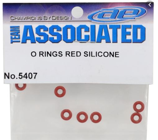

Hi there NeonNoodle
If all you need is the orings I think they are still fairly available.
Try searching for the following part #s.
Chuck
Chuck

So, KidAgain....the o-rings in that ebay link are the particular size that's needed?

I also just rebuilt a set of gold bottom loaders, the only mandatory replacement parts would be the o-rings that radio linked (still very readily available) and maybe the plastic gasket between the body and cap (I reused mine). Just be careful not to kill the bottom spring clip. It's really tricky to remove, use a sewing pin and gently pry it out. It can take a lil abuse and mold back to its original form factor no problem.
