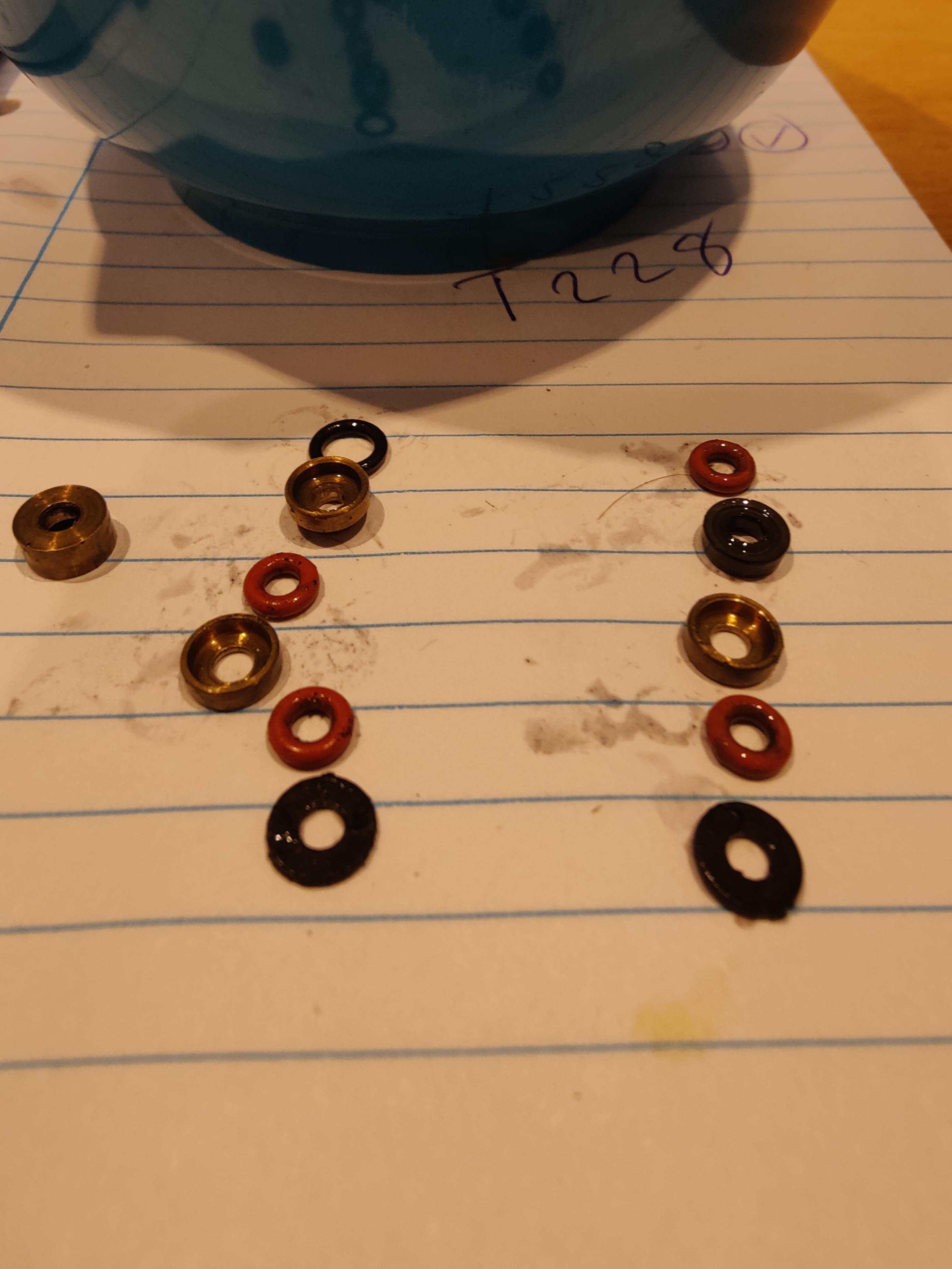

I´m rebuilding my old Cats, and the schocks are getting a rebuild.
But, memory fails me, I have taken appart two old long shocks, but they were not with the same parts inside.
So, to get them the same, I´ll rebuild them with new bushings and Orings. Do any of you know if the ReRe shocks have the same measurements as the old shocks, so I can use the new bushings?
Best regards Brian

Hey Brian sorry just saw this post,
Yes the rere shock parts will work on the originals, atleast my rere xls parts fit the originals I have here.
Adrian
