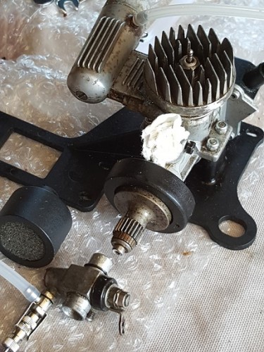

Incredible_Serious wrote: Sun Aug 25, 2019 5:30 pm
Having said that, I do have a NIB Leo 12.... although it appears slightly different to yours Colin - red head, tuned pipe, and no pullstart. These pictures may help, or may not.... let's see.
Well the head of your LSN is standing proud like mine is - so that helps. It appears to be same carb, though I have the HSN as in the 96 catalogue. Block is different too.
If NIB then I guess it should have [correct] factory settings. Would you be able to see how many turns-from-closed you have on the LSN?

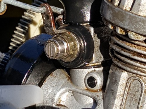

I'm suspecting the carb isn't seated properly. Gonna be a pain to get it out/in though... might get to the bolt if I remove the silencer and have a good spanner, otherwise going to have to remove engine plate :(

Well that's definitely not right, fix it first and see how you go.

RC10th wrote: Mon Aug 26, 2019 8:18 am Well that's definitely not right, fix it first and see how you go.
Yeah, looks like more of a scarf than an O-ring! :lol:
