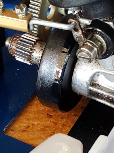

I noticed that after having it running (igniter attached....) for about a minute, the idle stop screw & spring are pretty wet with fuel, and some fuel sprayed up onto underside of air-filter body (on the linkage side of the carb). I wiped them dry, had another couple of quick goes at starting (un-successfully), wet again afterwards.
I don't know if this is normal..?
This, after wiping the flywheel dry, priming and half a dozen or so pulls on the starter.

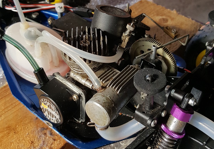

Yes, that's how I'm priming it, and initially the fuel line stays full. But once I've turned it over a few times times the fuel is draining back into tank and then on priming again the fuel doesn't want to stay in the pipe. If I'm quick I can get it to fire before it drains back.RS Chris wrote: ↑Sat Aug 24, 2019 9:21 pm The orange glow sounds about right, but the brighter the better. If the plug was bad it would barely glow, if at all. As for priming, you can put your finger over the exhaust tip and pull the pull-string a few times. This will help pressurize the tank and push fuel through the line to the carb. Might need to push on the tank lid to keep it from popping up.
If you're having trouble with fuel building in the pipe you could try putting a loop in the pressure line. I have to do this with some of my nitro stuff. Does the line go straight into the pipe? Or does it have a nipple it attaches to?
EDIT: it looks like the loss of prime might be due to the fuel line. I get it primed stably, then just lightly flick the line with the tip of my finger and the fuel shoot back into the tank. It feels tight on the carb inlet, but apparently not. Better try a new piece, I guess.
Makes sense I suppose that if I keep priming, keep failing to start, then the fuel has to go through to the tail pipe. As I say, with a clear pipe I can now spot when it's getting full (i.e. blocked).
This is the arrangement of pipes

If you blow in the exhaust pressure line with the throttle fully open does the fuel flow freely without much effort?
Does the engine ever hydrolock by way of too much fuel in the engine?
When it does run does it sound like it's running out of fuel or choking on too much fuel?
Fuel shouldn't go from the tank to the tail pipe, the pressure port in the tank should be above the fuel level.
If I were you I would try to reset the needle settings back to factory, as a "guess" I would say the low speed needle is far too rich and the high speed needle too lean (or blocked, but blowing in the pressure line would tell you this). I don't know the needle settings for that engine (Incredible_Serious where are you
) but judging by the first picture it looks too far out, most engines factory settings have the low speed needle flush with the end of the carb.
Try priming it this way.... With the radio off manually open the carb to full throttle, pull the pressure line off the exhaust pipe and blow into it. Watch the fuel in the line as it just enters the carb (normally you can hear it) and continue blowing for 1 - 2 more seconds then stop, put the pressure line back on the pipe, turn on the radio and then try to start it. It works every time and only takes about 3 seconds.

Thanks for the comments, they're appreciated. I'll work through the suggestions, but some initial clarifications:RC10th wrote: ↑Sun Aug 25, 2019 9:41 am If you blow in the exhaust pressure line with the throttle fully open does the fuel flow freely without much effort?
If I were you I would try to reset the needle settings back to factory, as a "guess" I would say the low speed needle is far too rich and the high speed needle too lean (or blocked, but blowing in the pressure line would tell you this). I don't know the needle settings for that engine (Incredible_Serious where are you) but judging by the first picture it looks too far out, most engines factory settings have the low speed needle flush with the end of the carb.
1 - I'll try that
2 - Not a full-on hydraulic lock, no (I remember the feel of this when playing with model diesels decades ago). It gets firmer when I'm re-priming again and again to explore the apparent leak - perhaps flooded at that point. Once I get to be able to start it more repeatably then I'll begin to get a feel for it lol
3 - Not had it running long enough to get a feel for it. Again - I need more time n experience
4 - Sorry if not clear, fuel is going to tail pipe via the engine and silencer. As I say, probably inevitable when I keep re-trying without anything catching light much. I keep an eye on it and drain it so as to not cause back pressure problems on top of everything else.
5 - I did find online some 'factory settings' tips - has some 'half confirmed' numbers for the Leo 15 as opposed to my Leo 12, but might be a good comparison. Certainly worth checking that number of turns [same make, similar size, maybe even same carb] given your thought of the LSN typically being flush.
6 - Sorry if I'm misunderstanding your point, but I can get fuel down to the carb. And if I've left it an hour then the fuel line stays full. But as soon as I begin trying to start it, it 'loses the prime', and when I try to re-prime the fuel instantly drains back to the tank. I might need to shove GoPro in my mouth and video it - just don't expect a commentary
I've ordered new fuel line, but I can't believe its not tight on the nipple. I've even trimmed 1/4" off so as to have on unstretched piece on the nipple. It feels snug - needs a firm pull to get it off. I'll keep re-testing my theory that flicking the tube is letting air in - tried it half a dozen times, but I know from work that a sound technical theory can still have a loophole!!
So frustrating. It is giving a bark, and has run for 30secs, so I don't think I'm too far off.
It's the 'loss of prime' which seems to be stopping me readily moving onto the next phase. Am trying to suss out any root problem - without going random and changing everything all at once, trying to keep some method and traceability to what I'm doing... :S
Thanks again for the input.

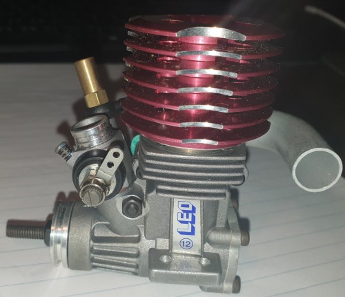

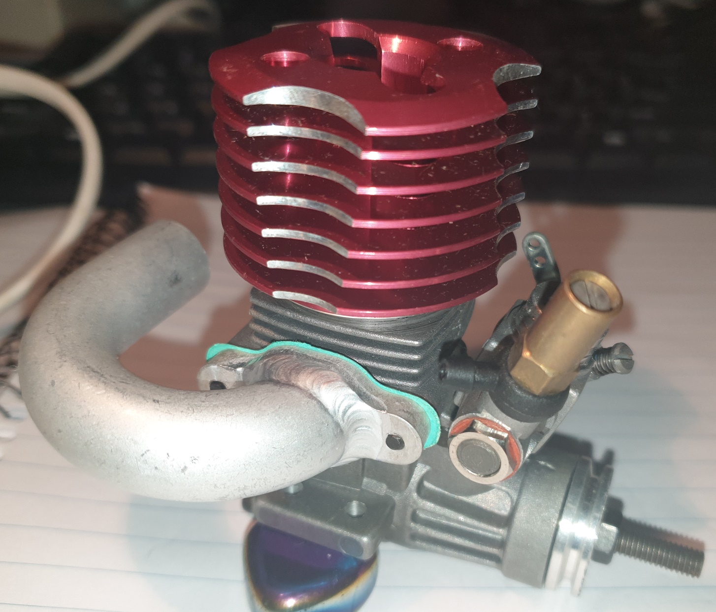

Alex, that looks like a GT manifold and gasket ?

In that in this instance, GT means what, exactly? I assume it's a tuned pipe manifold, rather than the original cast unit, although I could probably sort one of those if necessary...

GT as in Team Associated manifold for the RC10GT/NDS. Sorry, didn't want to sound dumb and ask if it was a factory Schumacher manifold
