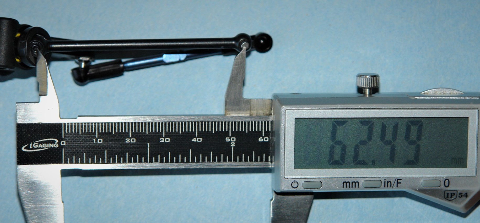

Re: Length of ASC 9754 CVA Bone
The 9754 according to Associated should measure ... 9754 Rear CVA Bones B44 B44.3 RC10B44.1 62.7mm c/c, 68.7mm e/e
I pulled one side off a B4/B44 setup I have on a car and measured appx. 62.5mm center of pin to center of pin.
Pretty sure you add about 6mm to find overall length.
Chuck
Chuck
Yes the pic is great thank you. With my less sophisticated measurement device I’m about 63-64 mm. So it’s likely the 9754.
