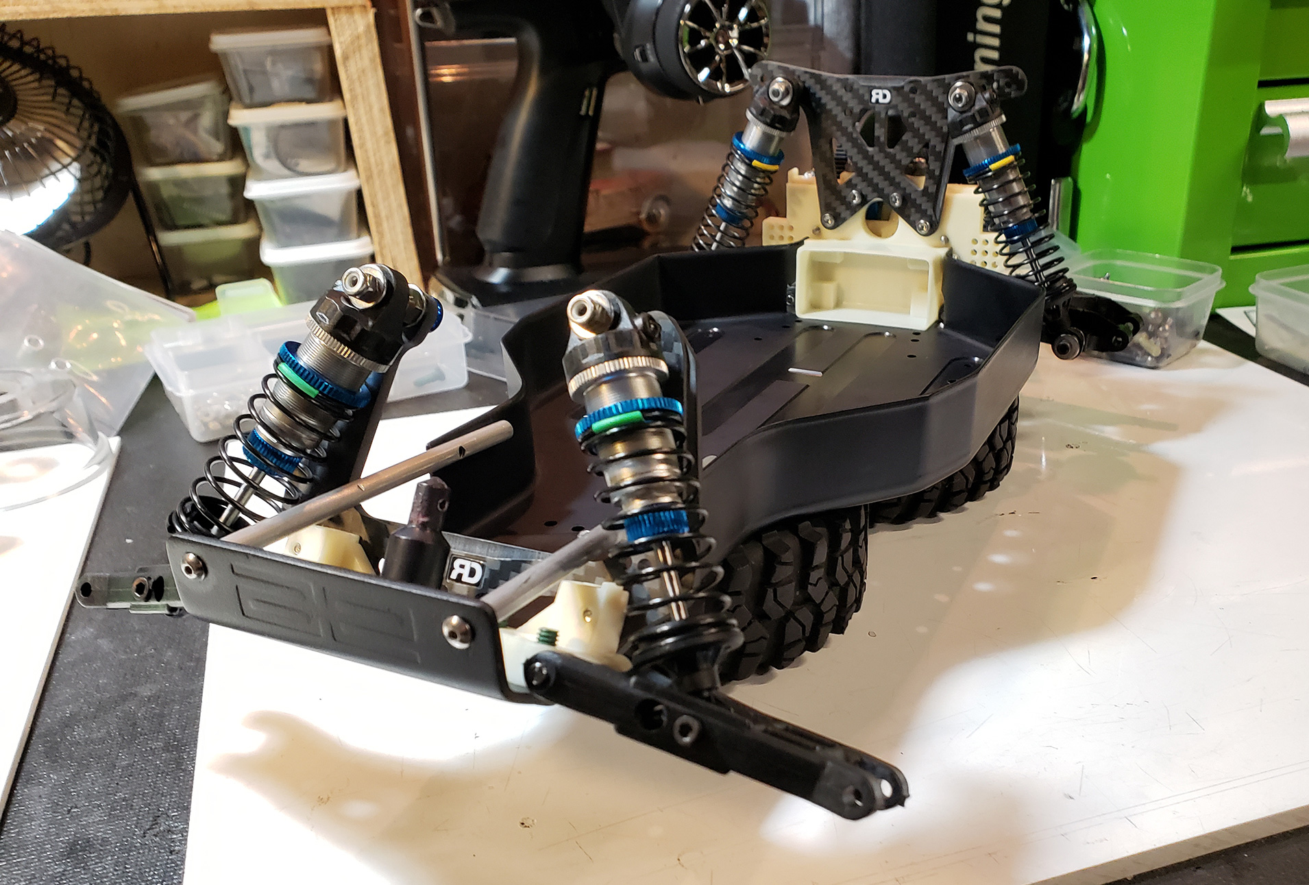

I've got the front and rear shocks mounted,
next up will be the drive shafts ...trying to determine the easiest/best way to do this as there are ton of options it looks like.

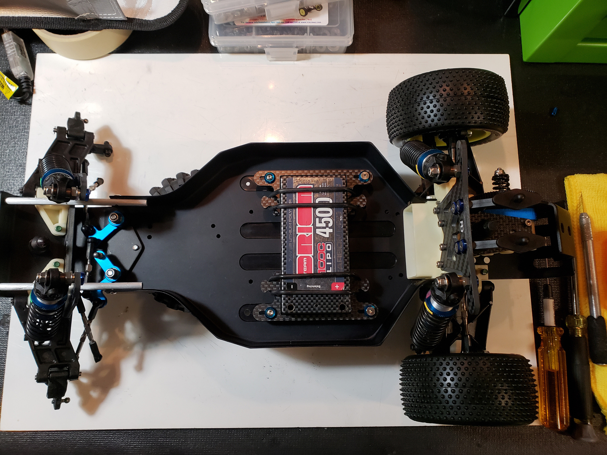

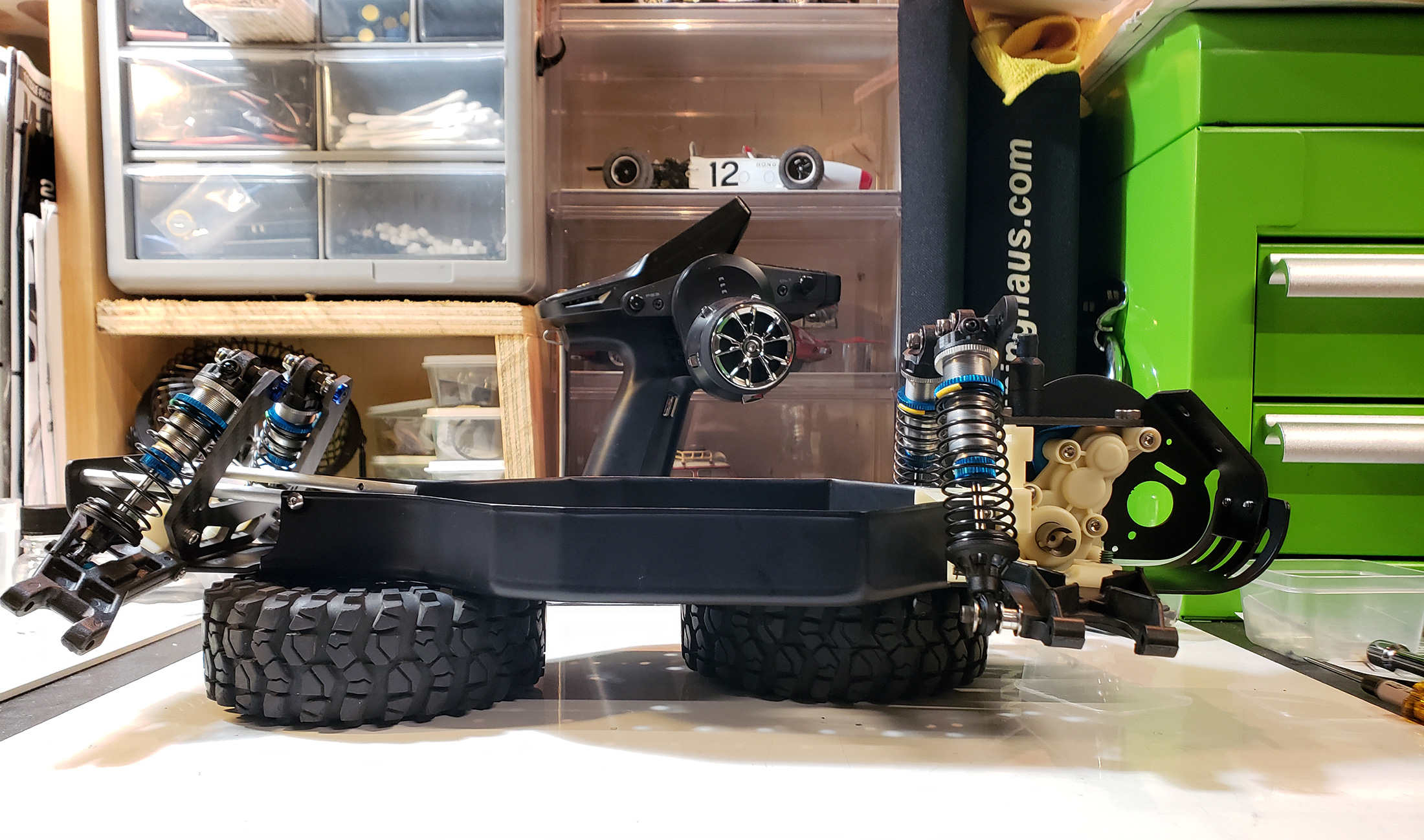

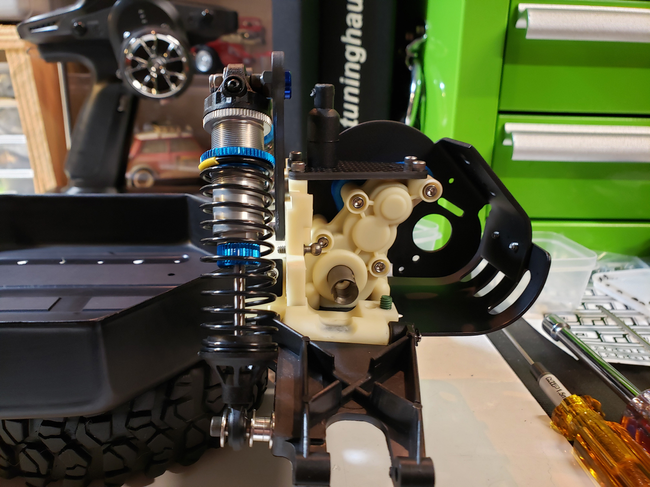

okay, got the back 2.2" wheels mounted, took some back and forth to get them right but there is no binding and everything is smooth and fits well.
I also adjusted the rear camber a little and tightened up the rear diff ever so slightly as it was a tad too loose (I think). Installed a battery holder (and battery) ...
...just waiting for the front axles to arrive, yet may start on the electronics and body while I am waiting.
