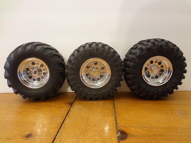

In going over the truck for the past couple days, I've come to the conclusion that if I want this 1980's design truck to compete with modern crawlers , It has to at least have the best tires available on the market. The subject of tires for this truck is not new and has been discussed a little on this thread. What fits on the stock wheels and reasonably clears the body, front spacers, 12mm hub adapters of different types, etc. Well after getting specs on actual mounted tire sizes and seeing what the best gripping tires out there are, I found the proline flat iron 2.2 in m3 compound. Super grippy very competitive rock crawling tire. It is short and wide compared to other 2.2 crawler tires and looks to be a possible perfect match for these trucks. Problem is---they were discontinued and replaced with the taller "flat iron xl". :roll: :lol: Sometimes it's like fighting the tide.

I found the same thing , you can't use a tall tire or it fouls the arches unless you cut them back ugly , I'm currently experimenting with 1.9" wheels that I 3d printed off Thingiverse , it just allows you to use more choices that clear the arch while still having some tire height , the down side is loss of ground clearance on the diff's and gearbox but you do get full steering at full articulation without fouling the arches . I also think the 1.9's look more scale , certainly from a UK perspective as we don't get as many cars here with wheels like the originals seen on the road !
I'm not sure your ever going to compete with a modern purpose made crawler no matter what you do but don't let it stop you enjoying it and I bet you don't come last either .

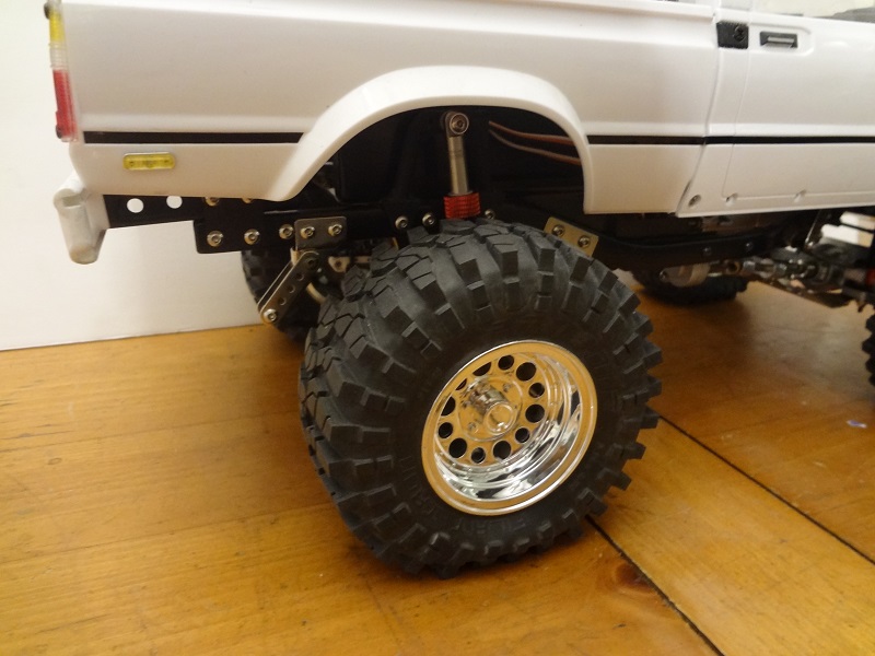

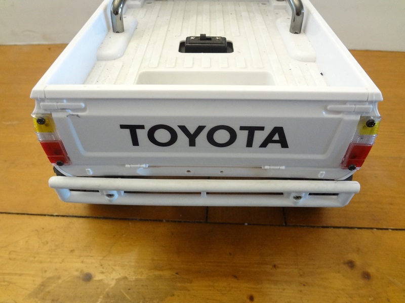

Did a little rear bumper work. I never liked the stock one. Too wide and sat too low. I trimmed down the stock bumper and made some small plates to attach the bumper mounts on top of the frame rails. The results won't win a concours show, but it is very effective at protecting the rear of the body without losing much departure angle. Also, since I made the little plates from material laying around, it was free. 8)

Your modded front and rear bumpers are a big improvement over the stock ones. I don't run the stock bumpers on either of my HG trucks because I really don't like the look. However, with a little creative trim work, they look good.

That's probably a better rear bumper solution than mine , I just drilled an extra hole each side and pushed the mounts further onto the chassis rail , it brings it in well but not higher like your idea

I got lucky and found a set of used, but still new condition, Proline Flat Iron 2.2 crawler tires. I confirmed with my LHS owner that these are unfortunately discontinued. These are THE tire to run if you want to really try crawling with this truck using the stock wheels. They are nearly identical in size to the stock tire. They are super soft and super grippy. You can see in the pics that the weight of the truck squishes them down quite a bit. I will be trying out some 2 stage foam inserts to keep the tire more stable and still have the conformity in the tread area. The first set of tires I tried previously (taller ones on the right) were a great upgrade and good all around trail tire, but these prolines are on another level. I thought they looked pretty good too. 8)

Yep, they do look great. Should definitely do the job. You're lucky to have found them.
How many times have I seen the word "discontinued" today -- I've lost count. Very frustrating!
