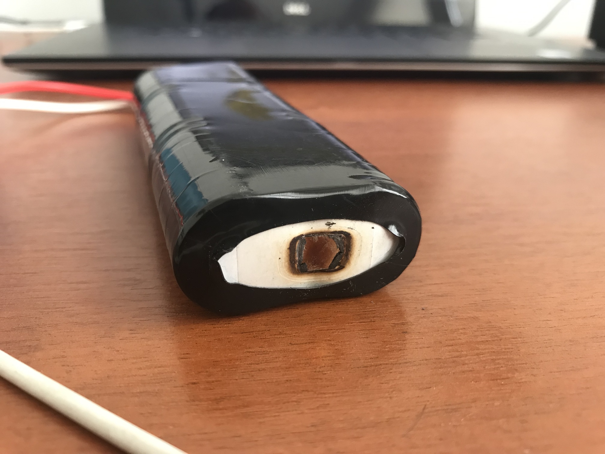

Hi. I’ve finally had some brain time to dedicate to the hobby and tried running my first RC10 build.
The car has parts from two very abused cars I bought online. Everything has been cleaned and rebuilt from the ground up.
So the car runs, but the battery is extremely hot after use. I read around,looking for a cause, and at first I thought it could be a crap battery, but the speed controller and motor also seem very hot to the touch after a while.
You can see the plastic wrapping on the battery has burnt through at one end.

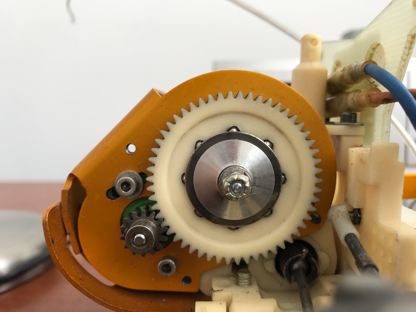

So now I’m thinking maybe the gear ratio has something to do with it.

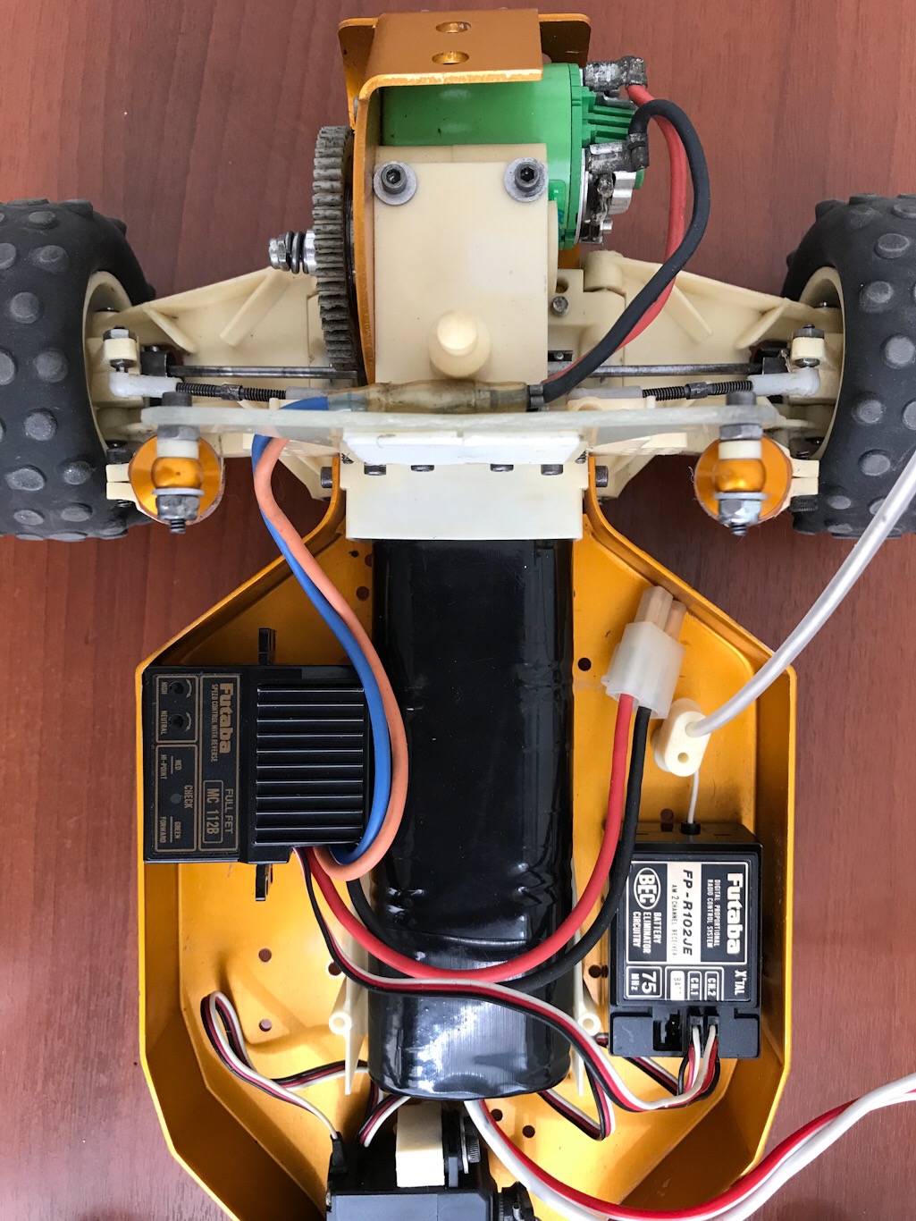

The car is powered as follows:
Motor: Trinity Green Machine 2 which I gather is a 27t stock motor. The motor has been cleaned and lubed.[att
ESC: Futaba MC112B
Battery: Generic,shop assembled,1800mAh nimh pack.
Gear ratio: 54t spur and 14t pinion, standard 6 gear transmission.
Any suggestions based on this setup?
I can get a 12t 32p Traxxas pinion here locally, but spur gears are not available.
ESC: Futaba MC112B

how fast is it heating up? ie, how long are you running the car?
if you remove the motor, does the drivetrain feel free or does it feel like there is drag?
what surface are you running on?
the gear ratio does not look excessively wrong.

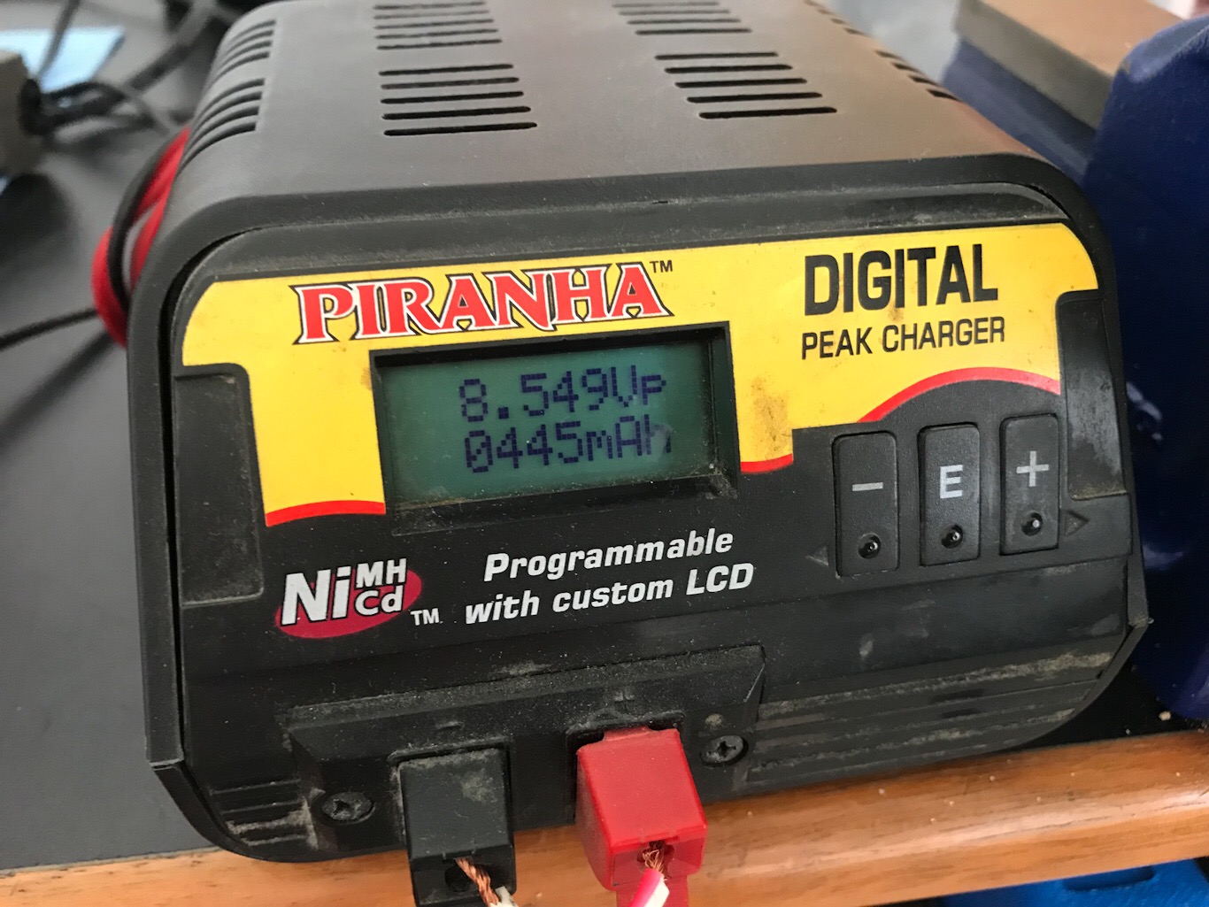

Just finished charging the battery back up. It took 445 mAh. So I used about 1/4 of a 1800mAh pack trying it out last night, and the thing was hot! May have run it 5 minutes total come to think of it.
