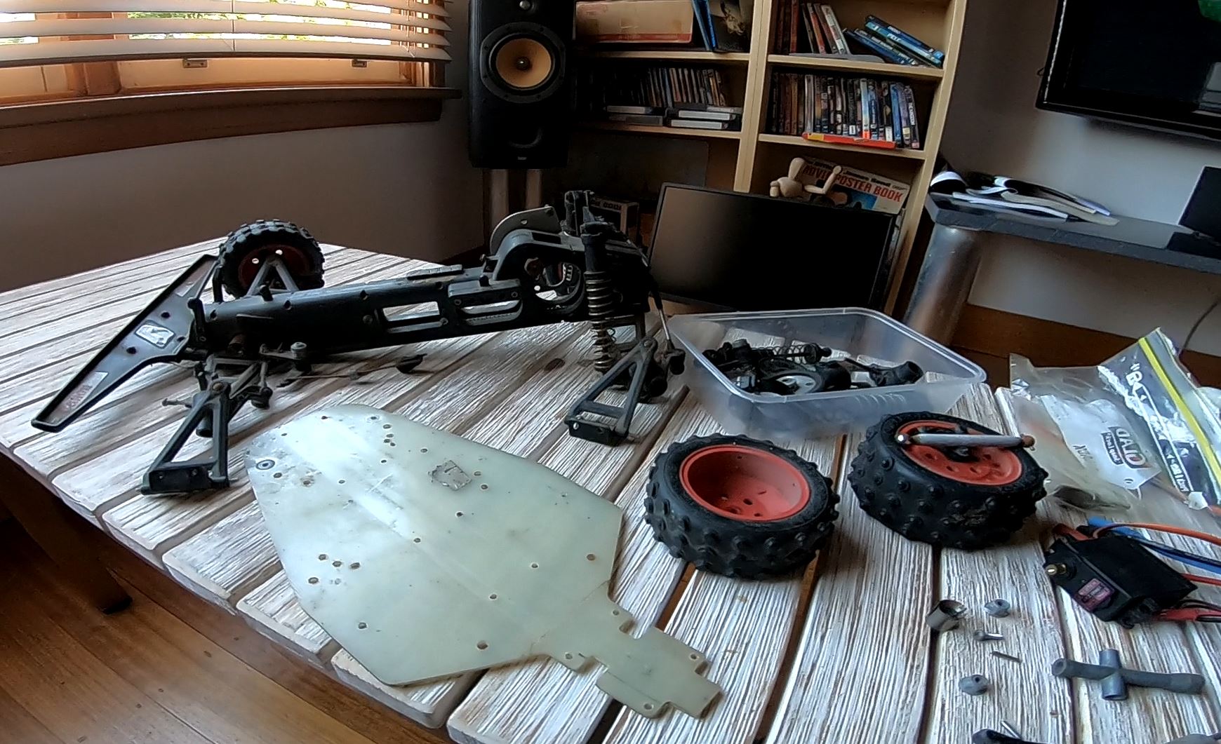

Hi All,
My barn-find PB Mini Mustang 4WD needs drive shafts.
I bought some driveshafts off eBay; 65mm with 3mm pins and got halfway through grinding the pins down to fit
the 'stang's coupling but there has to be a better way. I was running out of dremel drum sanders.
Can anyone recommend a compatible driveshaft?
Chris.

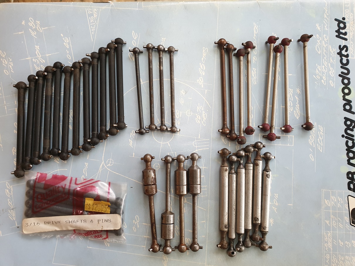

Re: PB Mini Mustang driveshafts
Found my Mini Mustang box.... and these were in it...
- Stock dogbones
- Just slightly too short bones
- Slightly too long bones (I think the last 6 are SRM or something)
Bottom row left to right are:
- New stock dogbone pack - my last set.
- Two pairs of one-way bones; of course, three drive one way, and one drives the other
- Hotshot series bones (Tamiya ones are marked with two lines)
I think the 'too long' ones are all the same length, and most likely Hotshot or Manta Ray or some such length. Not sure if the 'slightly-too-short' ones are an aftermarket version of the other Hotshot bone, or for something else.
Top row left to right are:- Stock dogbones
I´ve got the silver ones with red balls in my parts box #metoo
And I´ve checked them against Tamiya outdrives, which they seem to big for.
Thanks all.
Thanks for the link Coelacanth I'll give them a go.
FYI the original dogbones were a "dog's breakfast" mix of types.
Chris.
Chris.
