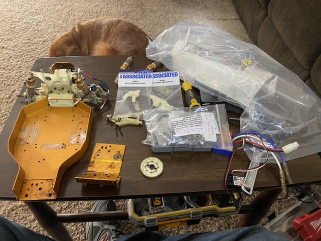

Well Christmas decided to come right in the middle of my tear down, staring at the parts definitely makes you want to move quicker, but I am definitely not the rushing type. Started with tearing down the front end. Removing the battery cup and working my way forward. Steering servo, shocks arms etc. etc. Definitely makes me nervous popping the cups off the ball studs, I’m sure you guys have a good tool or specific way of doing this, I’ve been using a flat head and prying really gently and hoping for the best :roll: . But to make a long story short. Disassembling the whole vehicle piece by piece for a good soap and water bath, then some plastic hydrogen peroxide sunbathing. Stay tuned for my successes and failures!

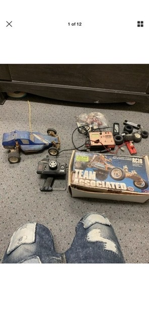

Thanks for the tips guys. Boiling definitely helped take the pressure off the cups. I was able to find some replacement cups on rcplanet or some other site. They’re rpm, they look a tad bit different from the oem ones, these are solid white I think instead of that semi-transparent look. But might give those a shot to get that clean look. I was also chatting with this seller I met on eBay who told me to take the, what I call tie rods, not sure what they’re actually called, and wire brush them then dip them in gun blue. Might give that a whirl and post some pics and see how that works. Mine are very rusted. Next update may take a week or so since the sun here in Missouri hasn’t been showing up too often haha. But the peroxide bath is doing pretty well, might have to try that with my teeth sometime! :D Also bid and won on this beaut the other day on eBay, can’t wait to get it and tear into it as well! Looking forward to coming up with a cool but vintage paint job for it.
Chibfoo
Posts: 7
Joined: Sat Feb 15, 2020 3:18 pm
Location: St. Charles Mo
Re: My Gold Pan restore chapter1
Post by Chibfoo »
In all her vintage glory

Chibfoo
Posts: 7
Post by Chibfoo »
Sorry been awhile since I updated, been ordering parts, I was not aware that there were 2 different types of front stub axle/steering block combinations. The one I had that I needed to replace, had a short back end and the hex cavity was deeper in the plastic, so when I got a new set of blocks, they wouldn’t fit, so I had to buy a couple stub axles as well. Thanks for all the advice on getting those ball cups loose, helped a lot, especially the short boil to soften the plastic. Yes a lot of the plastic was really discolored, and I ordered some new parts, battery cups, etc that were also discolored, and that peroxide bath really is amazing, man that makes a difference. So all the parts are clean, except I made a goof, and tried to clean the rusty screws with vinegar, and low and behold they look like they came off my grandpas old Massey Ferguson. So waiting on some some hardware to replace those as well. I will post some pics as soon as the new parts come in!
bluewormx
Posts: 345
Joined: Wed Jun 08, 2016 4:56 am
Location: Spain
Has thanked: 41 times
Been thanked: 91 times
Post by bluewormx »
Chibfoo wrote: Wed Mar 04, 2020 4:03 pm I was not aware that there were 2 different types of front stub axle/steering block combinations.
Actually there are three.
6216 + 6219 (trailing hex) original design until wide arms came out.
6217 + 6218 (inline hex)
You missed 6221 inline steering block for aluminum axle and 6220 aluminum axle. These came with all late kits ~1993
