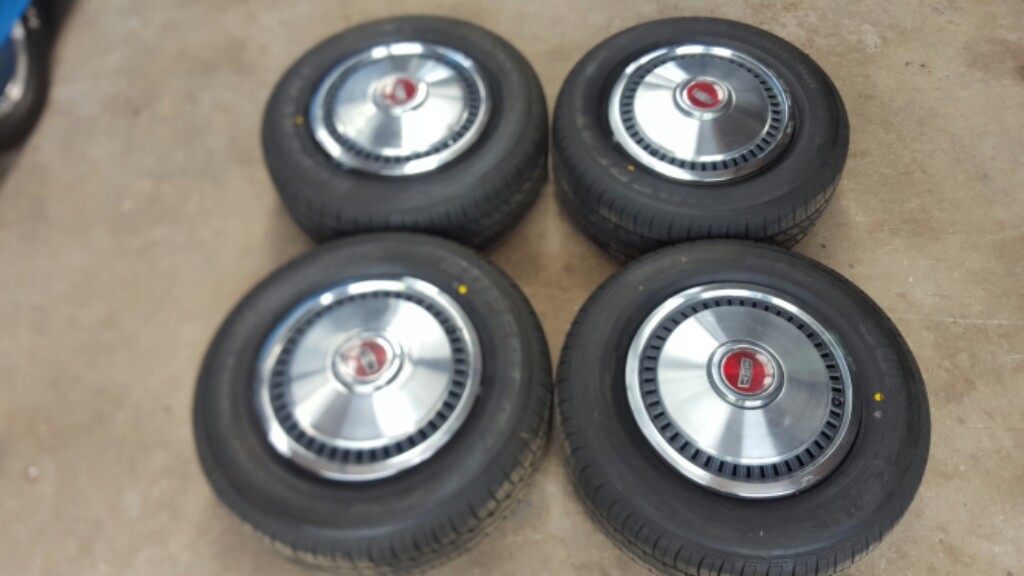

just thought I'd post up my sleeper wheel set. I'd love to put them now to see what they would look like but I'm waiting to put them on with the 9"..... so unassuming......
Speed disks :lol:
