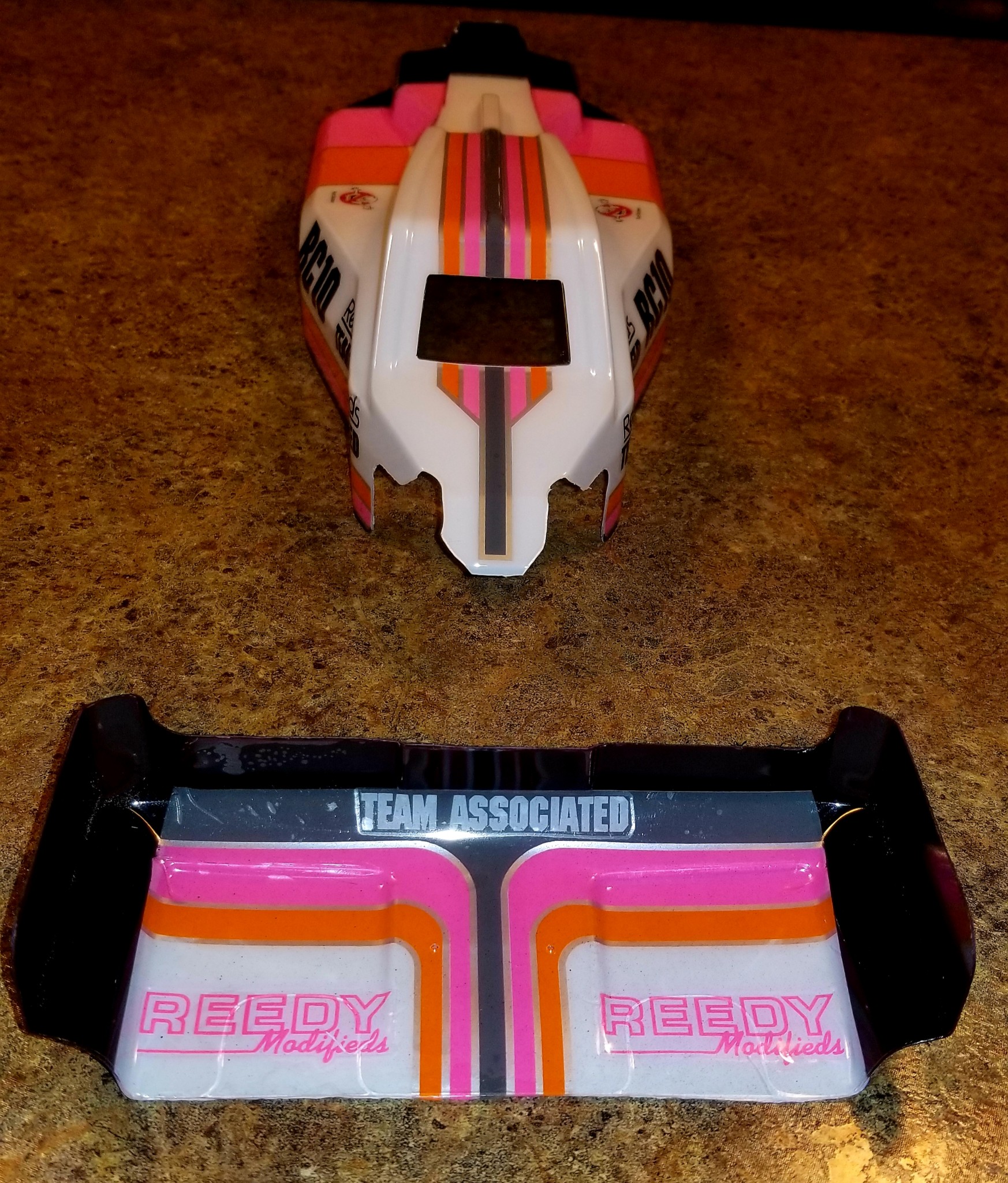

Going with the RC10CE scheme with inverted decals from MCI (man he is good) on new B6.2 carpet car. Paint still to go....white in the front black in the back

That's a great idea Derek! This is going to look awesome!!
So, are these the standard CE decals or are they made specifically to fit the B6 body (they certainly seem to fit that body well)?

Thanks homz! ....yes they are the standard CE decals from MCI except inverted to mount underneath

Diggin' it!

Looks great!
Have you had better luck keeping out the bubbles or have you found they tend to go away with time?

Thanks Chuck...yes much better luck....not saying there arent a few' especially in tight corners....but the flat surfaces are smooth. all i do now is clean the body...spray the area i am putn a decal on with aearosal window cleaner...position the decal then wipe it dry with a clean soft micro fiber rag. get all the decals on then hit it with a blow dryer and wipe some more. then let the body dry a week or so before paint. thats it!

I love the vintage paint scheme.
Sadly, even that beautiful paint scheme cannot disguise the hideousness of a cab forward body.

thanks! ole boy is right tho on that cab forward stuff
