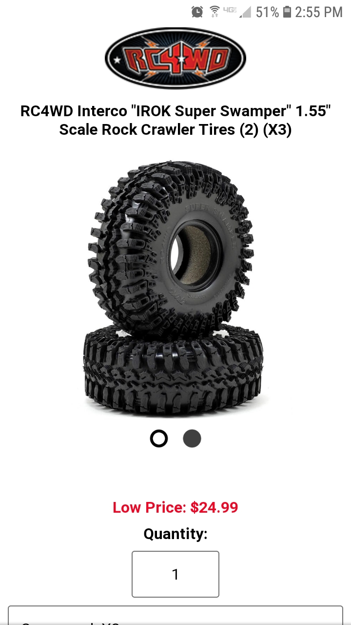

Thanks Dadio...
I found these:
I found the axle kit in Eurupe!
Gonna be sick build!

I found some tires that work better with the 1.9" wheels i made earlier , the Super Swampers looked a little small and reduced the ground clearance as well but i found these https://uk.banggood.com/4Pcs-AUSTAR-AX-5020-1_9-Inch-120mm-Rock-Crawler-RC-Car-Tires-For-110-Traxxas-SCX10-4WD-TF2-RC-Car-p-1285880.html?rmmds=search&cur_warehouse=CN
on Banggood , very soft almost sticky to the touch 120mm high and only 40mm wide , they give better ground clearance while remaining fairly narrow so the get good arch clearance .
These are the Super Swampers
and these are new tires
I think they are the best combination yet for grip and looks , i like them more inside the arches .
