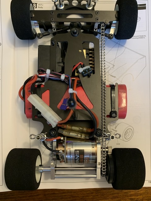

Finally built.
Things to note, the parts fit is excellent. The only thing that wasn't quite right on mine is the front right stub axle side play. There was a little more movement than the left side. Easily remedied with some Tamiya shims.
The front sprocket isn't ferrous. It has quite a heft to it. Probably stainless steel or nickel plated brass. It should last a long time.
The spur gear rides on a bearing instead of directly on the rear axle.
The kit includes a 21t pinion with a long shaft. Optional pinions are listed in the instructions but from the pictures it would seem they are not long shaft pinions. After fitting the 600E it looks like shorter pinions will fit without problems.
If you use the Le Mans 240S ESC you'll have to buy a sensor cable for the brushless motor. Kyosho lists the part number in the manual.
For some reason Kyosho recommends threadlock on the kingpins only. With lots of machine screws in alloy, I threadlocked everything apart from the nyloc nuts.
I've fitted a Power HD R6 servo. It's length is 35mm. Anything longer than this and you'll have to file the slots a bit more.
Five links were removed from the chain to get it to sit as in the picture.

The car looks great Chris!
By chance, are you able to determine if the front and rear sprockets have the same tooth count? Someone mentioned the car having one-way bearings in the front but I'm curious if they've addressed the difference in tire size by over-driving the front sprocket.
Anyway, thanks for posting. Can't wait to see the completed car.

Thanks Doug. The rear sprocket has 16 teeth and the front has 15.XLR8 wrote: ↑Sat Sep 19, 2020 10:25 am The car looks great Chris!
