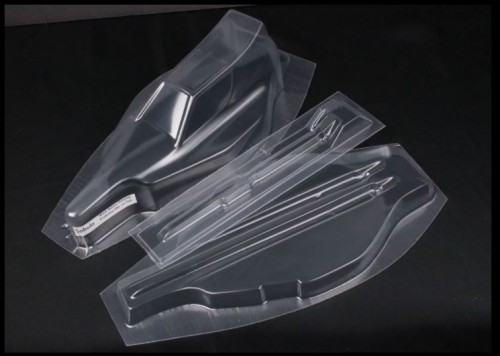

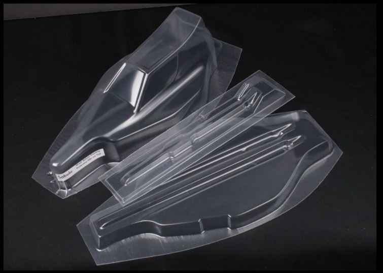

FYI, OldRC (aka Sabulatech) has the complete CAT SWB bodyshell set. Price is reasonable (22 bucks) and quality is very good. I've picked one up back in January.bismuth wrote: ↑Mon Sep 21, 2020 2:15 pm Thanks guys,
I want it to be a runner, so I think I'll go for the XLS because I already have most of the parts. For the SWB I do not have the short belt, front joints, bodyshell, bottom shell, top chassis plate, grey front bumper and they are very hard to find.
Any tip for gently removing the light rust spots from diff/integrator balls and washers ? Or is it better to replace them ?
https://store.sabulatech.com/b018-Cat-SWB-Body-Tray-and-Belt-Cover-Set_p_106.html

Thanks Doug,
Good to know for the SWB shell.
