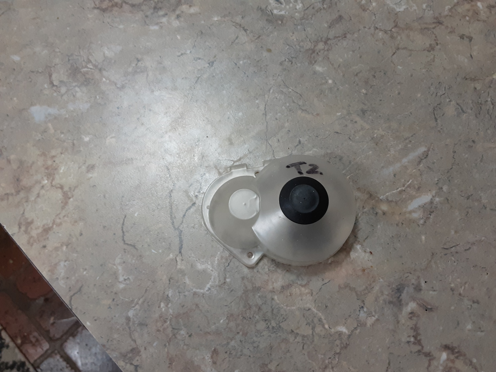

Hi - totally new to this forum and hope this is the right place to ask. I'm restoring my RC10T2 and am missing one part that I cannot locate anywhere; the gear dust cover (part 7372). Does anyone happen to have the dimensions handy as I would like to 3D print a cover for it in the absence of finding an original. thanks in advance
- juicedcoupe
- Posts: 3010
- Location: Pascagoula, MS
- Has thanked: 235 times
- Been thanked: 1754 times
Re: RC10T...what are the non-original parts?
I seen this:geoffm wrote: ↑Mon Nov 16, 2020 6:17 pm Hi - totally new to this forum and hope this is the right place to ask. I'm restoring my RC10T2 and am missing one part that I cannot locate anywhere; the gear dust cover (part 7372). Does anyone happen to have the dimensions handy as I would like to 3D print a cover for it in the absence of finding an original. thanks in advance
https://www.thingiverse.com/thing:4461750
If you are in the US, I've got one that you can have. Just cover the shipping. I got it in a parts lot and have no use for it.
