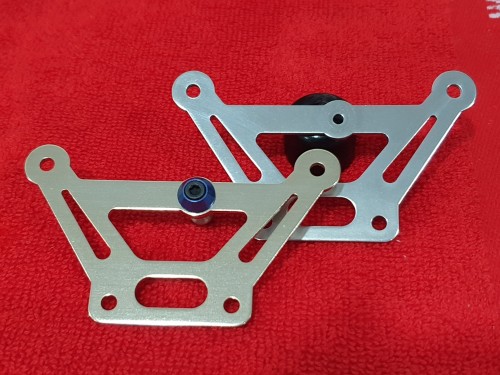

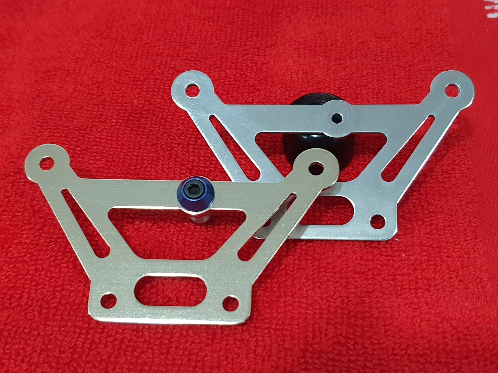

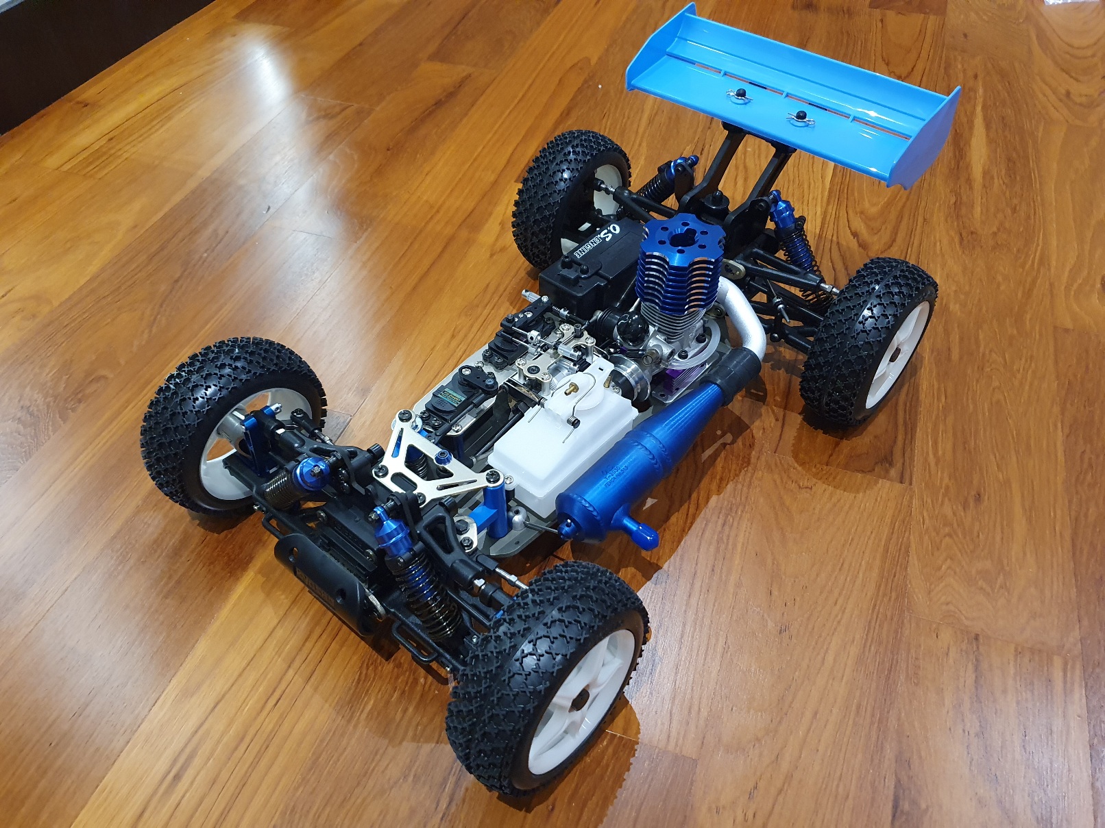

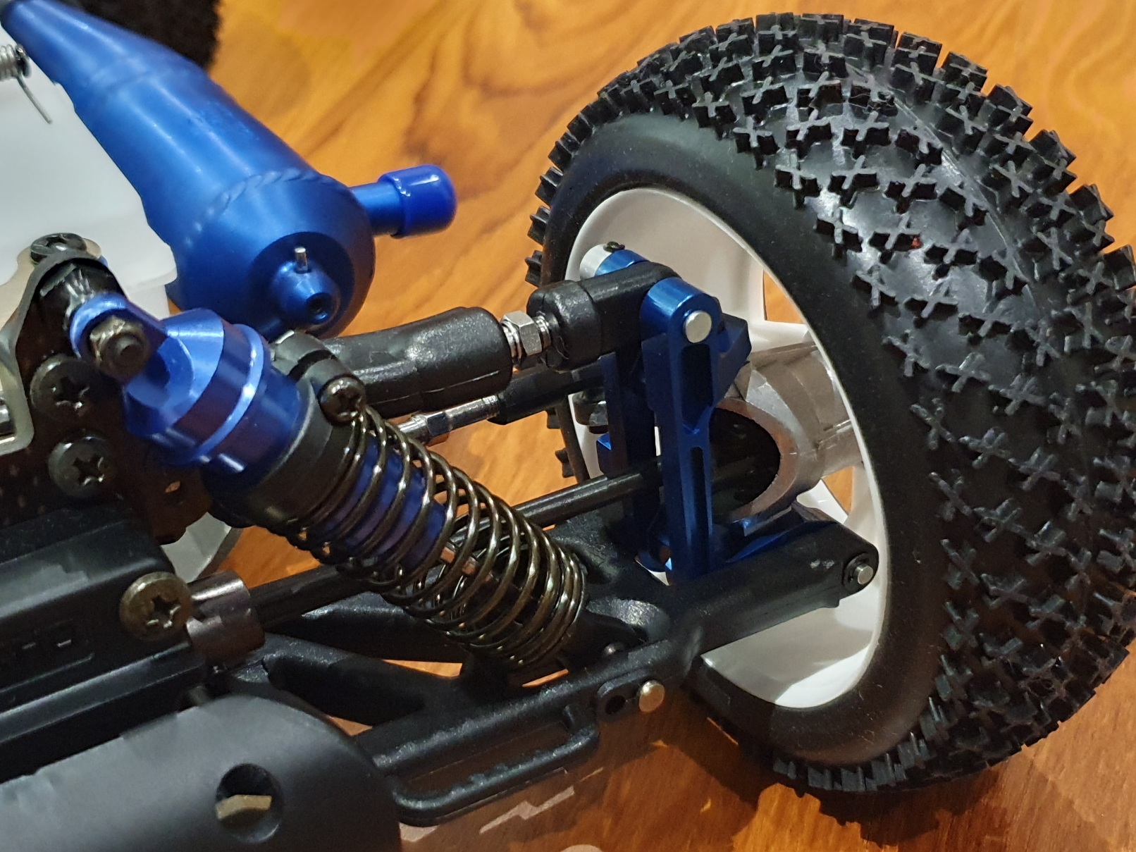

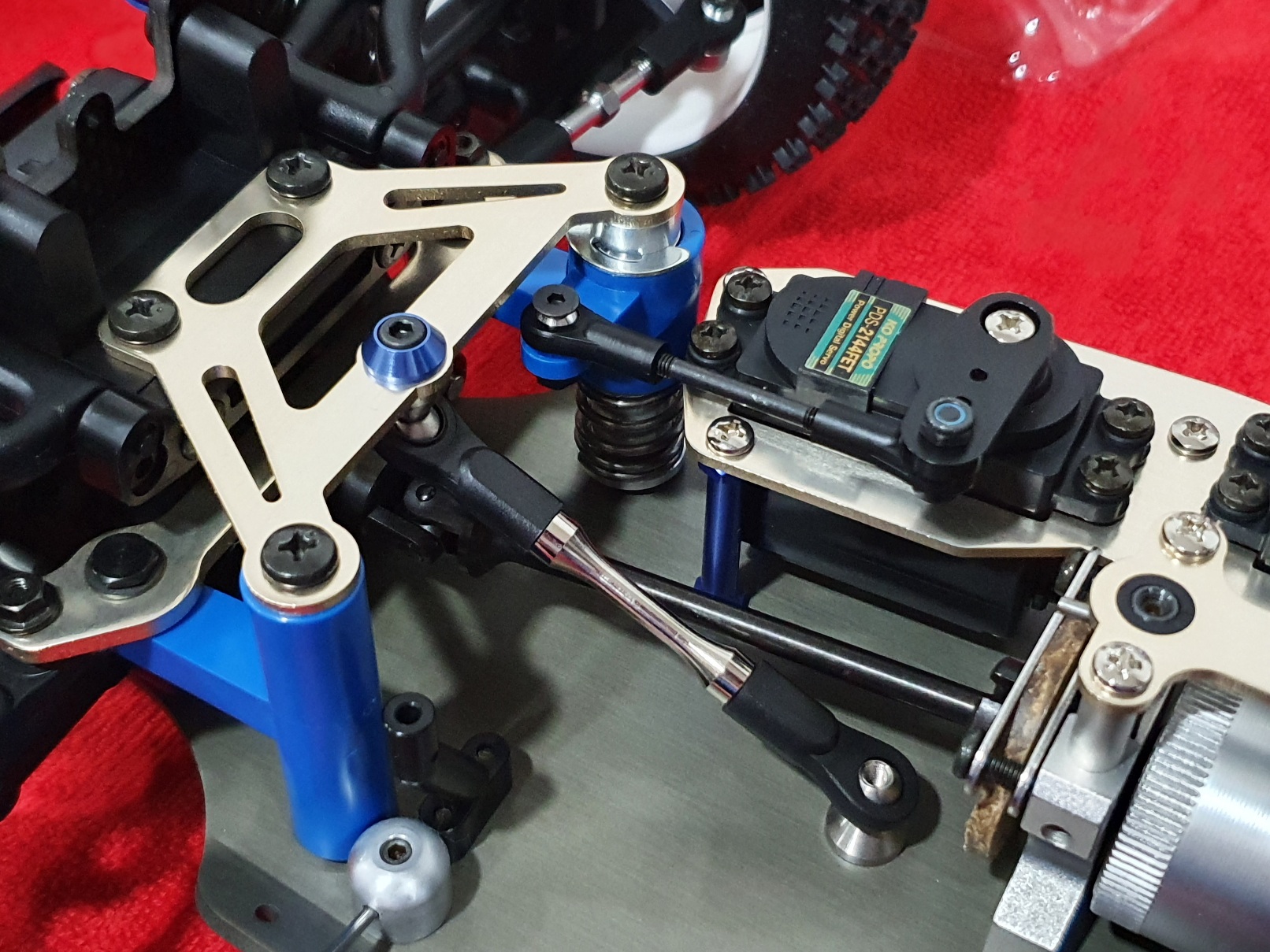

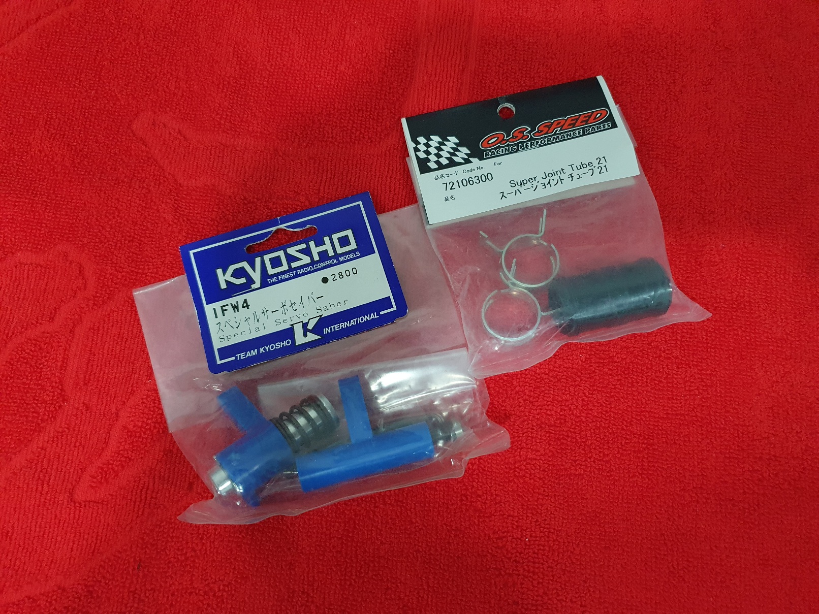

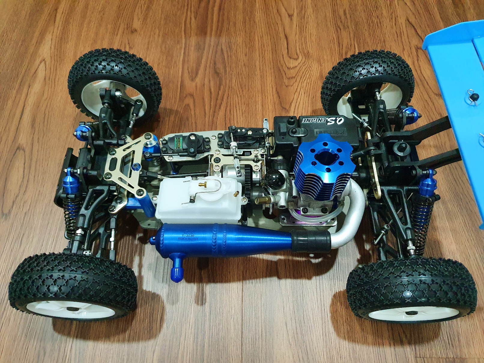

The last pieces for this build have finally arrived. I've managed to hunt down the optional Kyosho ballraced servo saver, as well as a silicone coupler from OS.
I've also found the front steering top plate in the light champagne anodizing. Here's a comparison with the original piece (that I've polished).
All installed including now the front torque rod supplied with the long wheelbase chassis kit.

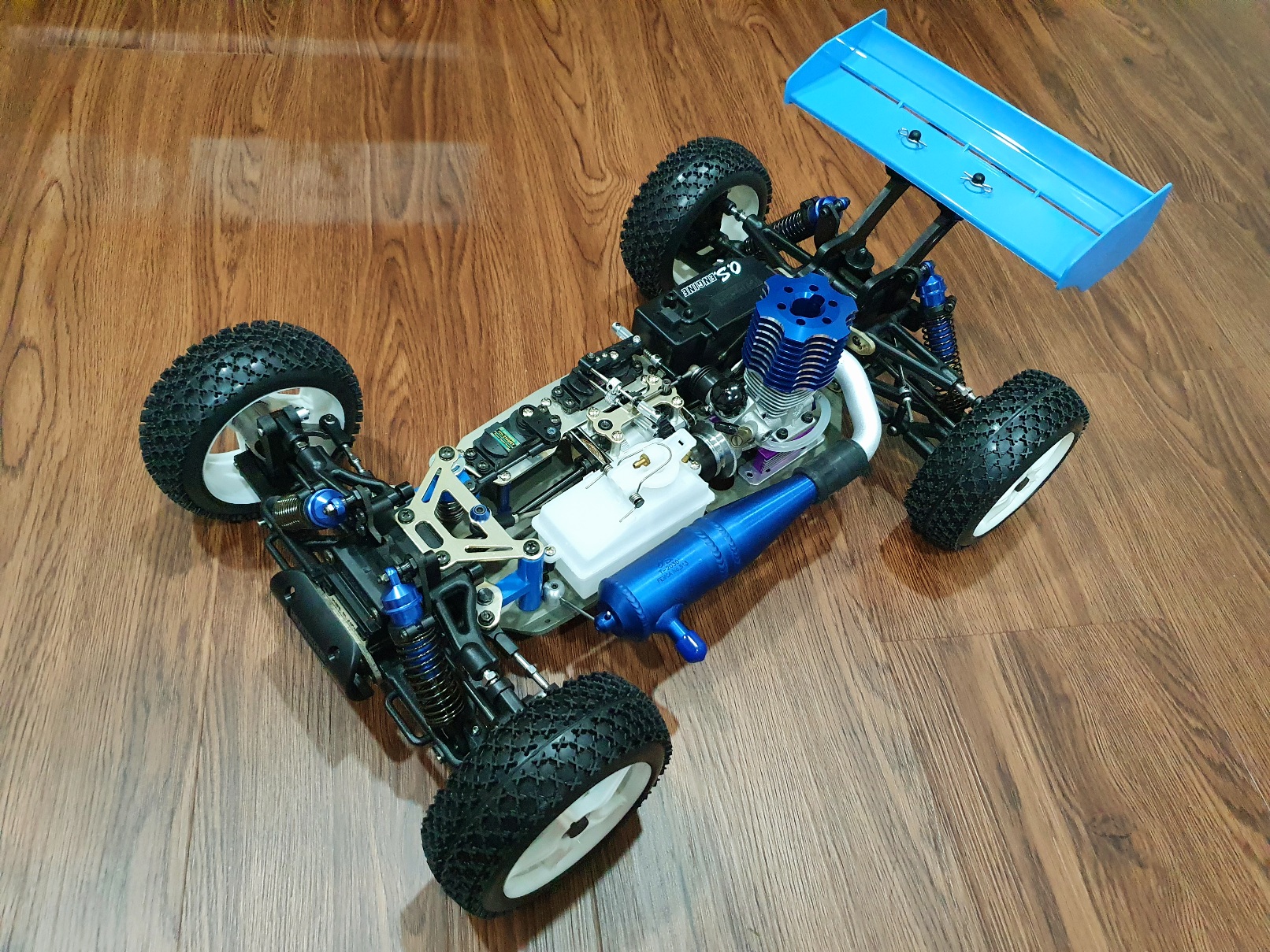

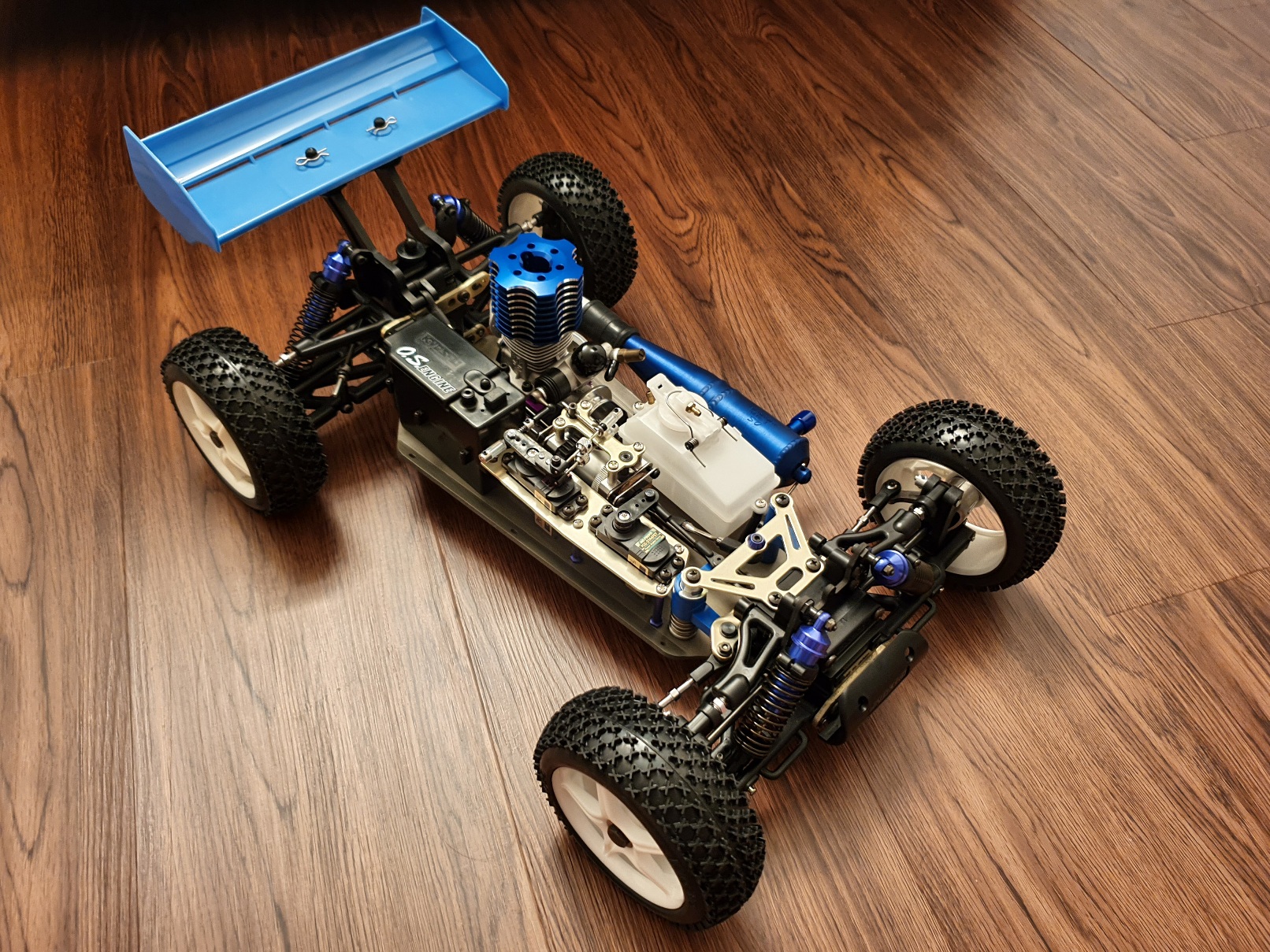

All together now, with new white wheels and a blue wing :)

First class build. Great work.
Great find on the blue wing. They are not easy to come by.

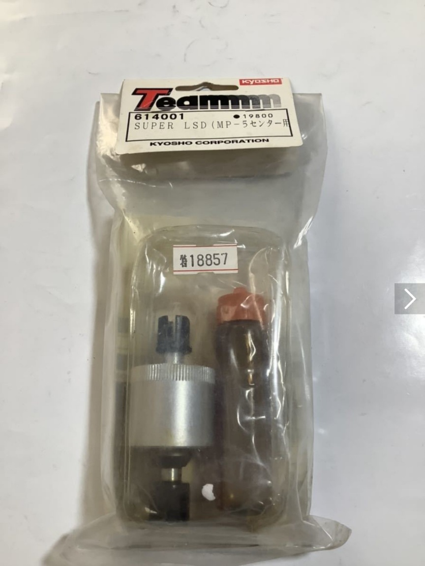

You mentioned, that the Torsen Diff was made by Kyosho, do you happen to have a part number for it? I picked up some used Fioroni diffs recently and will post them here when I find time for the hobby again.

Here's a picture of the Torsen LSD in its original packaging and you can see the part number too.

thanks for the quick reply and the picture of the diff in its original packaging. That is a great reference for other fans of the MP5/MP6!
I had never heard of Kyosho Team parts up until now, and a quick google search didn't give many results. If you have any information about them it would be good to know. I will try to find out a bit more about them and will then add it to Wikipedia with a link to your thread. In the meantime I have added some information concerning other 3rd party suppliers in the optional parts section. More details and links to pictures including the Fioroni parts will follow as soon as I have time.

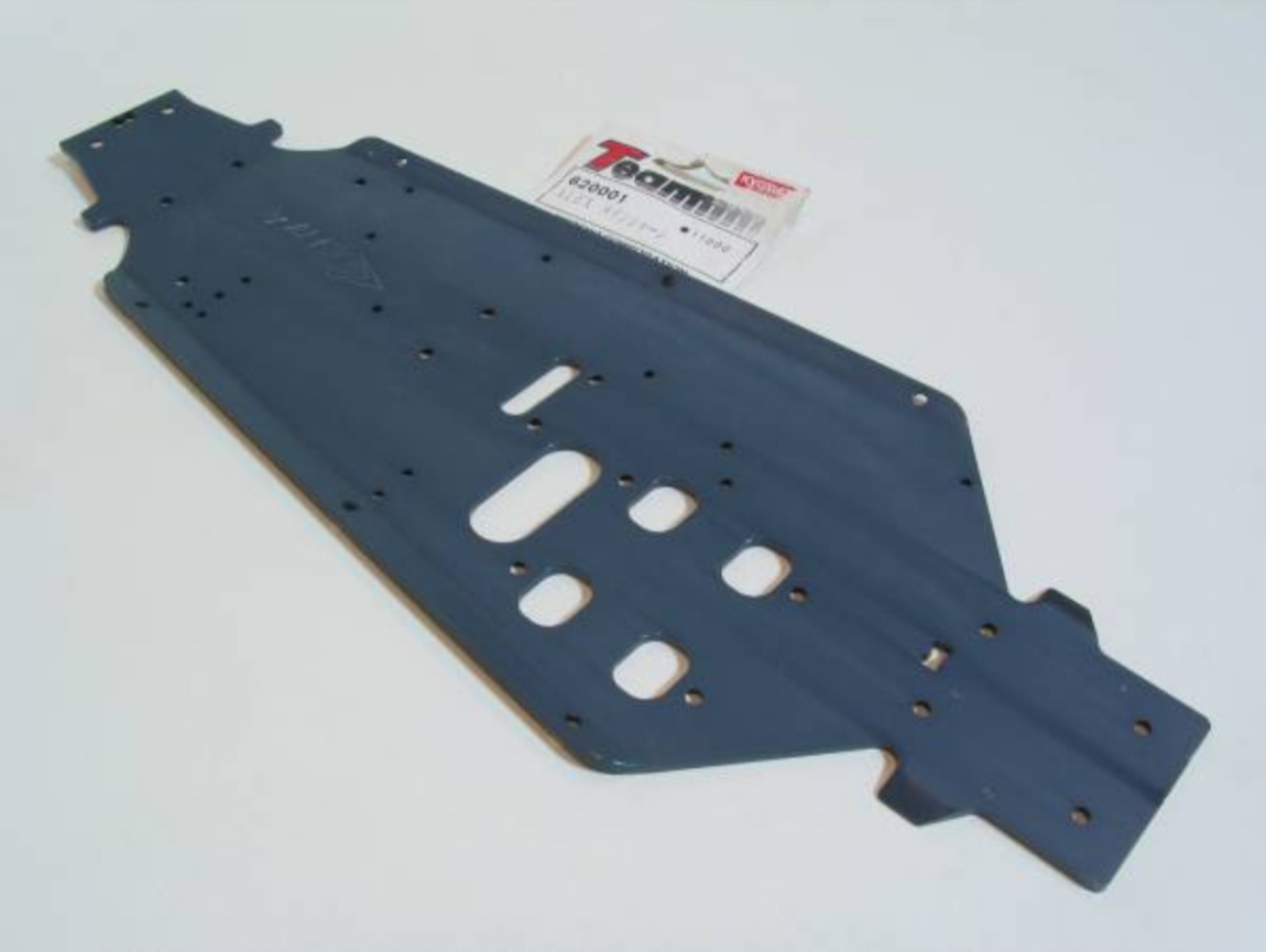

If I'm not mistaken, Fioroni made parts for Kyosho Europe. These option parts have Kyosho header cards. I've got a chassis from Fioroni like this.

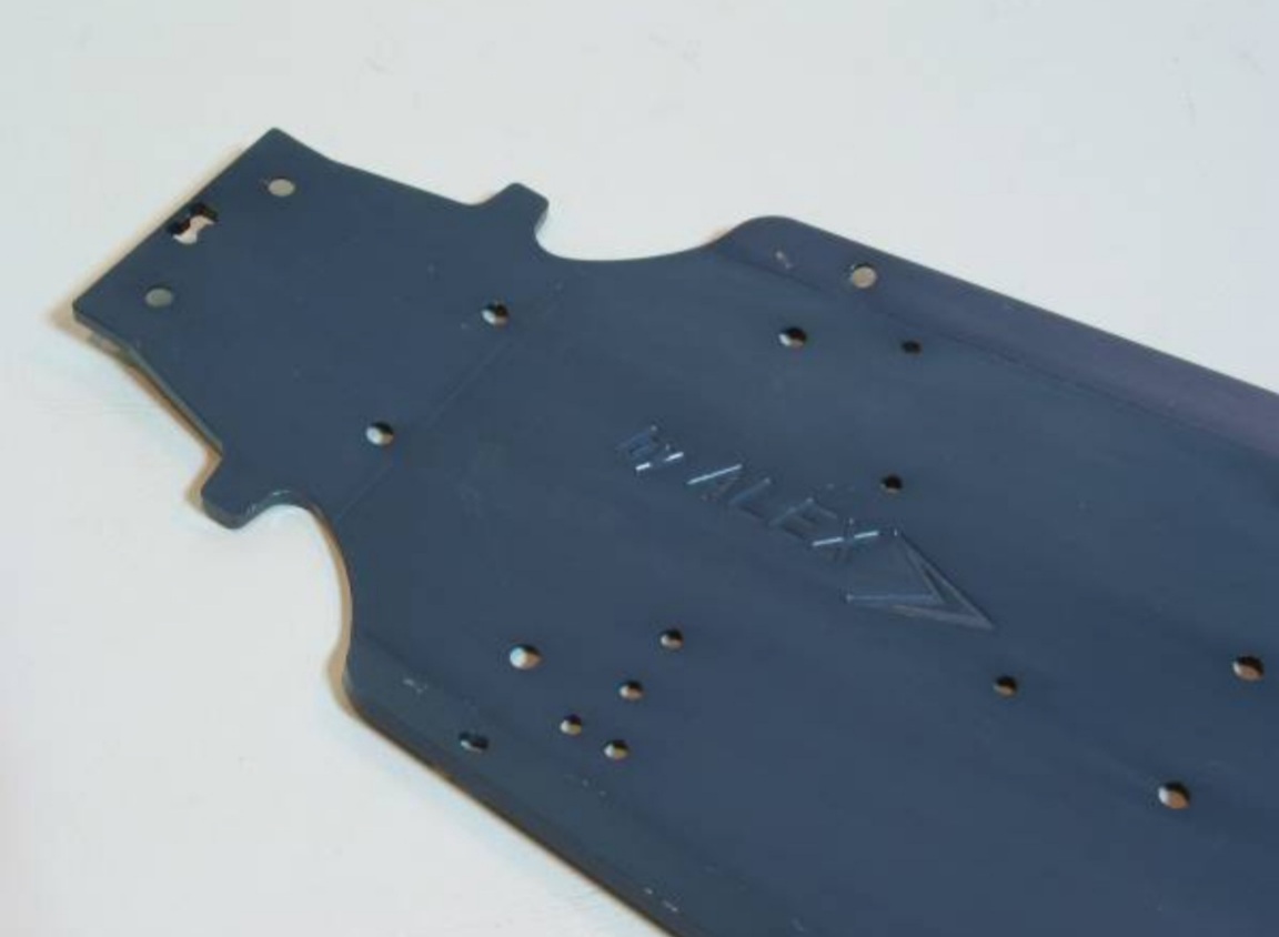

Kyosho Team parts are similar in concept too, I believe they would be option parts made by other manufacturers. Here's another example (not mine). Kyosho Team card, this chassis for the MP6 is made by Alex Racing.
You are right, to be period correct is to have some pink parts mixed with the blue ;)
I'm trying to find the source of information on the IFW4 ballraced servo saver that claimed the blue plastic is a different resin from Du Pont. I read this once but can't seem to find it anymore.

At first I had assumed it would be Alex Racing Design that made the chassis but I think I am wrong. The arrow logo seems different from typical ARD logo.

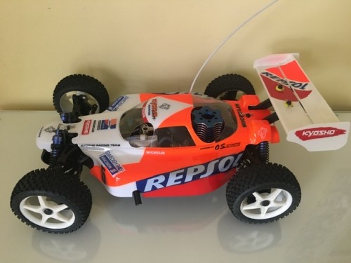

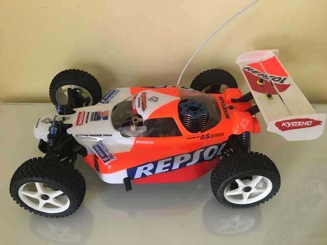

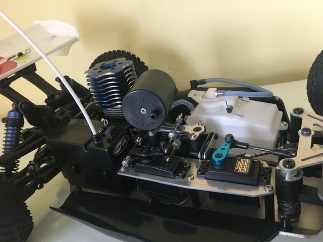

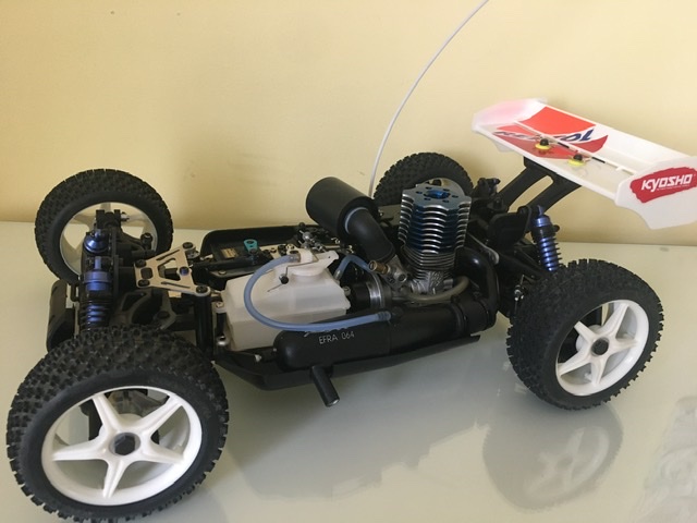

I have attached a couple of pictures of my own mp5, it’s the basic kit, straight out of the box. Only additional parts are the shock towers and front chassis brace.

Thank you Hoseman!
You’ve got a really beautiful build there, I love your Repsol scheme!

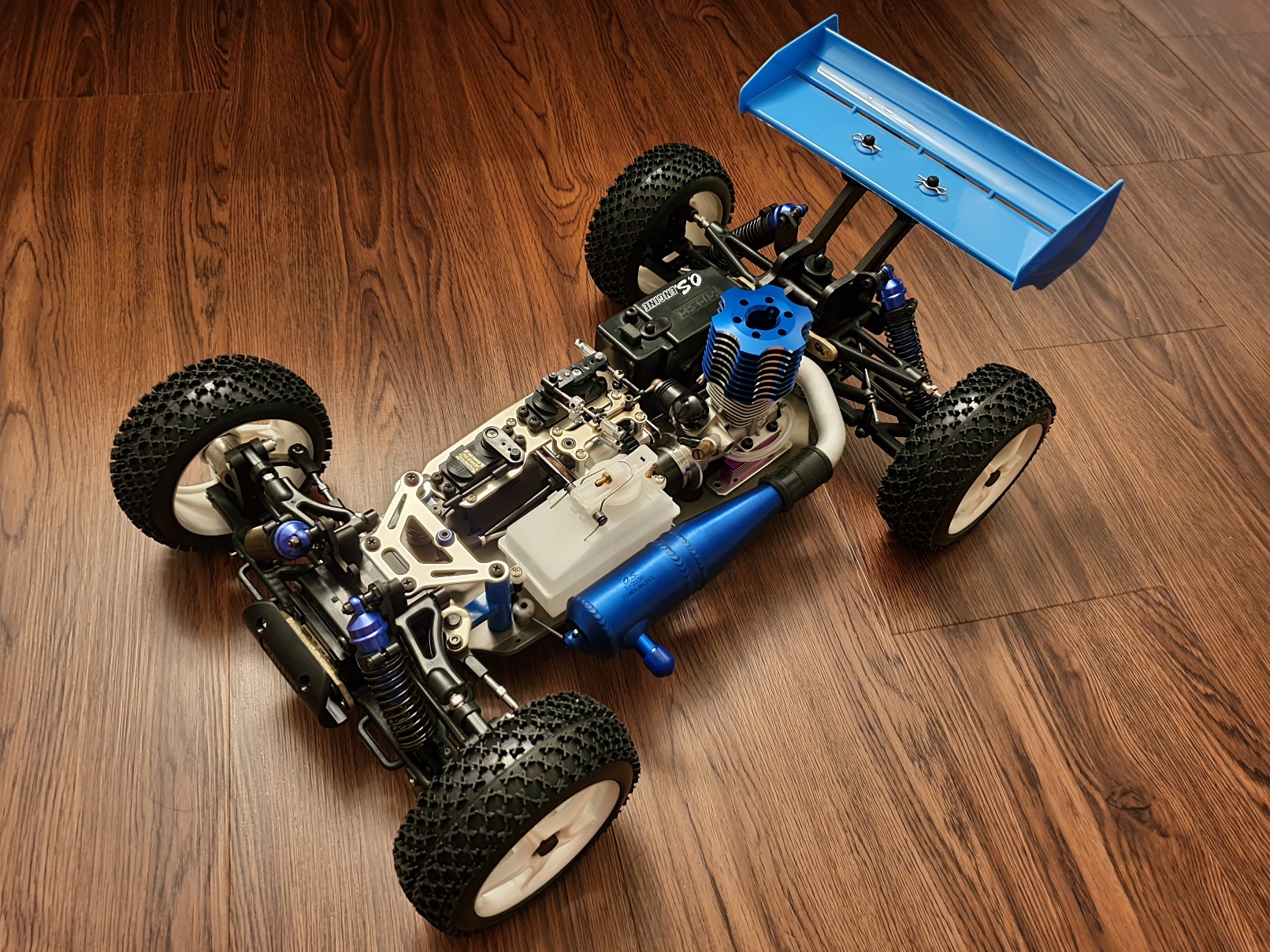

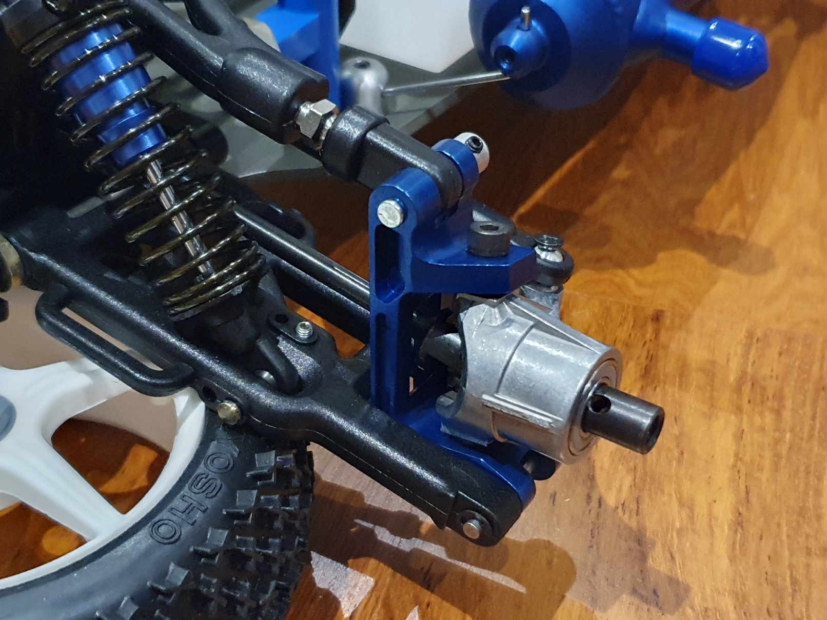

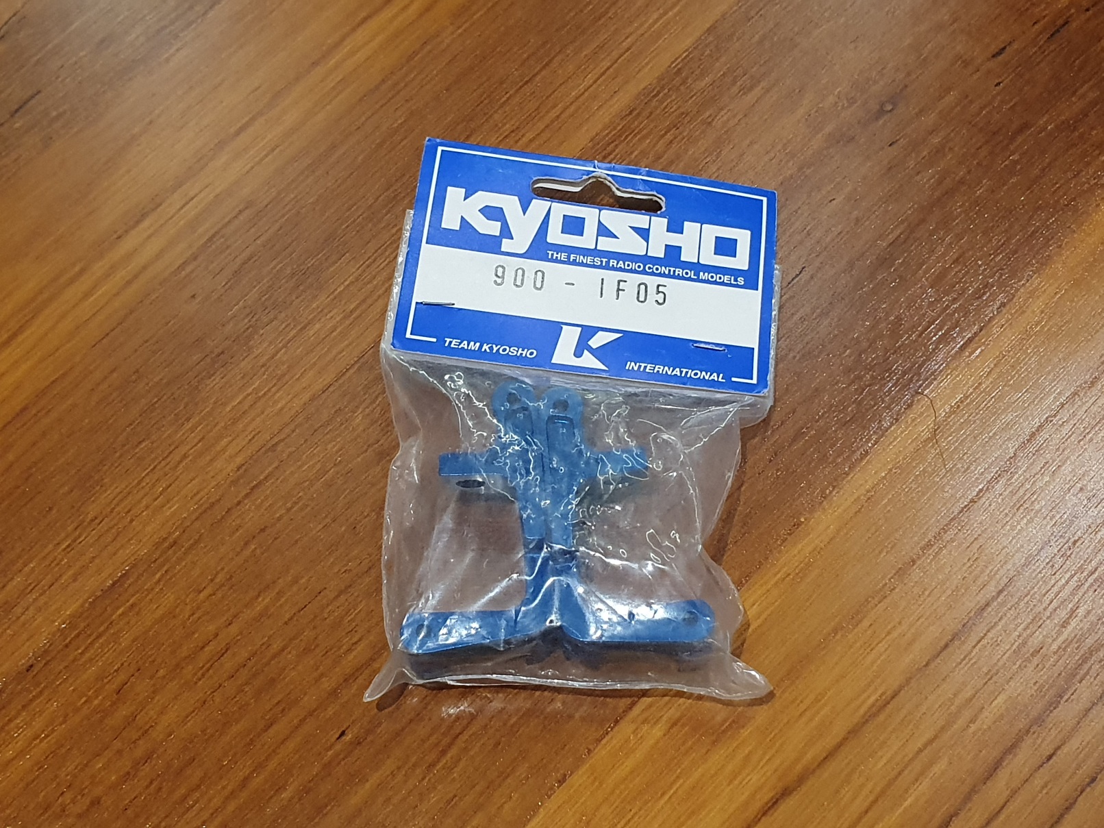

A bit of an update after some time away - I managed to find some option parts available from Kyosho Germany. These alloy C-hubs replace the stock plastic ones.
During installation I realised the lower hinge pins wouldn't fit.. these new ones made later for the MP6 were very slightly larger in diameter. Fortunately my old used MP5 examples were still around.

Fascinating! Thanks for posting that, I did not know they existed. The part number IF05 is the same as the plastic versions. It would be great to know more about them if you have any additional details. They look really good on the car too!
