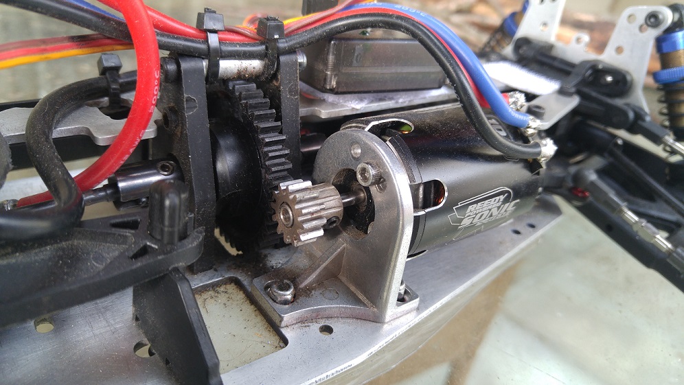

Motor and battery layout was tricky. I first considered mounting a shorty pack, but there isn't enough room for a 4.2 Ah shorty (too long), so you'd end up having to use an ultra-shorty. I don't like small capacity batteries for 4wd buggy, so I went instead for a saddle layout, which is still tight but possible. I used B44.3 saddle cups/holders, which work quite nicely. Had to mark out where to drill the holes and then countersink them on the bottom of the chassis (this goes for all screw holes on the underside. Nothing was countersunk, so I had to countersink everything). I also had to cut some of the upper deck on the left side of the chassis to make enough room for the left saddle to slot in, and also make a hole in the upper deck over the negative terminal of that saddle, so I can make an actual connection. This gives you basically no room to mount an ESC, so I made a little Kydex plate to go over the upper deck, to make enough surface area to mount the ESC. Anyway, this setup basically forces me to mount the motor on the front right of the chassis, which is fine except for the fact that the diff gears are mounted in such a way that the car goes backwards unless you have an ESC that can run in reverse mode (you can't flip the diffs, as they ride a little bit into openings in the bottom plate, so they have to sit where they are unless you cut the chassis again, and I'm not doing that). The Trackstar 120A does have reverse mode, and I generally love that ESC as it's only ~ $70, is very tunable, and works quite well.

I forget the part number for the motor mount. It's a Kyosho part, but it's not made anymore :( I think I was for the DBX. Undertray is hacked/modified from a spare TBG YZ10 870C undertray.

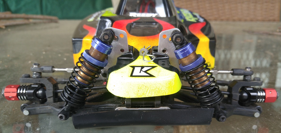

The stock front bumper is rather large and extends past the chassis by quite a bit. I had used that bumper at VONATS and it was okay, but really I needed a shallower bumper. So I just made one from Kydex (I know, it doesn't look perfect, but it works), which pulls the leading edge of the bumper back in, behind the front wheels. This gives you a larger approach angle on jumps and will help keep the car from nosediving off of steep jumps.
Ride height set to 22-23mm. Kyosho RB5/ZX5 front/rear shocks with Losi blue/Kyosho gold front/rear springs and AE spring cups (need to choose the right spring cup to avoid it hitting the front arms at full droop). 2C/2B front/rear pistons with 45wt/35wt AE oil. This is a setup for hard packed dirt. Not exactly what I ran at VONATS, but what I arrived to afterwards as something that should work much better, especially on jump landings where the car was previously not jumping very well.
