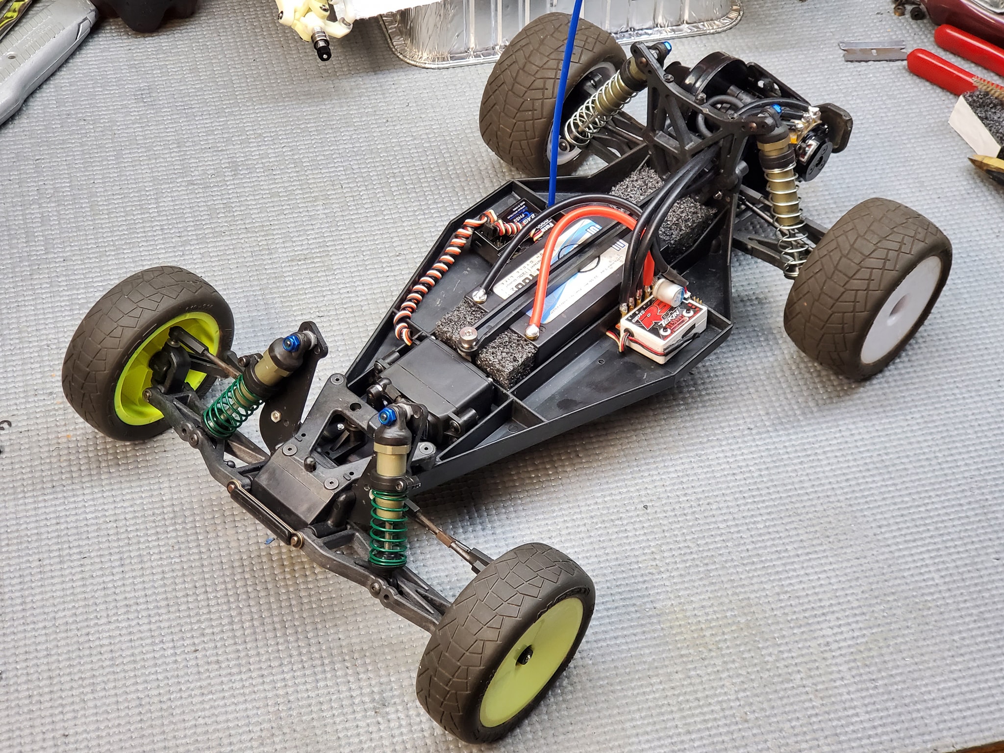

Hey Jason any pics of your B3

mikea96 wrote: Thu Jan 28, 2021 1:29 am Hey Jason any pics of your B3
Nothing special. I picked up a b2/b3 lot back in September. Basically 3 complete cars. I threw the b3 together to shake down at the Vonats in October.

Looks good! I was debating on big bores for mine but I think I will just leave the kit shocks on for now.
