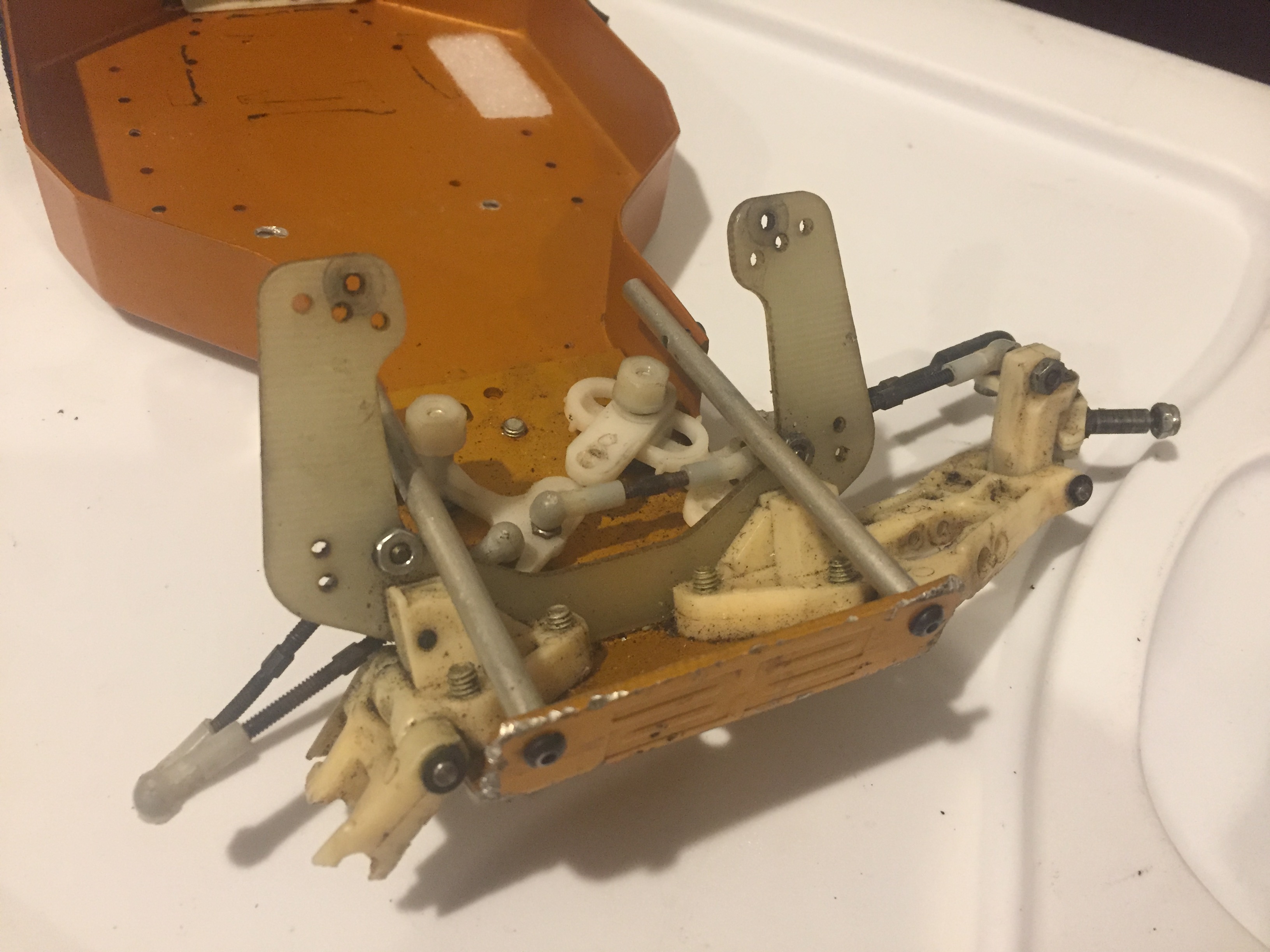

So, I found my old RC10 and thought it would be a good idea to let my 5 year old son drive it for a minute under the supervision of a responsible adult.  Since there wasn’t one around, he smashed it into a wall within the first 5 seconds, breaking the front right A-arm.  After kicking myself repeatedly, I put it back into the box I found it in.  <br />After a week or two, I began having thoughts about fixing it, so I found a new A-arm on eBay and ordered it.  I also found a bunch of great things I could buy to spruce up the old gal.  This sparked something inside me and I fell into a deep rabbit hole on YouTube searching out every video I could find about RC10’s. <br />After not having been into the hobby for many years, I started learning about all the advancements in RC cars since I was a kid. LiPo batteries, brushless motors, stealth transmissions.  It was a lot to take in but I was hooked.  That’s when I decided to modernize my car but still keep some of the old school vibe.  A resto-mod.

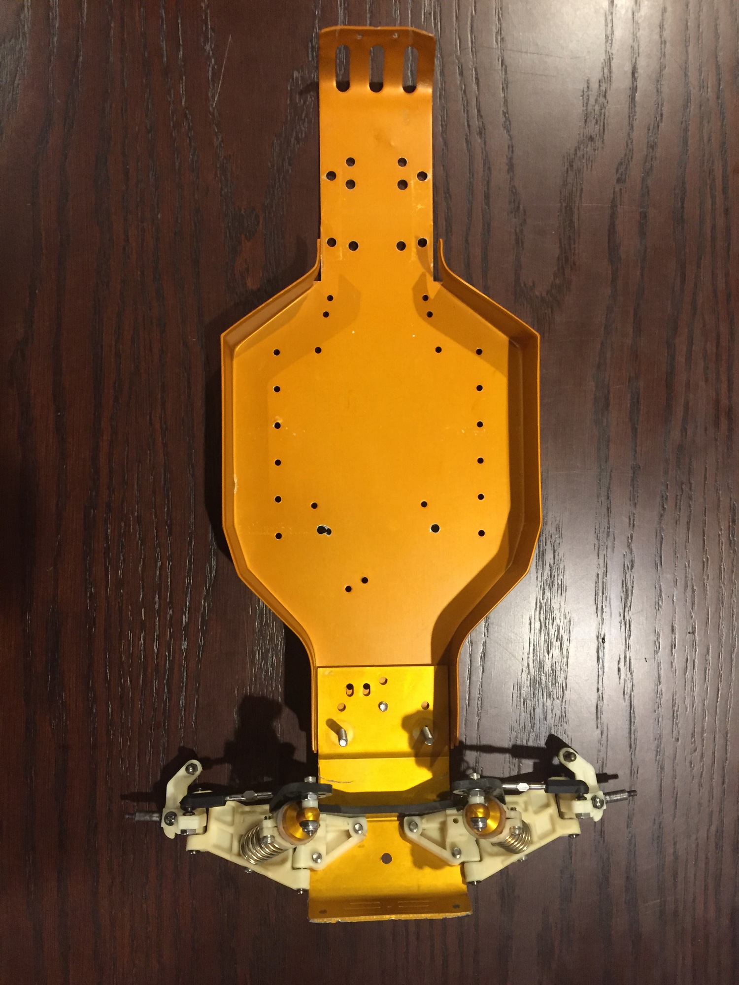

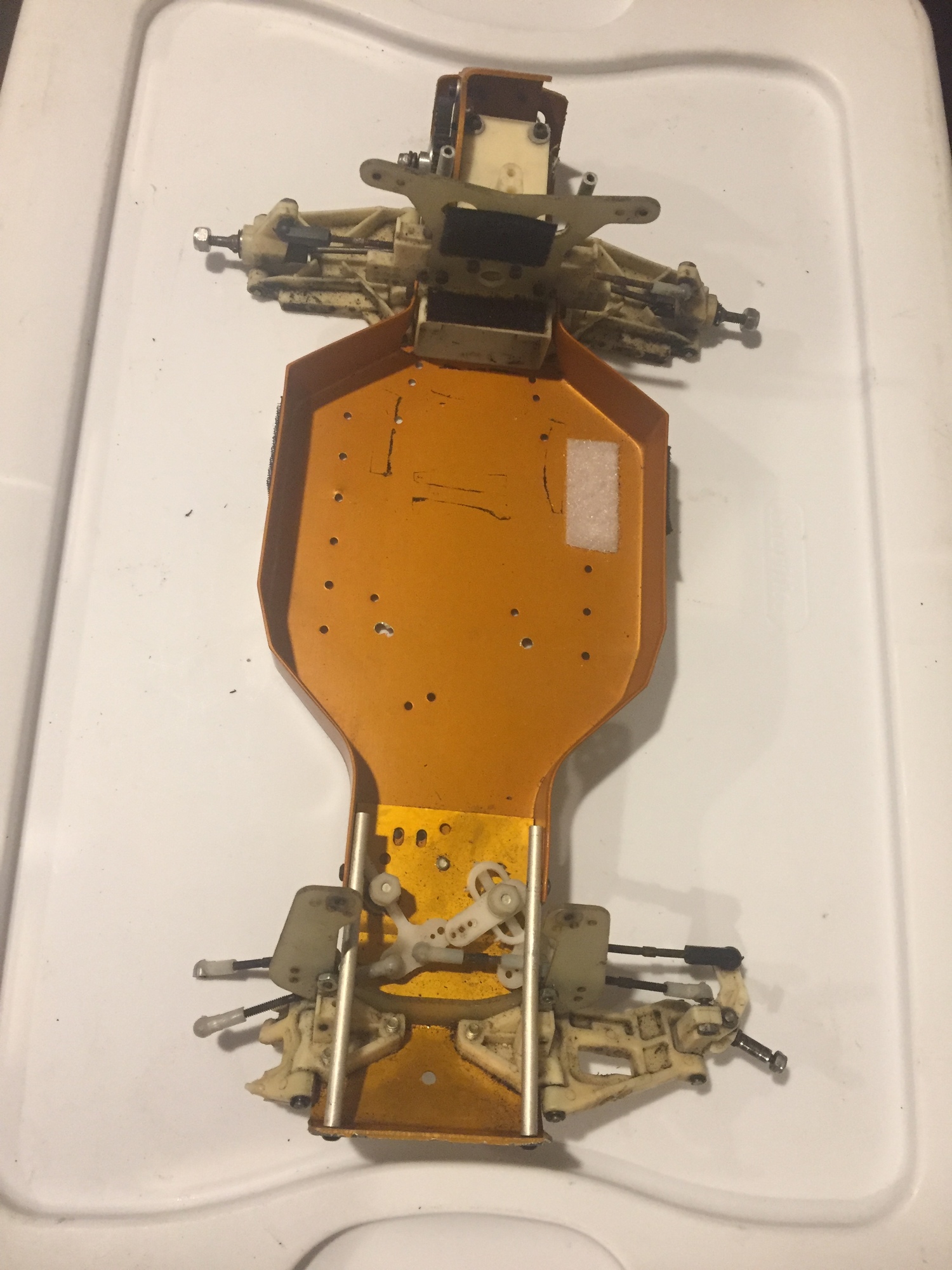

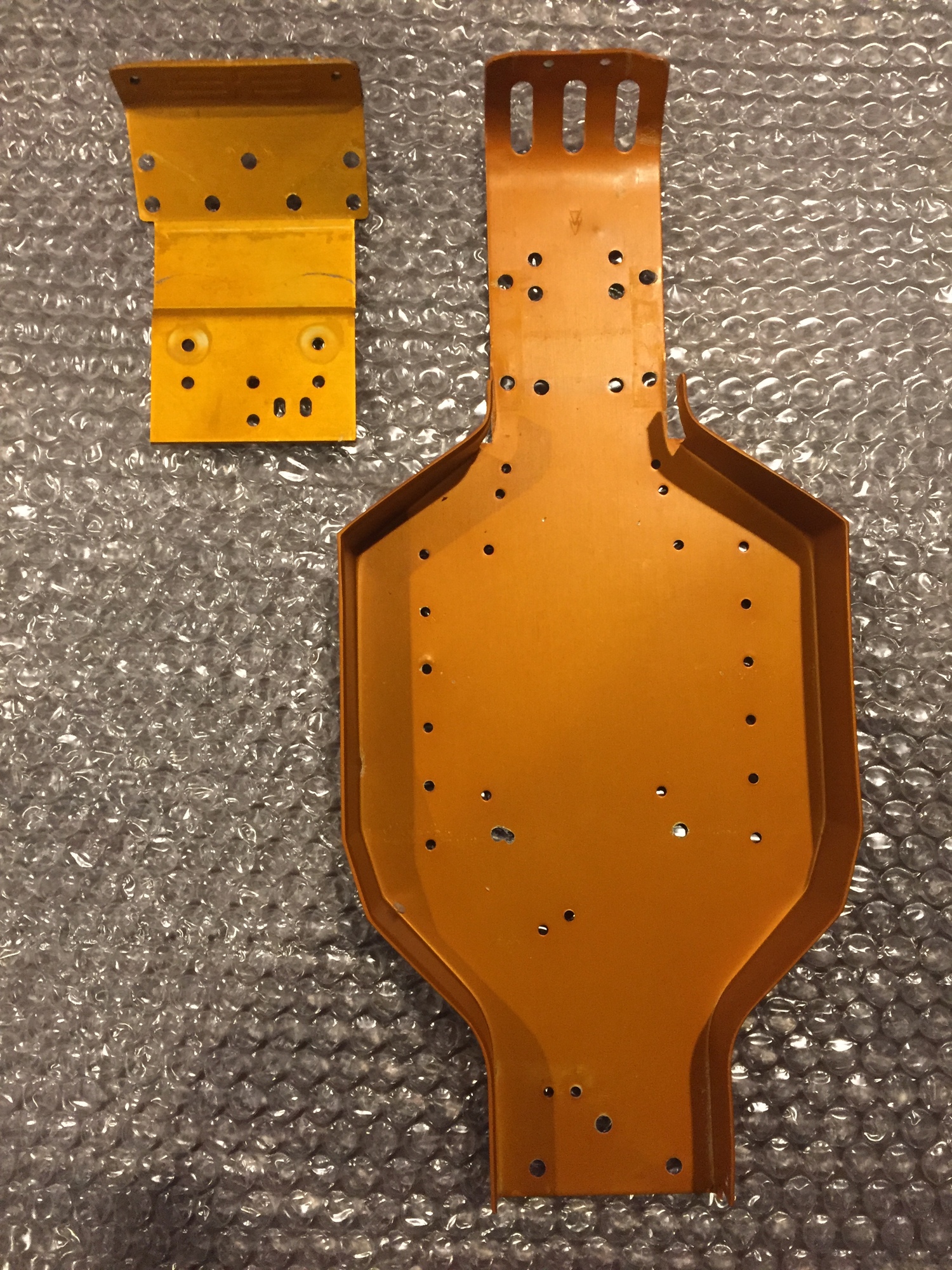

Realizing that I needed more help than I could find online, I searched out a local hobby store for some guidance. The guy took one look at my car and said ‘wow that’s old’. That’s when I knew I was in trouble. He told me that the newer electronics would tear apart the old six gear transmission and tried to sell me a new RTR. I told him I wasn’t interested so, back to the rabbit hole.
First step, tear apart the whole car. I wanted to clean and refurbish everything I could.

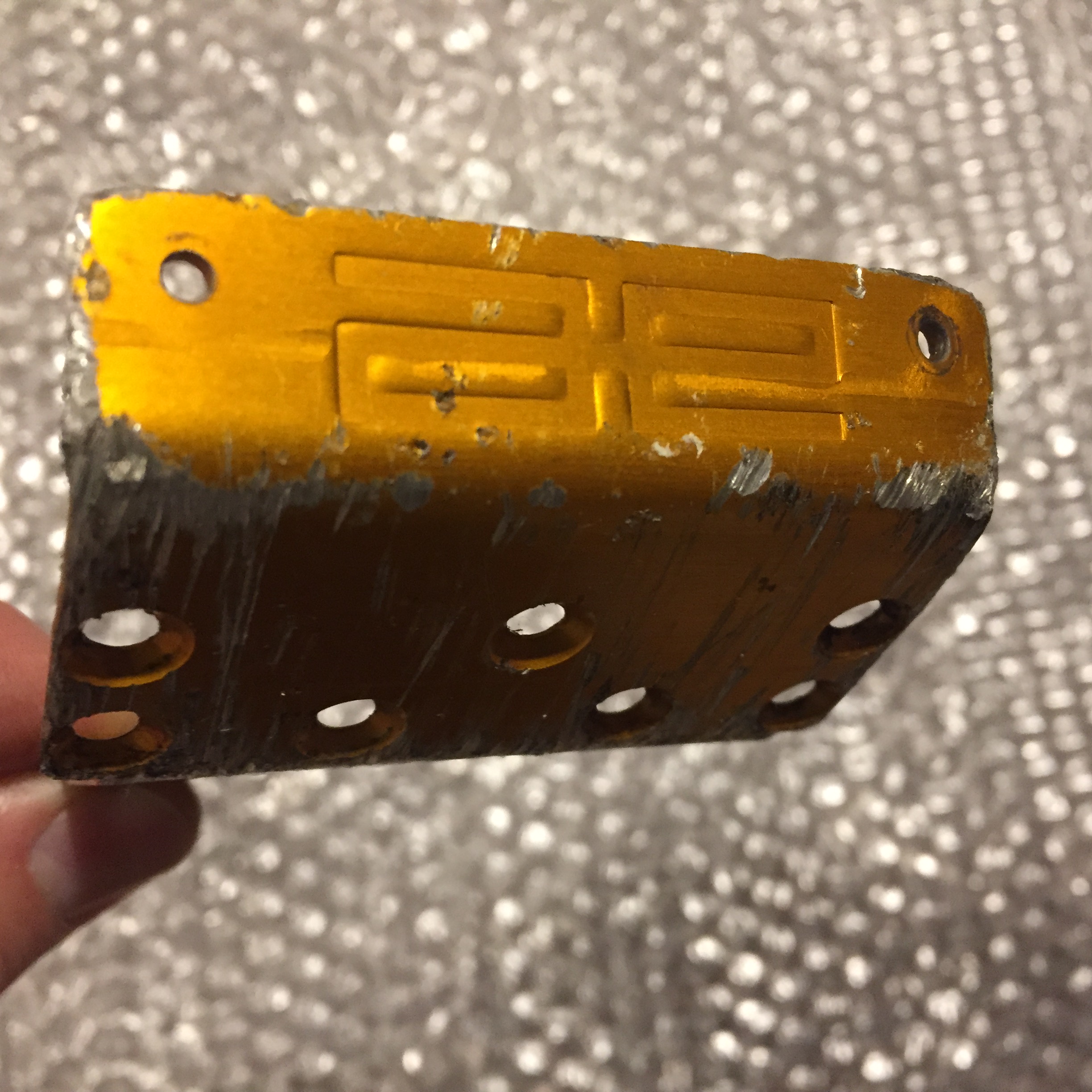

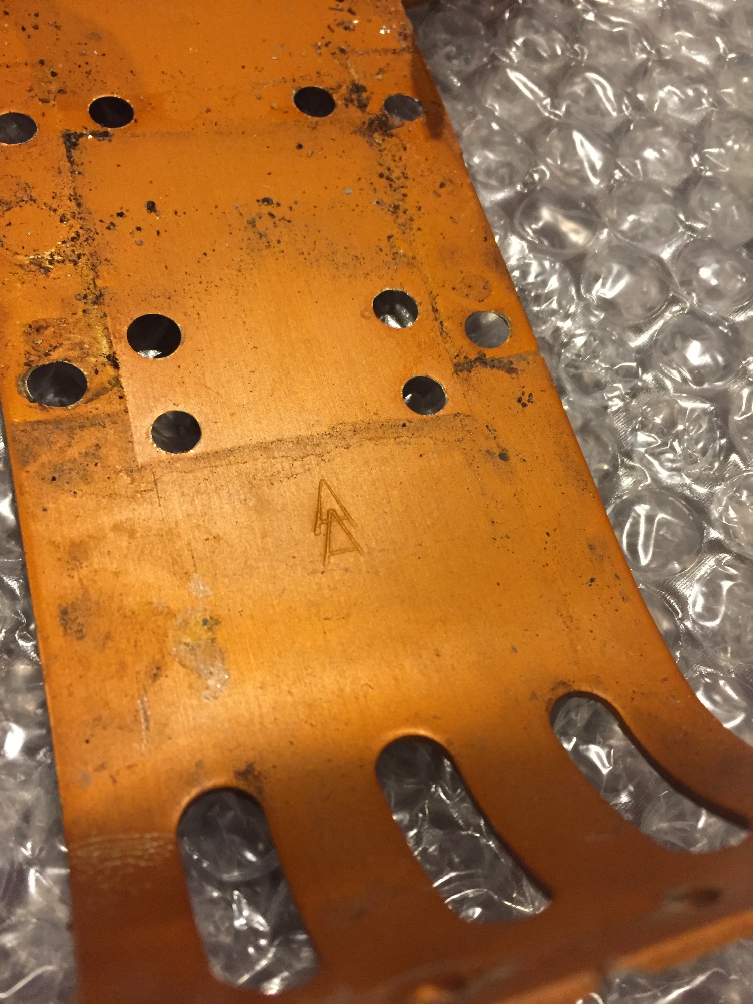

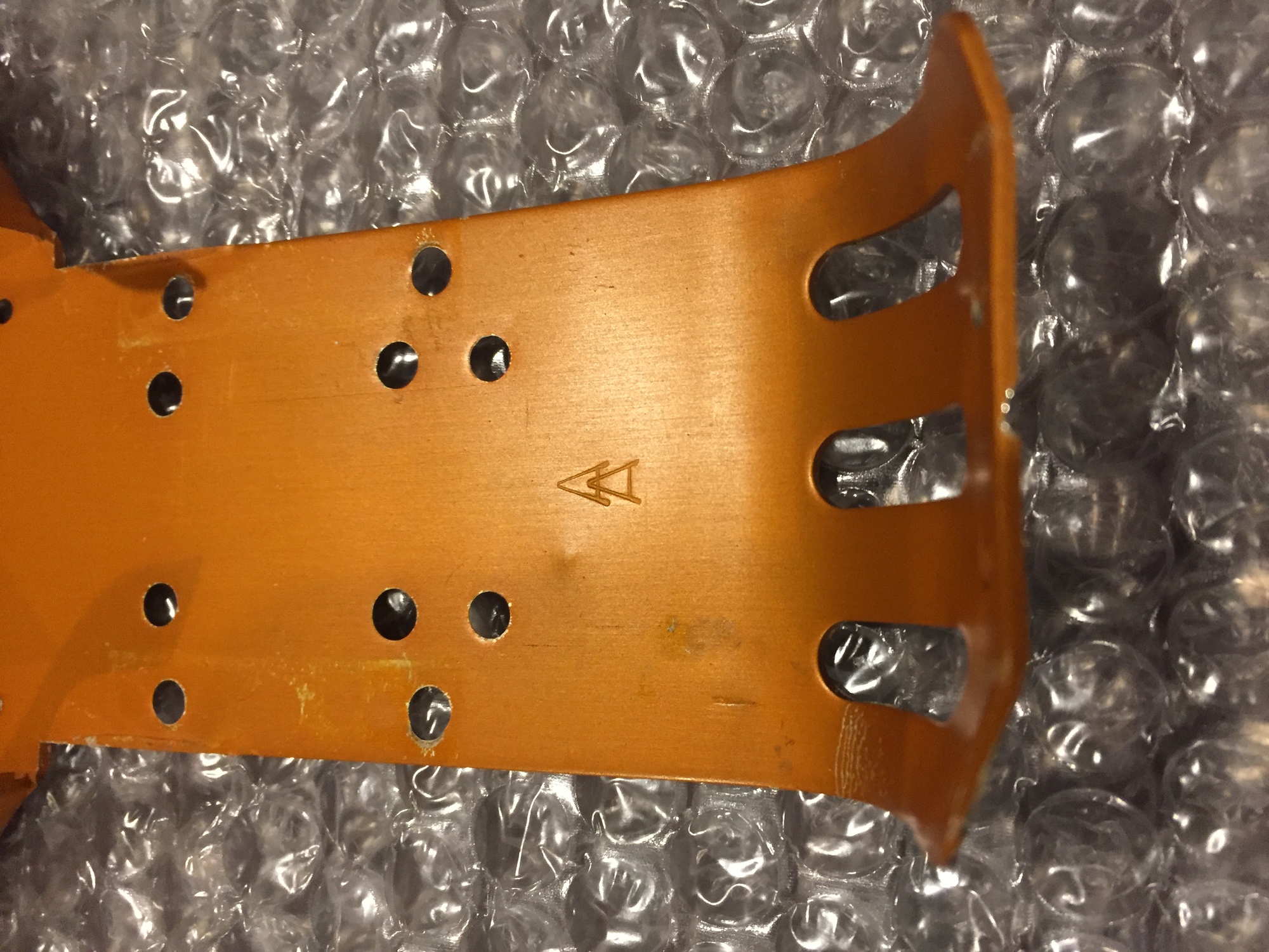

Anyone ever seen a double A stamp?

I learned about the differences between an Edinger and a Cadillac but I couldn’t find the address on my box.

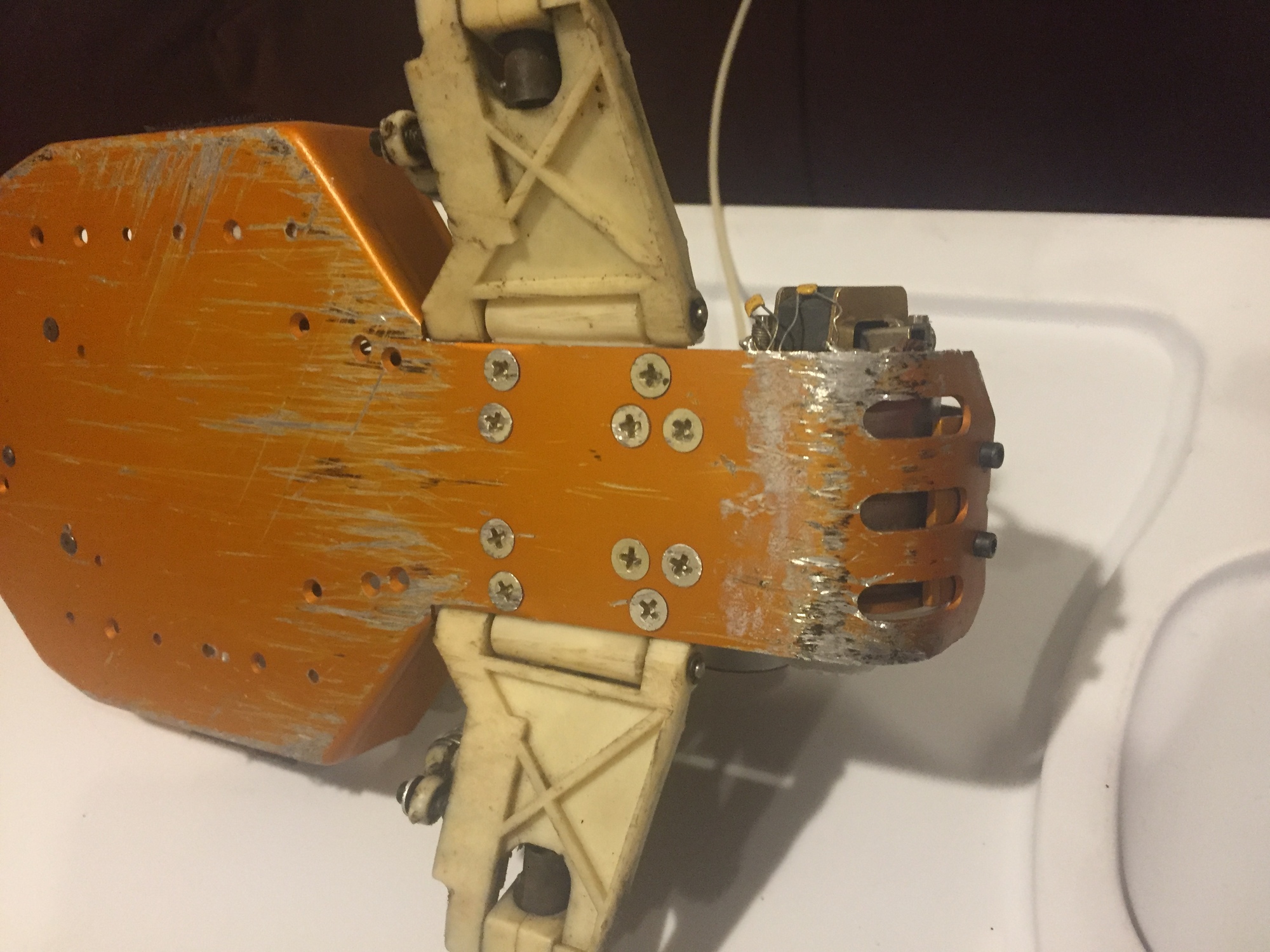

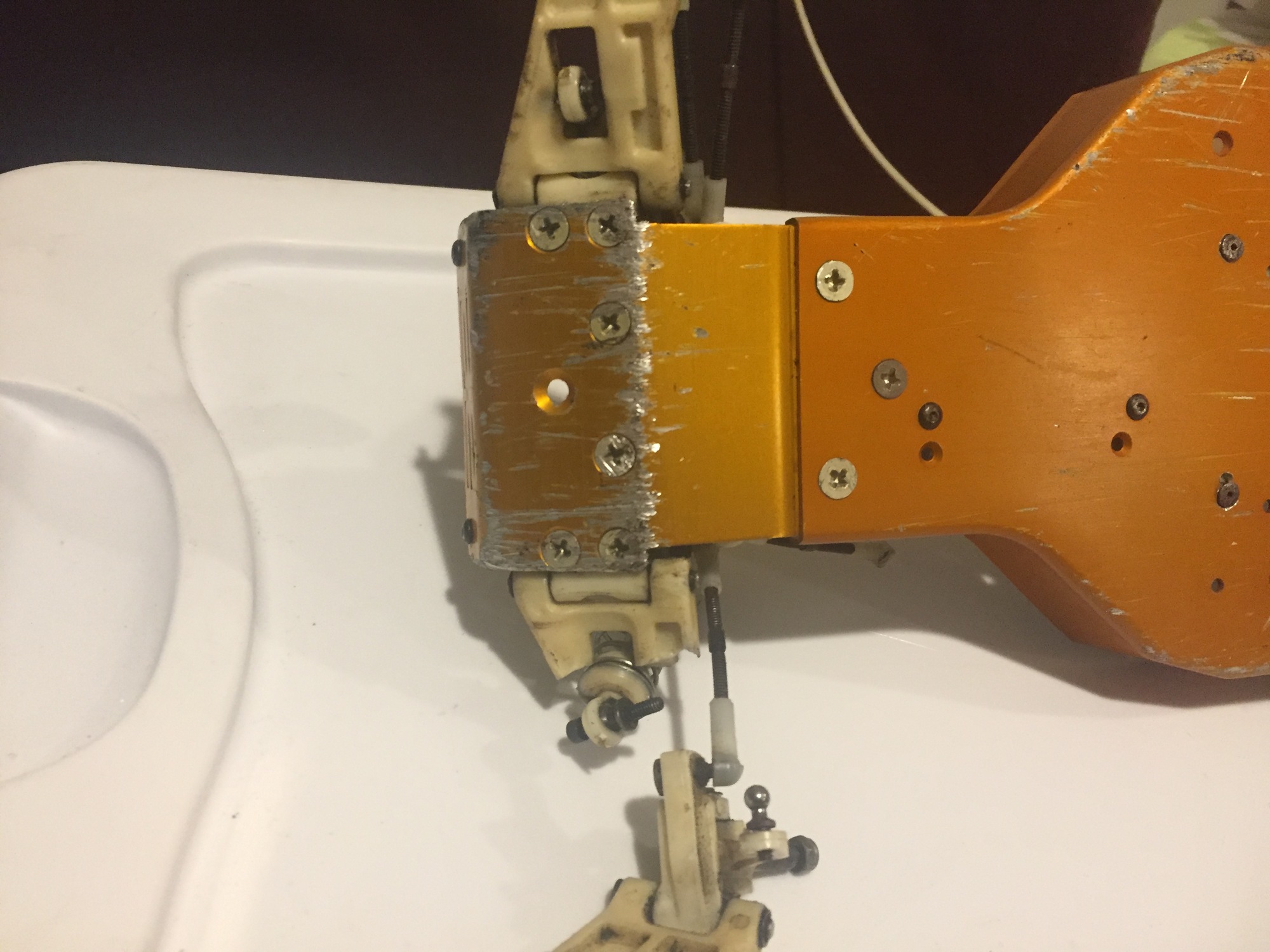

After a little warm water, some dish soap, a toothbrush and a little elbow grease. Nice and clean!

Your car is a CE, all were Cadillac Ave.
The front suspension and wheels are a dead giveaway, as well as your instruction manual.

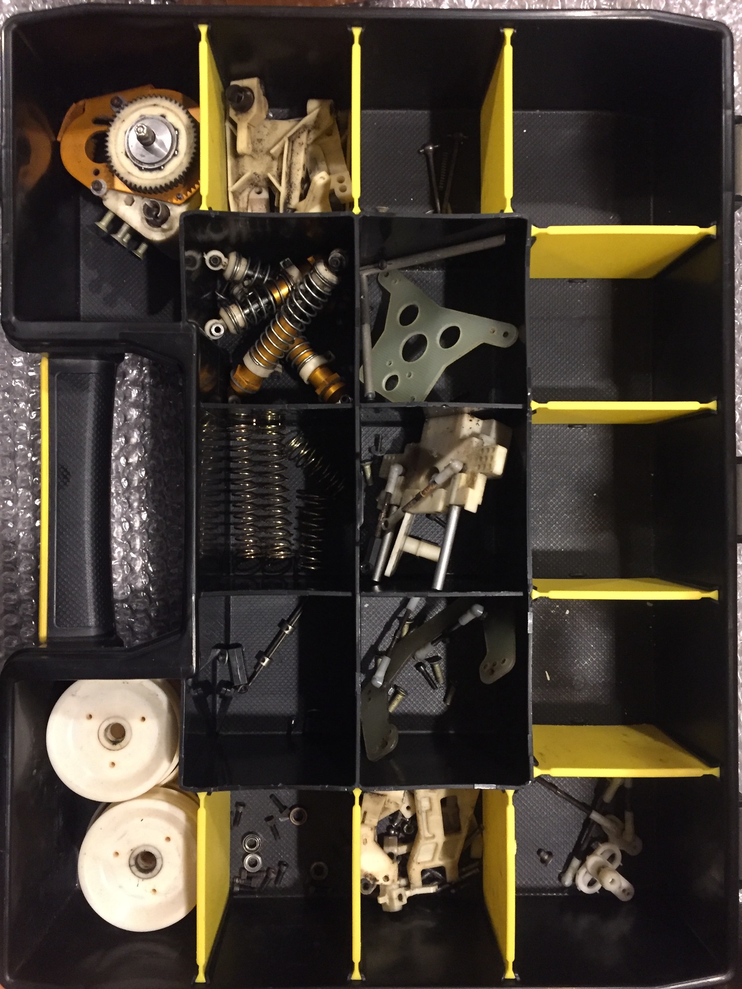

I don’t have a place to set up and work on the car so this parts case keeps everything organized. I set up everything and work on it at night while watching old sitcom reruns with my wife. She looks at me and smiles as if to say ‘I love you’ or ‘you’re an idiot’. Probably a combination of both.

After the move to Cadillac Ave, everything was produced there through the B3 (maybe B2).

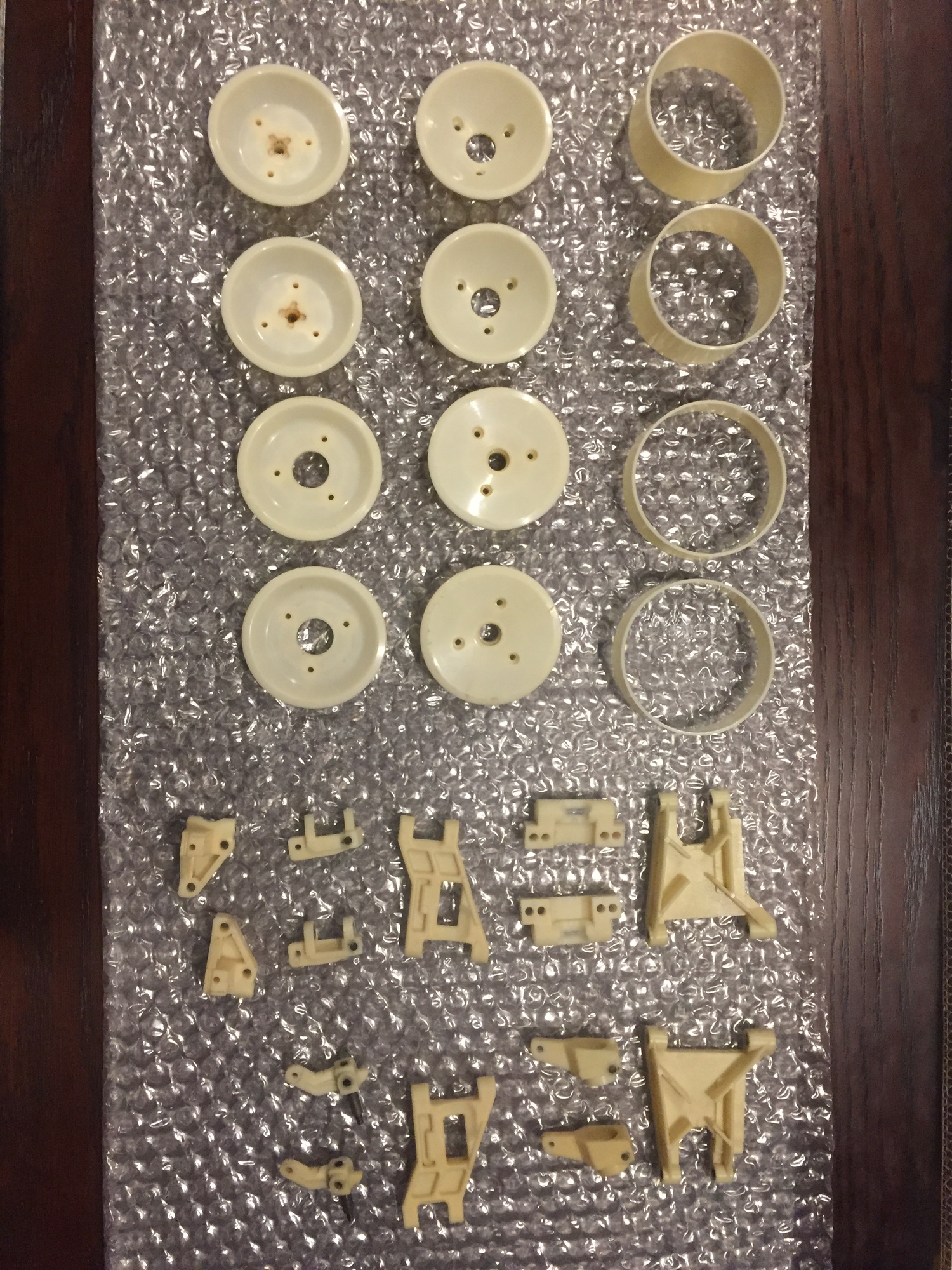

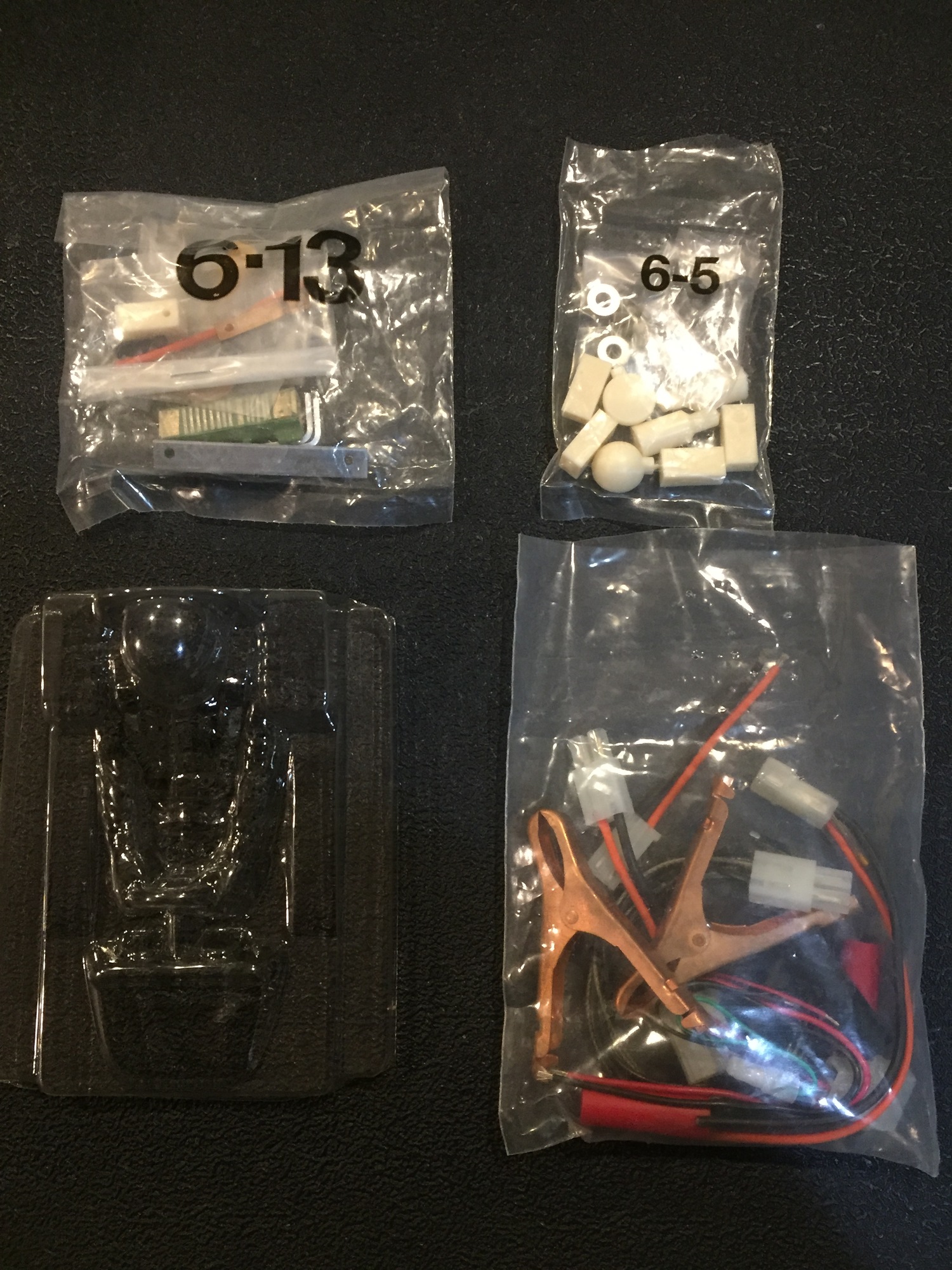

Some leftover original parts.  Mechanical speed controller in a bag never opened and original driver unpainted.

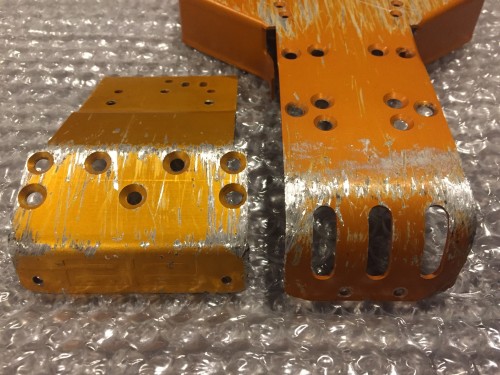

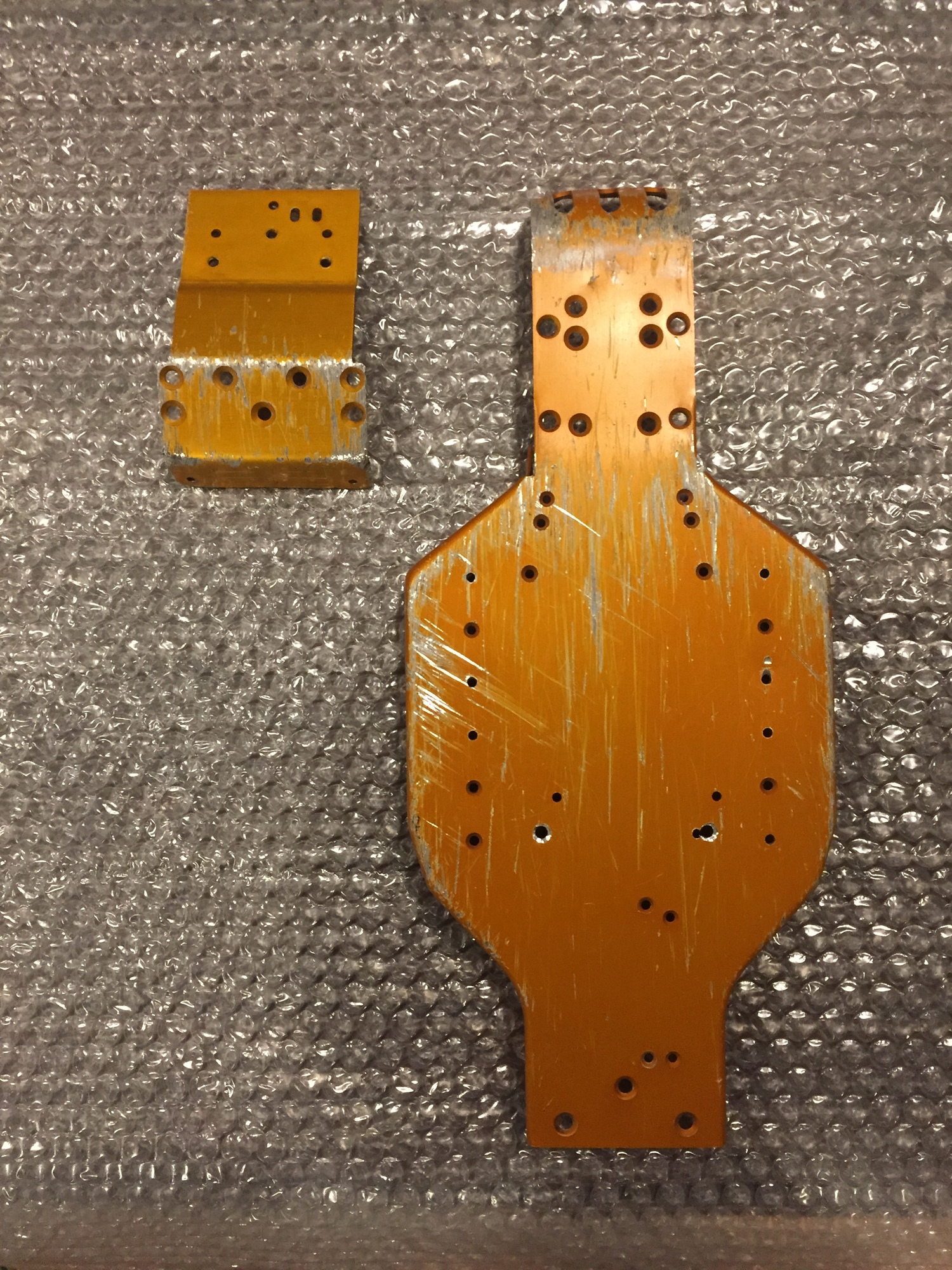

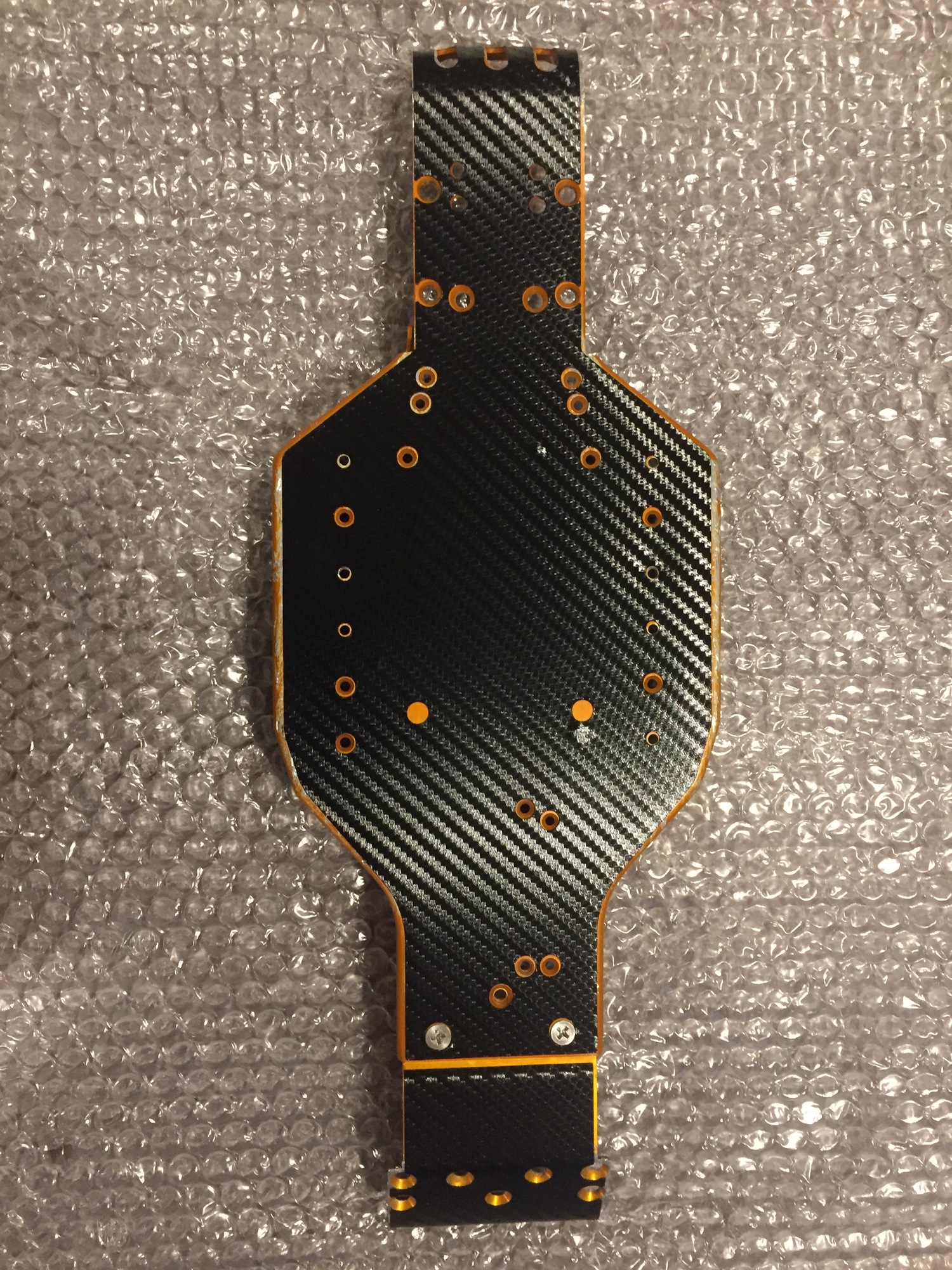

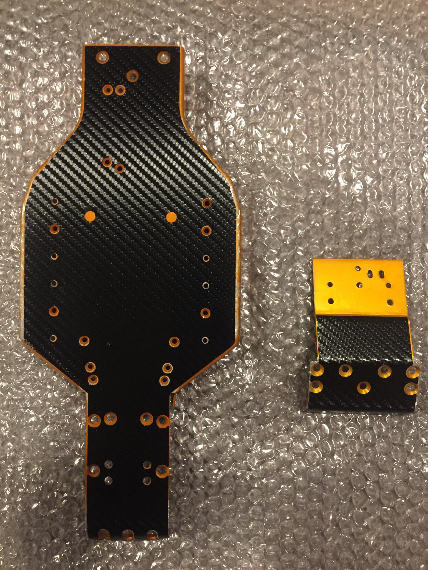

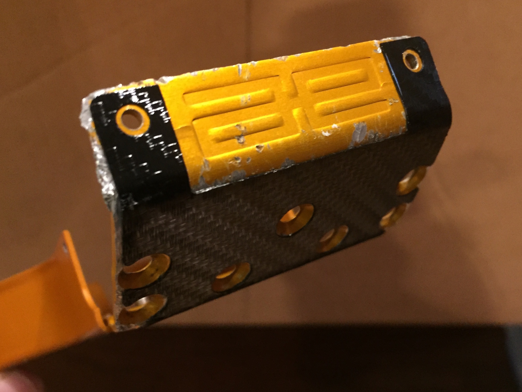

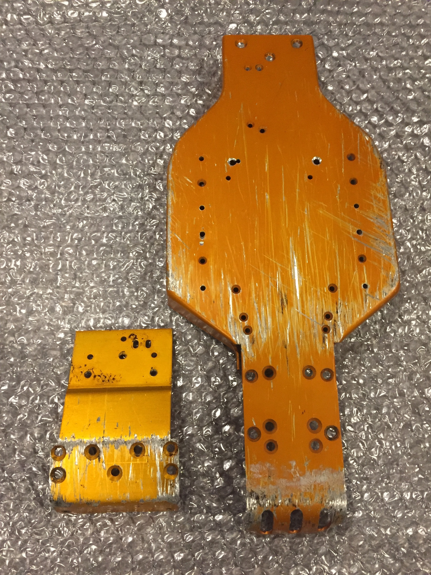

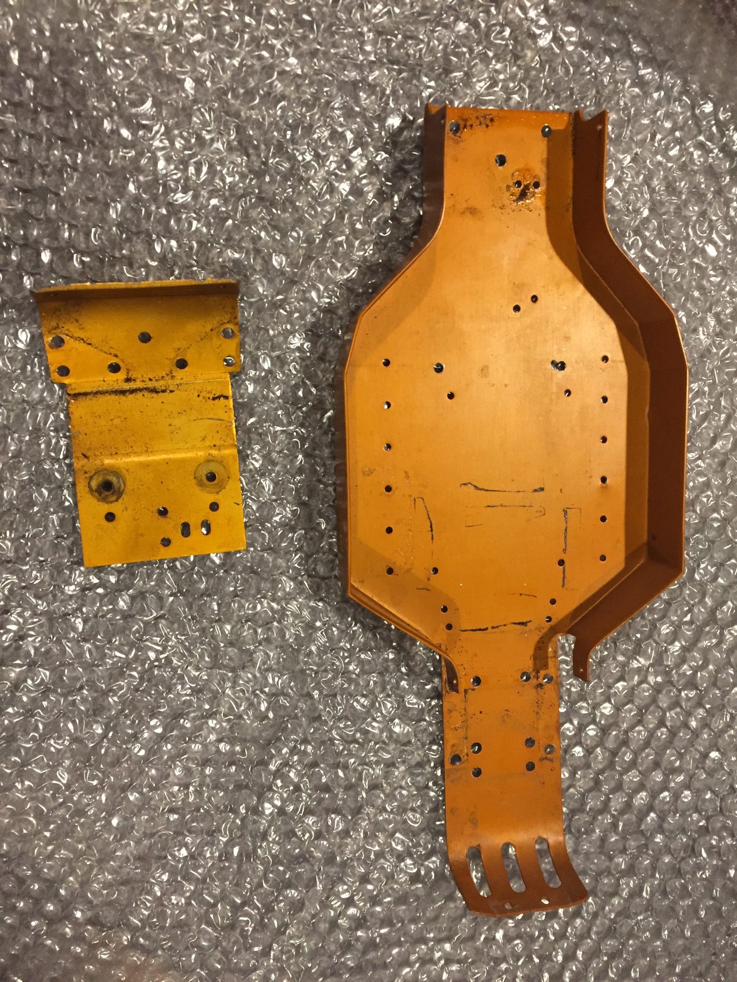

I found this carbon fiber look vinyl chassis protector on eBay. From team picco mx. Since the bottom is so scratched up, it’s no big loss.
I cut out the front to expose the logo...like a hood ornament.  Rolls Royce has the spirit of ecstasy, Chevy has the bow tie, we have this.  It always reminded me of the Delorean logo.

You can buy repo mci decals and have it look box art again. Make it happen! Nice rebuild.

TheDiamondOne wrote: Sat Jan 30, 2021 6:00 am You can buy repo mci decals and have it look box art again. Make it happen! Nice rebuild.
Thanks! It’s been a lot of fun building so far. I saw the decals from mci and contemplated going the box art route. I have something else in mind-not sure if it will look as good as I think it does in my head but we’ll see. I’m sure you guys will let me know if it’s cool. If it goes south, I can always get another body.

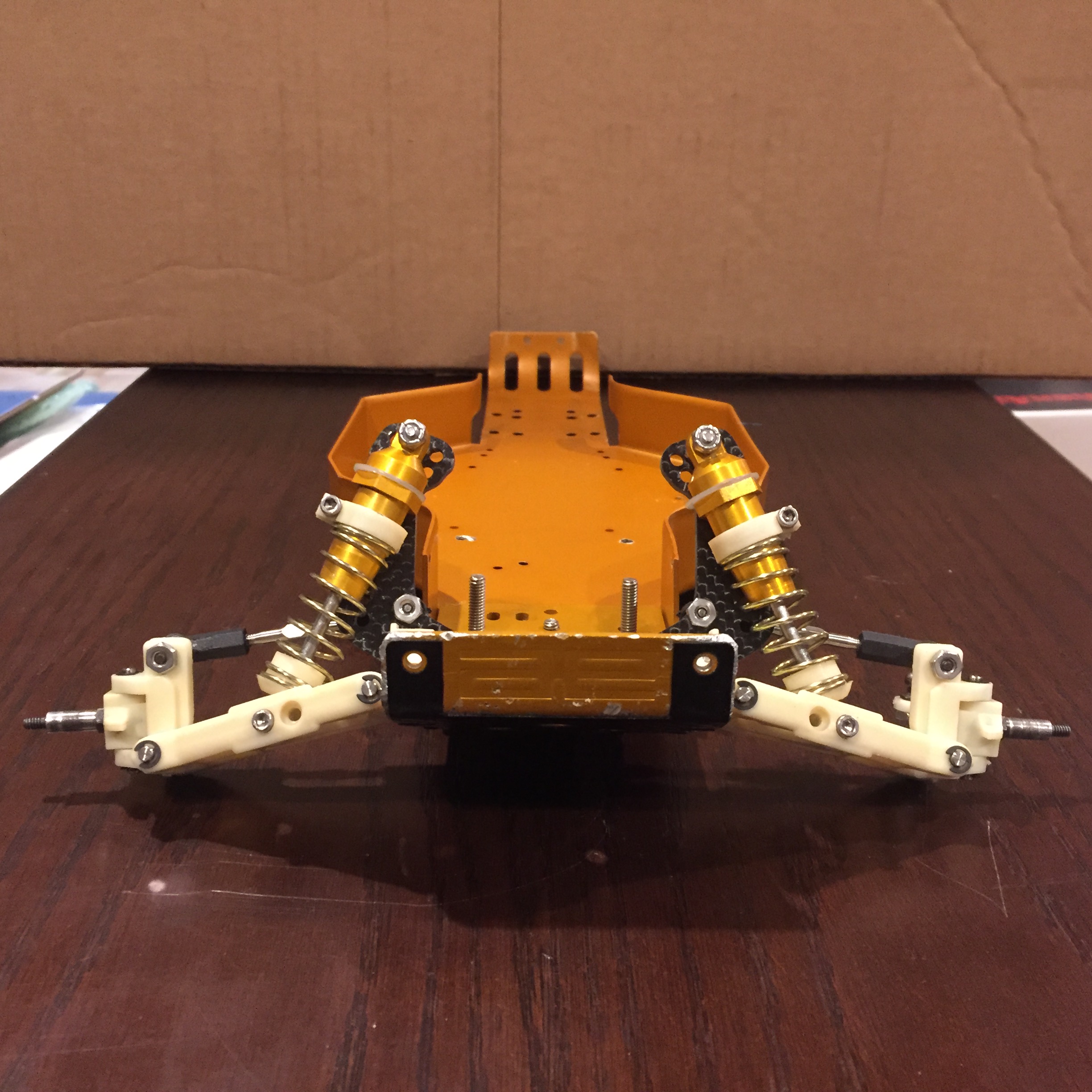

Post by AVguy »

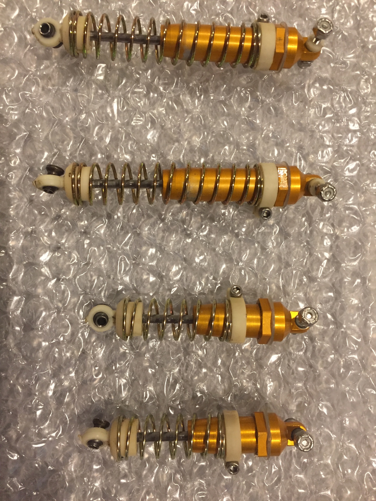

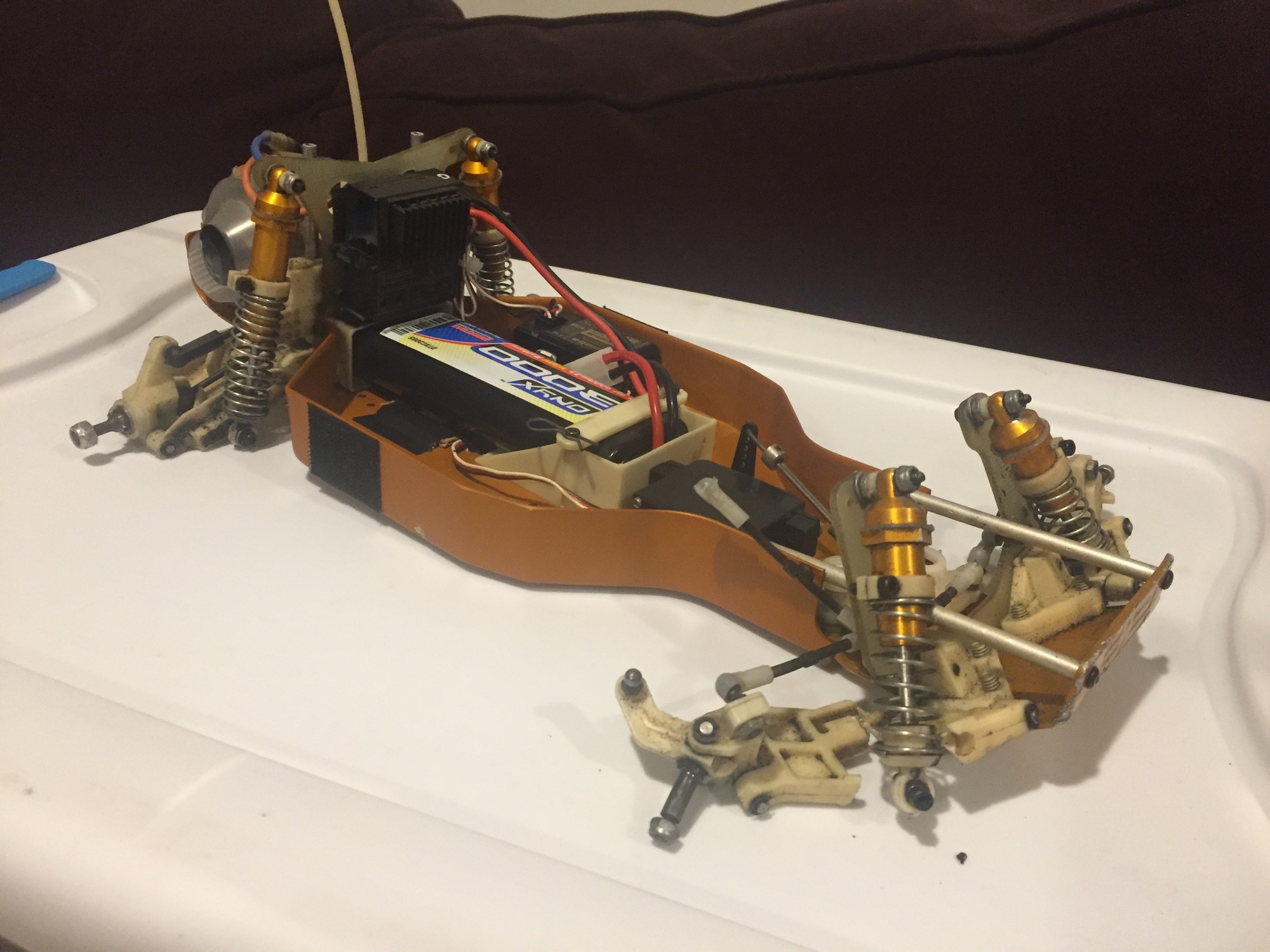

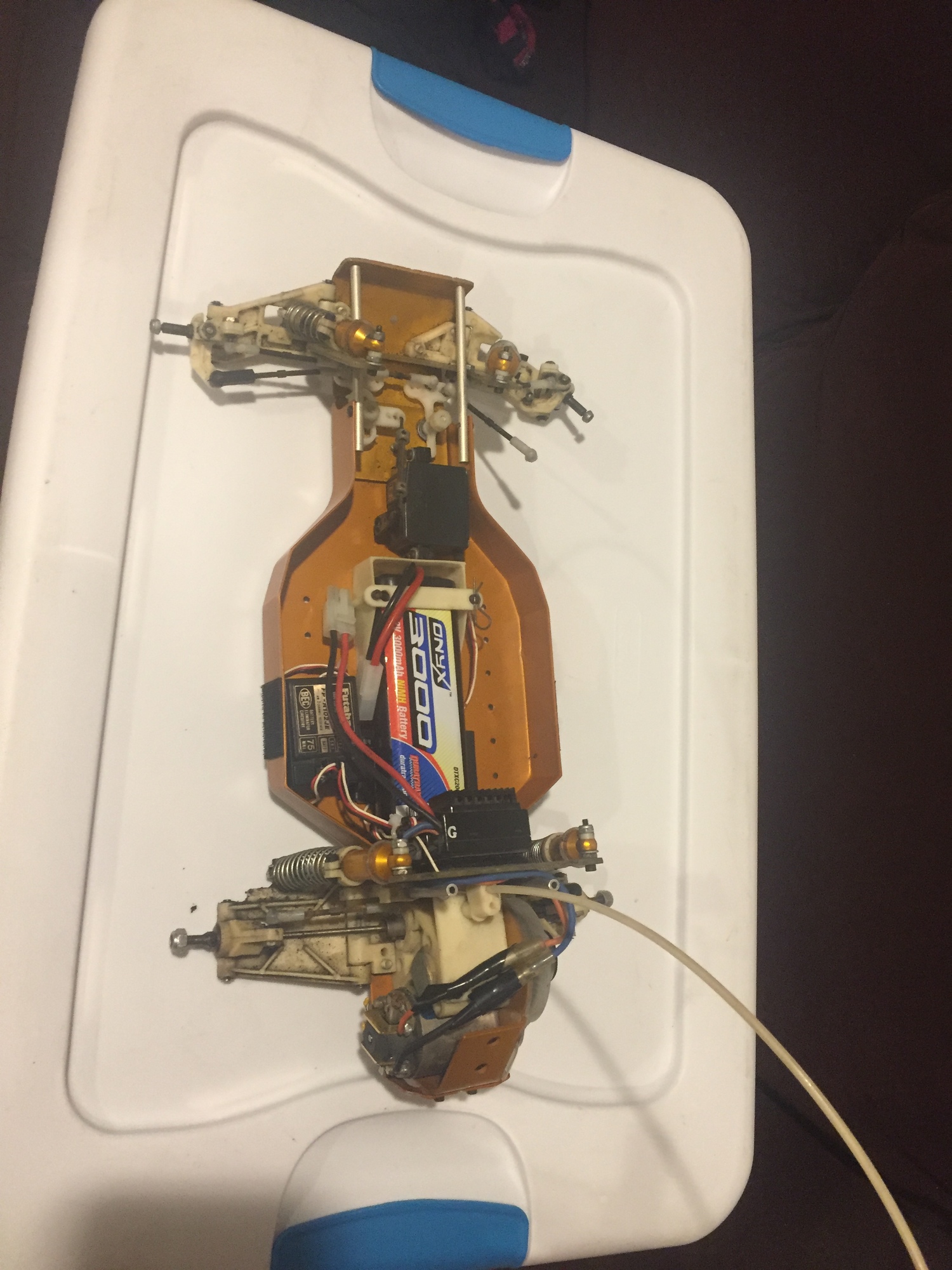

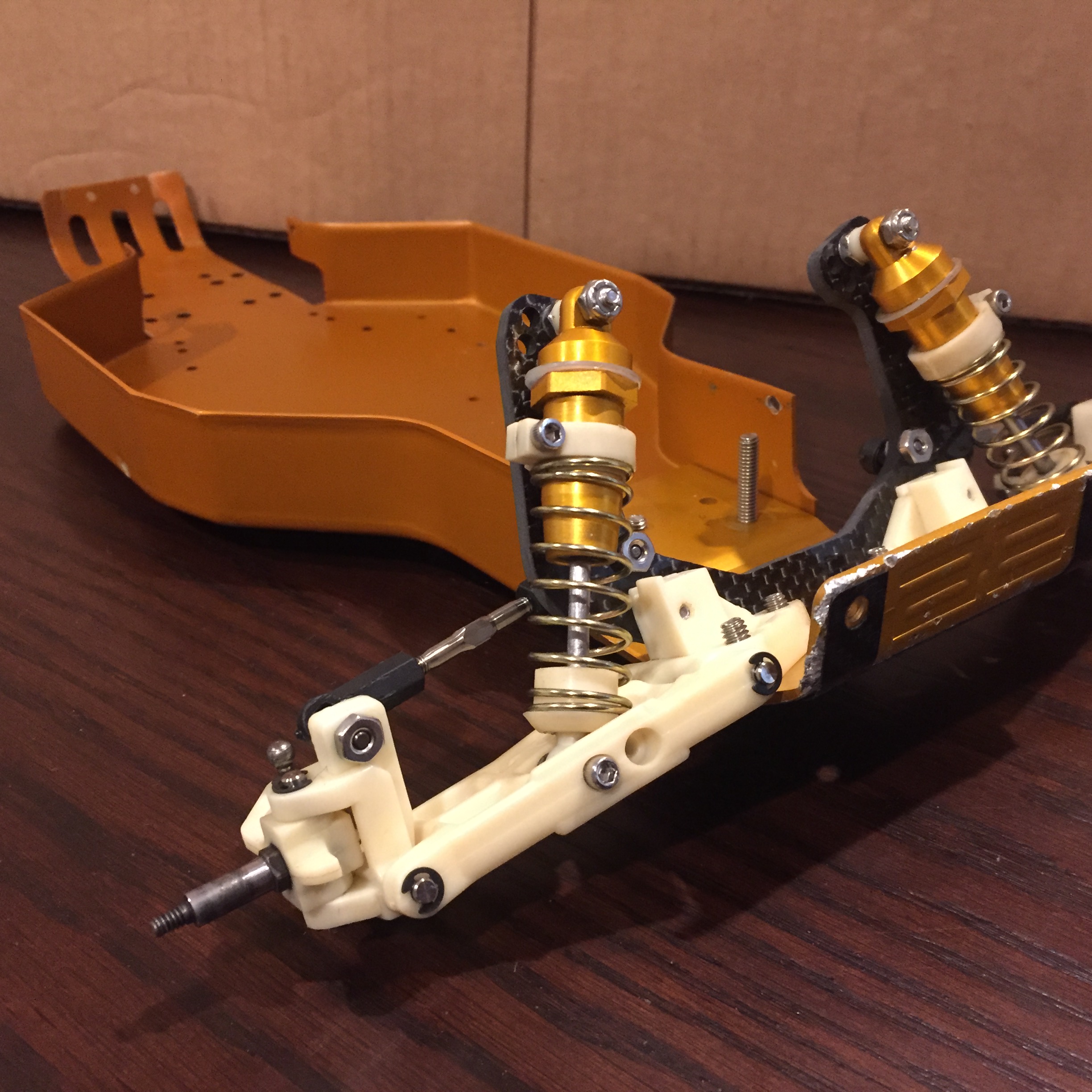

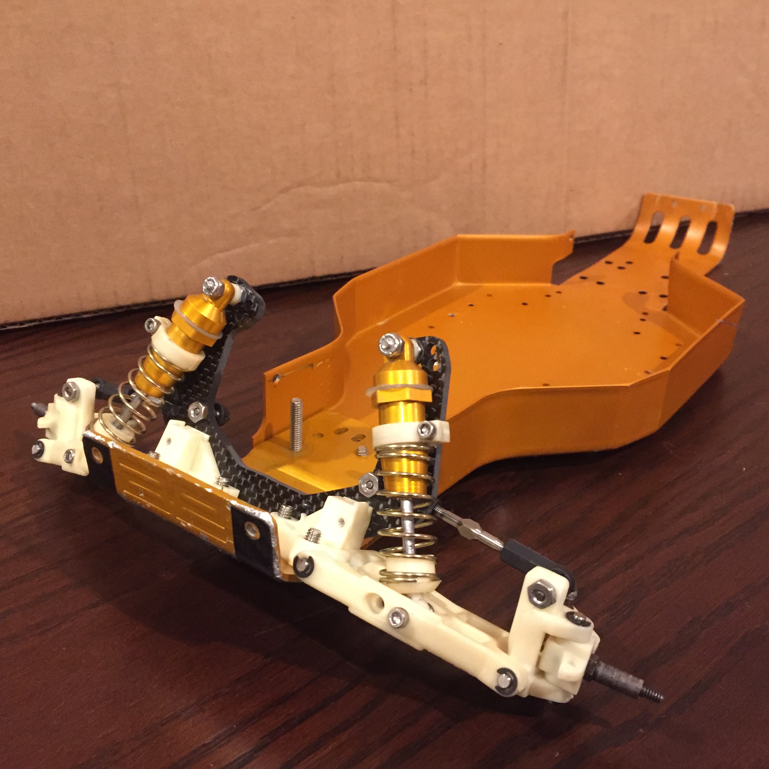

I ordered the stainless steel screws from KNK, titanium hinge pins and turnbuckles from Lundsford racing and started rebuilding. Also, got the carbon fiber front shock tower from Vintage RC. I gotta say, I’m loving the black and gold color combo. I also ordered the RPM ball cups but realized that they are too big and the steering rods hit each other. I ended up ordering the appropriate associated ball cups in black.
I rebuilt the shocks with 30wt oil and used the gold springs that came with the car. Not sure how it will affect the handling because they are stiffer but we’ll see. I was going to use the silver ones again but the’ve been on the car for decades.

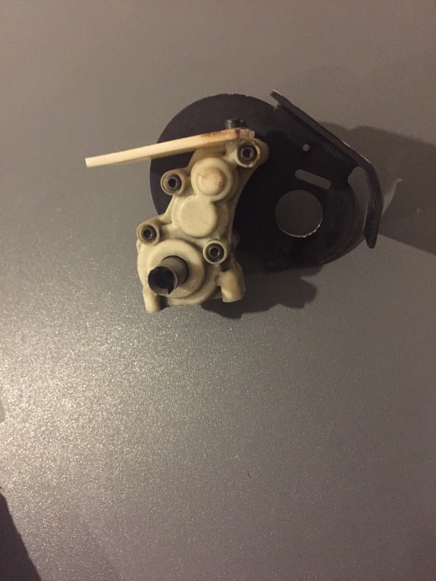

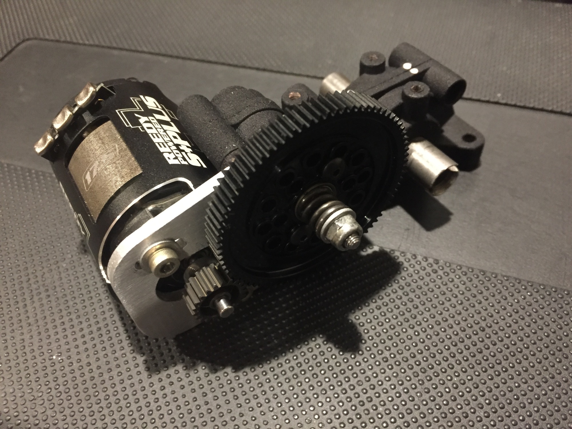

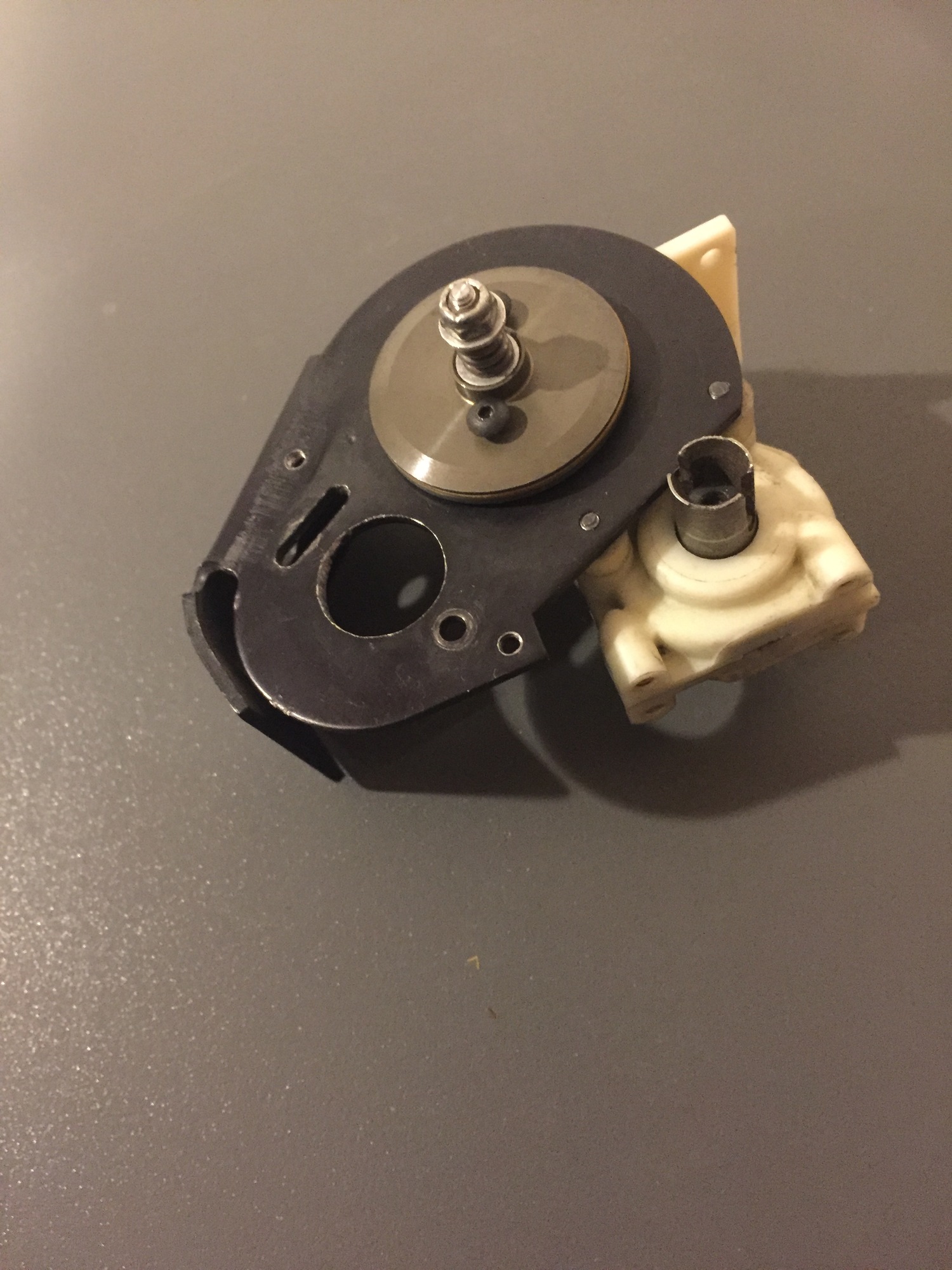

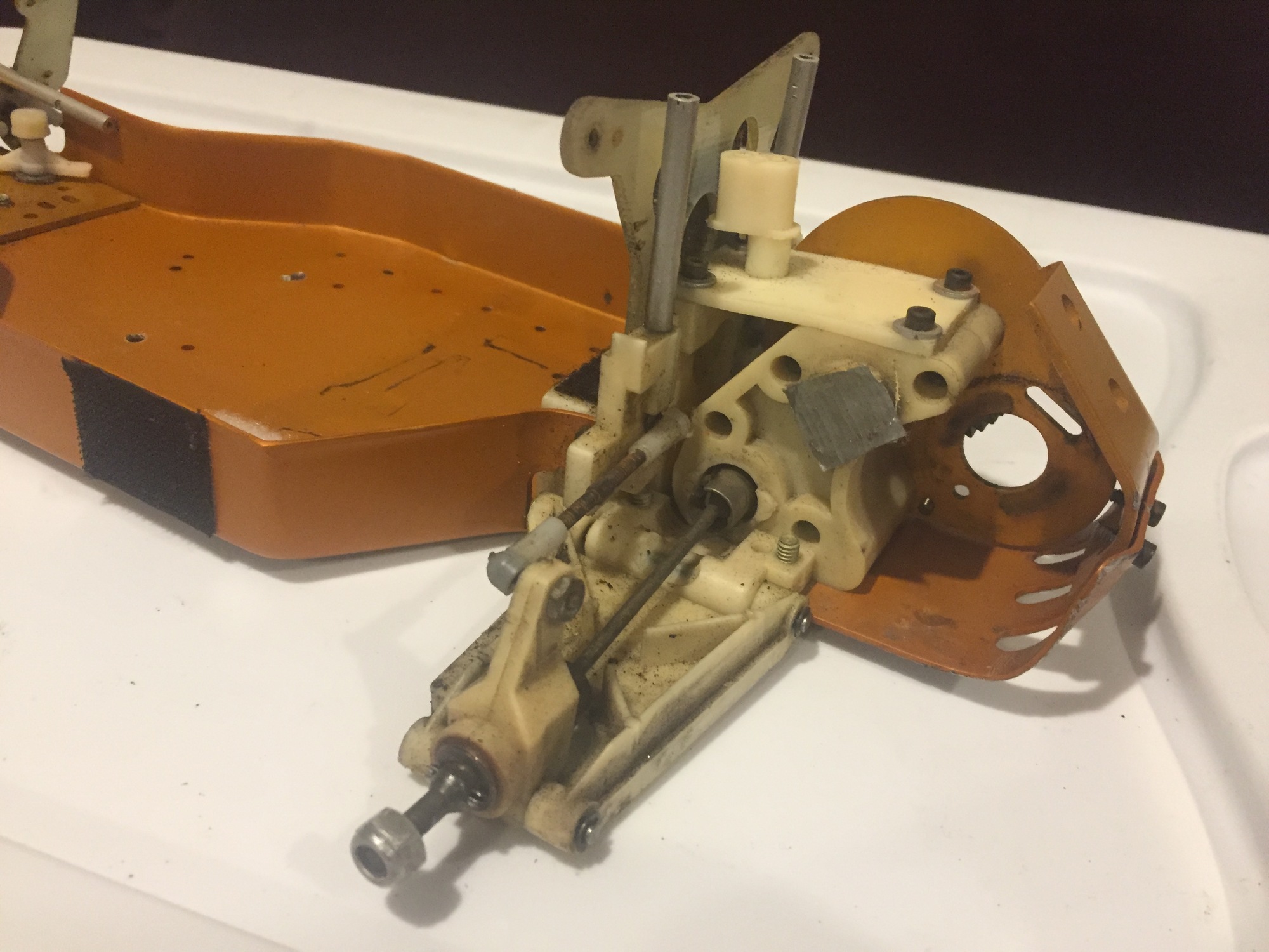

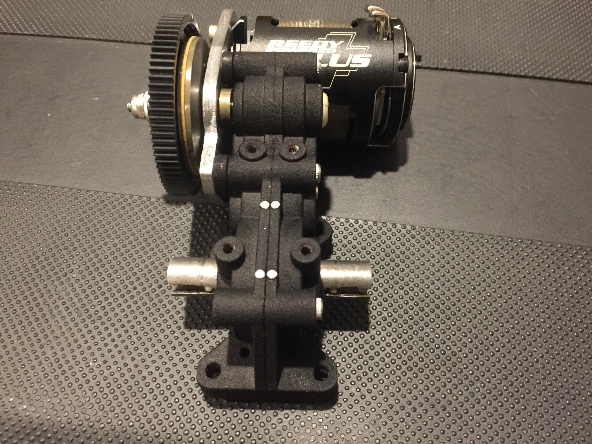

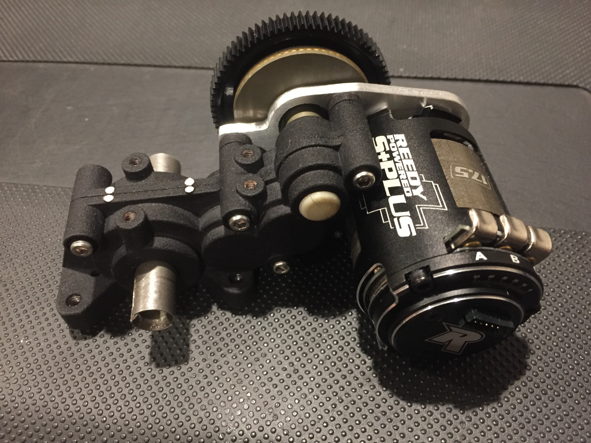

I decided at the beginning of the build that I wanted to use a stealth transmission because it can handle the power of the newer electronics. But, I didn’t want to drill out the chassis. I came across a YouTube video for a mid motor conversion for the RC10 and thought that was a great idea. I contacted Brian Conklin and ordered the B1M conversion kit. He was very gracious and answered all my questions. I also found a stealth transmission on eBay.

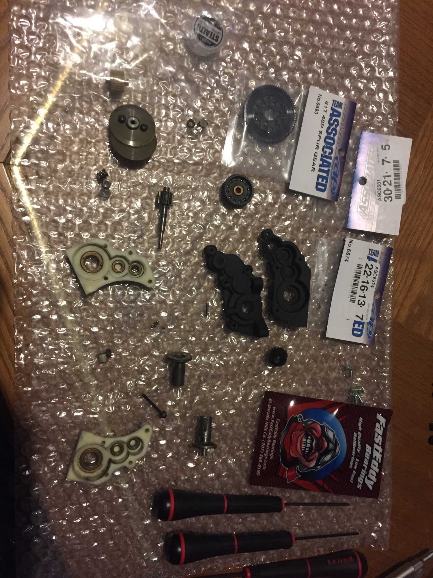

I had ordered the classic RC10 ball bearing kit from Fast Eddy but quickly realized that it didn’t have the correct bearings for the stealth transmission. I contacted them and was told that I needed the RC10T kit so I ordered that as well. Turns out, I needed both kits.
The T kit had all the correct bearings for the front wheels and the transmission except the bearing for the top shaft. That one, along with the bearings for rest of the car were in the classic kit.
At Brian’s suggestion, I ordered an 81T spur gear and 21T pinion. He also directed me to this forum. Thanks Brian!
