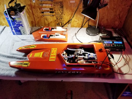

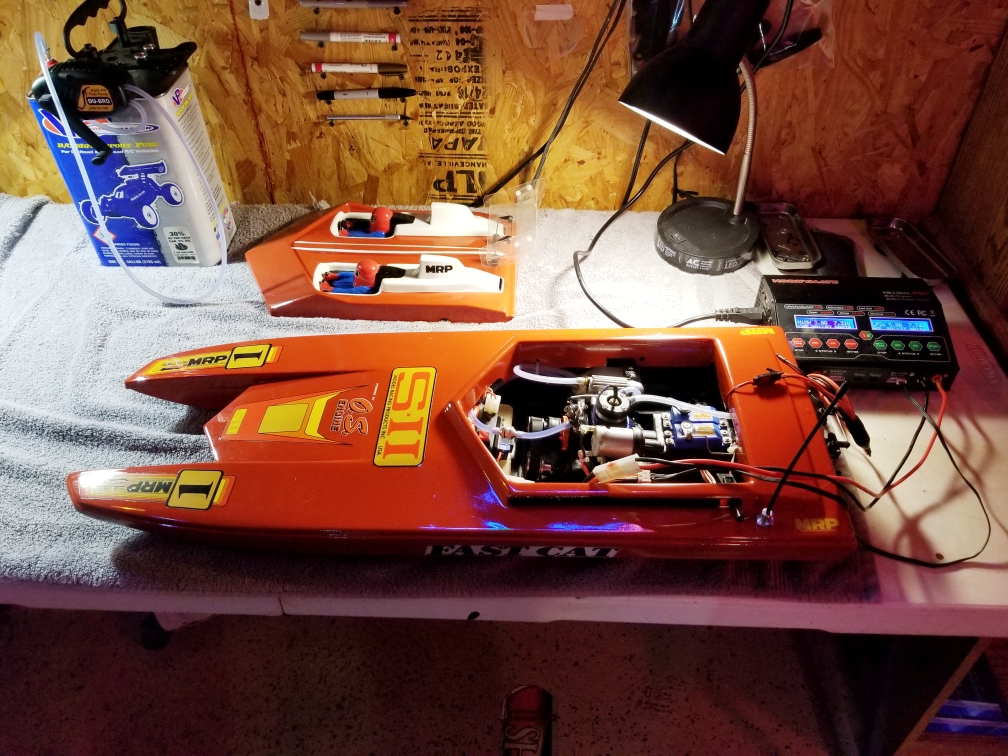

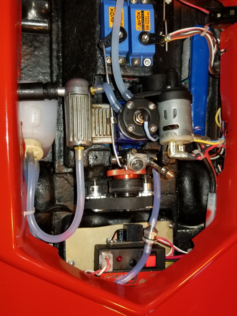

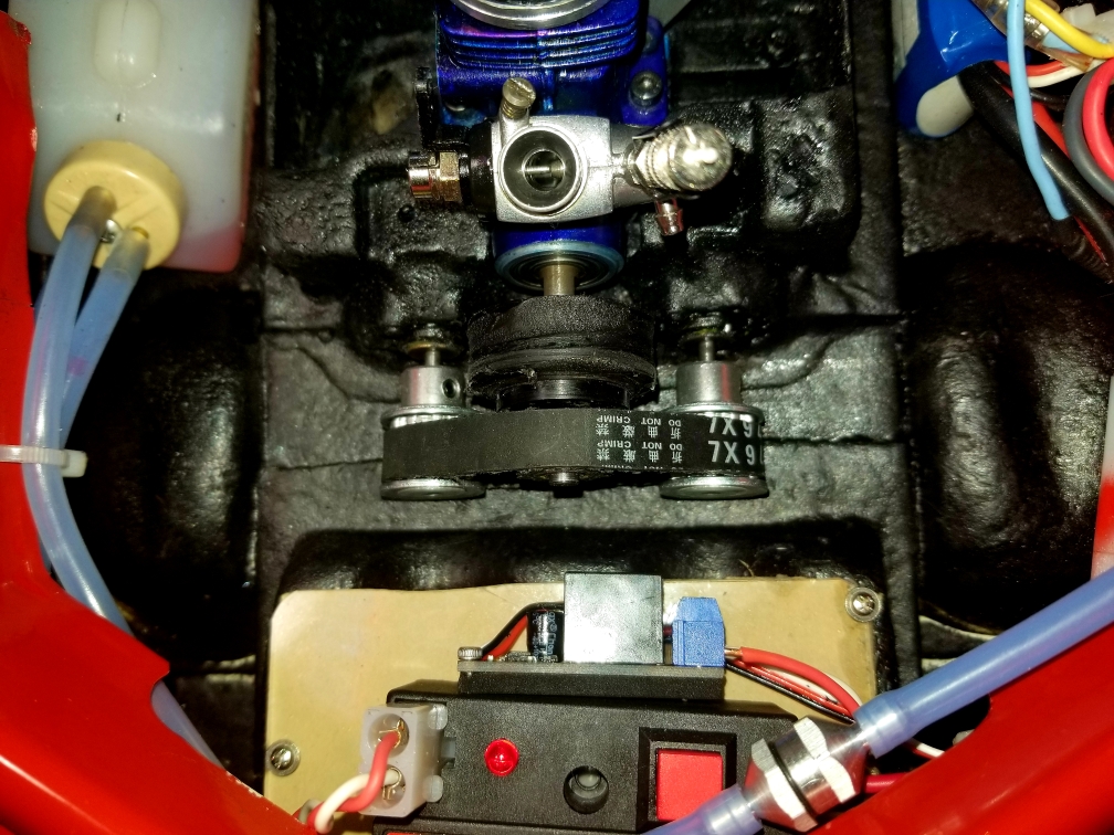

mocking up a belt drive setup using an old Nitro Brute clutchbell....waiting on parts but u get the idea.
The gear fell off the clutch yesterday when i was free revving it so i needed a better setup...plus the props will be spinning a tick slower than the crankshaft now (10t clutchbell/12t propshafts)whereas the other setup had them spinning 50% faster than the crank...the 1st and only lake test so far was a total disaster....water in the boat, wouldn't plane off, head gasket leaking oil into the boat,cracked engine mount, cracked starter control mount....am i missing anything
i got it all fixed except the belts/pulleys/clutch i am waiting on

Re: MRP FAST CAT
belt drive done....smooth as silk on land....too bad i am scared to throw it in the lake
