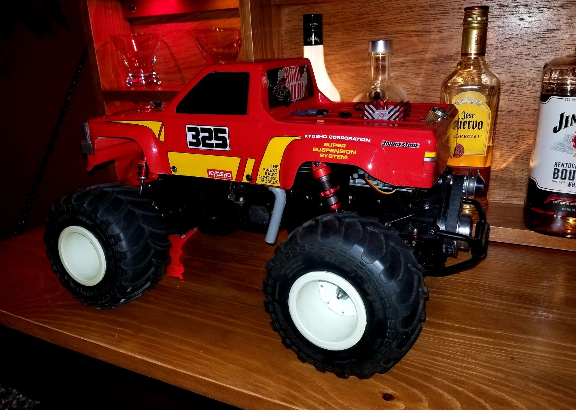

Poor quality Nitro Brute video. Look how cool it looks with the big tires before Derek ruined it!

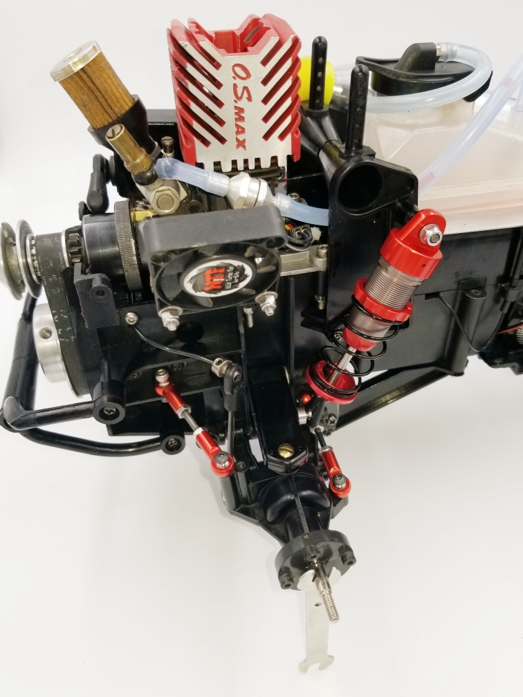

Rear shocks came in....worked so titties! Smooth! getn a set for the front as they come with soft springs too which i didnt know.

Those tires should definitely be a little easier on it. Those giant meats were cool, but has to be hard on that trucks internals.

They were, this is much better setup.

In your vid, it looks like the right side has alot of play in the axle thru the bearing. Check that...does the truck have full bearings? it needs to. On the left side (and probably right side too) alot of play is coming from the rod ends. Mine had that to...if u look 2 pics up, i installed rod ends on the backside of the rear knuckles too. It eliminated all the slop....i have none and this thing was a pile when i got it and gets ran quite often....heres a link to the rod ends i used...but the stock black ones work good too they just popped off if i hit anything and these cant:
https://www.amazon.com/10Pcs-Joint-Aluminum-Metal-Holder/dp/B07H4MXNKY
As far as the shims in my gearbox mine is different than your big brute. About the only similarities inside there would be the 3 bevel gears in the diff gear. Thats where i shimmed both sides with an o-ring inside before the output shafts were put thru the gearcase. I also drilled the bevel gears out and put steel pins thru them, the gears kept falling out of the diff gear. Not i single issue since these changes
