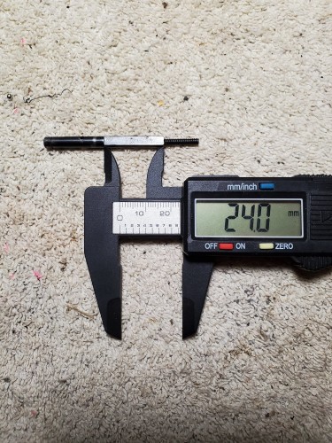

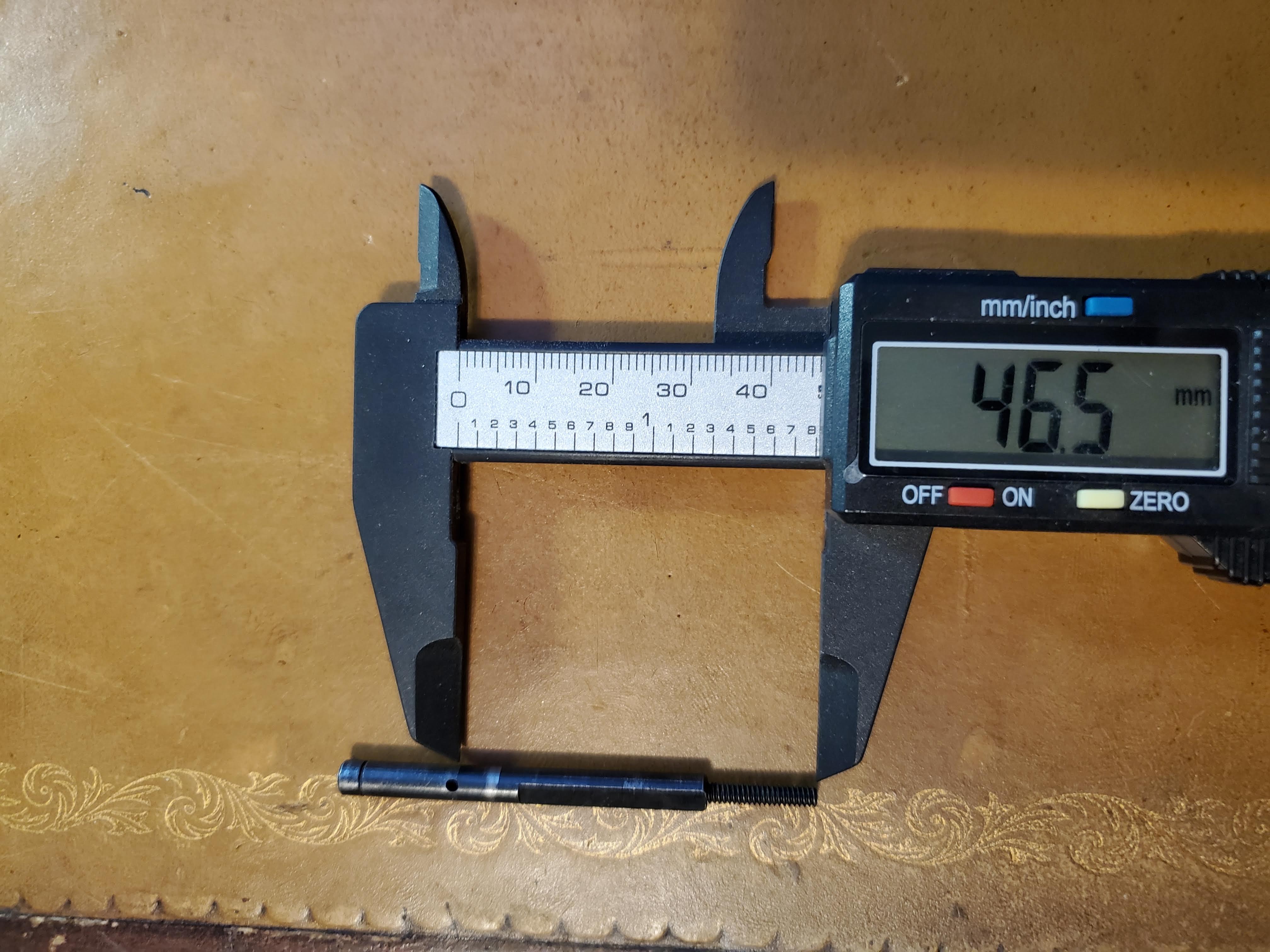

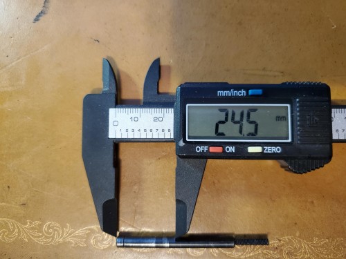

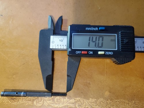

This is a XXT CR Hydradrive shaft
Edge of pin to outer end of shaft
End of shaft to flat
Inner end of shaft to flat
Edge of E-clip groove to flat
Hope this helps

That's a big help, thanks!

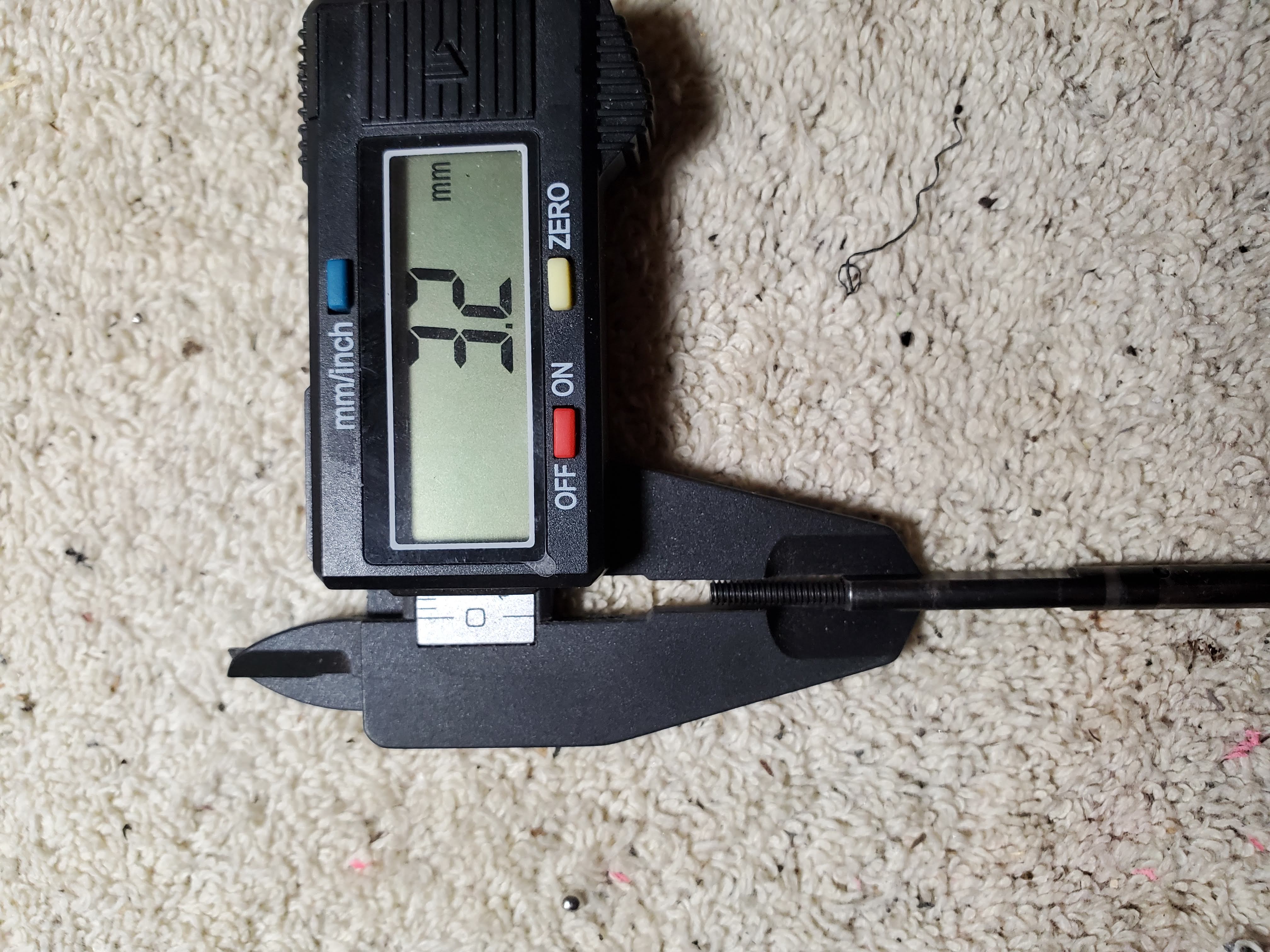

Wasn't sure if you were looking for length of the flat section, or diameter of the flats, so here's both.
And of course the shaft is 3/16"

My bad. Forgot it was flat on both sides and not D shaped.
It was the 3,2 measurement i was loking for. 1/8" i guess... :wink:

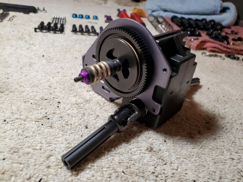

I installed a XX Double-disc slipper (could also do single disc/hydradrive, whatever) on one of my LRMs, no mod needed, just used XX stuff I had laying around. Now I know the early ones weren't slipper at all, but the later ones (like this one) were made for the slipper. You just need a Losi A3120 top shaft... if you can find one.

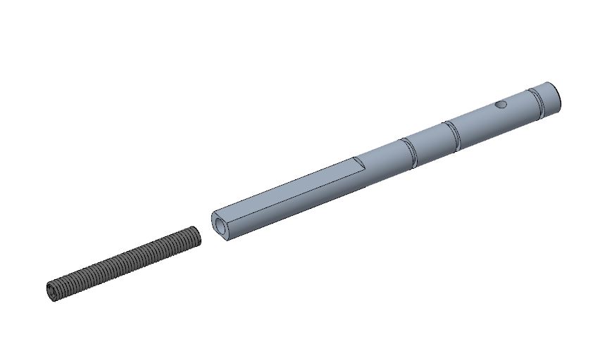

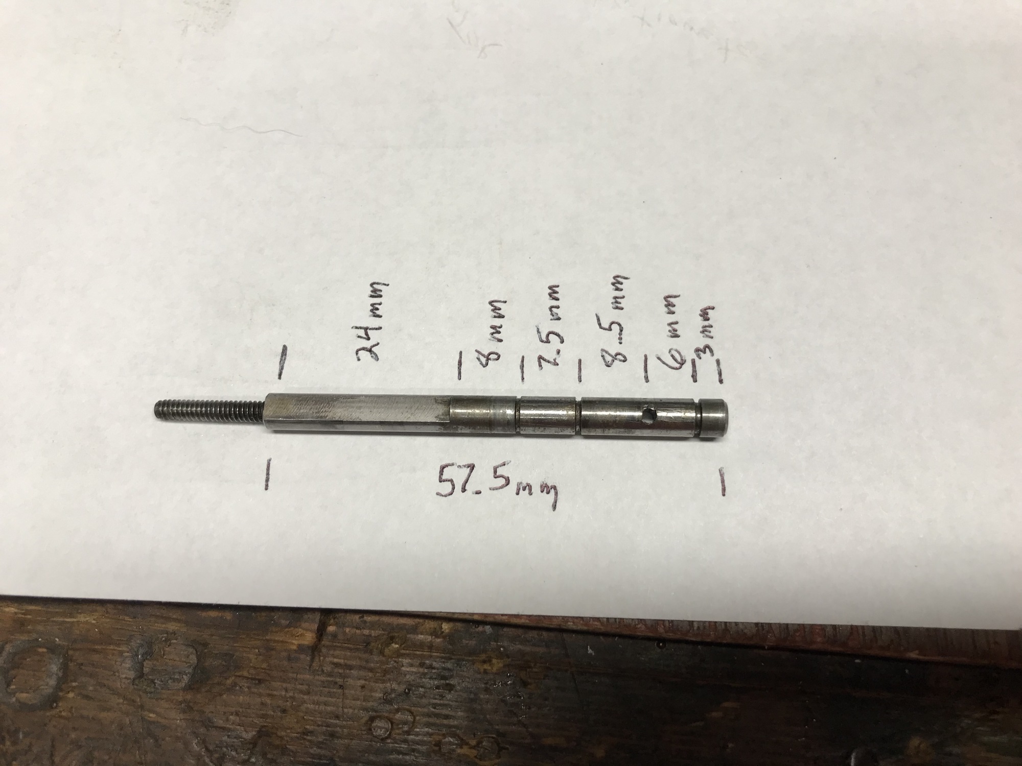

Here are the dimensions for the LRM Hydradrive/slipper top shaft.
Matt

Thank you both for taking the time to take measurements!
Now in my CAD:
//Johan
