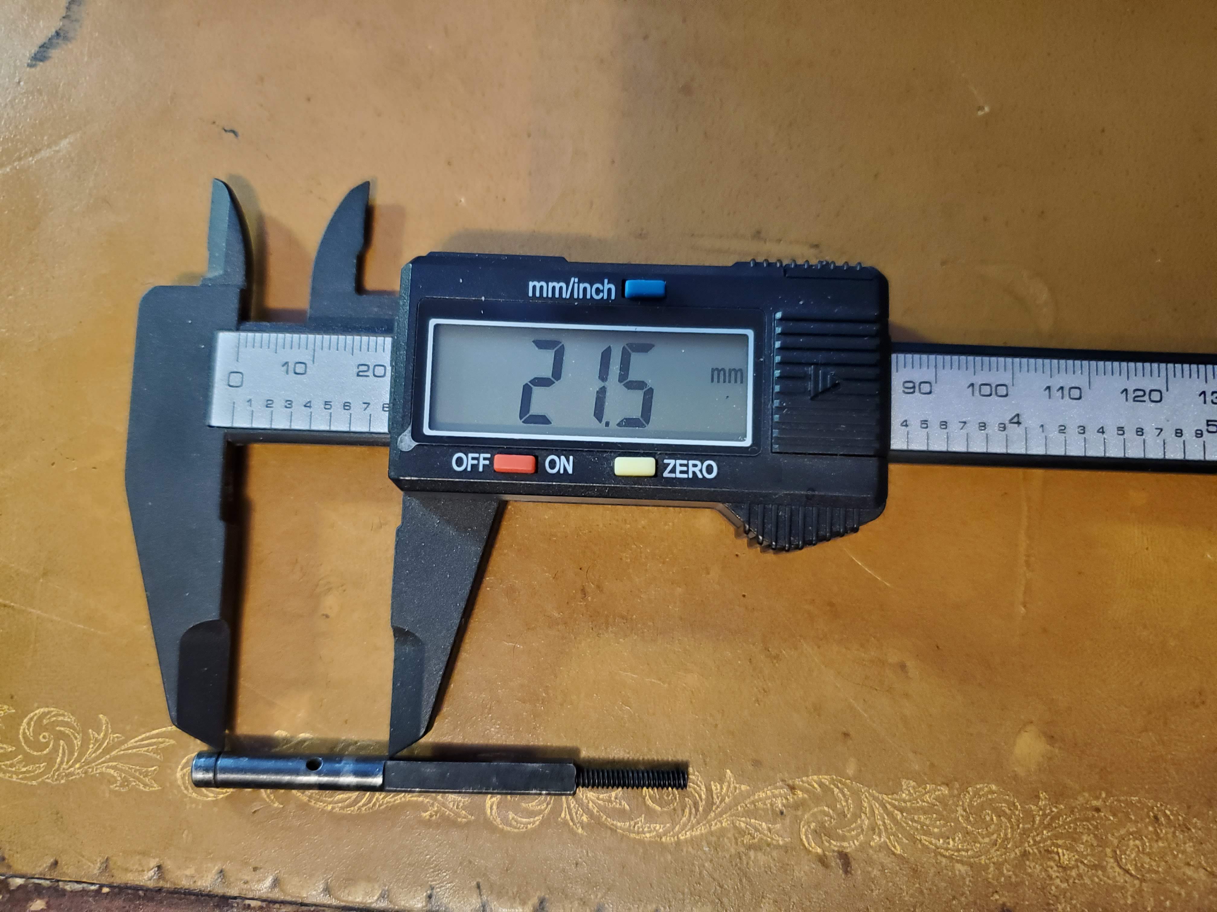

Re: Looking for top shaft diemnsions
This is a XXT CR Hydradrive shaft
Edge of pin to outer end of shaft End of shaft to flat Inner end of shaft to flat Edge of E-clip groove to flat Hope this helps
Even measured in millimeters!
Can you also please measure across the D section?
Thanks!
Thanks!
Even though the old stuff is standard, we all know it's easier in metric.
You want to know the diameter of the flats? (It is flat on both sides of the shaft, not just one)
Wasn't sure if you were looking for length of the flat section, or diameter of the flats, so here's both.
And of course the shaft is 3/16"-
My bad. Forgot it was flat on both sides and not D shaped.
It was the 3,2 measurement i was loking for. 1/8" i guess...
I have most parts for a XX slipper as spares in my old box of rc stuff. Would like to fit it to a LRM transmission but is missing the top shaft. Thinking of having one made. So this thread is very helpful.
Thanks!
Here are the dimensions for the LRM Hydradrive/slipper top shaft.
Thank you both for taking the time to take measurements!
Now in my CAD:
