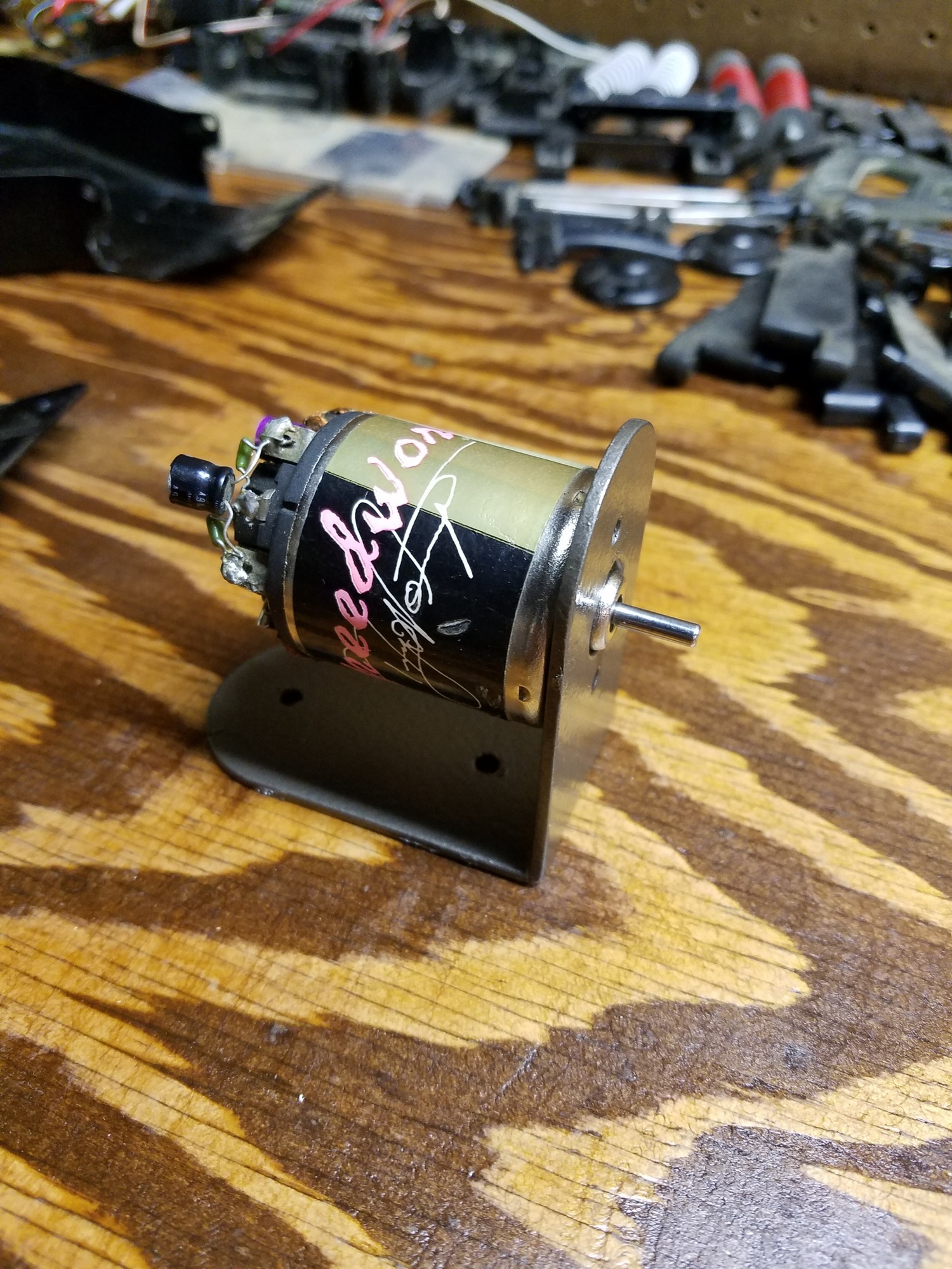

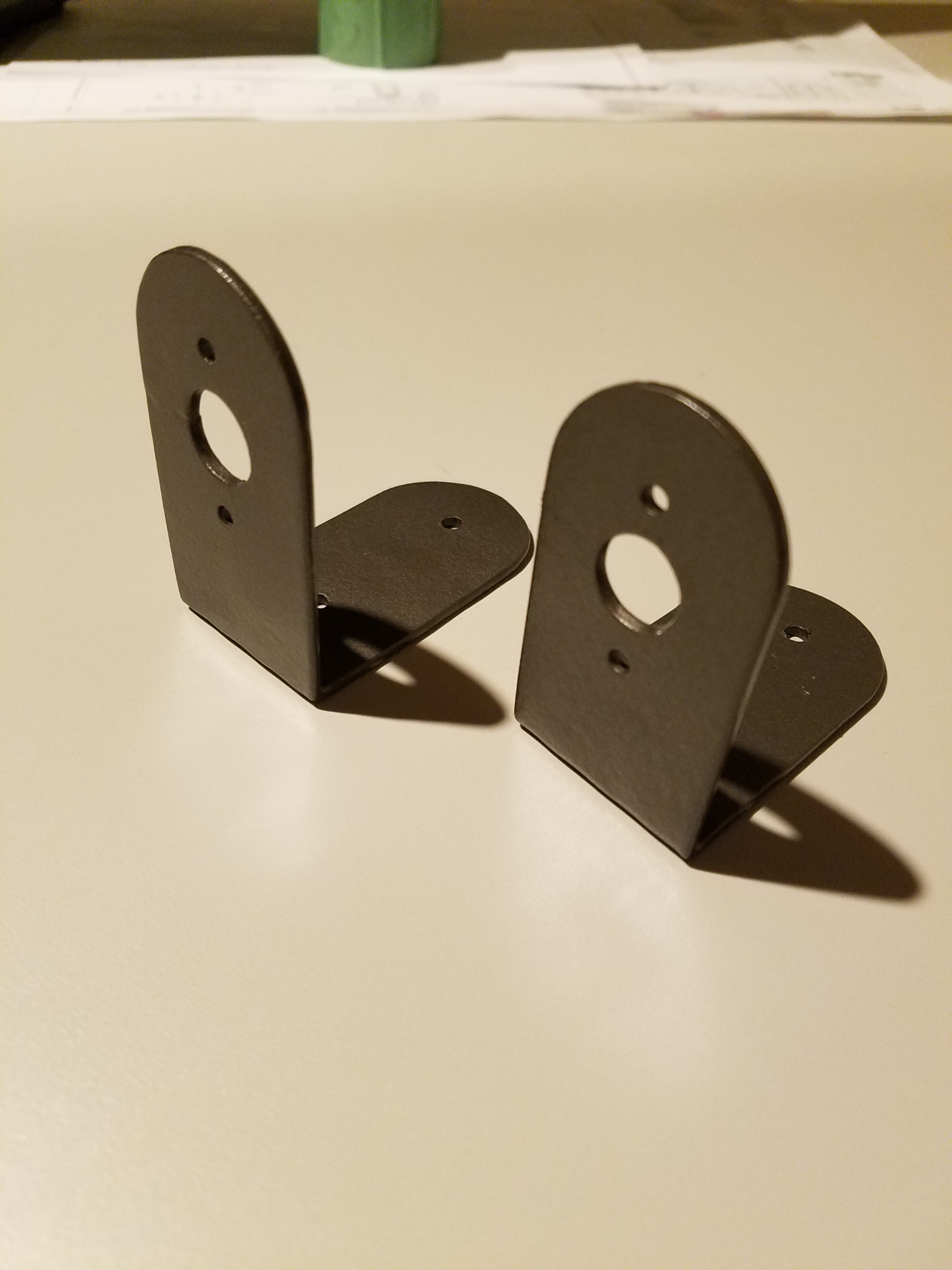

Was able to fab the aluminum mount right quick over lunch break today (since I took an actual lunch break). Motors hold themselves up to the steel mount with no assistance. Have a feeling this will affect performance somewhat.

Will find out soon enough, or whenever that brushed motor speed control shows up. Which I purchased a week ago last Thursday and tracking number says the item is still awaiting USPS. Estimated delivery was today, gonna assume maybe next Thursday. Ahh well, still need to get a 12V power supply but will use a 3s Lipo until then.

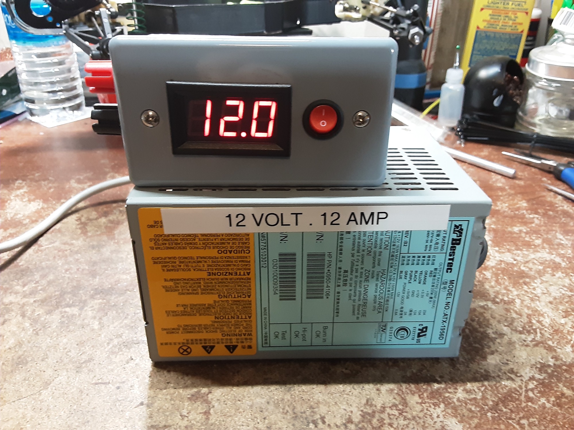

Mine is built from a computer power supply. There are directions all over the web on how to do it.

Nice. I'd have to source a computer power supply somewhere. Will see if I can come up with one and look into it. I'm guessing there's probably not much cost, if any, if you already have a computer power supply...?juicedcoupe wrote: ↑Thu Feb 25, 2021 2:05 pm Mine is built from a computer power supply. There are directions all over the web on how to do it.
Was looking at getting this one; 6 amp, $45

I've probably got ~$20 in mine. But I chose to add a digital gauge and banana posts to it.
