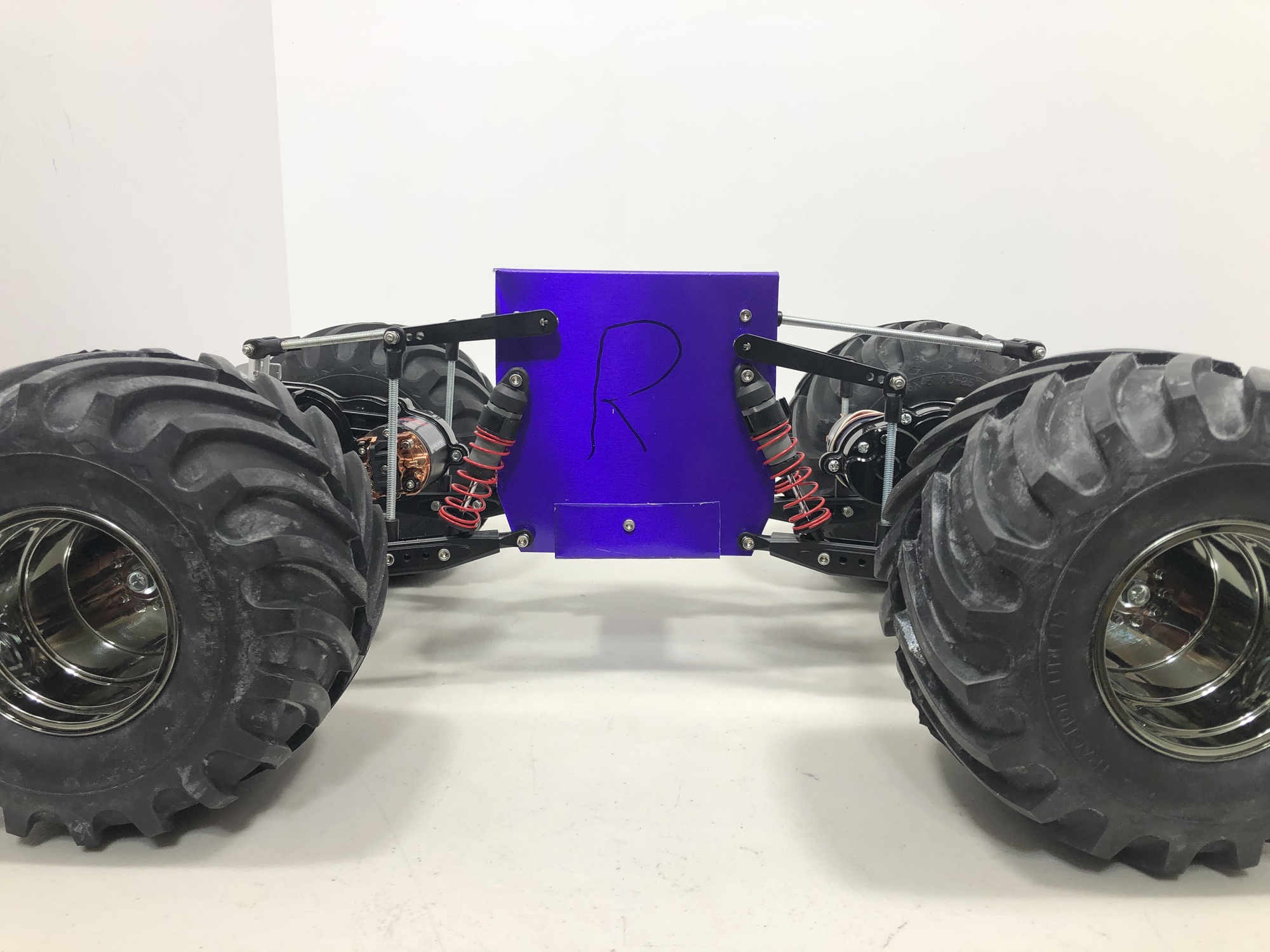

Starting to lay out my suspension. The lower links are some super cheap China deals I found. I thought they were going to be plastic judging by the price, because I never fully read descriptions. Turned out to be some pretty decent quality machined aluminum pieces. The “chassis” is just for mock-up, using some easy to work with thin stuff to do the majority of the work and I’ll make a better version with more adjustment holes and more meat on the top for better body mounting options. Never was a fan of mounting bodies by the sides. Especially a heavy monster truck.
romulus22
Posts: 2549
Location: KY
Has thanked: 900 times
Been thanked: 789 times
Re: “Race Clod”
Post by romulus22 »
First mock-up finished. Now I have an idea how I need to reshape the chassis to fit the body, where I need to make more shock mounting holes. I was glad I went with the CVDs and hub wideners. The tires barely clear the lower links at full lock. I’m also using my anti roll bar spacers for the shocks. I’ll mock them up on the next mock up chassis.

That's a good stance.... perfect height, low cg etc...

I didn’t think about it before but I used some ball end pivot balls for shock spacers so I could steal the anti roll bar spacers back. I tried a couple different chassis mounting points and I like the rear(left) better. As for right now the chassis is way too flimsy to do any real testing or shock tuning. I’ll need to make my next piece from much thicker stuff and use real bracing. But it’s looking like a truck.
