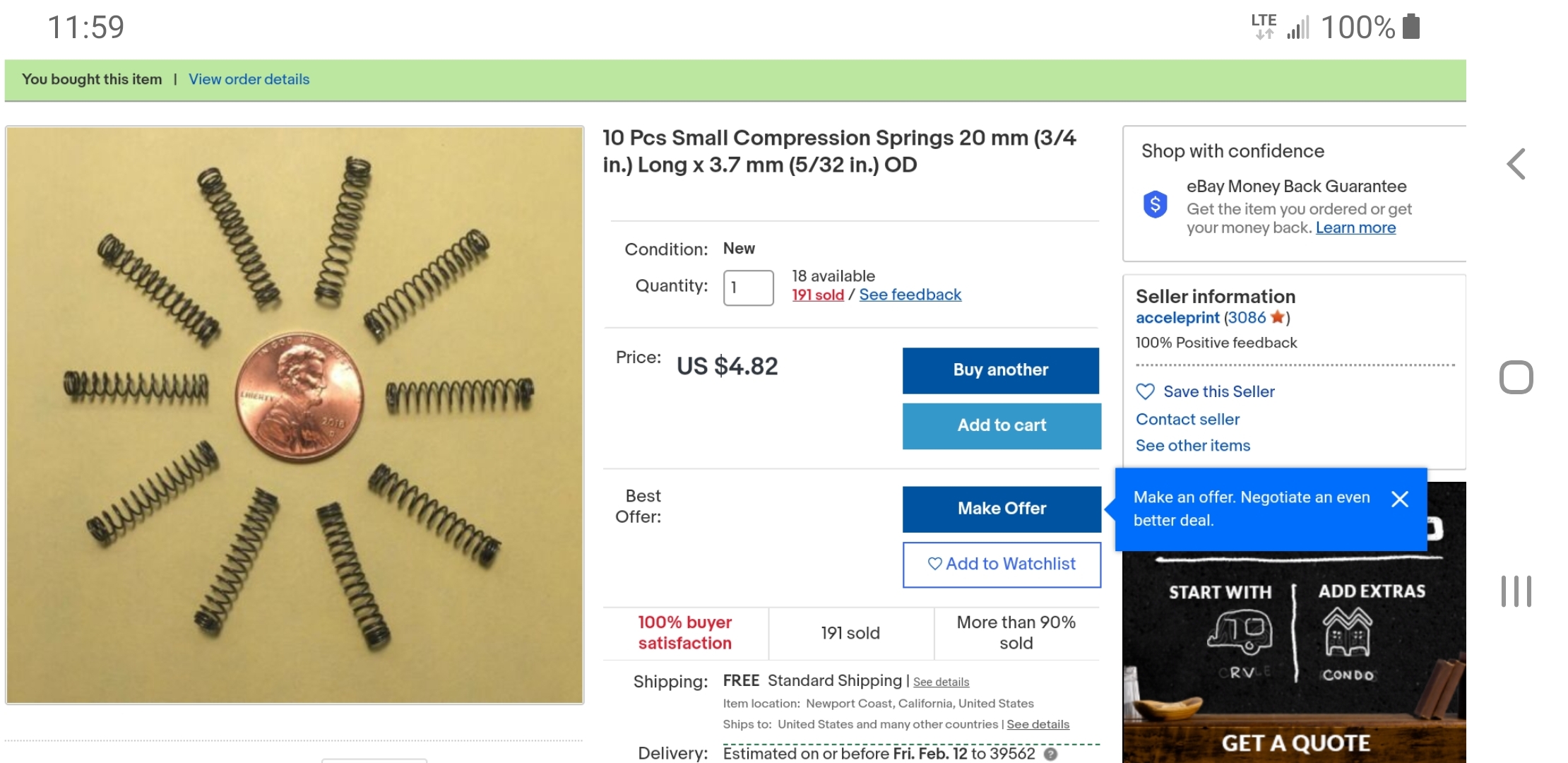

I took the measurements from a new 6372 set and found these that match.

I was able to score an NIP 6372 set but I think I will get a set of these since I recall these springs being easy to lose. Thanks.juicedcoupe wrote: ↑Mon Apr 26, 2021 1:01 am I took the measurements from a new 6372 set and found these that match.
