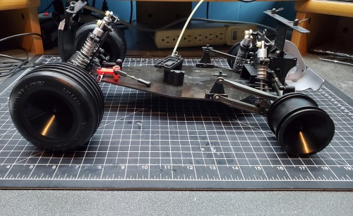

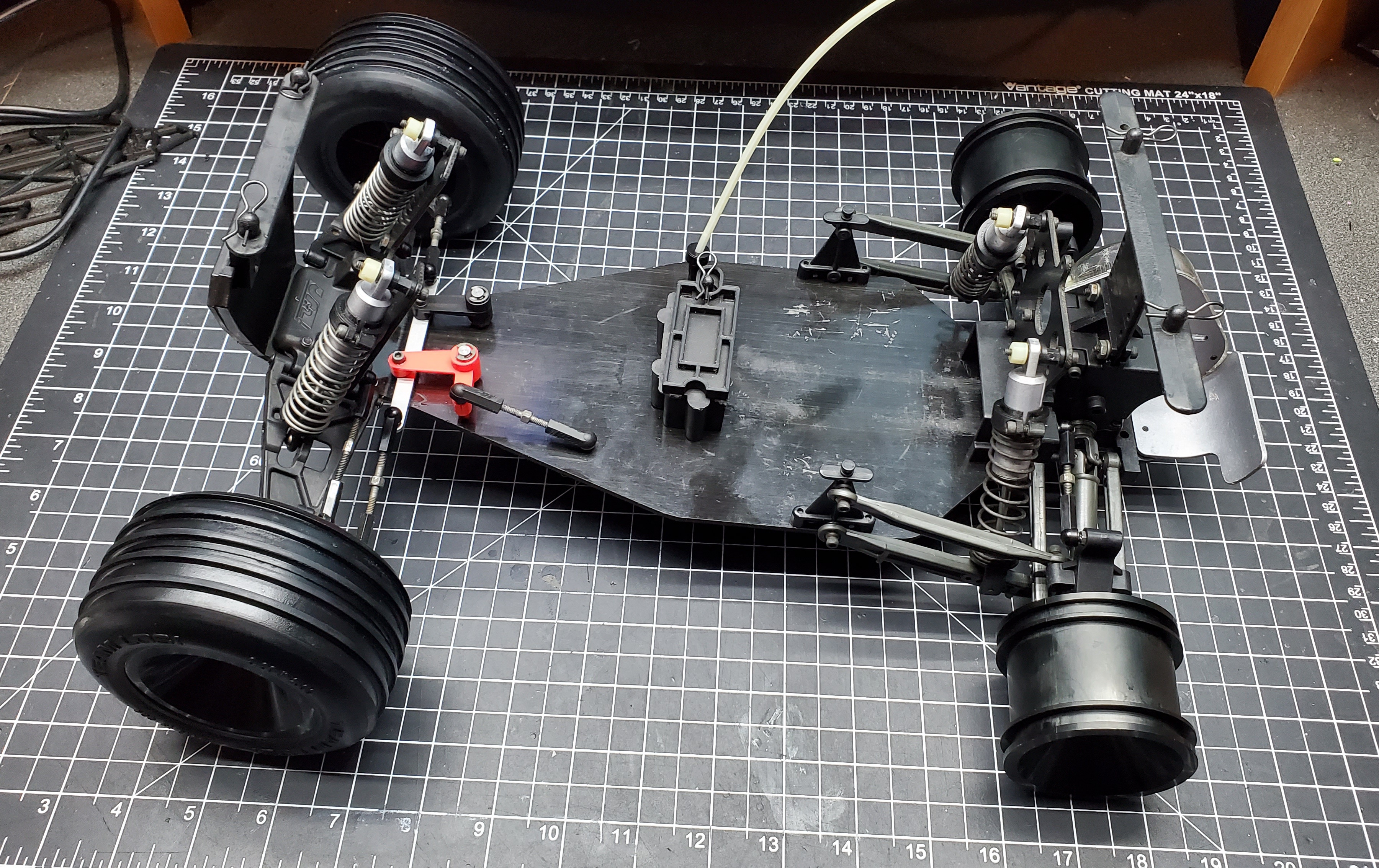

Looking good! If you're not already aware of the issue with the chassis screws, it's because Losi used flat head screws with a 100 degree angle on the head, instead of the more typical 82 degree. You can get some really nice, complete Jrx-2/T screw kits from Team KNK Hardware https://teamknkhardware.com/121-team-losi or they sell individual sizes like McMaster-Carr https://www.mcmaster.com/screws/flat-head-screws/phillips-flat-head-screws/thread-size~8-32/countersink-angle~100-/. Also, your front axles look to be longer than the stock Jrx-T ones, which are the exact same as found on the Jrx-2. They may be aftermarket or from a later truck.

An update. I dyed some A&L wheels today and 3D printed some custome wheel nuts to for the wheels as I didne want to use metal nuts on this. I was also able to acquire some losi front tires that are in great shape.
Now I just need to find some rear tires. I am looking for a pair of aggressive spikes (not mini pin). Something that looks "stockish" if I cannot find stock ones.

I like the black wheels too! Great build.
