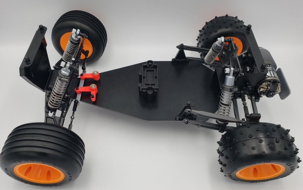

That treatment on the metal parts looks to work great. I need to look into this for myself. If you put in the time and effort, you can have that truck looking better than new, and with minimal parts replacement. I just rebuilt a JRXT that looked about the same, and now it looks like this (below).
I look forward to seeing your build. Thanks for sharing.
