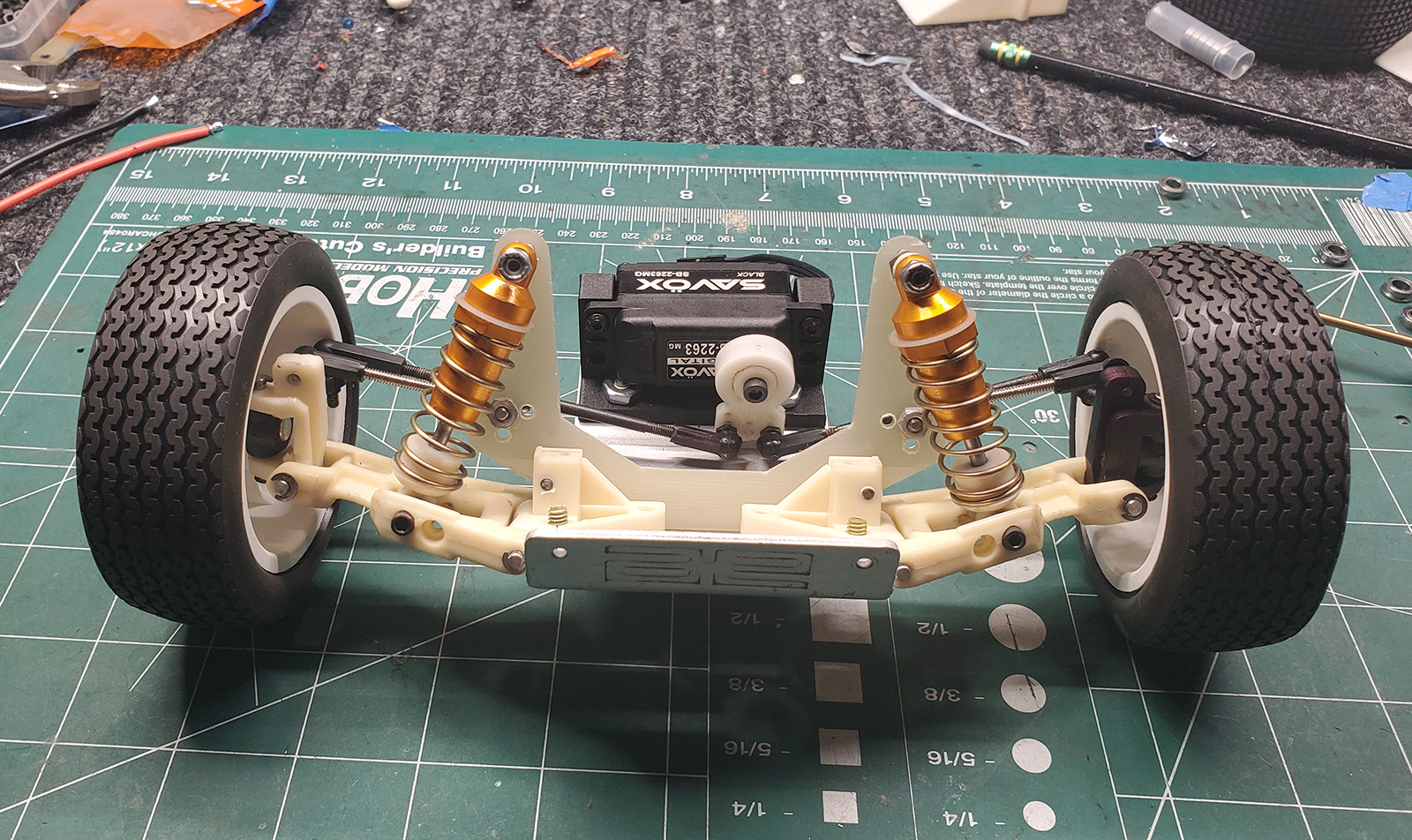

Starting to look at other systems during the down time on the tub. I printed a servo mount so that all of the front tub screws are used as they should be, but a simple servo with generic saver can be used. This will save space in the tub, as it has been drastically reduced. Wide arms bring the track width out to close to where it needs to be.

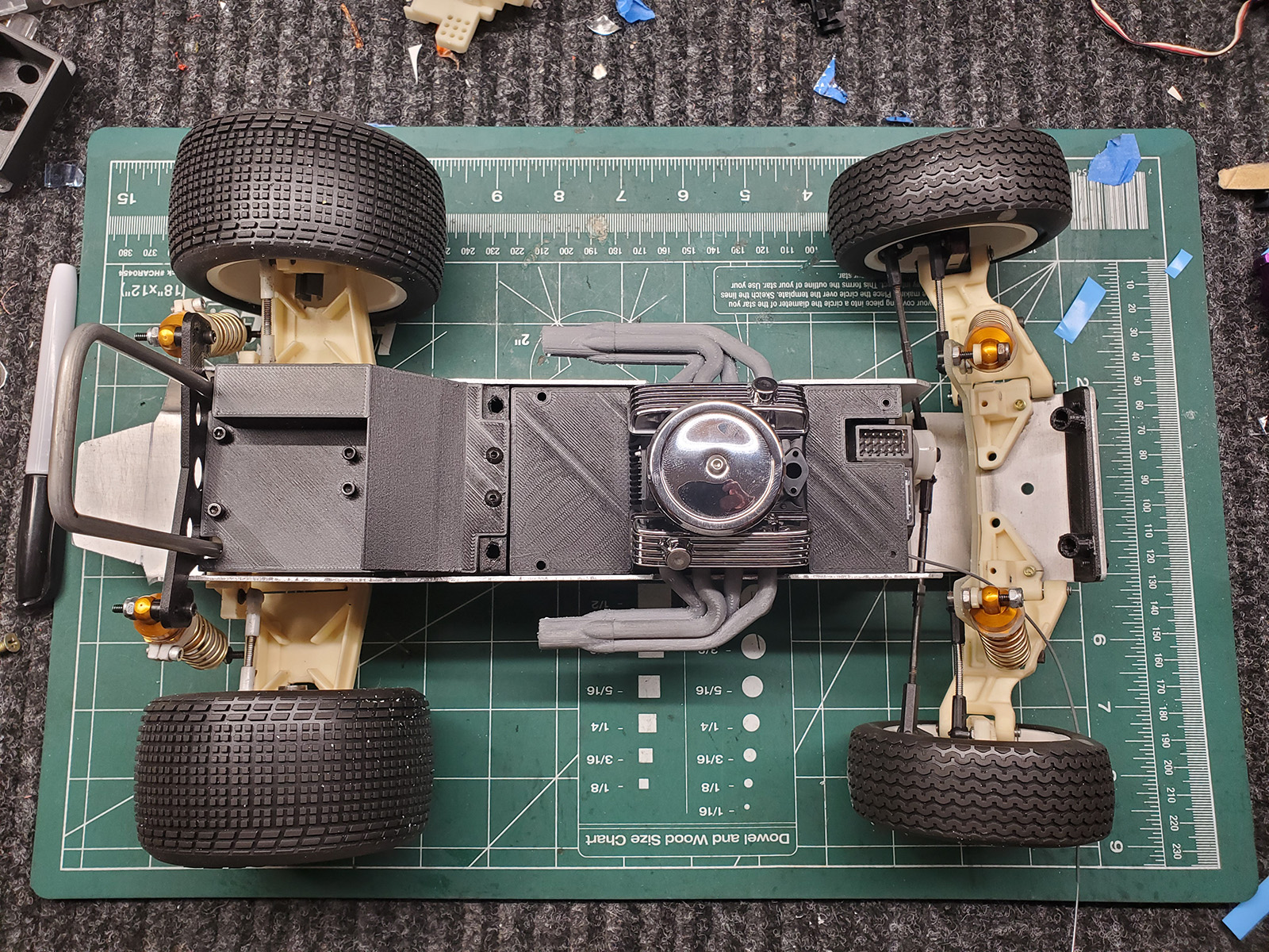

Not much progress lately as I am neck deep in real work, but a little got done recently. I started bending some cage tubing, but got distracted by trying to clean up the inside of the tub some.
I told myself as soon as I started thinking about this build that I did not want the typical screw on headers that I see on too many sprint car builds. I wanted the tubes to go into the chassis and, well, attached to something, maybe something like an engine. The original plan was to bend my own aluminum or steel tubes, but after a few minutes of that, nope. Those radii are way too tight, and at 90* to each other, and yea, ain't gonna happen. I decided to print the main part of the headers, and then the plastic tubes will end up in an aluminum collector from that point until the end. Not the right way to go about it, but the right way for now. When said and done, I think it will look great.
The tub will end up with two basic printed covers. The rear cover acts a support attaching to the rear bulkhead, the trans, and the mid bulkhead, while covering the spur gear. Currently it is just a simple plate, but it will end up changing as I figure out the interior / driver later. The front cover will be easily removable and will hold the engine / headers, and cover the battery pack and RX.
