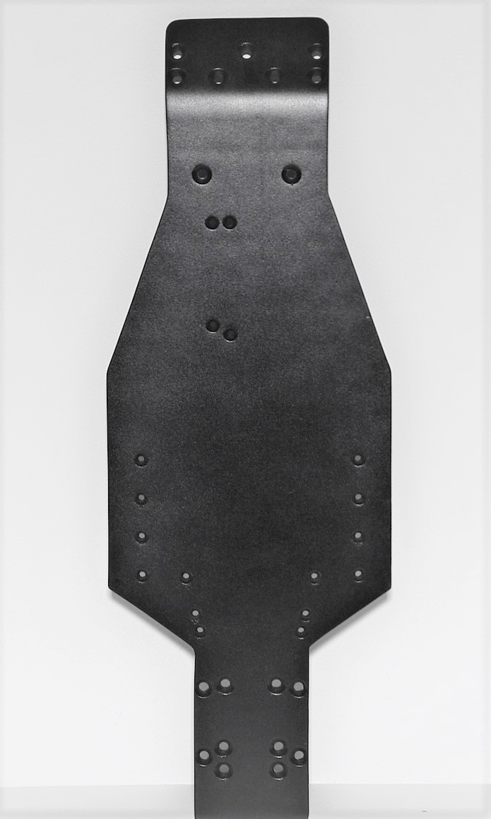

So I started a while ago on this car and never finished it.
The chassis doesn't line up well with most bodies and it got sidelined for a while.
Anyways...

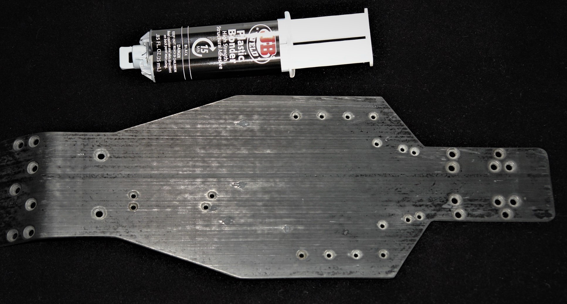

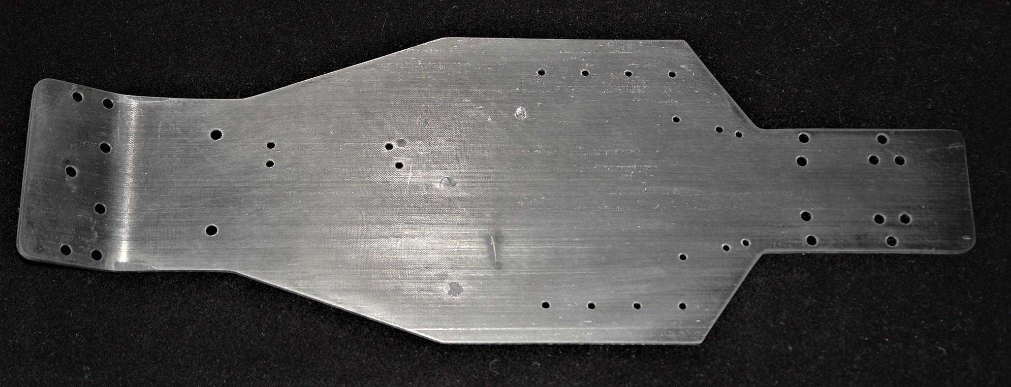

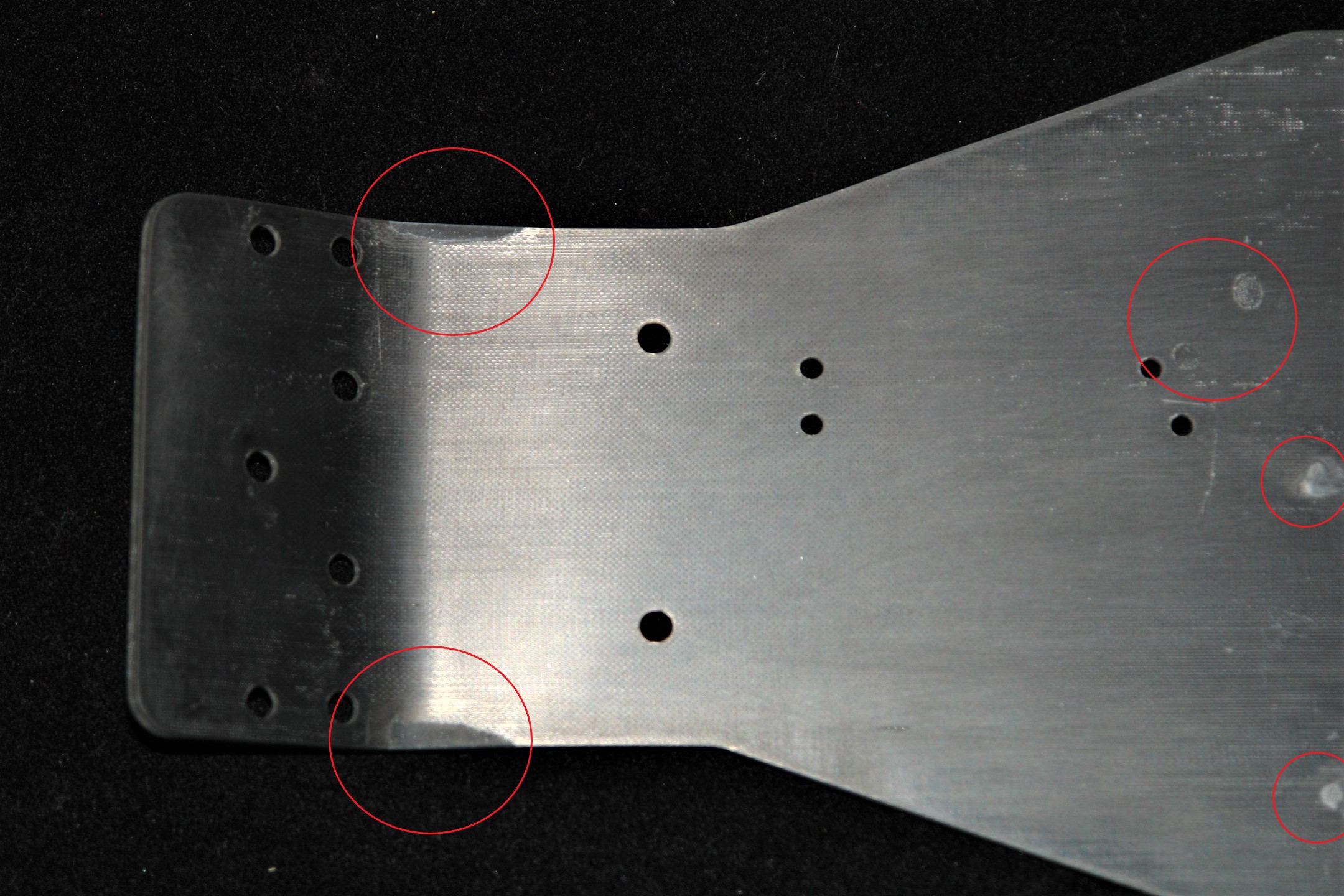

The chassis had been cut/carved where the front arms were touching the chassis on full droop.
Most chassis that are similar usually have some accommodation for this type interference.
There were also a few extra holes that had been drilled and minor scuffs/scrapes.
I used some JB Weld Plastic bonder as a filler after roughing the areas to be repaired to help with the mechanical bond.
Then sanded until it smooth
Chuck
Anyways...
Chuck

Re: Graphite RC10 build

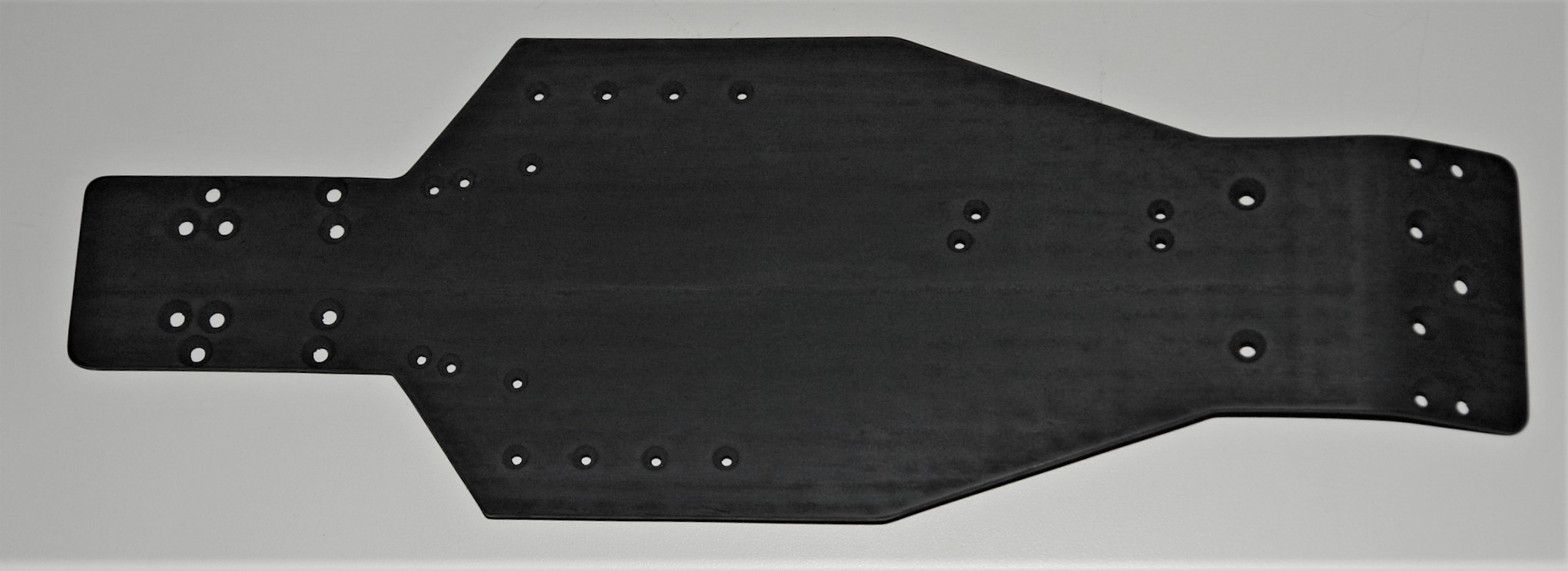

I decided to use SprayMax 2K Activated Epoxy Primer Black mainly to have a sandable finish to even out and fill minor imperfections.
After that Spray max 2K Clear Coat Semi Matte.
Chuck

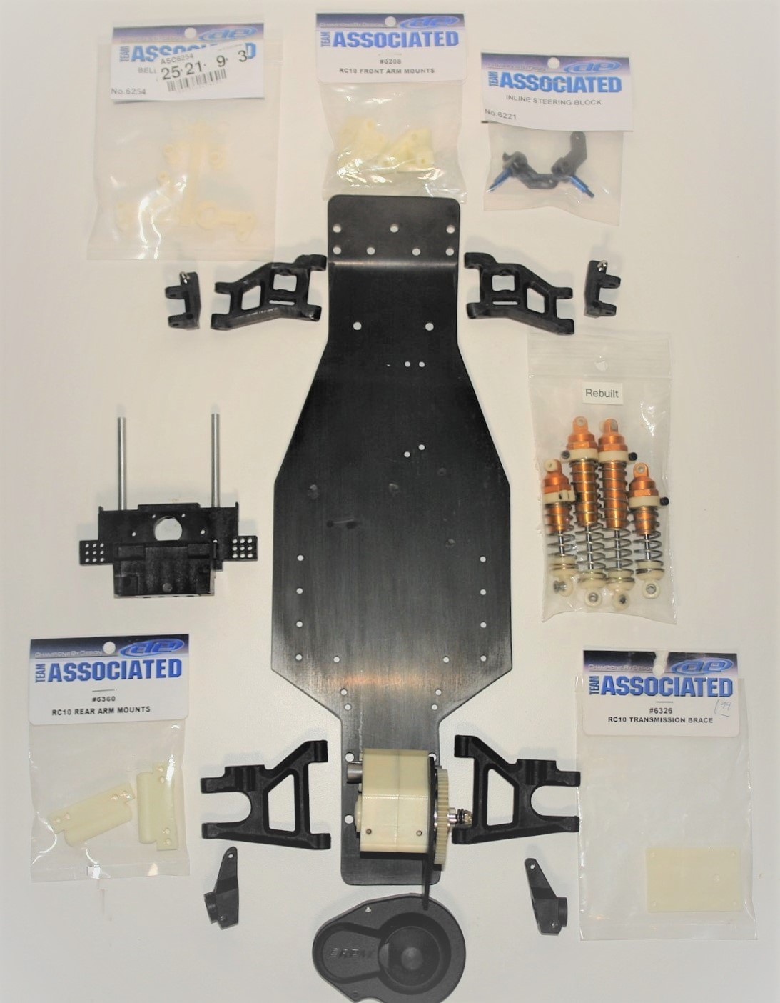

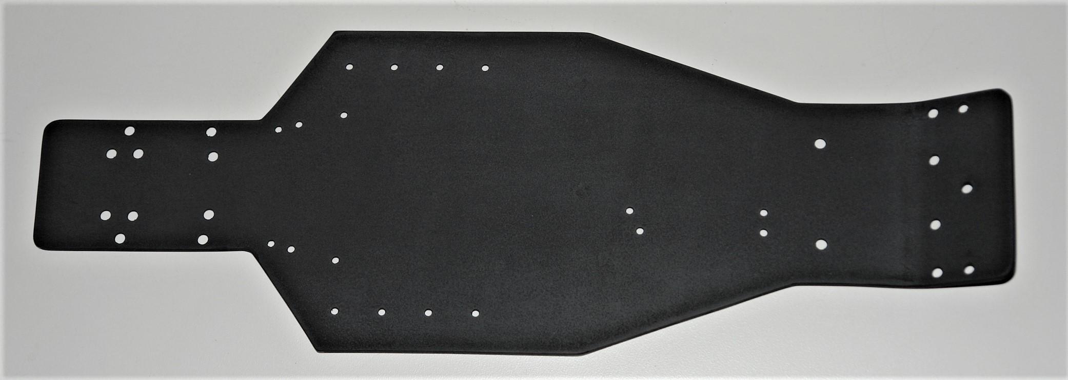

Rounded up a few parts for the build.
Fully rebuilt shocks... And in pretty nice condition.
New build transmission.
Made 2 spacers (1mm) for the front 6208 mounts. This gives good chassis to front arm clearance.
Andy's arm front and rear.
The first pic is before clear coat.
And then a few more parts...
Chuck

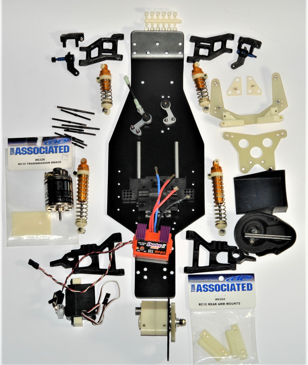

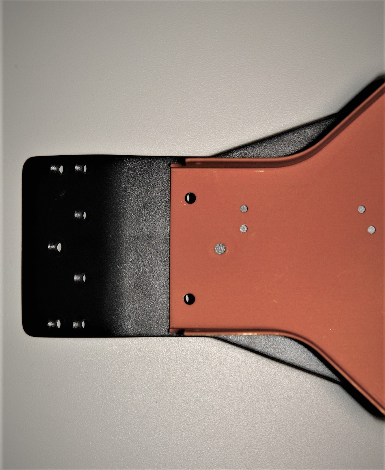

This shows the body clearance issue.
Chuck
You will probably have to notch out the chassis again in those spots in order to mount the arms in place. Those chassis are super frustrating. The Andy pro arrow fits as well as the heathen.
I really did not like the whole chassis notch thing,
That is why I added the 1mm spacer to go under the front mounts.
The clearance is fine now, seems like a small spacer but gained what I wanted.
That looks like a body I can live with. Thanks!
Chuck
