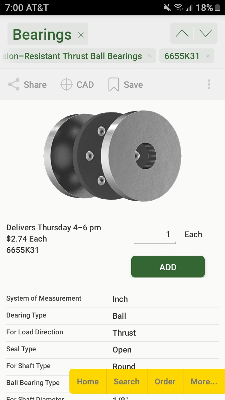

I don't have an Associated bearing in front of my to measure, but there's this guy from McMaster Carr.
Fits 1/8" shaft, 7/16" OD.

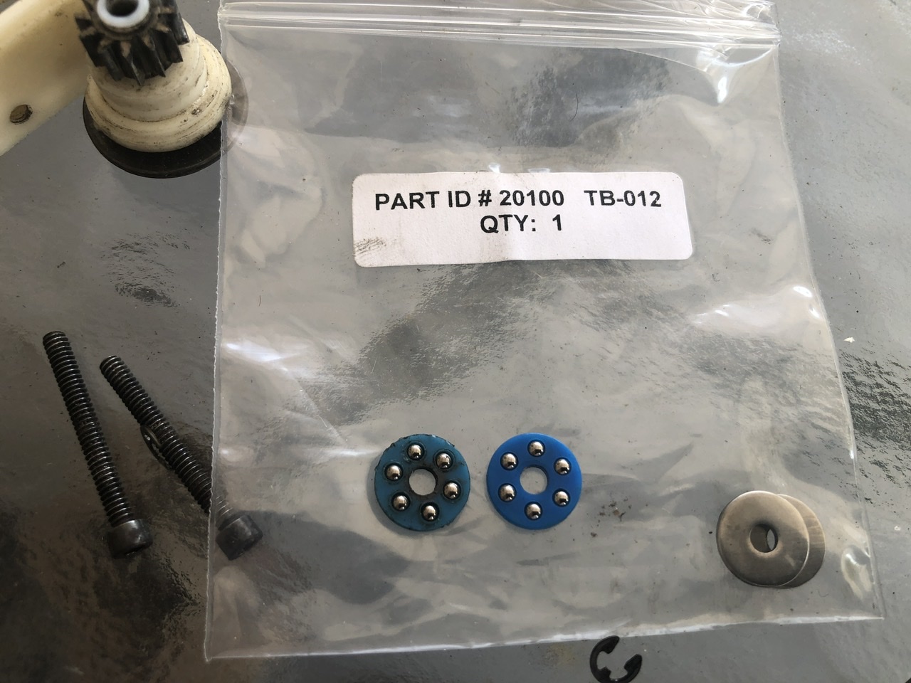

For future folks the McMaster carr part is identical to the associated part The dirty one is from the kit and the clean one is the McMaster carr part.
