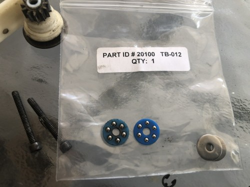

For future folks the McMaster carr part is identical to the associated part The dirty one is from the kit and the clean one is the McMaster carr part.
