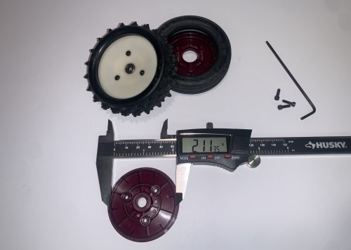

Ok decided not to disassemble the white wheels.
I’ve got a set of slightly used ones so I took them apart and measured.

Re: RC10 2.0" front wheel options for TQ70 tires
Here you can see they are the same size as the white one it’s sitting on.

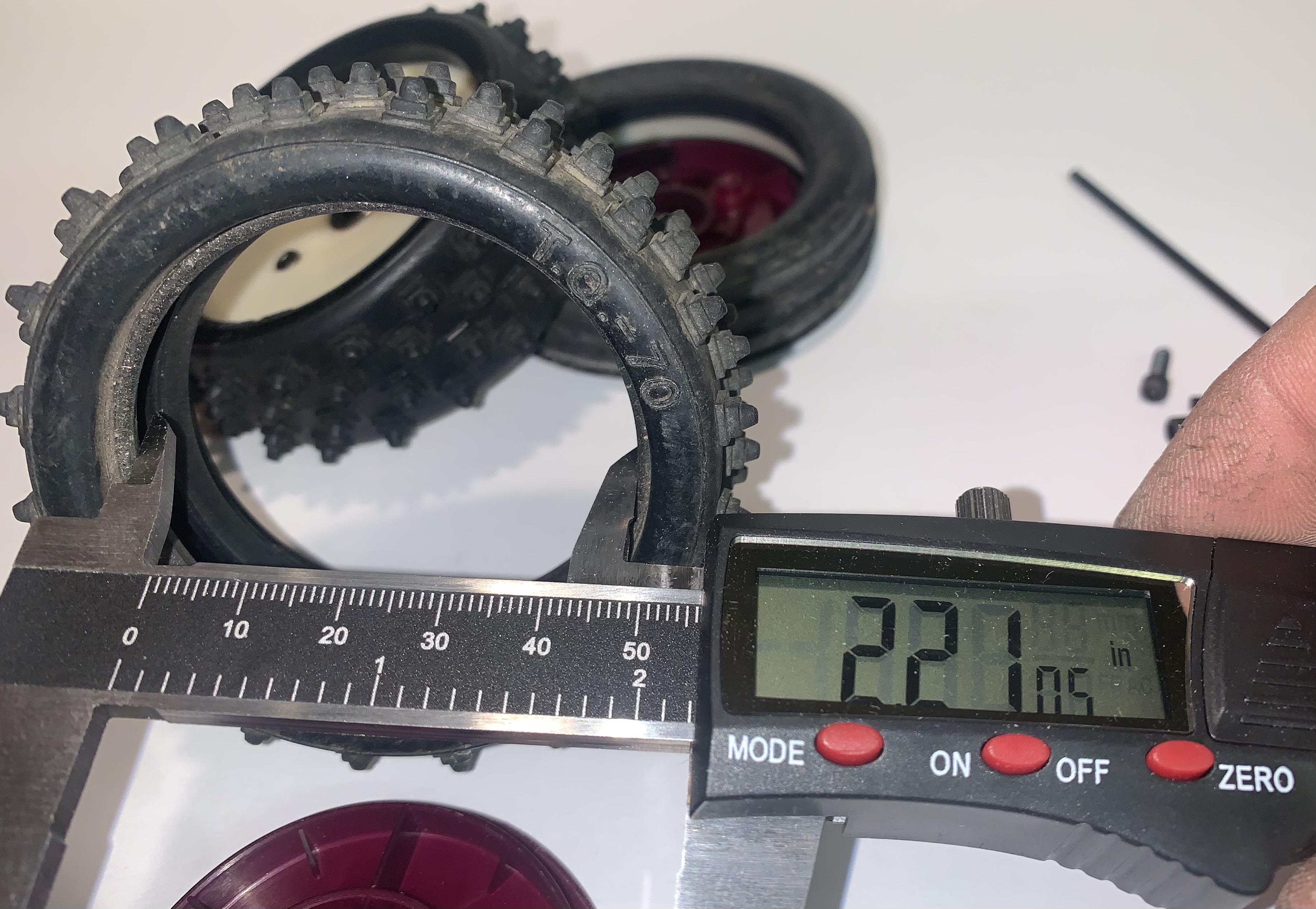

And here is a TQ-70 that’s been on a set of proline wheels probably since they were both new
#6870H is the TQ-70, it’s a 2.125”
