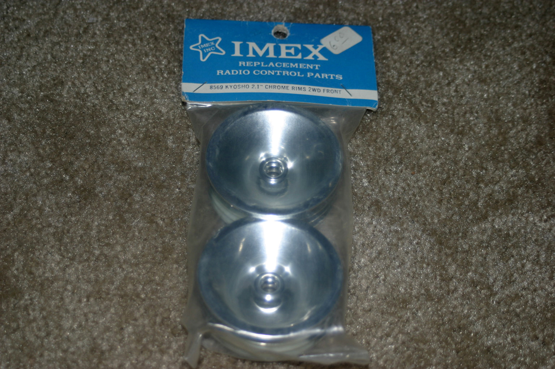

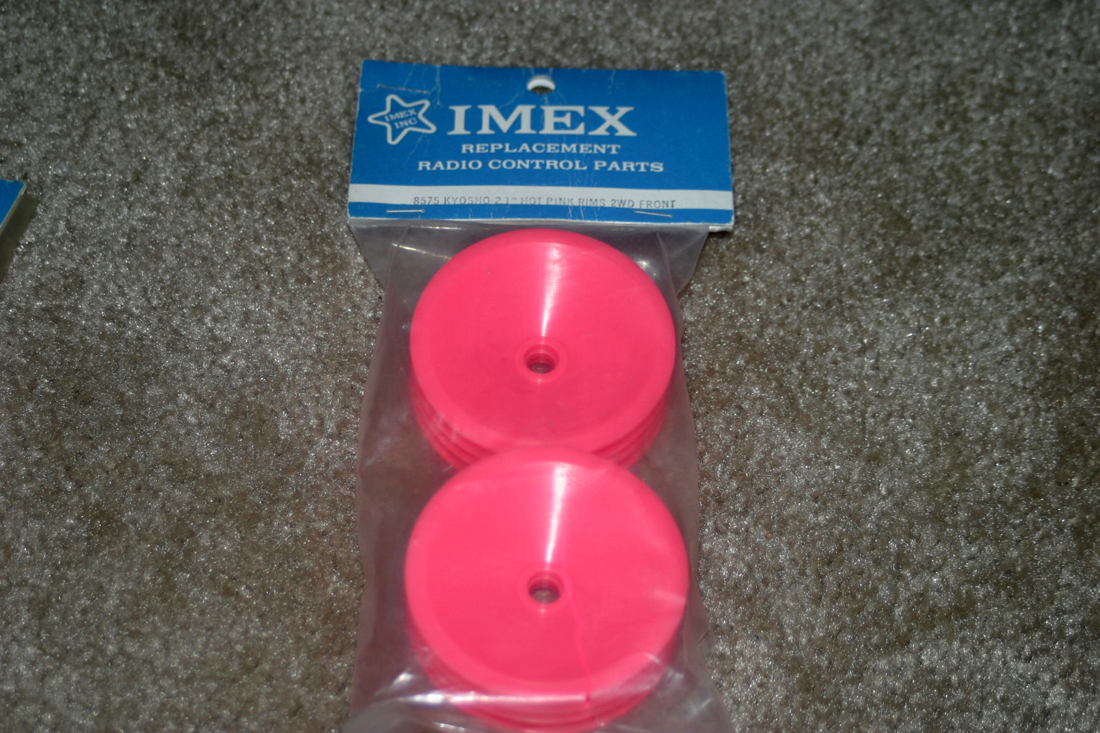

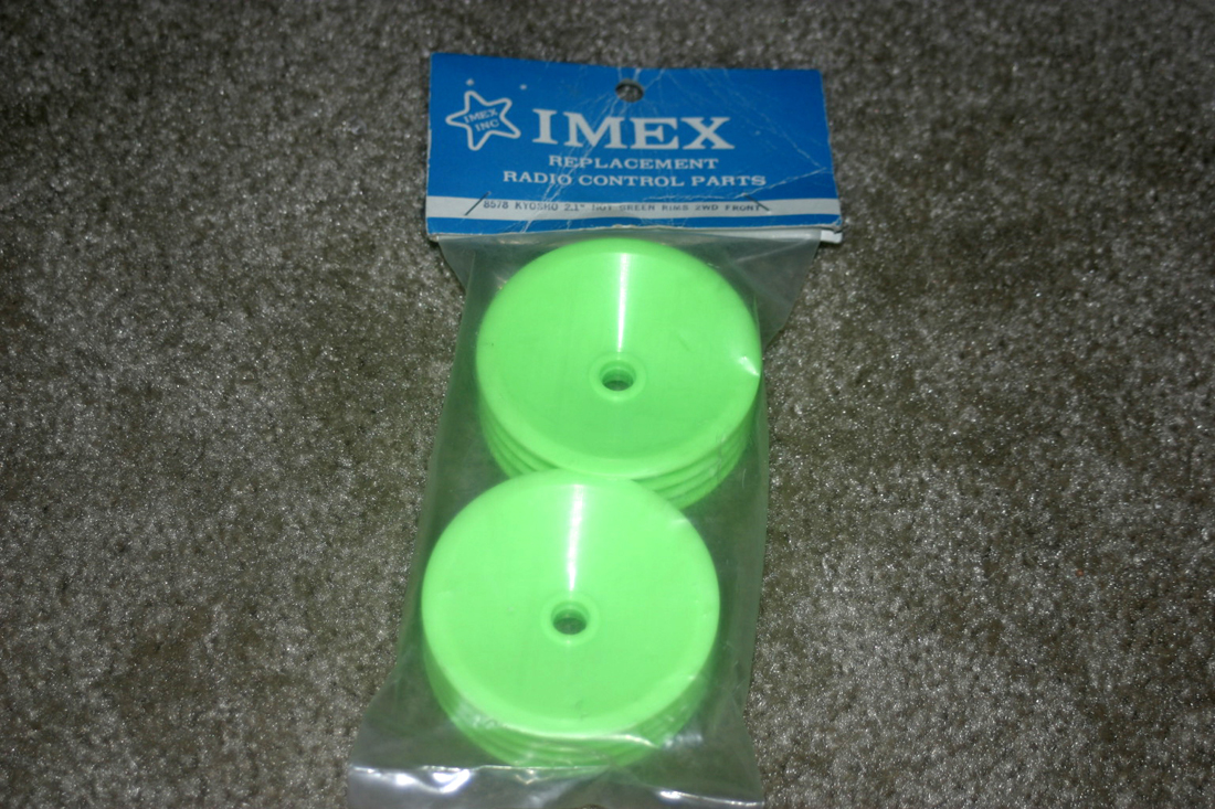

I'll give the vets here yet another opp to give me a hard time, have at it, but SERIOUS question. Did anyone like CRP, etc. make a front axle set for the RC10 that allowed the installation of Kyosho sized/bearing wheels? I know there was a Tamiya bearing option. I have a few nice color Kyosho wheels that I'd love to use on Associated products.
I searched ebay and my stash and haven't seen anything. Thanks in advance.
