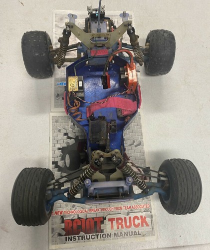

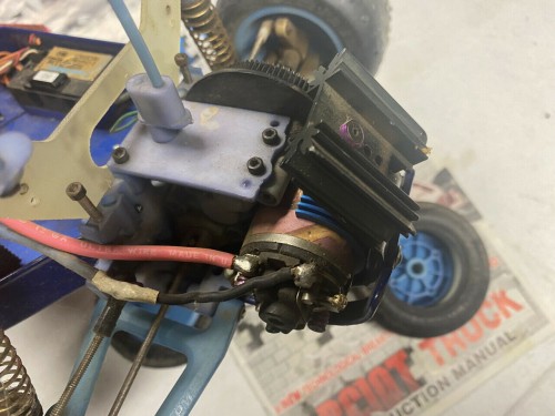

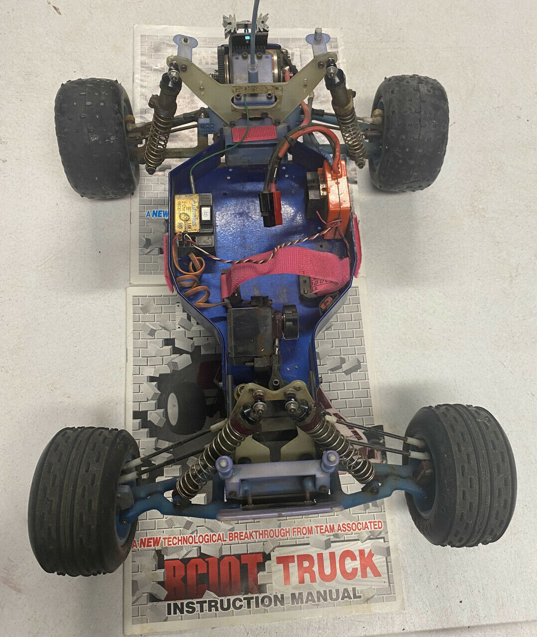

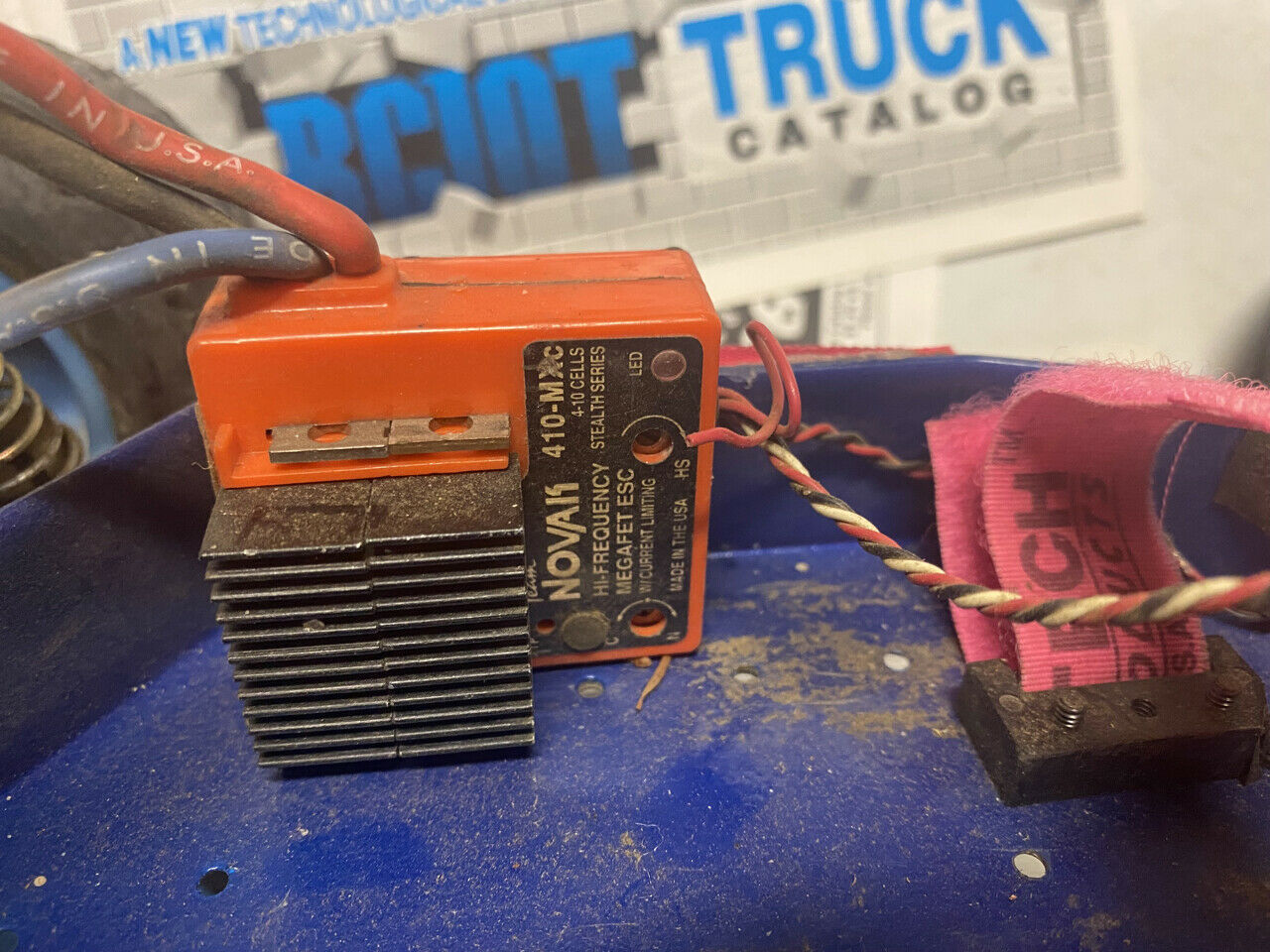

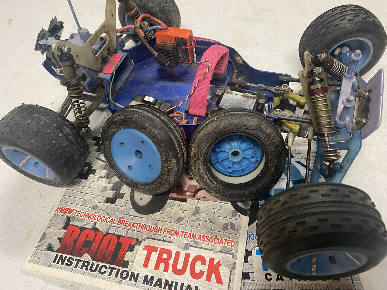

I am new here. Haven't had a r/c truck since I was a kid and it was a original Tamiya Stadium Blitzer. Got it when it was brand new. Always remember seeing everything with the rc10 platform but couldn't afford it. 30 yrs later and I finally get one. I actually was able to grab 2 off of ebay and grabbed the pics from the sale to my laptop. I am currently on rotation and they will be at my house before I get home. So I am doing research. .One of these will eventually be for my stepson xmas gift and something for him and I todo together. He has been wanting to come out and help me on the the car projects out in the garage. I am still on the fence on going brushed or brushless. None of the kits cane with batteries and no radios. pros and cons will help out and identifying will help also
truck 1
just here...trying to learn what I can and enjoy the hobby

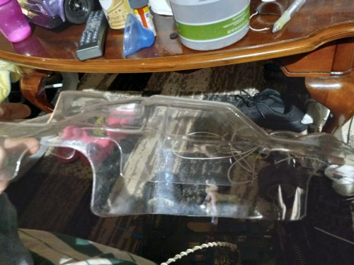

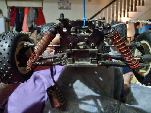

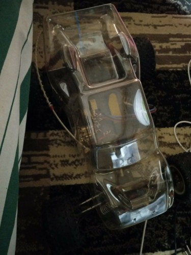

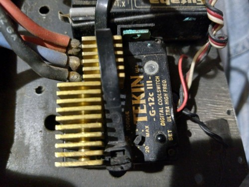

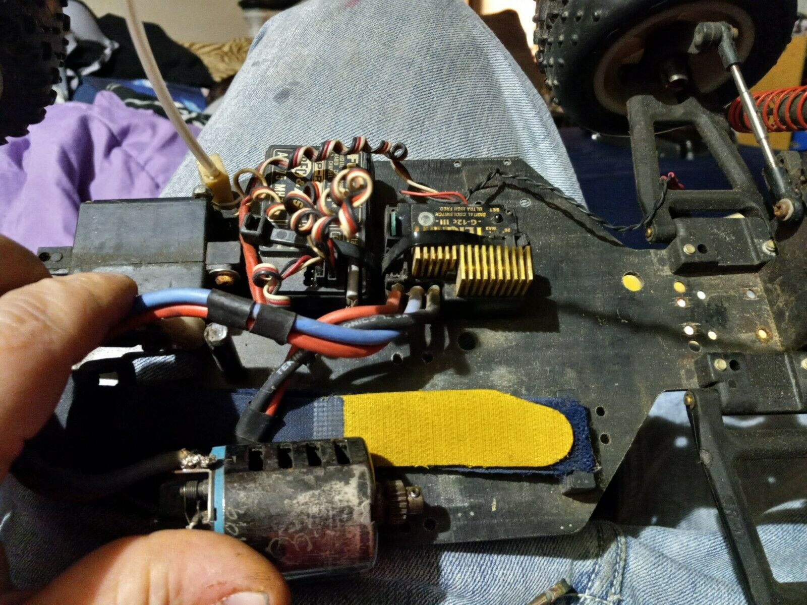

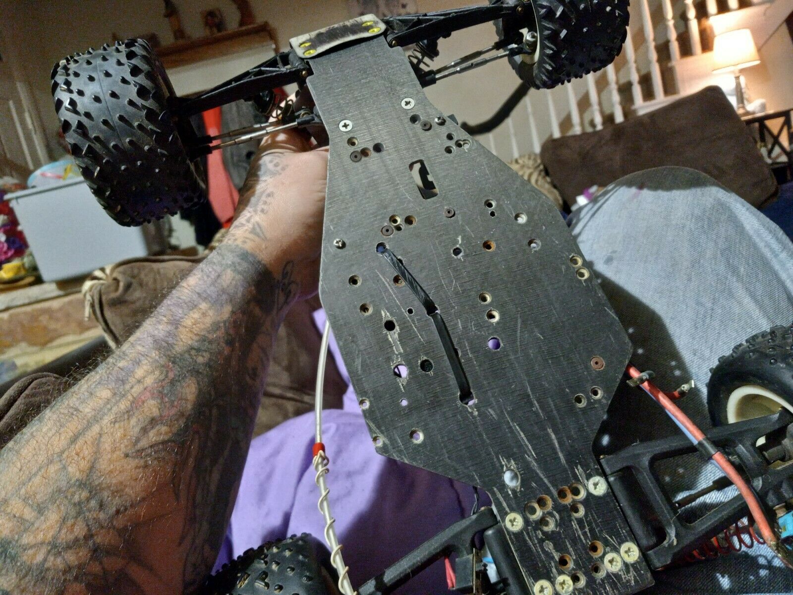

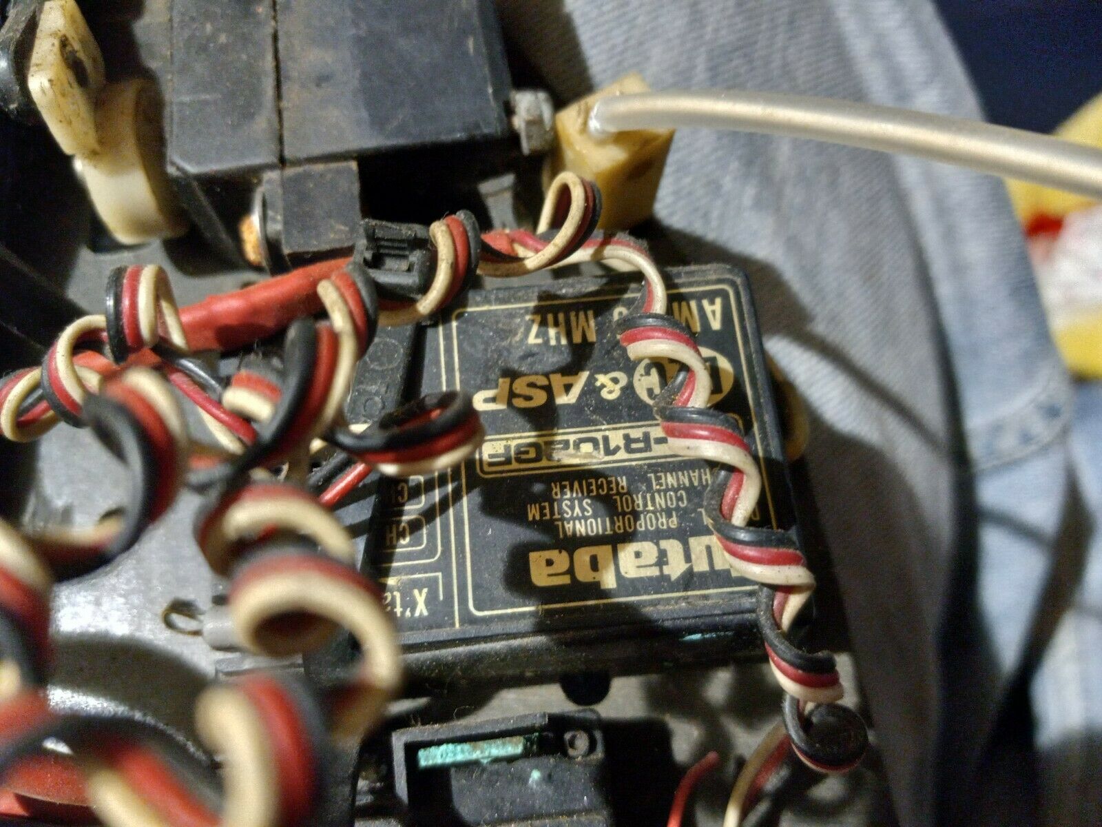

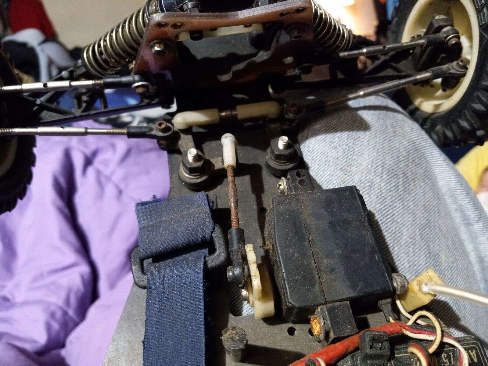

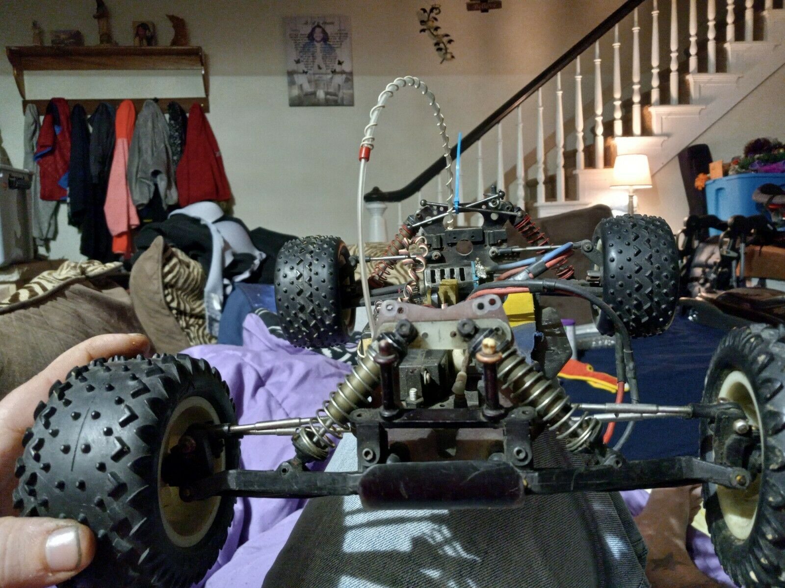

truck 2
this one is a little more difficult. I saw it was missing the stealth transmission so I picked one up

Truck one looks to have started as an early 10T, based on the skinny front tires and thin shock towers. But anything could have been mixed and matched.
Truck two is based on an aftermarket chassis. They were building a mid-motor setup.
Both have some nice parts on them.

Truck #1 is most likely a mid- late 7001

i ordered a stealth transmission that I will open up and inspect and re lube it..just need to find a how to and what to use. do I just mount that on there and add the motor?

Original manuals are still available that show how to assemble the transmission and what lubricants to use. A few parts are still available new but most will be ebay items.
Personally, I'd get another bulkhead and shock tower and set it up in the original format.
It looks like that truck also has wide offset conversion wheels on it, even though it has truck arms. Those were made pre-10T and used to widen a buggy, for converting into a truck. Left as is, it will be much wider than the other truck.

i just ordered another bulkhead and tower. it has the axles ziptied to the beat up tower..i'll have to wait to get home to get better pictures to post on here...thank you for the input.

I was bidding against you on that truck 2.
I wasn't sure on much of it but it looks like an collection of some harder to find parts.
It looks to me like the rc10t composite craft chassis, RPM rear arms and technacraft turnbuckles.
There are a few threads on here about how to restore the graphite chassis.
That chassis may have also had an upper deck available.
That went for a reasonable price. It'll take a bunch of work to make the second one drive, but if you put in the time it will be a pretty nice and uncommon build.
