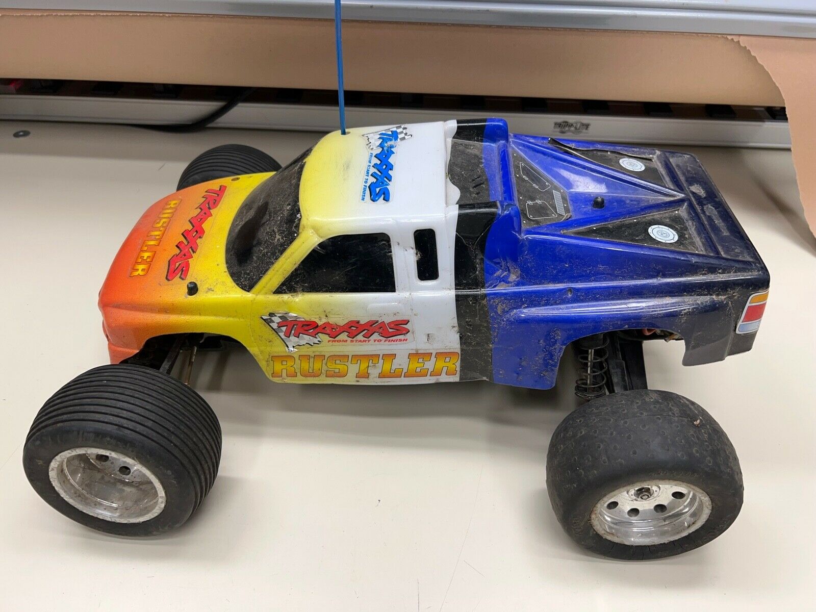

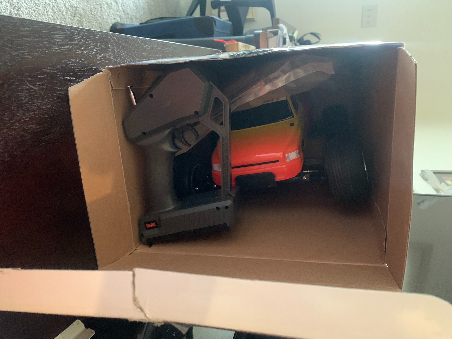

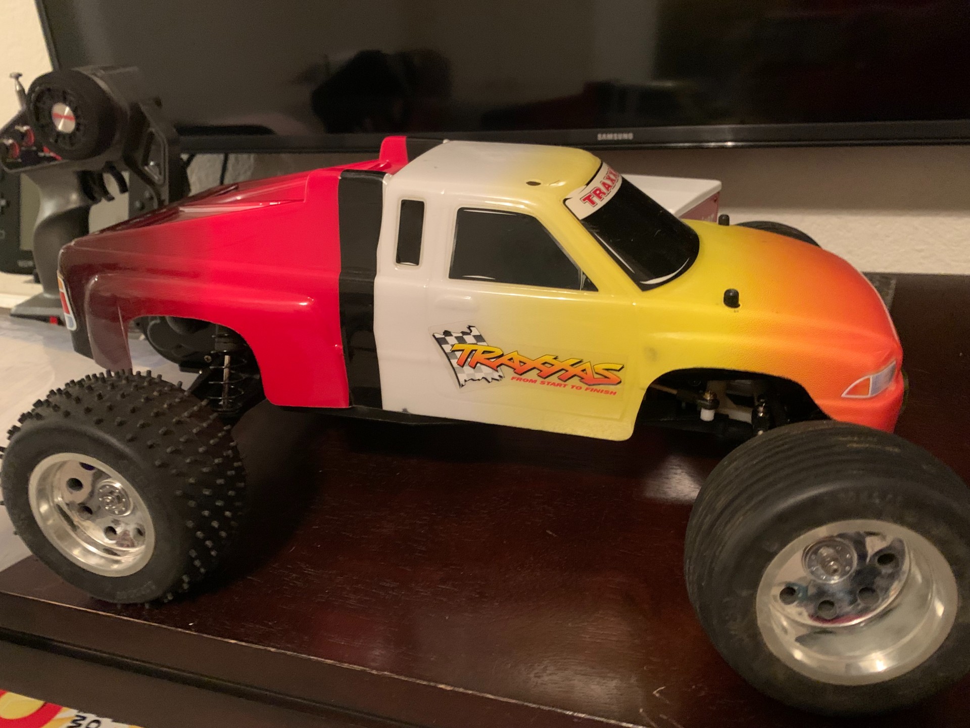

I got a vintage rustler with the box both in good condition! (Not looking to sell) What do you guys think?!

I like the bodies on these older ones much better than the new rustler bodies. I'm in for more pics. from what I can see I have to wonder if it was ever ran.

LowClassCC wrote: Thu Jan 06, 2022 6:07 pm I like the bodies on these older ones much better than the new rustler bodies. I'm in for more pics. from what I can see I have to wonder if it was ever ran.
From what the previous owner told me it had been ran once or twice before he bought it and kept it in till he sold it to me undriven
I agree the old body looks way better
