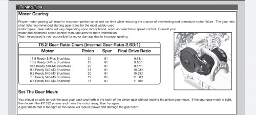

Best I can tell, a 3300kv is similar to a 13.5 turn sensored motor.
Here are the current 6T gearing recommendations, should be a good starting place.
Just keep in mind that the transmission ratios are different. So target the final drive ratios, not the pinion and spur combination.
Re: Brushless motor
I think I'm going to try a 20 tooth to start. That drops 2 teeth off what is recommended the 2.60 tranny. I have a 4500kv ordered too. I'm a little afraid that one might be a little hard on the tranny gears. Going to have to be careful when I try it in there.
