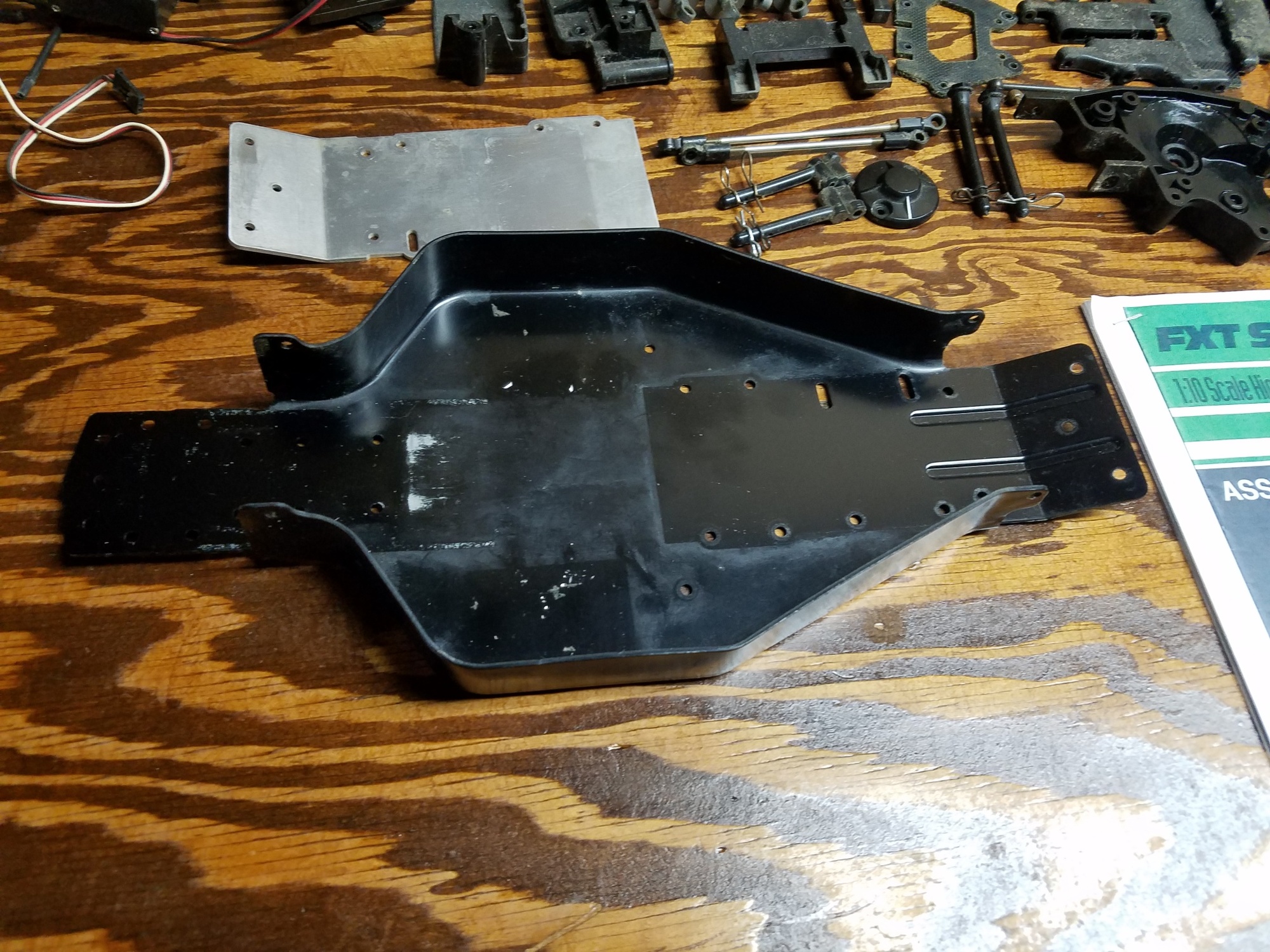

Restoring a couple old Futaba FXT stadium trucks. Just got one completely disassembled and need to refinish the chassis that's scratched up pretty bad. Please correct me if I'm wrong, is the factory chassis originally anodized aluminum..?? This is the first time dealing with something like this, not sure which direction to go. Can these chassis' be powder coated? If so, what's the process of removing the old original coating/anodize? I'm afraid the heating process of powder coating would warp the chassis, which is only 1.5mm or 1/16" thick. Or do I just prep the chassis and repaint it with high quality spray paint? Do people spray these with automotive body paint? The truck will be ran again (not real hard though) once I'm done so I would like the chassis coating to be as durable as possible. Or, are there companies that deal with this kind of stuff that you send your RC chassis to and they refinish it for you?
This is all new to me, so all options are appreciated. Below is pics of the top and bottom of chassis. Thanks for any help.

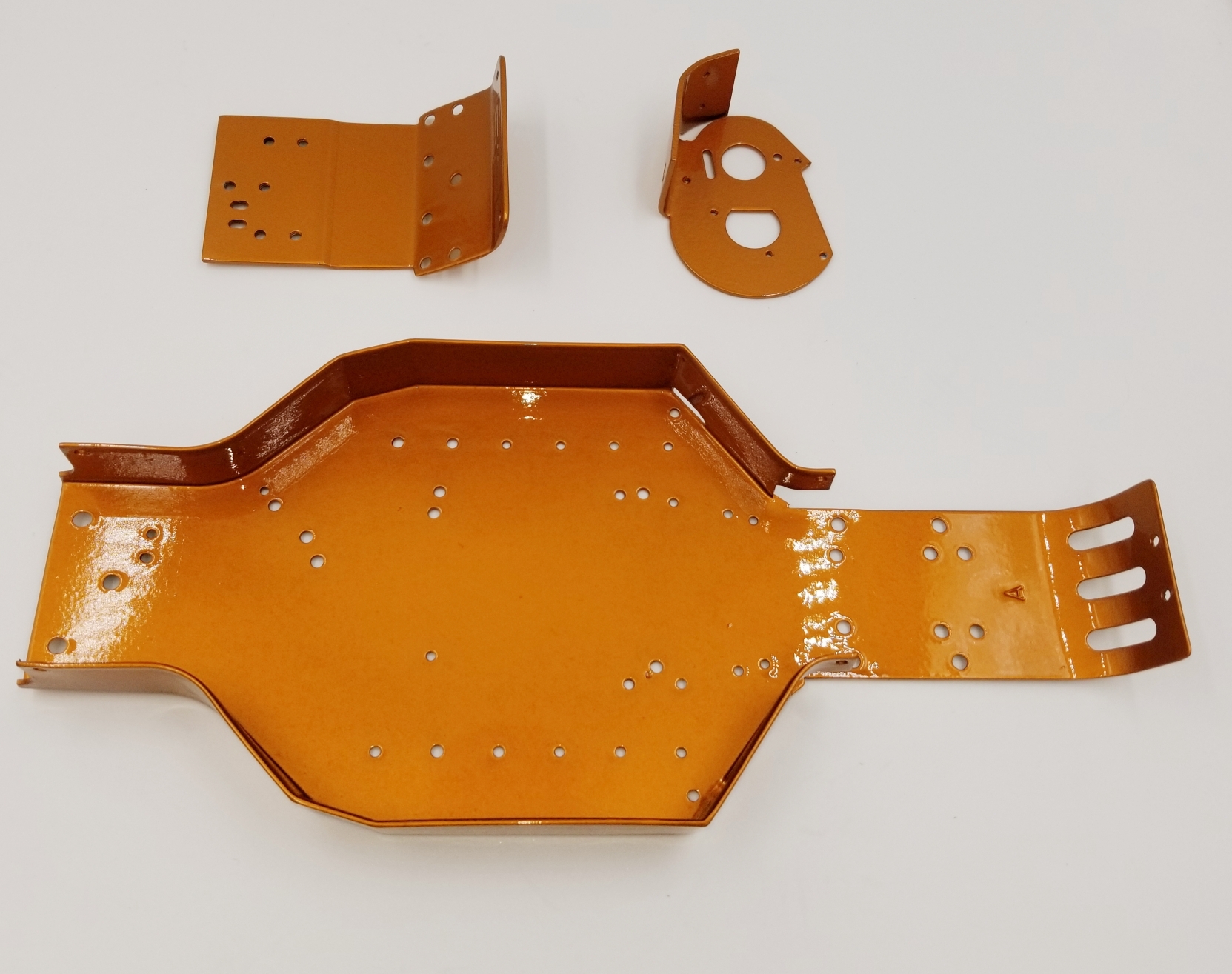

You can paint it but it won't be very reliable from scratches, this was painted with automotive lacquer then cleared... I run it lightly but it's mainly for the shelf

Is removing the old anodize only necessary if you're going to powder coat it? Due to the chassis needing to be bare metal. If going the painting route, would it be ideal to just wet sand the chassis then apply etching primer, paint and clear? Or is deanodizing better regardless? Even though I'd really like to powder coat the chassis if possible. My brother powder coats at his shop and I could have it done at no cost, I'm just afraid it will get ruined/warped from the heat of baking. I have no clue how much heat 16gauge aluminum can take. Too bad these things aren't reman'd and can't be replaced, otherwise I just powder coat it as a test dumbie and if it gets warped, I'd just caulk it up and buy another.Coelacanth wrote: ↑Wed Feb 03, 2021 3:34 pm Removing the old anodizing should be easy enough. Use Easy-Off oven cleaner, the heavy duty one with the yellow cap. Spray on, let it soak for several minutes, then scrub it off. That's how I do all my deanodizing.
Getting rid of the scratches will be a much tougher proposition...![]()
As far as the boatload of scratches, I guess all I can do is sand down the rough/high spots as smooth as possible and call it good. There's no way to make it look brand new, but at least I can do my best to make it not look like shat.
-Jerry-
