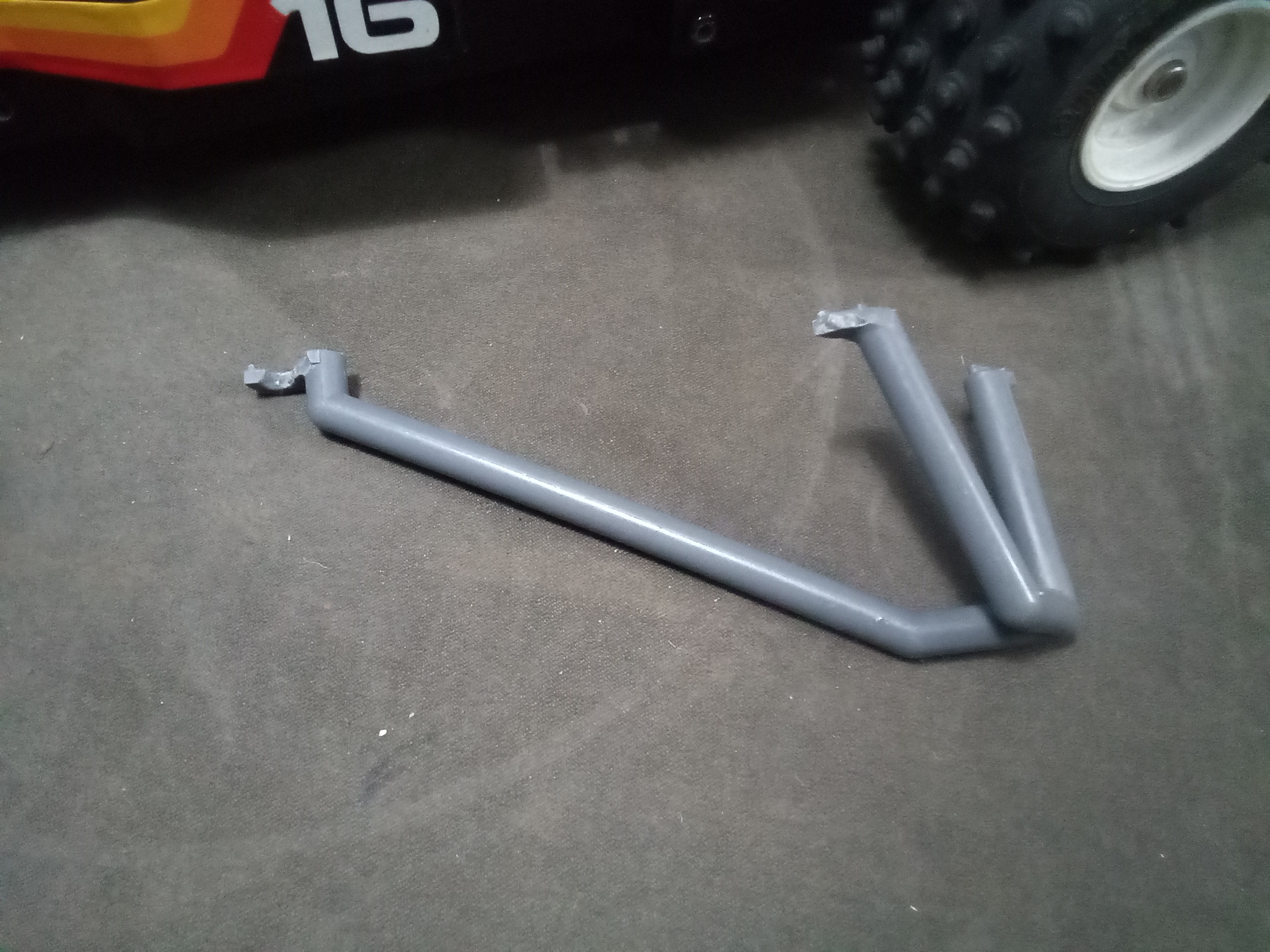

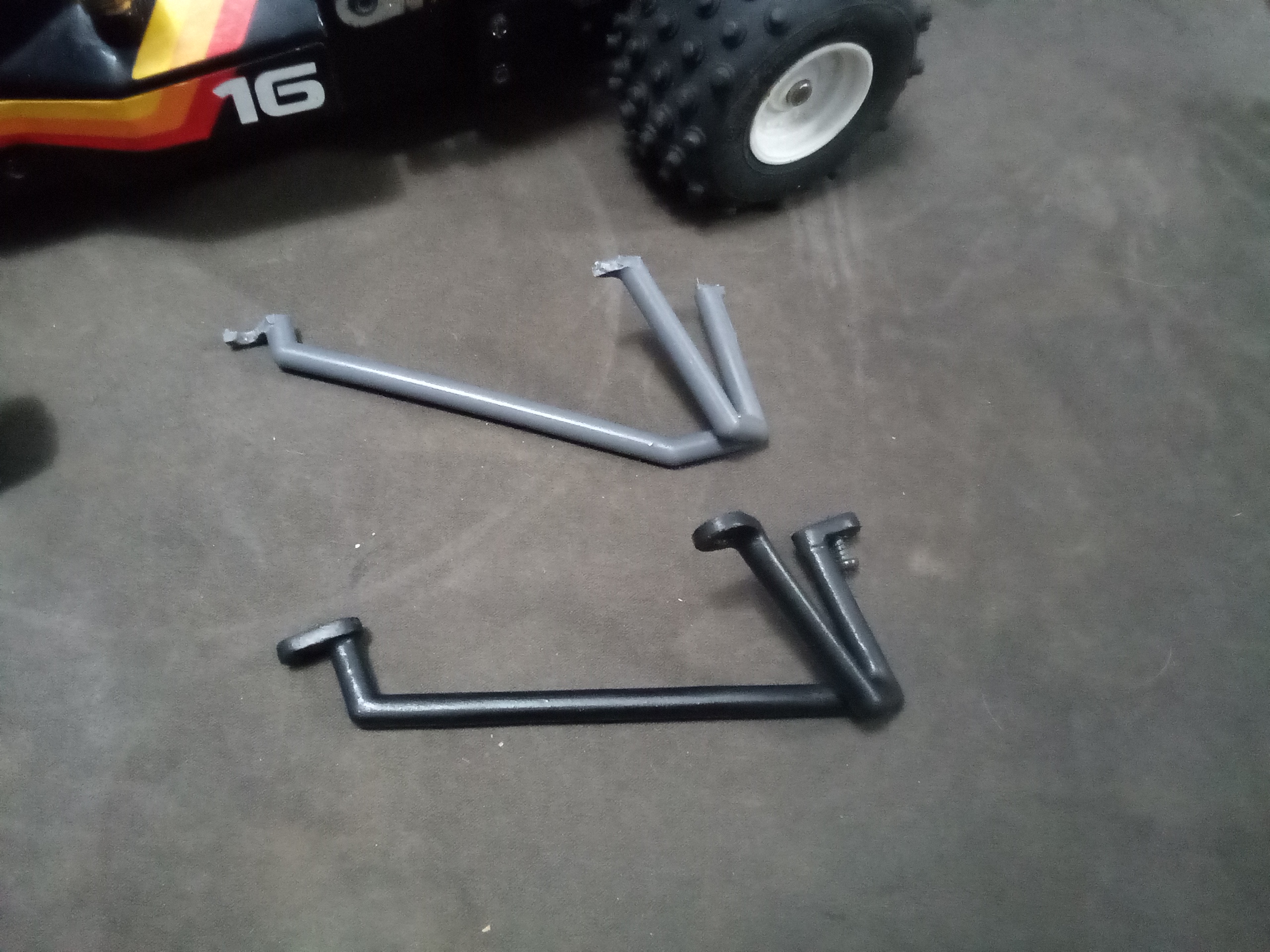

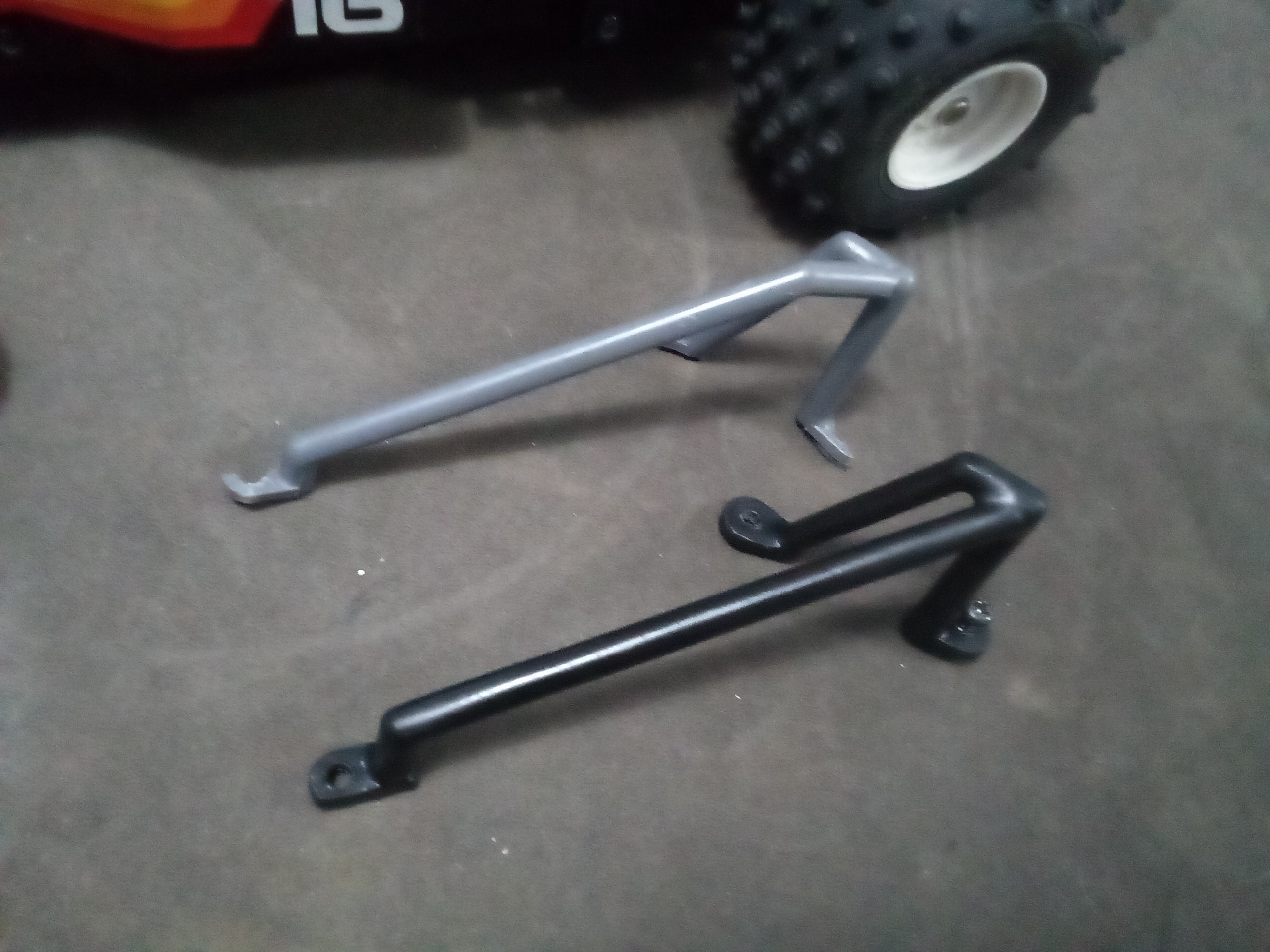

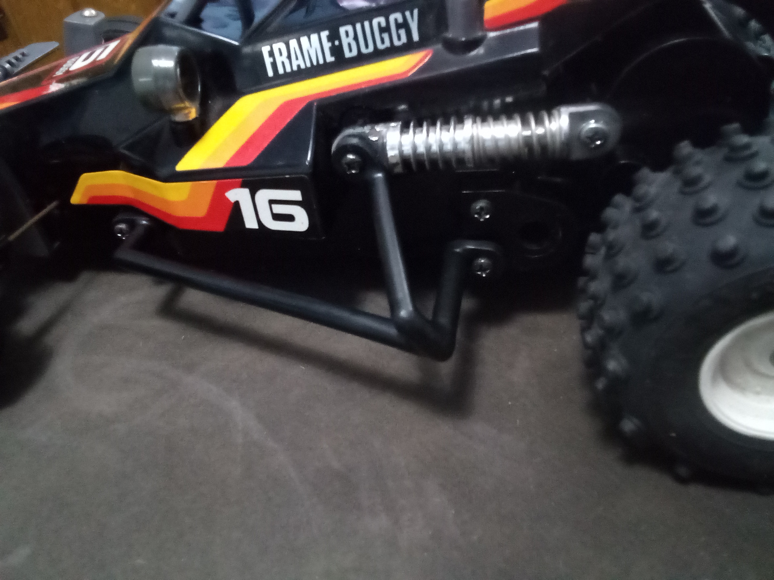

The next thing was the nerf bars, a bit of 3d sketching in Fusion 360 and we have this(3d sketching is, well it's hard to explain but it does odd things that are like putting my brain in a micro wave oven ), it's black because I just couldn't colour Mach the grey.
It's not exact but it had to be possible to 3d print it, it's FDM (filament) printed then painted with 3d printer resin to smooth out layer lines, then painted with ...well paint. :D
Think they look good enough.

Dadio wrote: Mon Apr 04, 2022 4:02 pm It's not exact but it had to be possible to 3d print it , it's FDM (filament) printed then painted with 3d printer resin to smooth out layer lines , then painted with ...well paint :D
Would you please explain how do you paint with 3D printer resin... Idea looks very interesting :)
And nice result, by the way.
How are you going to deal with the wing, as it seems that there is no sample to reproduce it?

Once you have printed something with a resin printer it is not fully cured , the resin still needs to be cured under UV light to make it fully hard so anybody who has a resin printer either has a UV light of a curing station but curing stations are more expensive , I have the UV lamp , basically the resin is just a thin liquid and can be brush painted onto an FDM printed part then 20 seconds under UV light , it fills the layer lines gradually , after painting a thin coat you cure it with the UV light then you can paint another cote untill it's smooth , the resin is also very easy to sand compared to PLA or most other filaments , it's kind of a lazy way to good looking prints, it's fast too but the resin is not cheap , fortunately it doesn't use much resin .

The nerf bars look great ! The main thing i don't care for with 3D printed parts is the layer lines/finished texture. Just looking at your nerf bars, no one would guess they were printed.
