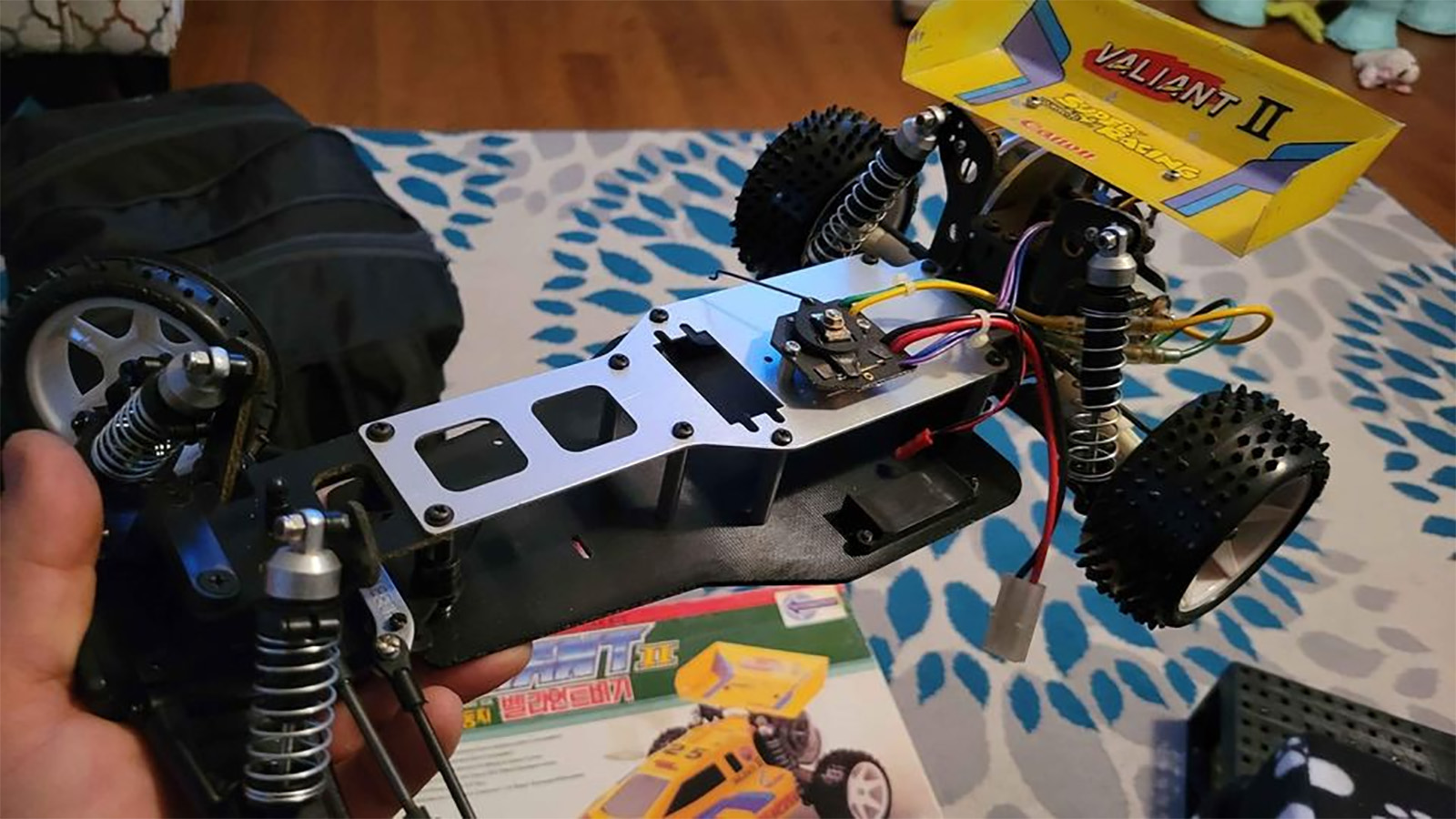

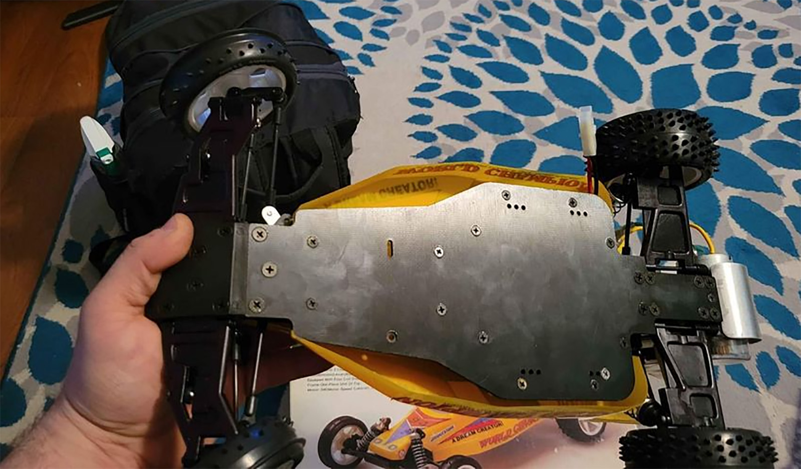

This turned into a typical FBMP fawkup. I "bought" one earlier today, but then the seller sold it from under me. Par for FB douchebags. :roll:
Here are some pics of the one I "bought," and a link to pics of another one.

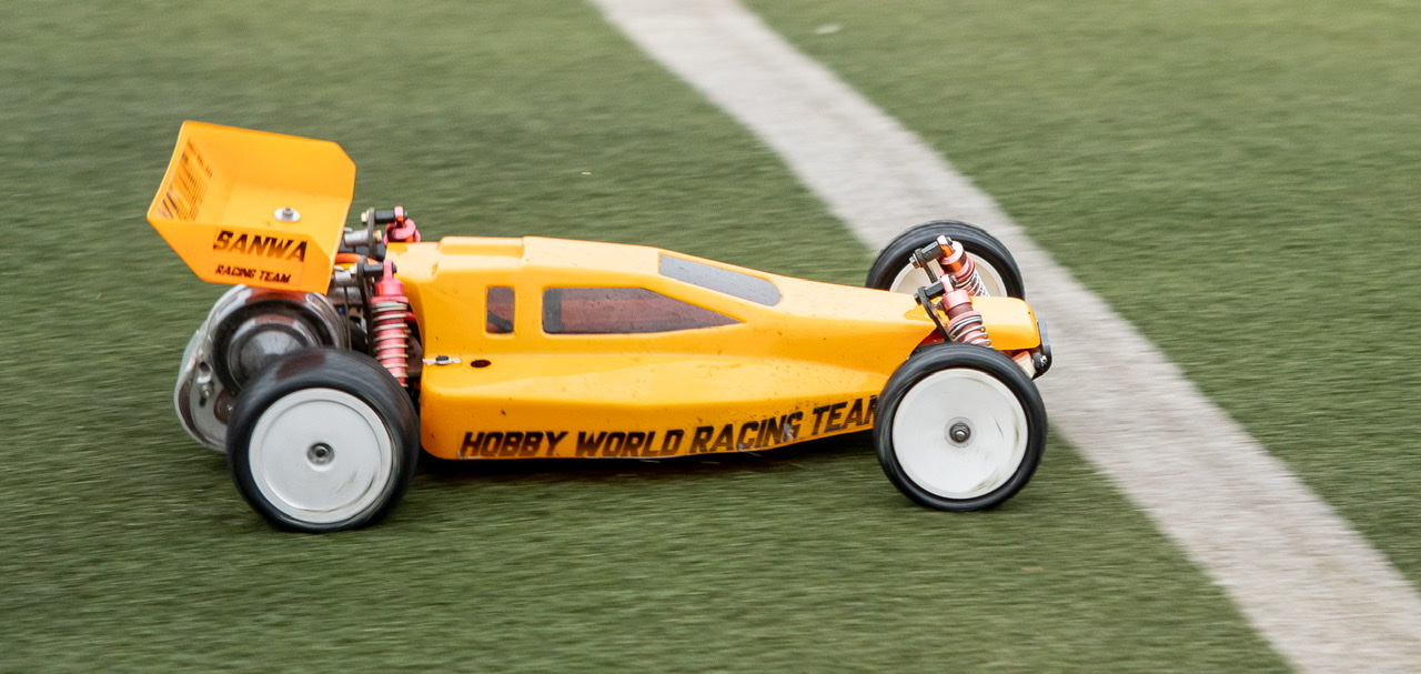

This is my modified one in action earlier this month.
photocredit : Ralph Loch

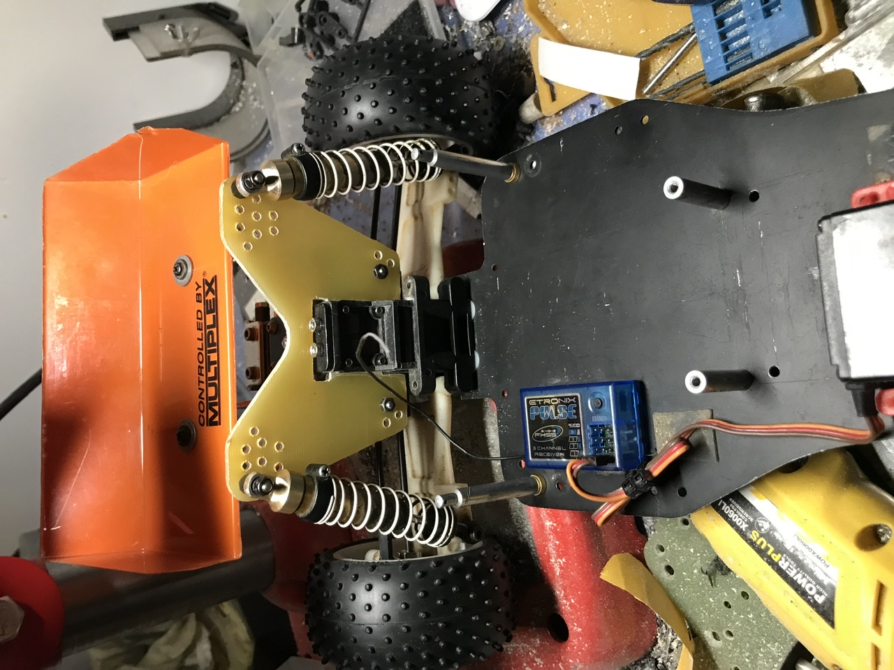

I also have a variant of it: made by hobbyworld for multiplex. The one with an outrage inspired body.
Neither are clones of the trx-1 or kyosho triumph. There’s only very superficial similarities.

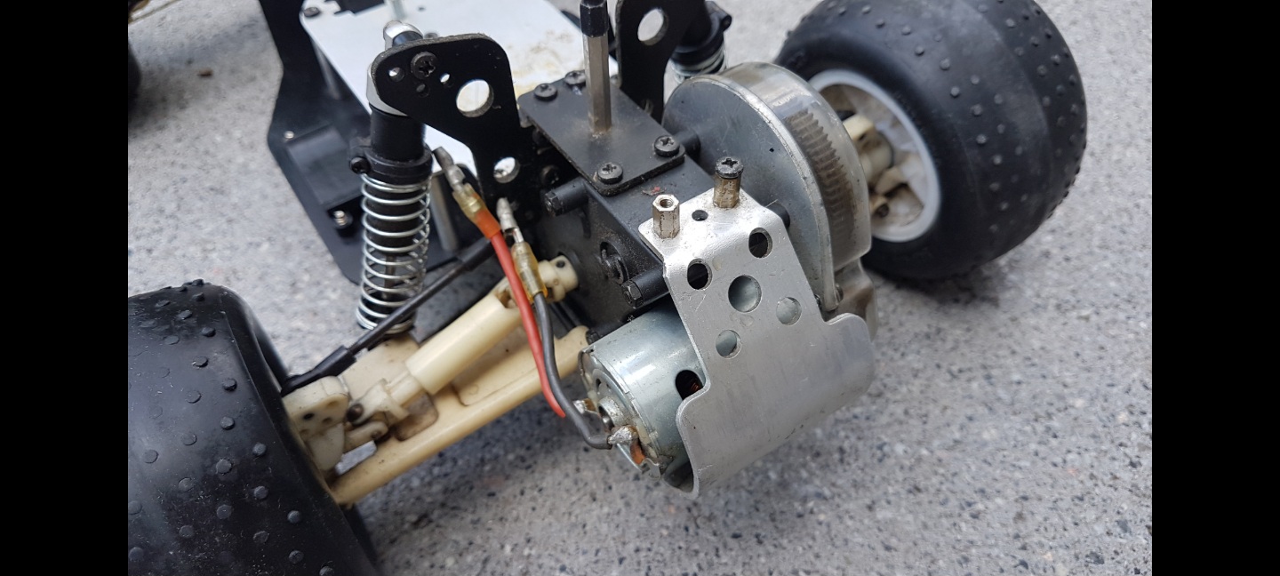

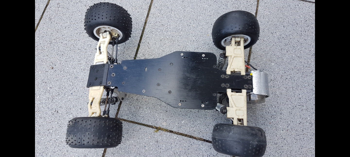

Post by Mr. ED »

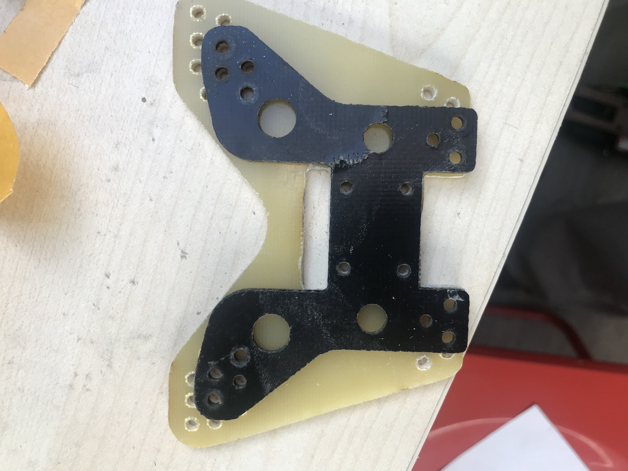

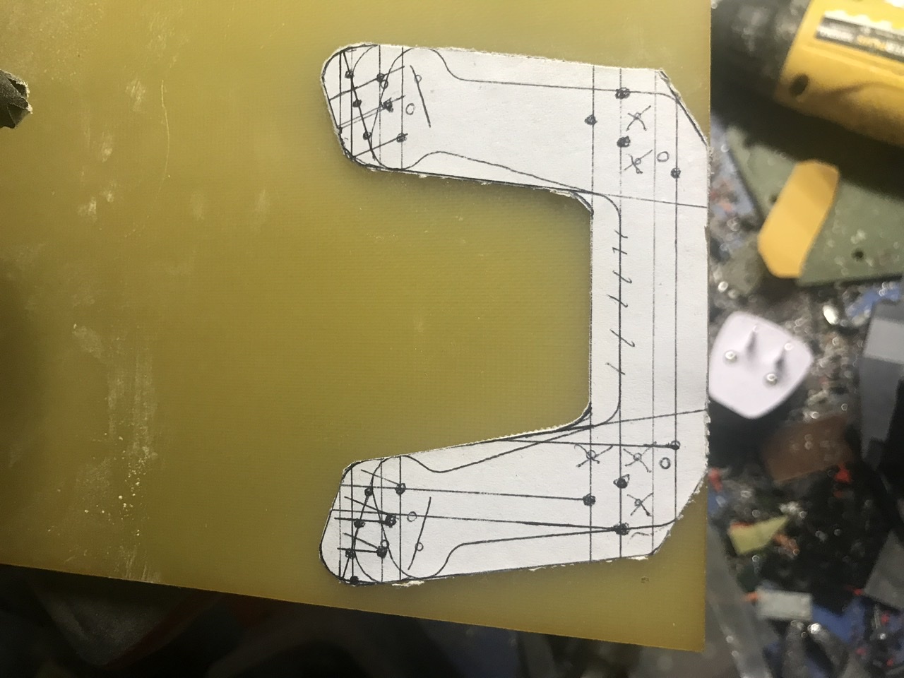

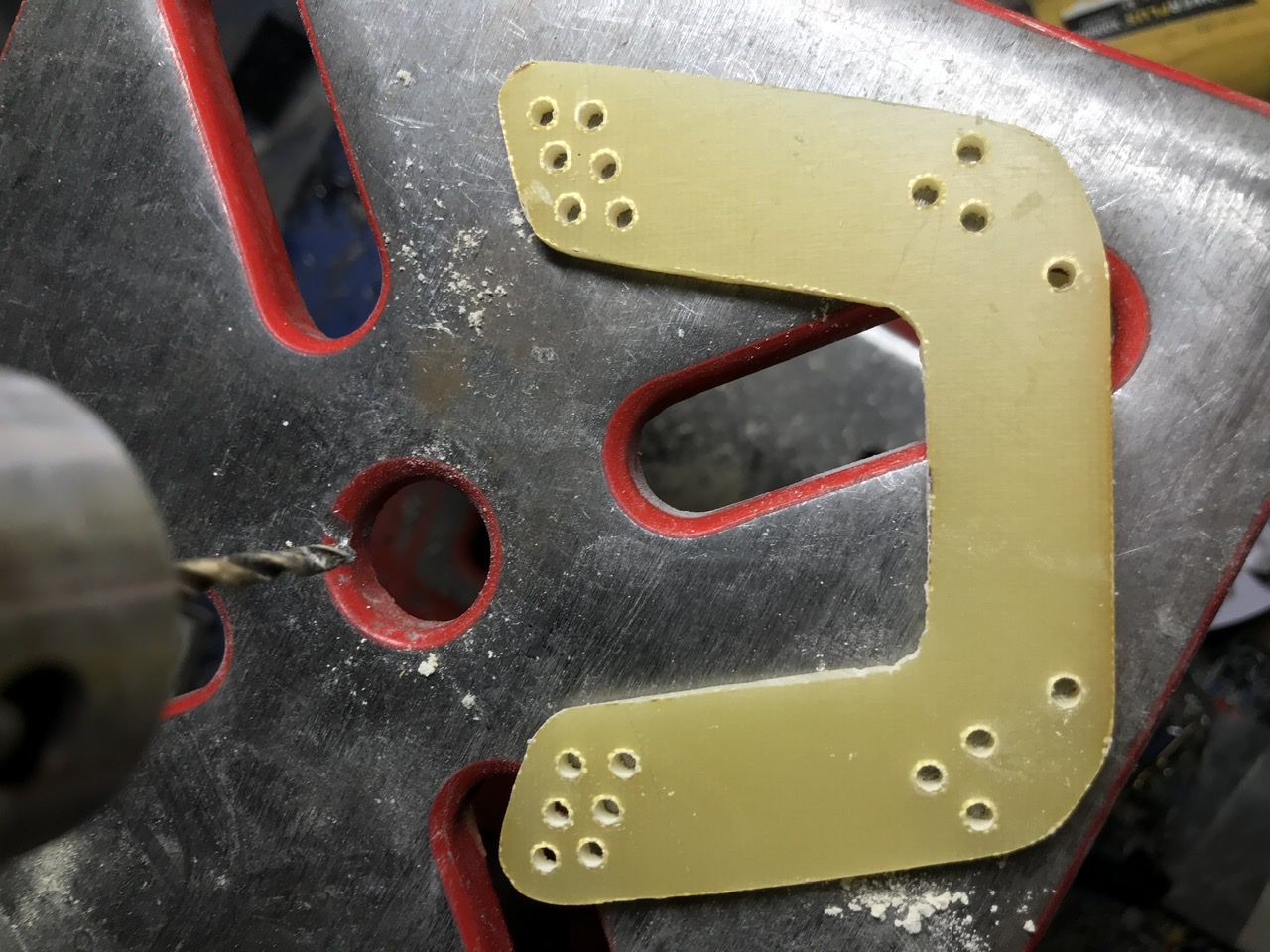

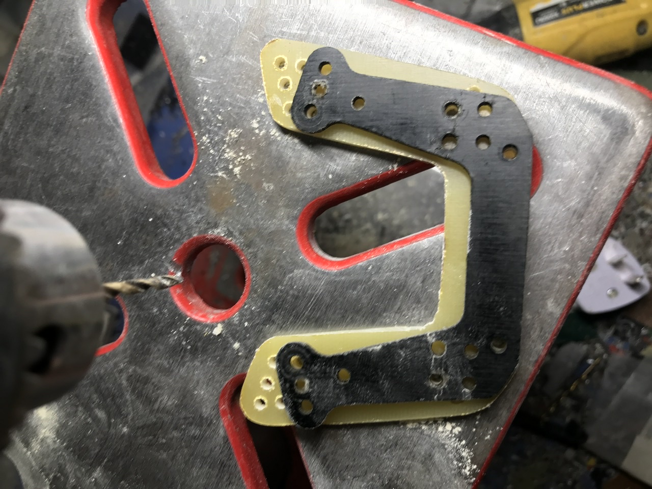

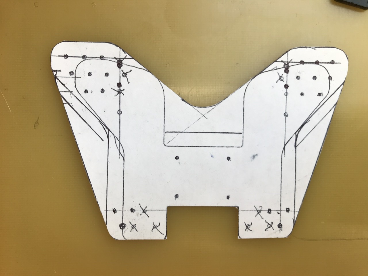

I made some new shocktowers as the epoxy ones broke and the alu ones bent. I used an old plate of natural colour epoxy in 3mm thickness. I also modified the design to have something stronger and with more usable tuning options. Hope you like it.
