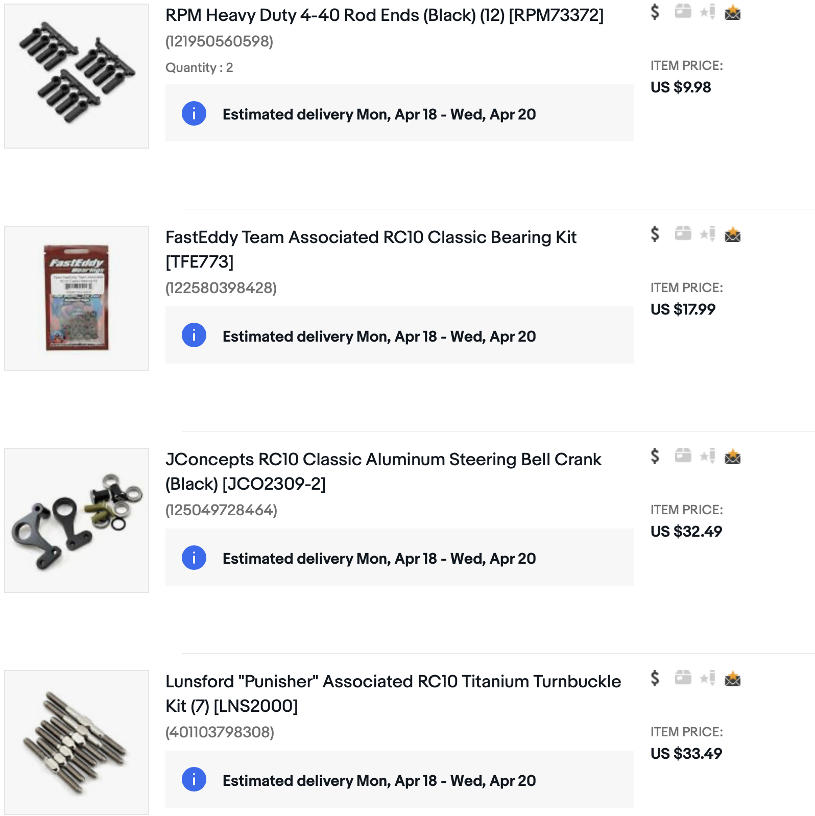

Yes, the LNS2000 is the Punisher kit for your short front arms RC10. You can get it for that same price with cheap shipping and no tax from A Main Hobbies:
https://www.amainhobbies.com/lunsford-punisher-associated-rc10-titanium-turnbuckle-kit-7-lns2000/p274100
I would also get an adjustment wrench too, if you don't have one small enough. It fits the Punisher turnbuckles as well as Schumacher.
https://www.amainhobbies.com/schumacher-steel-turnbuckle-wrench-5.5mm-3.9mm-schu4229/p1239380
You might be able to piece together that Lunsford set cheaper from Schumacher steel (HTT) turnbuckles
https://www.amainhobbies.com/search?cID=&s=Schumacher+turnbuckle

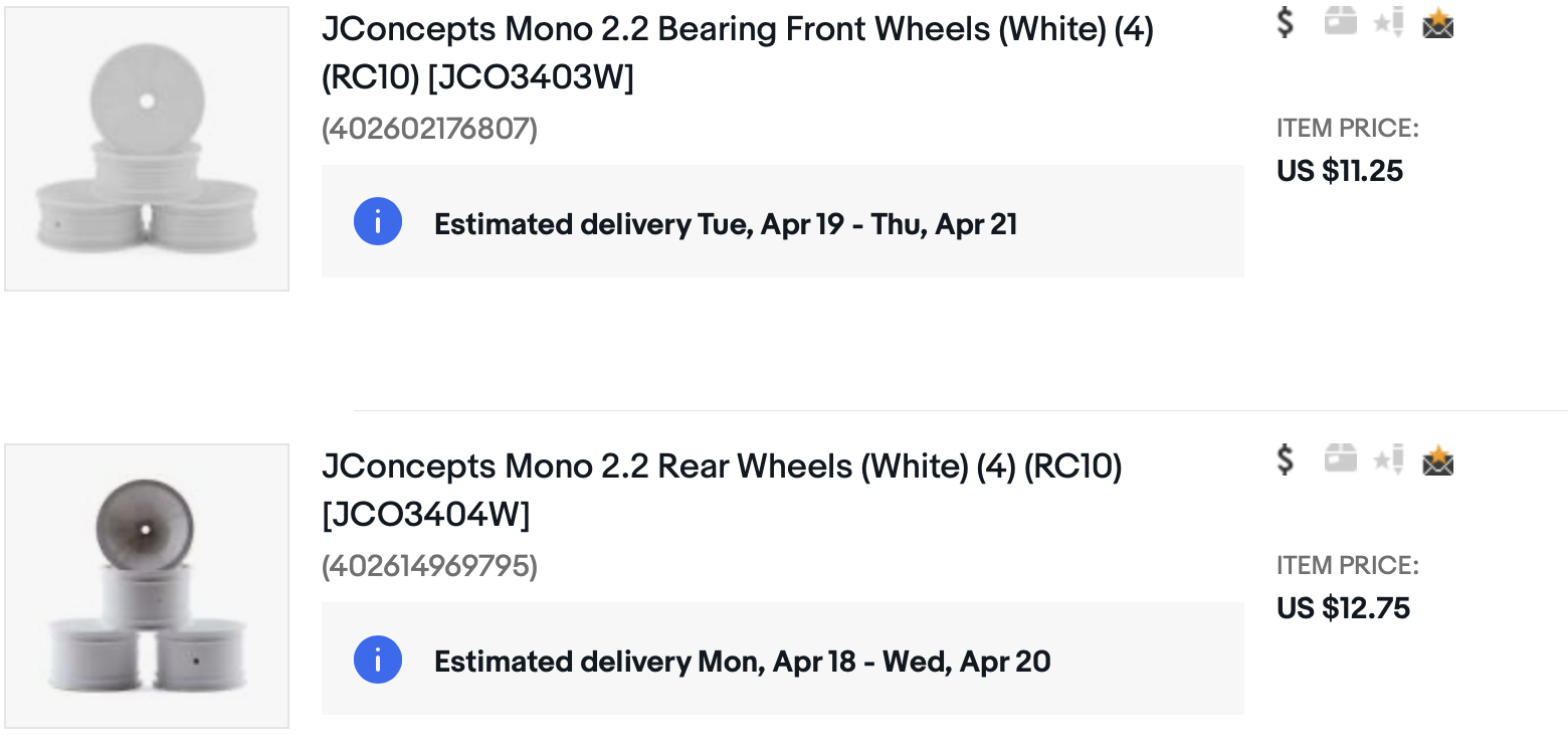

ok, so I ordered a few things tonight. Still need to get some body mounts (not a biggie) and a wing wire and buttons.

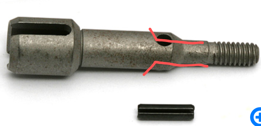

You should have asked first. Those rear wheels are for 3/16" axles, your car has 1/4" axles.

juicedcoupe wrote: Thu Apr 14, 2022 10:18 pm You should have asked first. Those rear wheels are for 3/16" axles, your car has 1/4" axles.
Wonder if I can drill them? Bummer😒
Posts: 3677
Has thanked: 2520 times
Been thanked: 2822 times
Re: Basement find
Not sure how much success you'll have trying to drill the 1/4" axle taper. Getting off center could make for a really wobbly wheel.

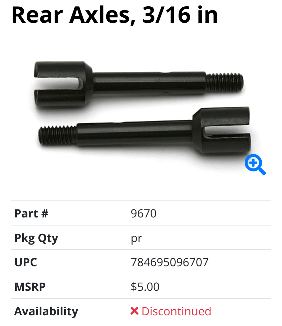

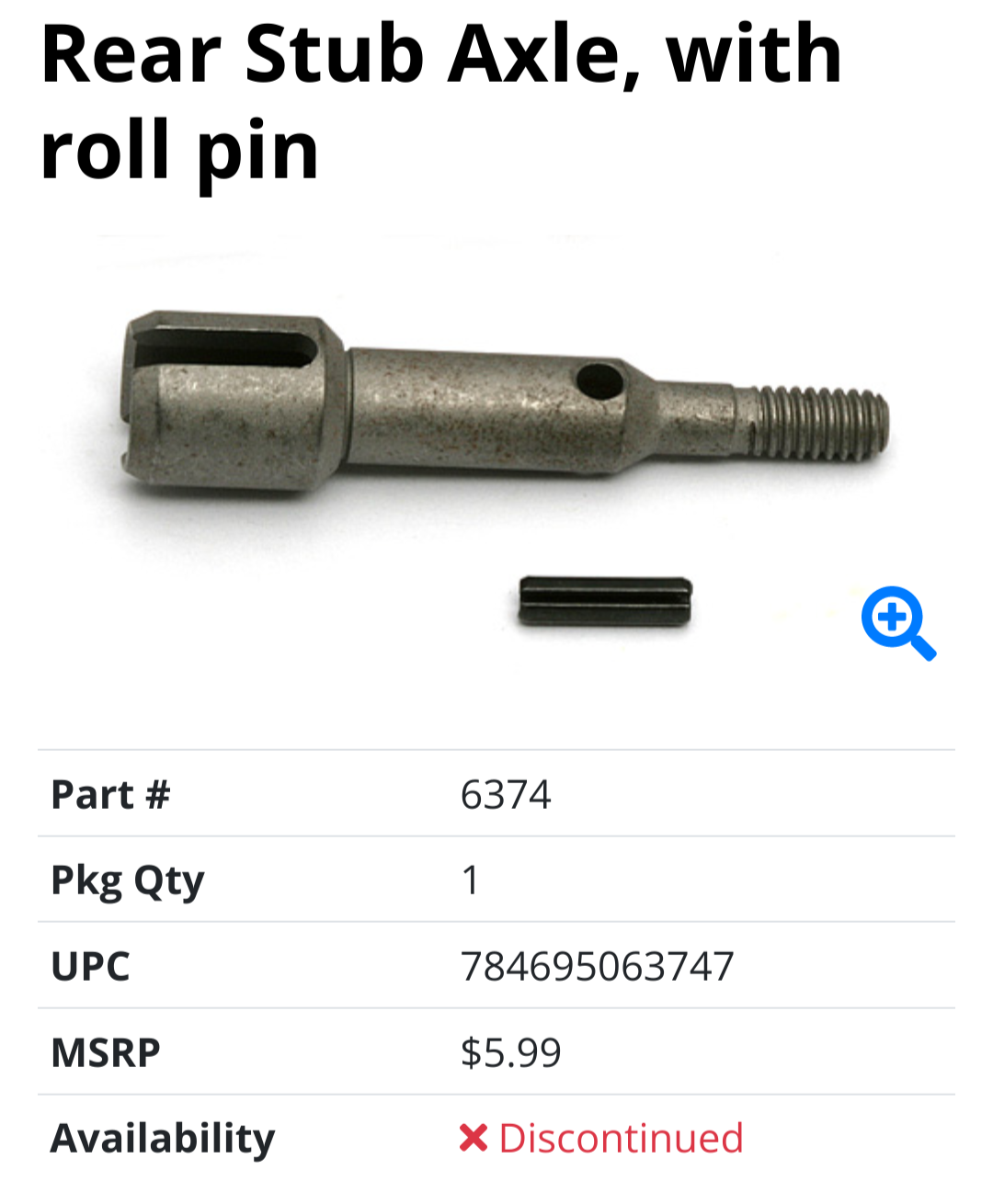

Your rear wheel options probably are:
1. Get 3/16" rear stub axles and flanged bearings. Axles aren't readily available.
2. Get Custom Works Short CVD kit and again 3/16" flanged bearings. Right now most places appear to be out of stock on the Short CVD kit
3. Get 12mm hex adapters and hex rear wheels
4. Get 1/4" rear wheels. Need to consider the rim size preferred (1.6", 1.9", 2", 2.2")
5. Get additional tires for your original wheels

I will be working on this for a while, I’m going to try and find some cvds, 3/16 or 1/4” if you know anyone that’s selling please let me know, I saw some on eBay for crazy money so I can wait till I find a fair price. Thanks for options you guys are super helpful!!! The wheels were cheap enough I may try drilling but like I said, I have time so hopefully I find a a set.

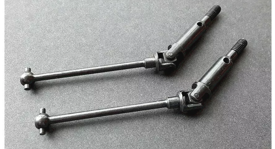

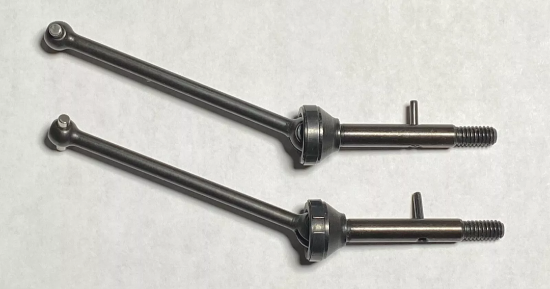

Is the worlds rc10 the same as mine as far as cvds go?
Posts: 3677
Re: Basement find
RC4X4 wrote: Fri Apr 15, 2022 7:45 am Is the worlds rc10 the same as mine as far as cvds go?
Looking at online build manuals, that's a maybe. Some versions show 1/4" axles, some show 3/16" axles. There are also universal joint axle assemblies that are all seem to be 1/4" axle (2nd photo).

If you had a metal lathe or know someone with one, the 1/4" axles could be trimmed a little so they accept 3/16" wheels and still use the 1/4" bearings.

Frankentruck wrote: Fri Apr 15, 2022 10:58 am If you had a metal lathe or know someone with one, the 1/4" axles could be trimmed a little so they accept 3/16" wheels and still use the 1/4" bearings.
I will do this on my lathe thx for the idea!

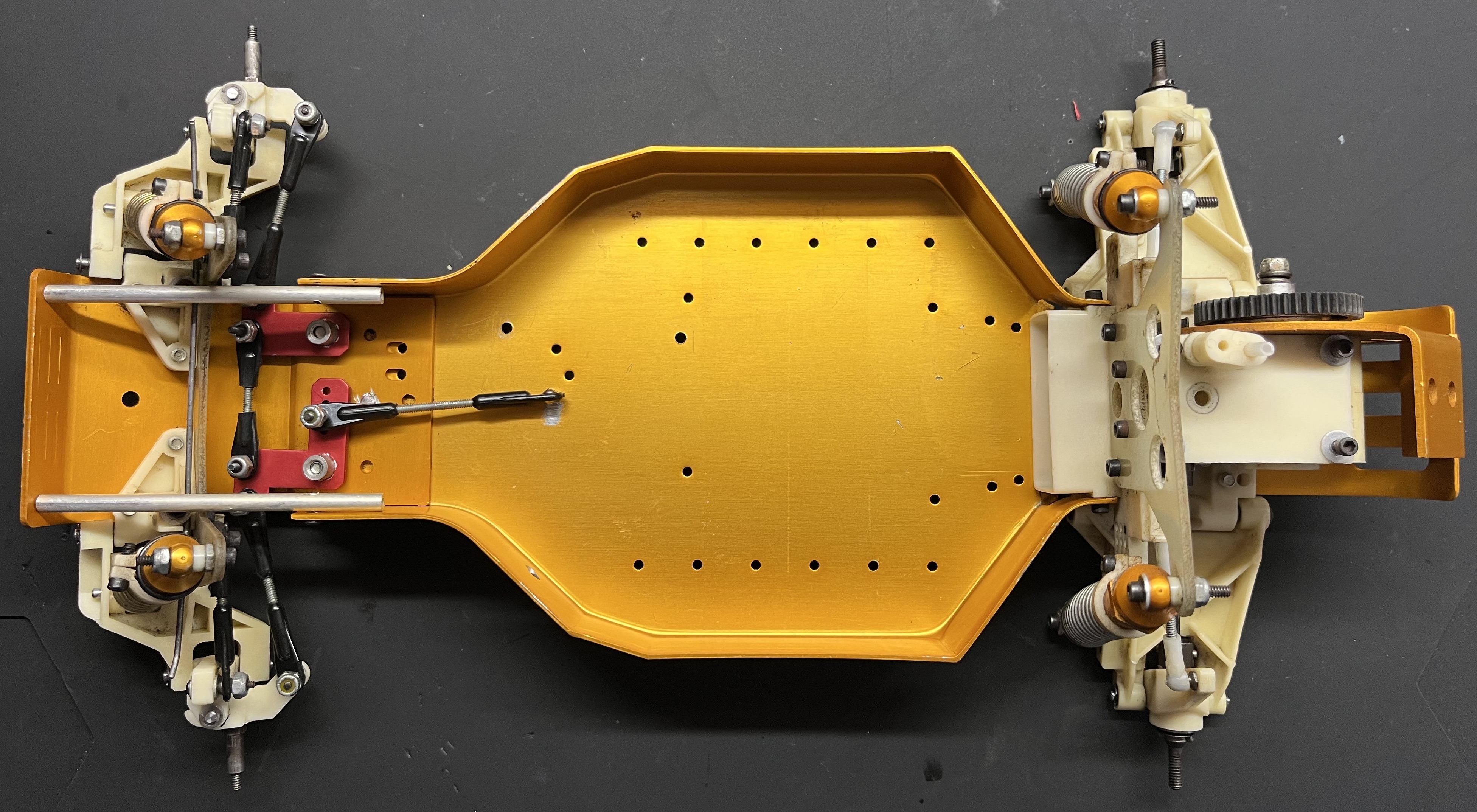

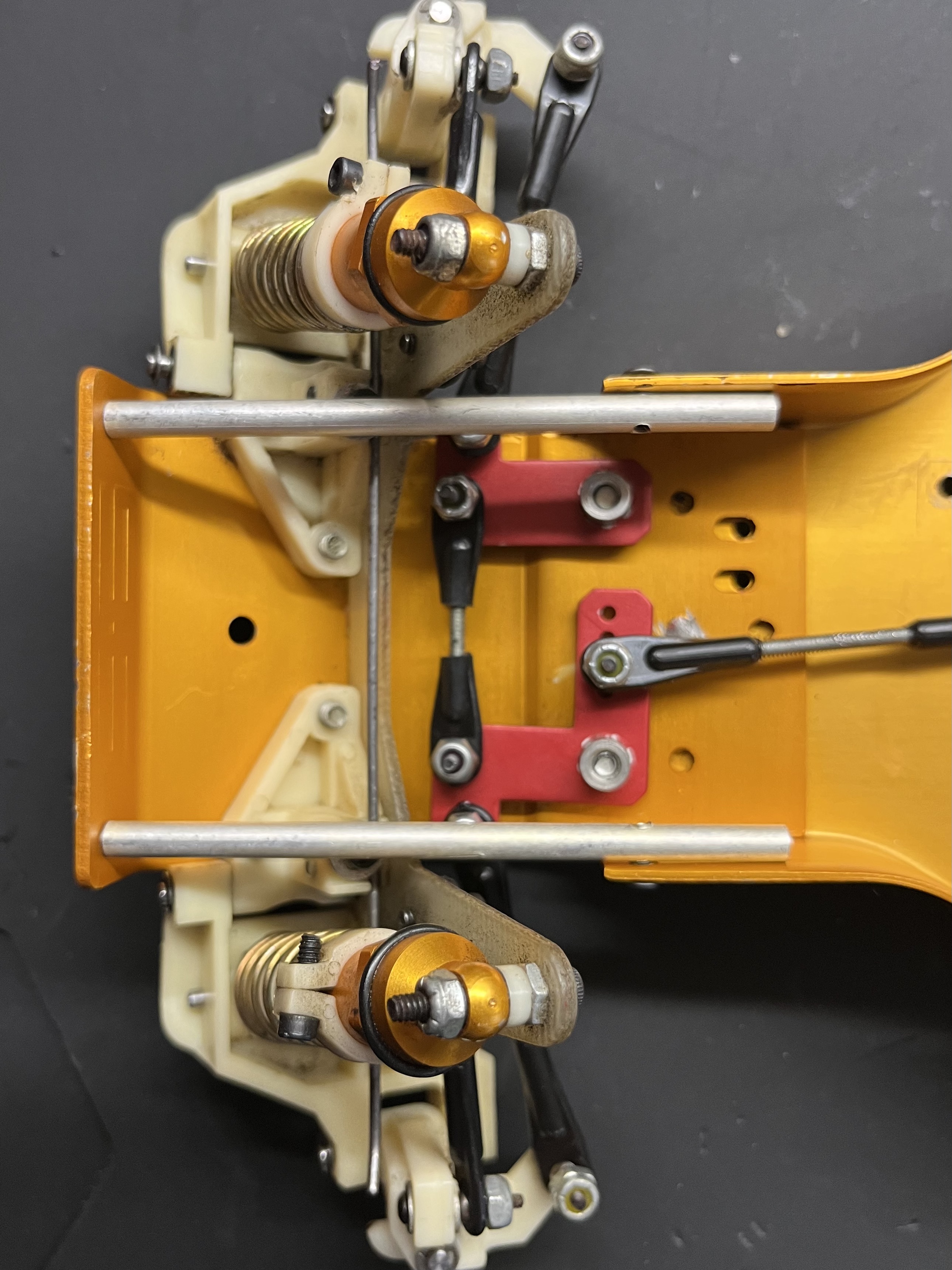

Did a quick clean up, just to see whats under the grime. It will make a really nice runner!

Does anyone know who made this suspension limiter?

a few pics of the first cleaning
Posts: 3677
Re: Basement find
It did clean up nicely.
That looks like a straight wire was being used in place of the front sway bar, which would have had ball cup connections to the front arms.
