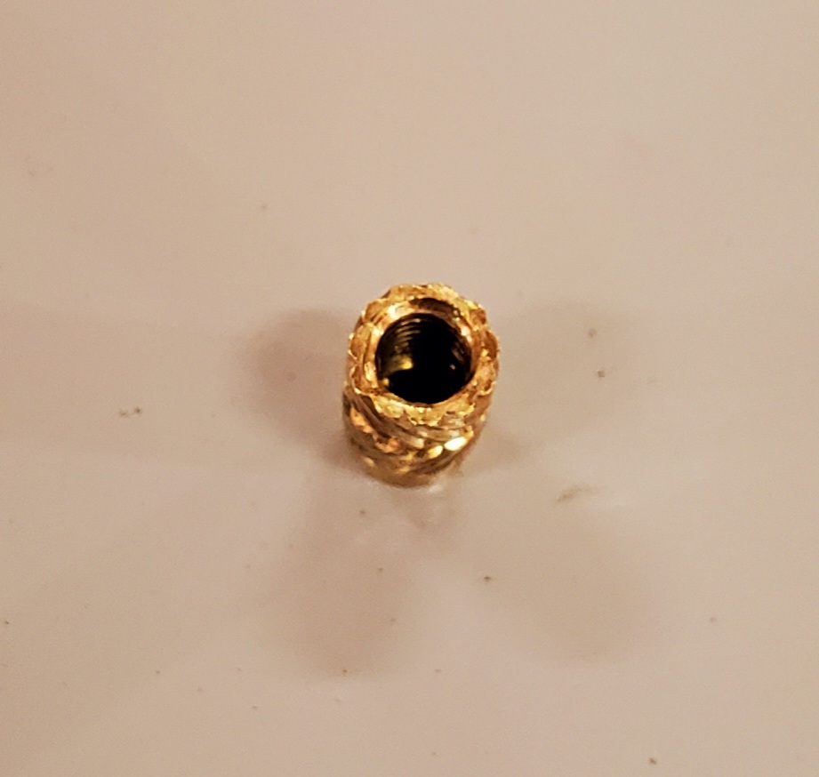

I have repaired many Le Mans motors with 3m knurled inserts from Ebay...works perfect....make sure u drill properly and I used a vice to press them in

i didn't know these existed. very interesting! The M3 ones I've found seem quite long (9mm) so may not work so well for the motor face.
thanks for this -- now I see that was what Dadio was recommending also:
I apologize, but I misread this earlier and thought the picture was a helicoil. now i see it's a knurled insert!Dadio wrote: ↑Wed Apr 20, 2022 3:22 am I'd try a thread insert , they are designed to be used as metal thread inserts for plastic parts ,I have some in M3 , you stick them onto the tip of a soldering iron and push them into a plastic hole meeting them into place , they are knurled on the out side to grip , I think if you drilled out the thread to just the right size hole you could press one into the ally .
I'm uncertain whether the helicoil of knurled insert would be best - but it sounds like both are known to work!
At this point I'm leaning towards the helicoil since the kit juicedcoupe recommended is easy to source and has a good selection of depths. I also like that the coil would contact the entire inner diameter of the hole in the motor face plate.
The knurled inserts I've seen look like it would be harder to get the knurls to align just right with the motor face (some of the knurls may end up inside the motor and not really contacting the face plate...).

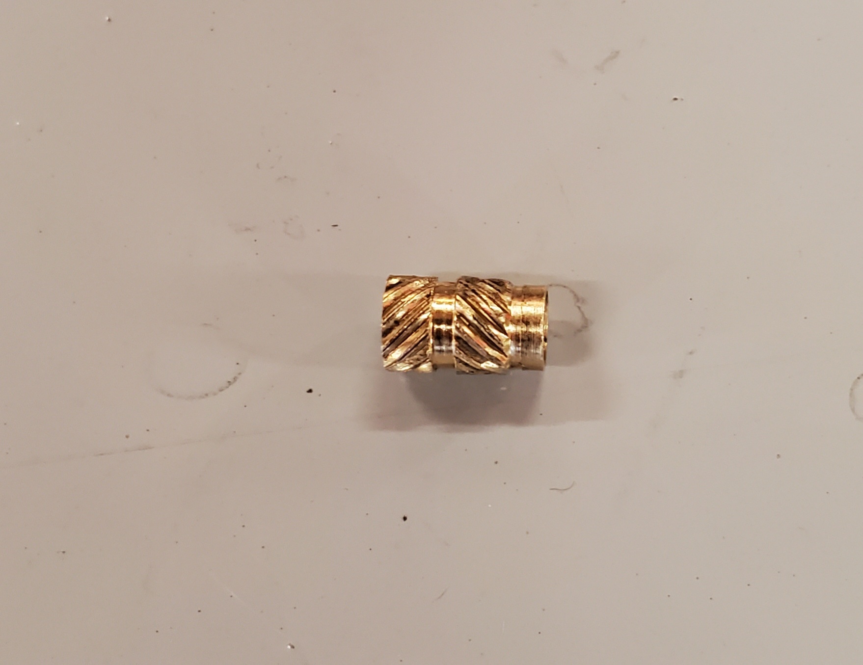

- coxbros1
- Posts: 2495
- Location: Energy, Illinois
- Has thanked: 2758 times
- Been thanked: 2407 times
Re: Stripped Le Mans 480Gold mounting holes
I will get a pic of the inserts, might not be till tomorrow, i bought them awhile back and have no link to actual units

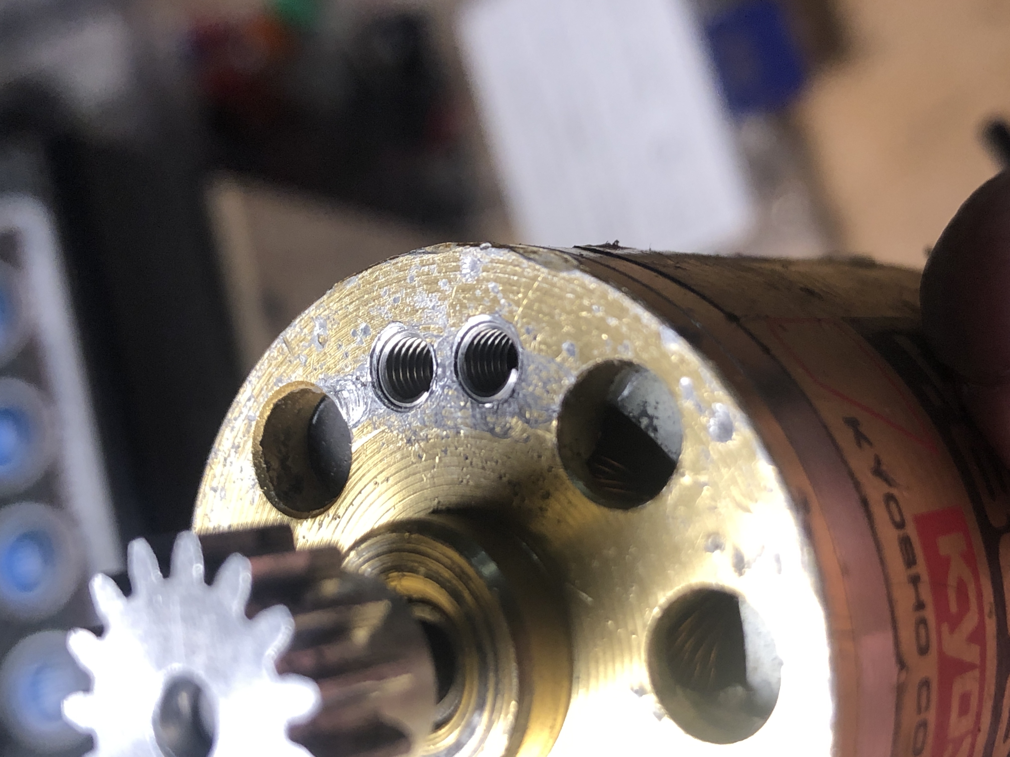

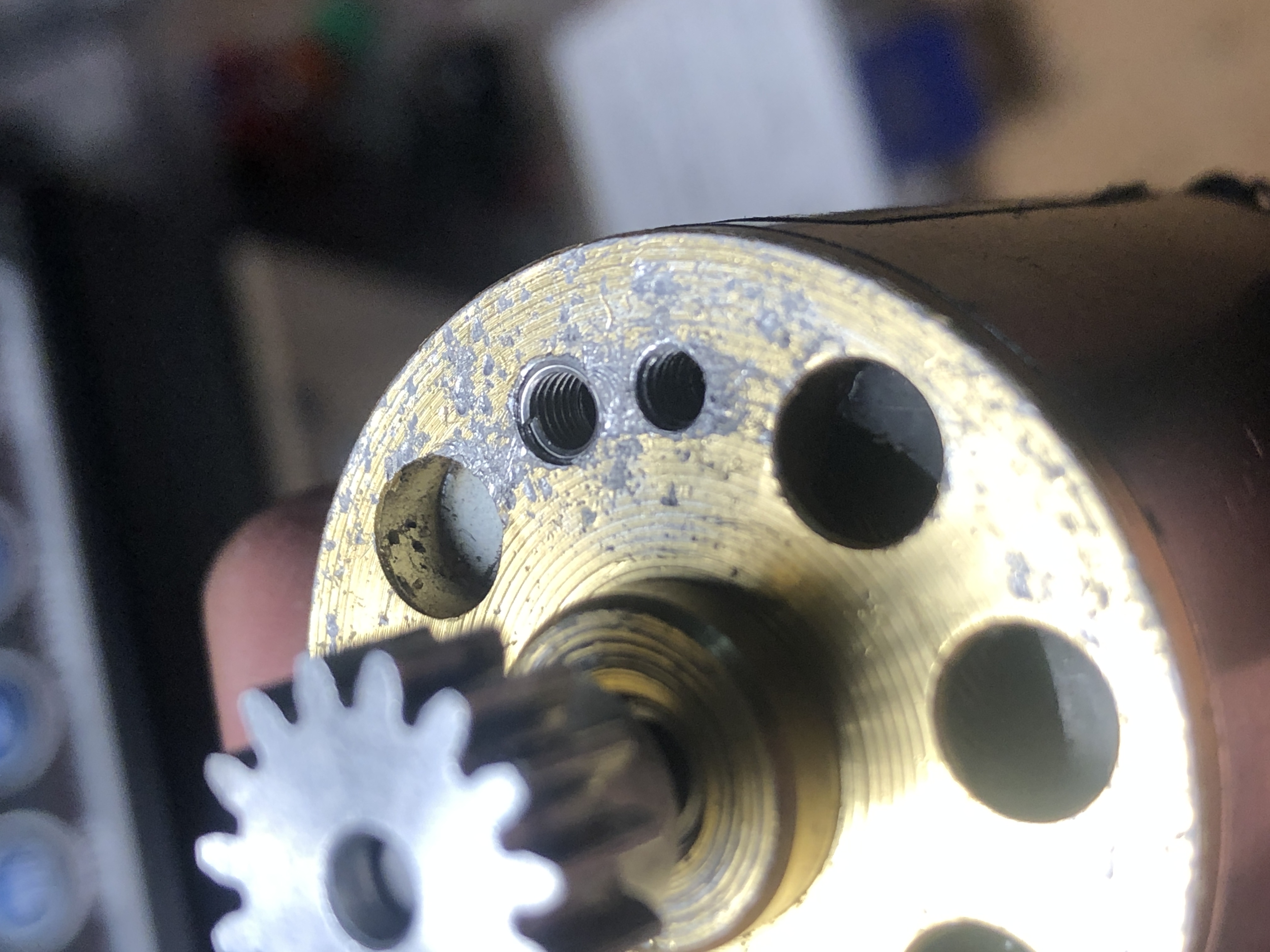

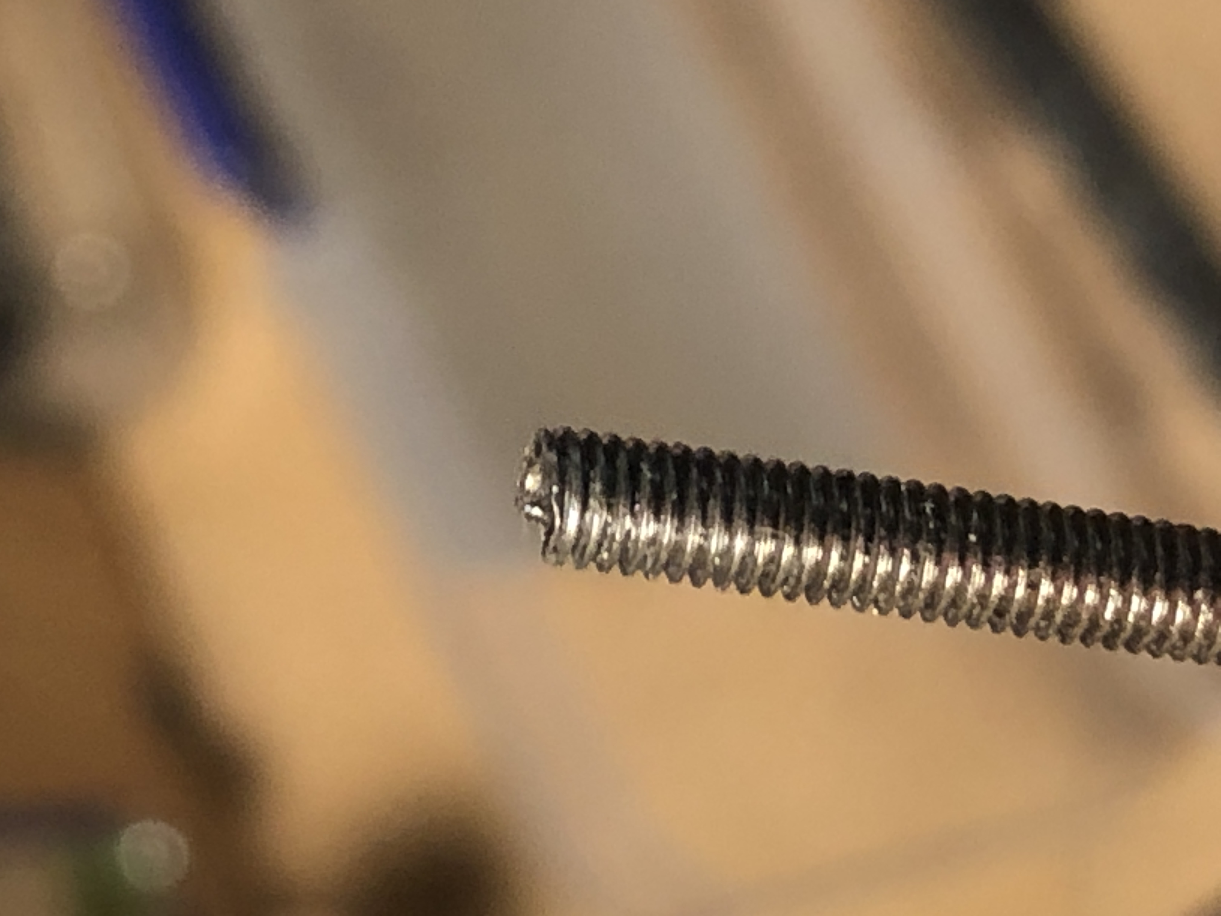

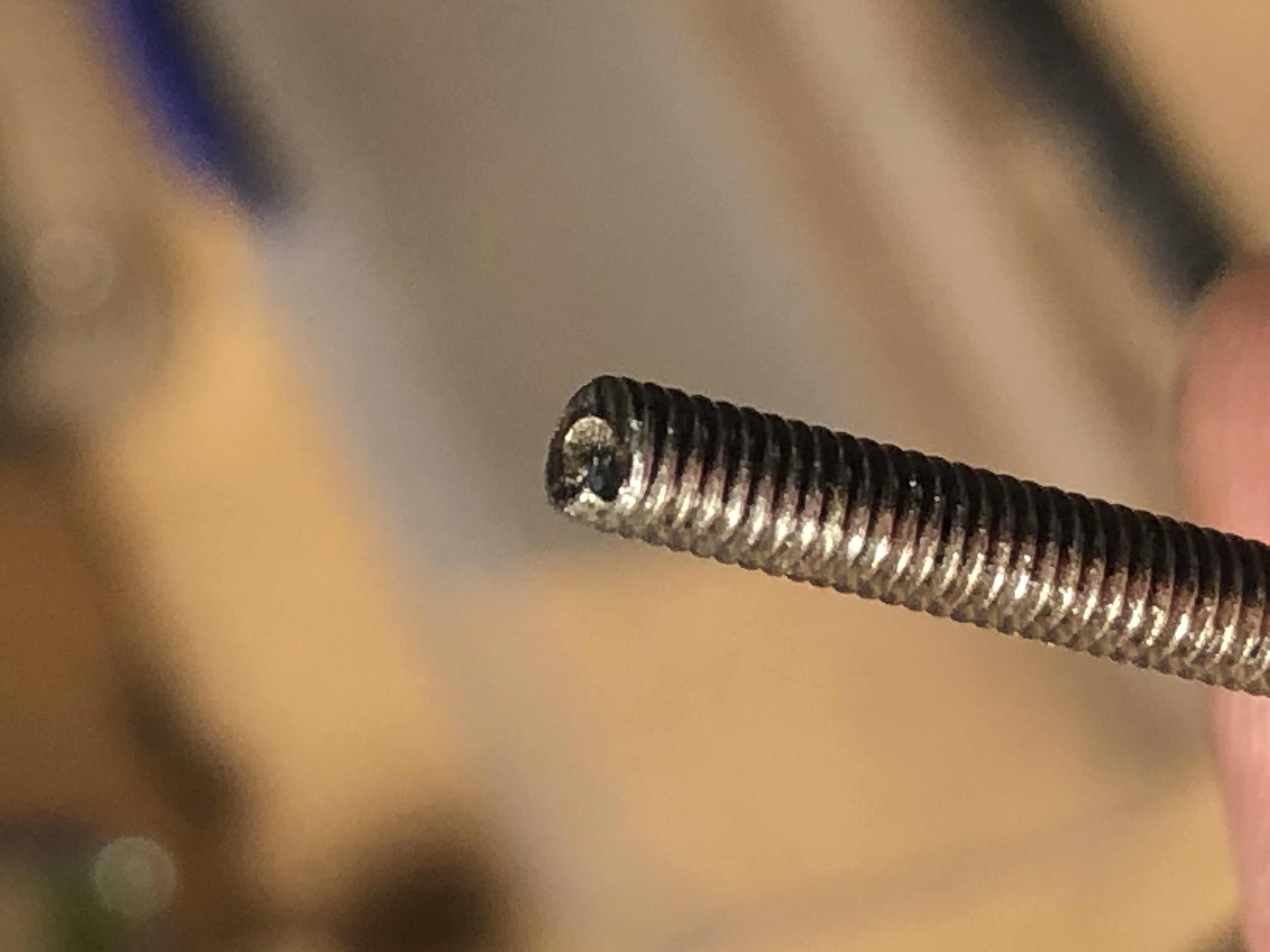

It took me a while to follow-through but i obtained the helicoil kit and completed the repair tonight.
I'm happy with the result! I repaired the 3 stripped holes and IMO it looks good (well, the repair, not necessarily the motor!) and holds securely on the Ultima. The motor has perhaps been too well loved by its previous owner, but this will certainly do to get it going again as a light runner
A few things I learned:
* drilling and tapping was pretty easy in the aluminum as expected. the only issue I had was i did't have the right driver to fit the square end of the tap (I assumed this would be the handle in the kit, but that's a larger bit size), so used a small 4" adjustable wrench that fit in my hand and just went slowly to keep the tap straight. not as good as a proper driver but it worked ok. I'd be interested to know what others have used with this same kit?
* as indicated the insertion tool did need some modification to grab the insert tangs more securely. I used a file to cut the notch in the tip a bit deeper and that seemed to work ok. See pictures below attempting to show a closeup of the tip after I adjusted the profile. A few of the coil inserts got bent out of shape before I figured this out sufficiently.

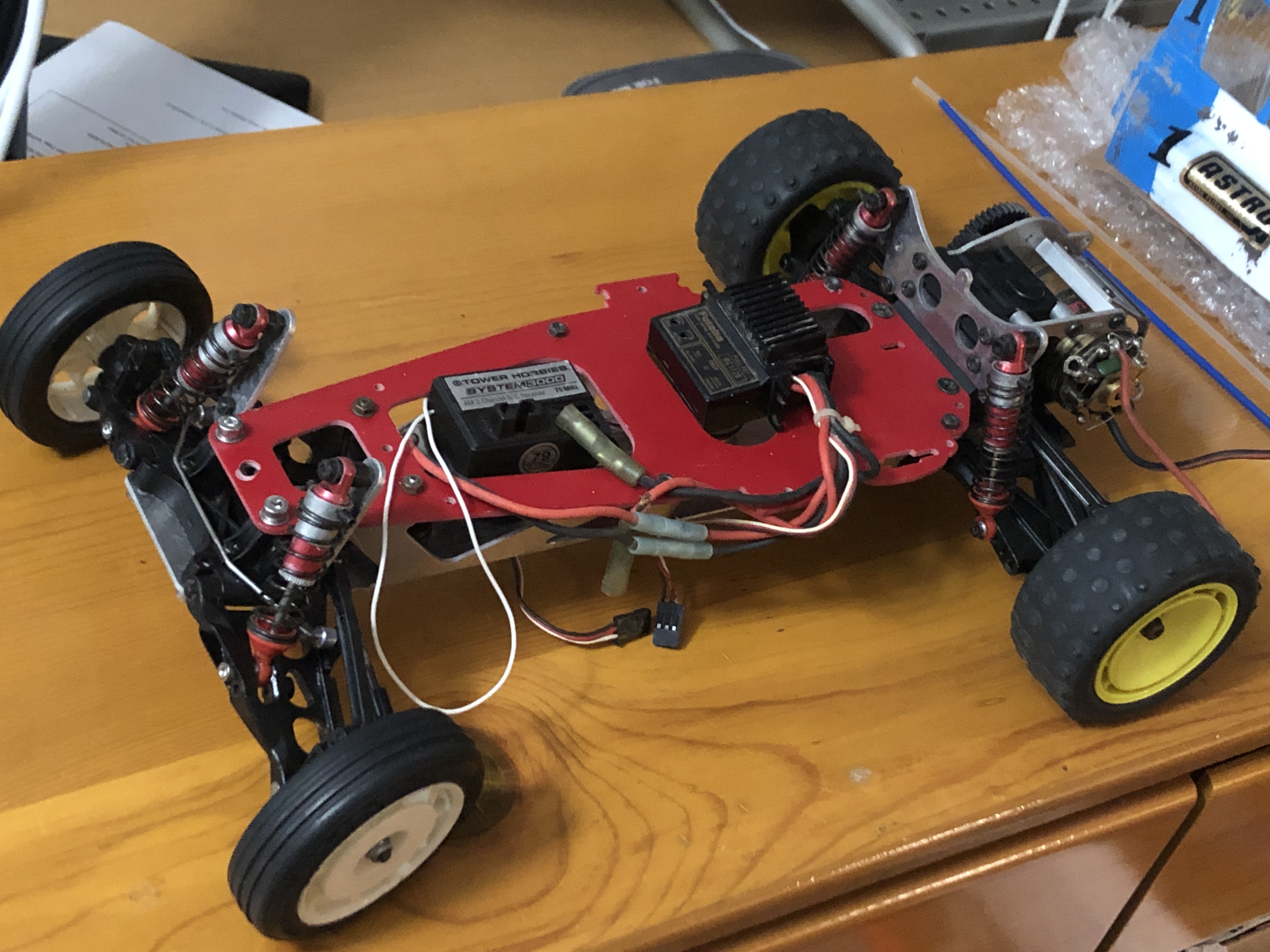

Lastly, if you're interested, here's the Ultima I've been working on that will get this 480Gold. It still needs quite a bit including a new body, wheels (have some ready to go), and tires, but the chassis and drivetrain have been fully rebuilt and are in pretty good shape
